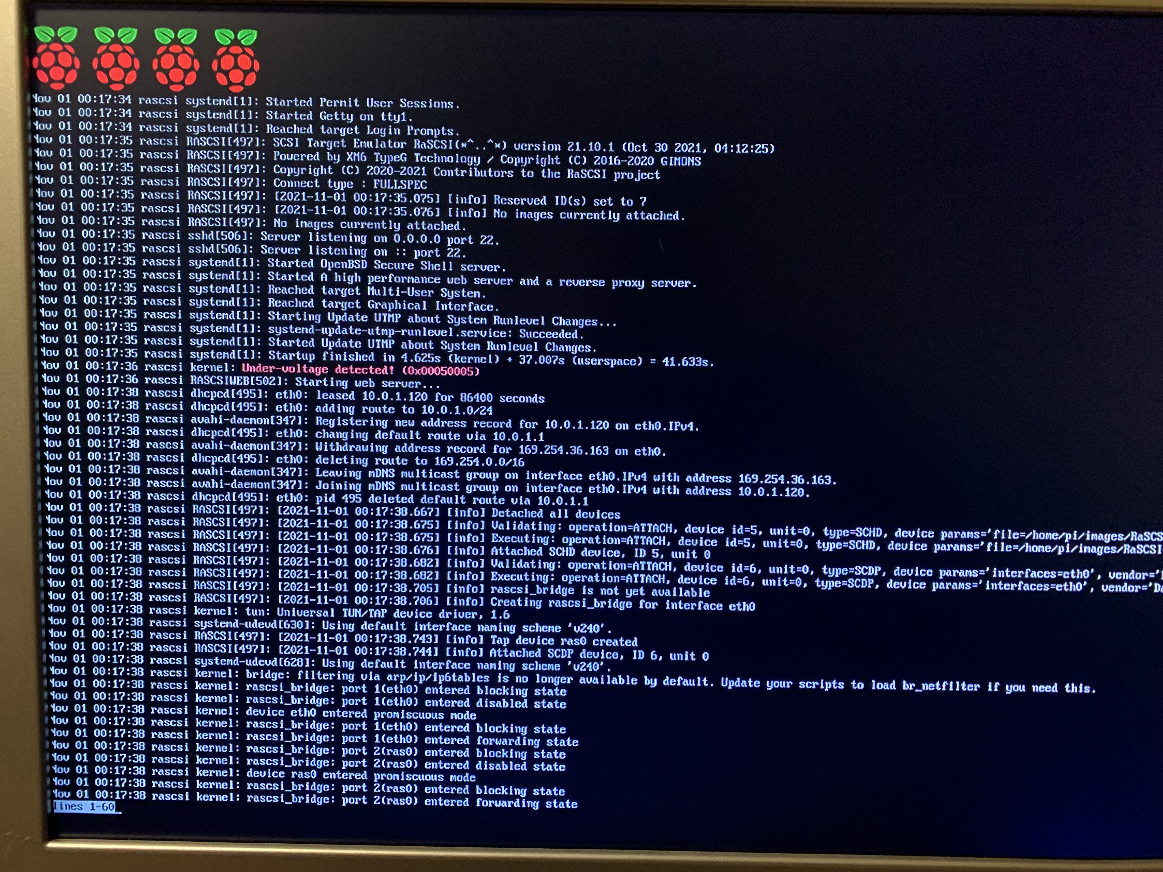

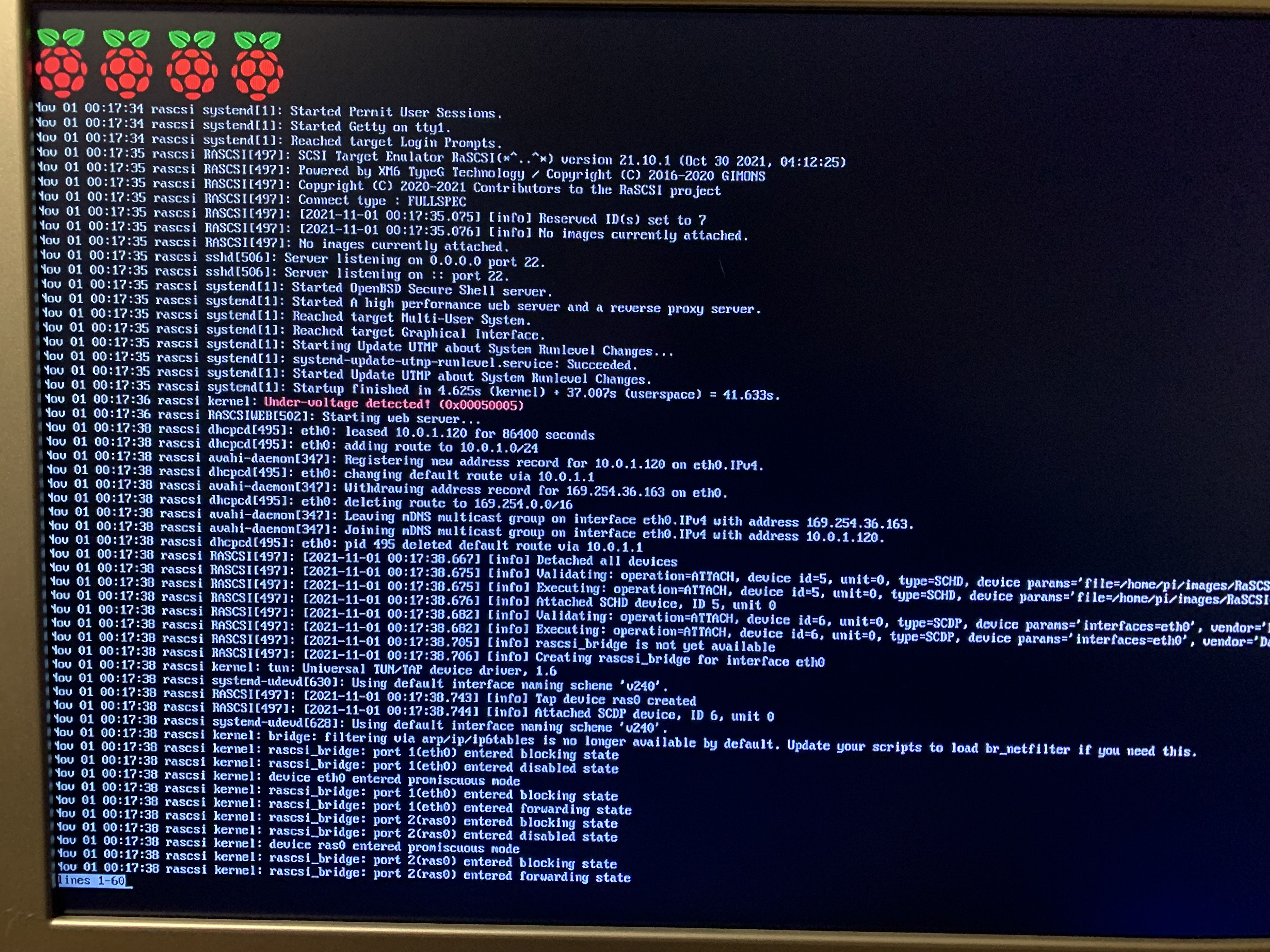

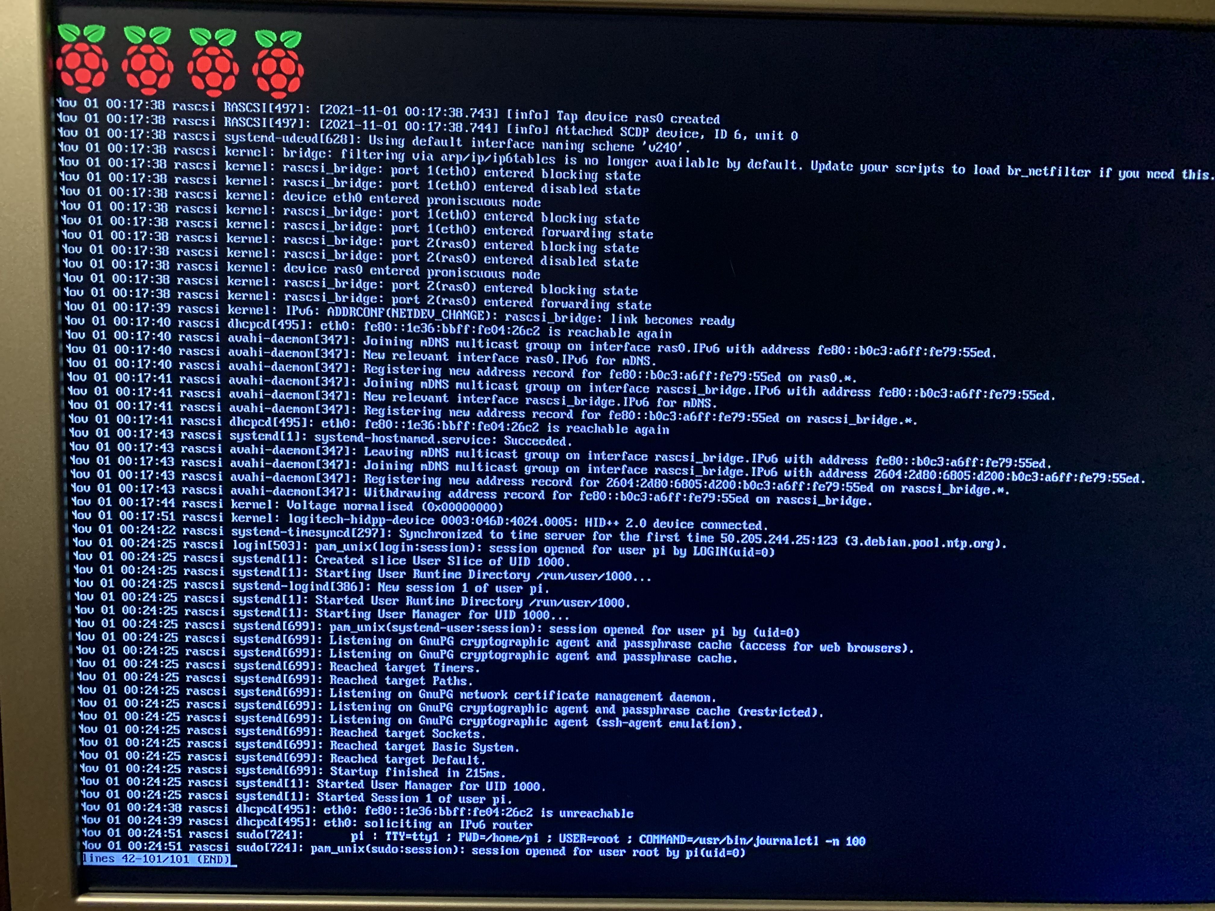

It's a 32 GB microSD, so I don't think it was that. I accidentally hit "unzip all" and may have done a reboot before it finished unzipping all the files...
I also permanently brought down the web UI by unmounting the included System 7.5.3 HD image. Here's the output from journalctl:
View attachment 452 View attachment 453
These logs don't show much RaSCSI activity apart from launching, so hard to say exactly what's going wrong I'm afraid.
The one thing that stands out is a "under-voltage" warning, which could explain why RaSCSI isn't able to run reliably. Are you using a power supply rated for at least 2.5 amps?
Tried it with my 2.5A CanaKit power supply and same result - simply unmounting one of the default HD images brings the web UI down. This is with the SCSI to Ethernet adapter mounted in slot 6 and HD image in slot 5.

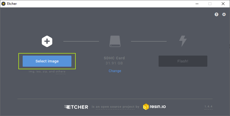

Yes; nice update; took a while BUT using a HEADLESS PI ZERO complicated it. First flashed the image from the above GitHub sight to the SD card using "Raspberry Pi Imager" (use last option "use custom"). Used notepad on a windows machine to make an empty text file named "ssh" and placed in top directory on card then made another text file named "wpa_supplicant.conf" copy and pasted:
country=US
ctrl_interface=DIR=/var/run/wpa_supplicant GROUP=netdev
update_config=1
network={
scan_ssid=1
ssid="your_wifi_ssid"
psk="your_wifi_password"
into it (editing the name of your network and password into to the right spot) and placed in top directory on the card. I couldn't get it to work with textedit on MacOS.
Then put the card into the Pi Zero and turned it on.Then looked for a new device on my network for an ip address.
Then went to terminal on my mac and Typed "ssh [email protected]" where all of the XXX is your IP address. Change password as recommended with log on. Once this was completed, I was then able to use the Web interface for the RASCSI.
It took a couple of tries; if you erase the card or refresh and start over , terminal sometimes will not let you log in secondary to security preferences and you may have to highlight your home folder on your mac and hold down command and shift and . so you can see hidden folders and delete prior information regarding ssh hosts (I just deleted all files in hidden folder .ssh)
