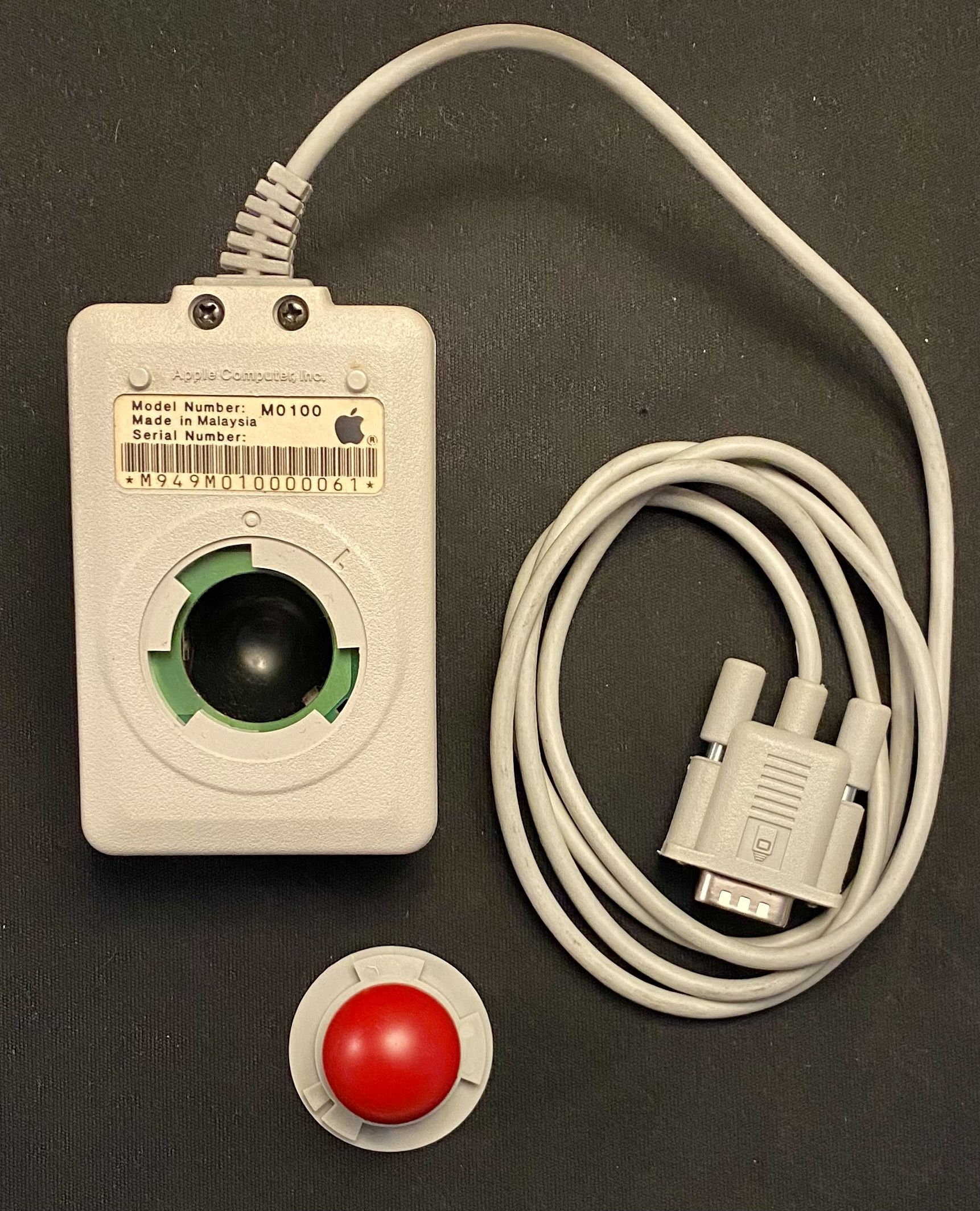

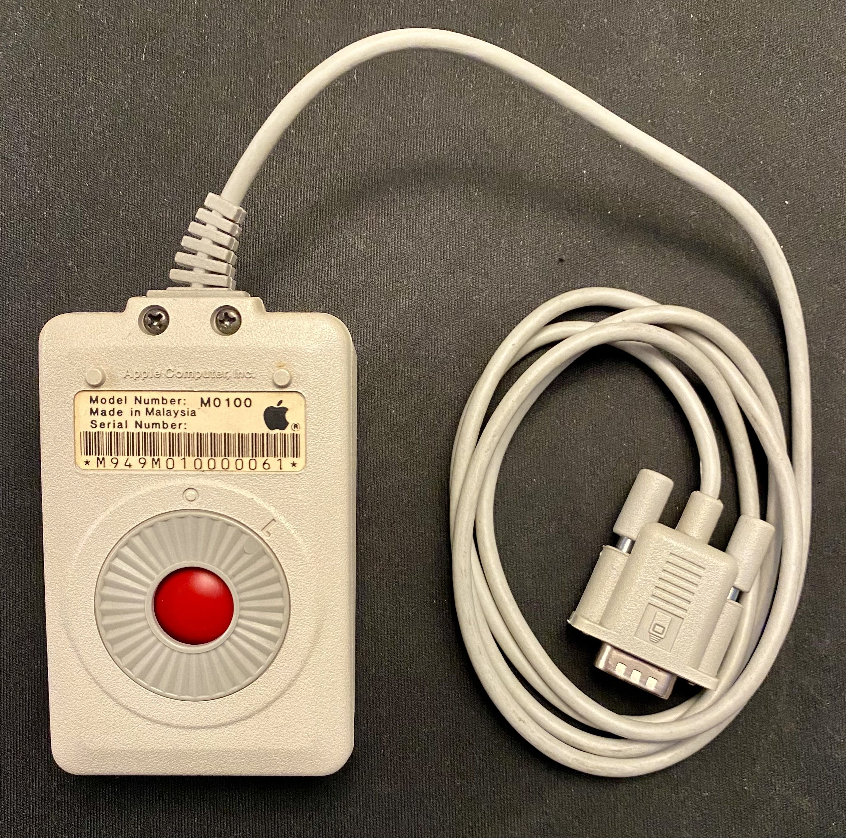

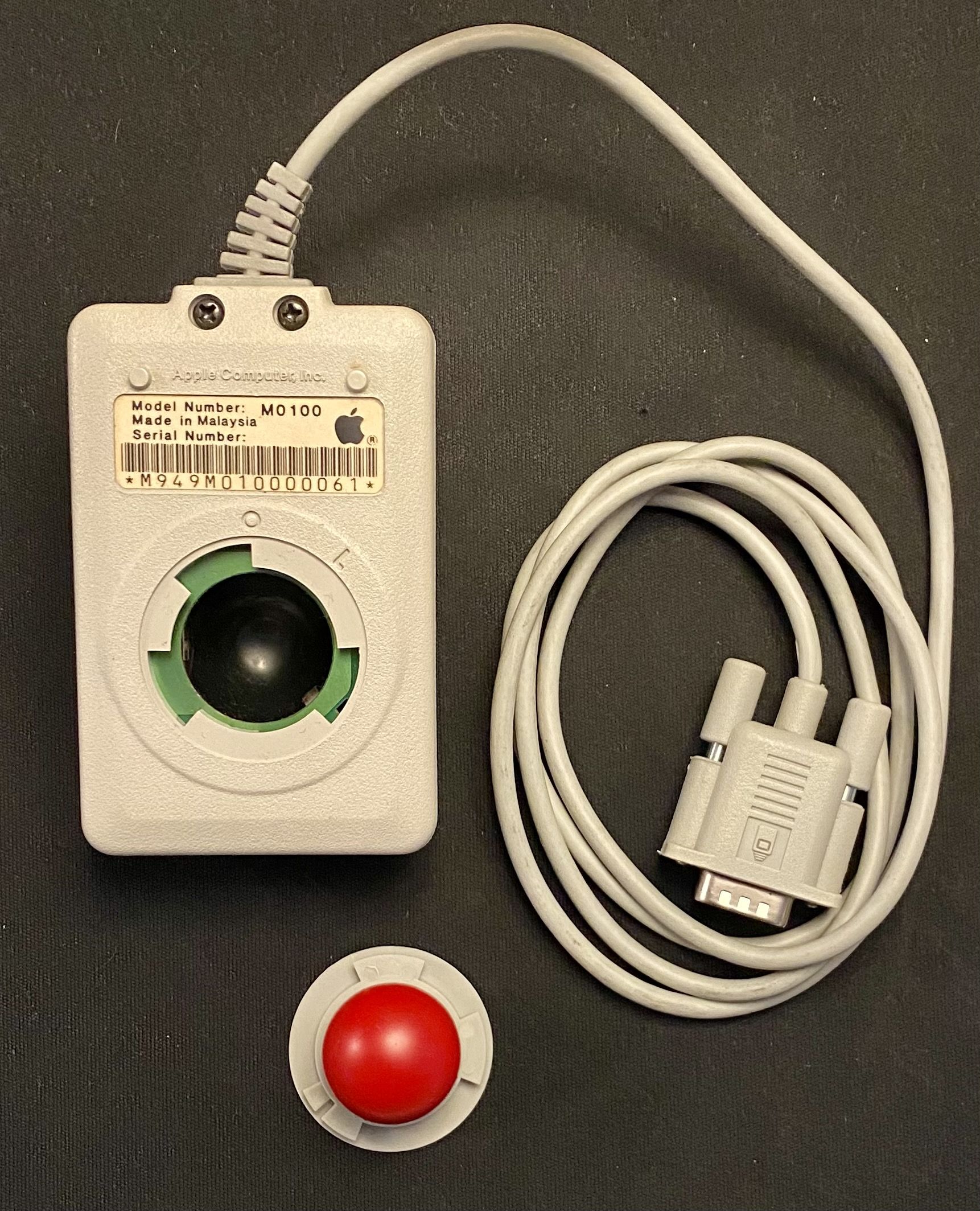

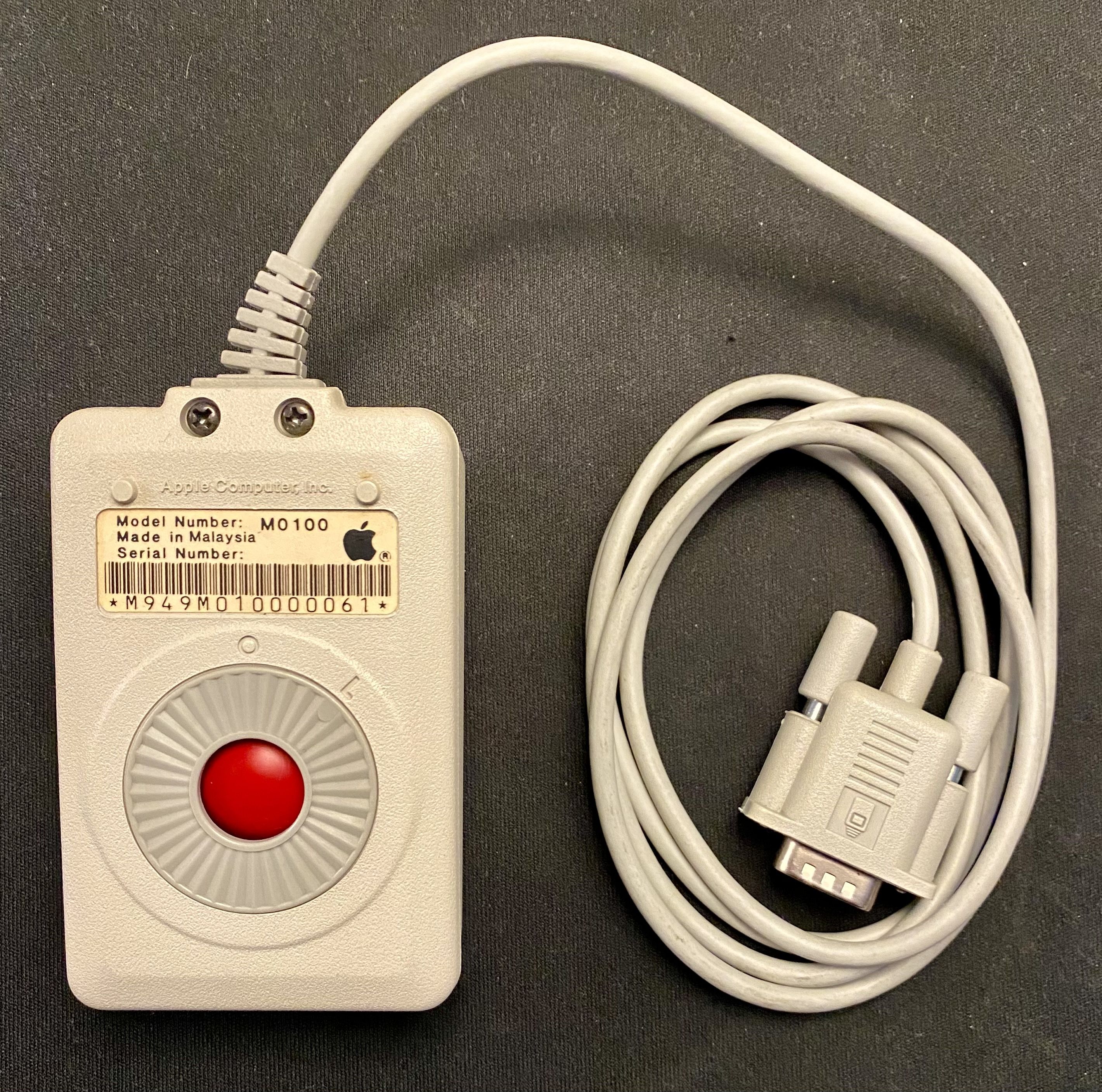

My liquid rubber is also quick, it takes till dust resist around 10-15 minutes, but that moment still will come off or memorize fingerprints easily. I let it try for the whole night, lets say 12 hours. (I did the procedure at the evening, it was no problem to wait till the next day.)
After that it was ready to roll...
