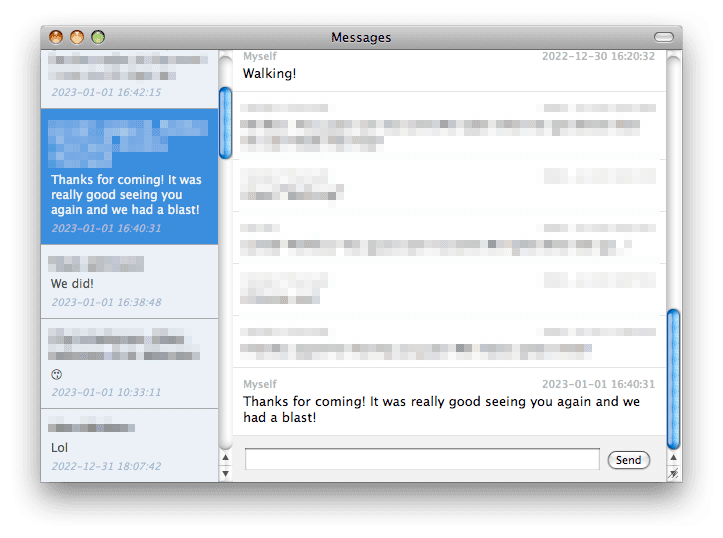

One issue I had last year was the inability to use iMessage and SMS properly from my PowerPC Macs, since I am a heavy user of the Messages app on my modern Macs. I found a few different solutions for this, but nothing I found worked quite the way I wanted--so I took matters into my own hands!
I made Message Bridge, which is an app you run on your modern Mac, and has a simple web interface you can load from your old Macs! It works on lighter older browsers on OS X like Safari and Camino, and even works on Classilla when you're booted into OS 9. For this year, I plan to use Leopard as my main OS, so I am using Fluid to have a nice simple Messages window on my G5 using Message Bridge.

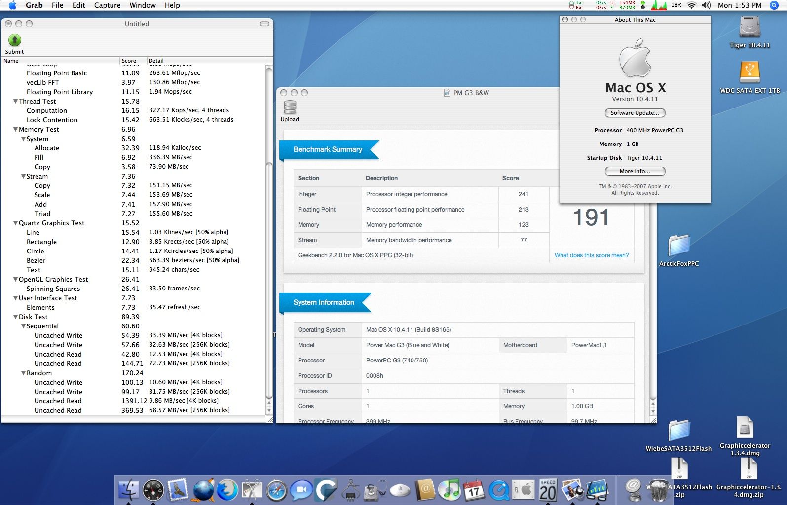

I drug out a Powermac G3 Blue & white revb and have been wasting time with that.
Powermac 1,1 Blue & white G3 400 PowerPC
Flashed SIL3512 PCI satat card, weibetech drivers
120gb NETAC SSD
ATI Radeon 7000 64MB (PC) GPU Flashed with Radeon 7000 Reduced ROM
1GB (256x4 PC100) Ram
PCI USB2
Wireless PCI card (forget the model)
Tiger 10.4.11 (build 8S165)
So this box is one of my janky-er boxes I have. All in all, so far it has been a woofy experience rife with KPs and general software instability.
*took a break, TFF just crashed the box here lol*
My gut is telling me the instability is from the 7000. This B&W so far has been a giant pain in my butt and I will not waste any more precious time on it today. (Lies) :D

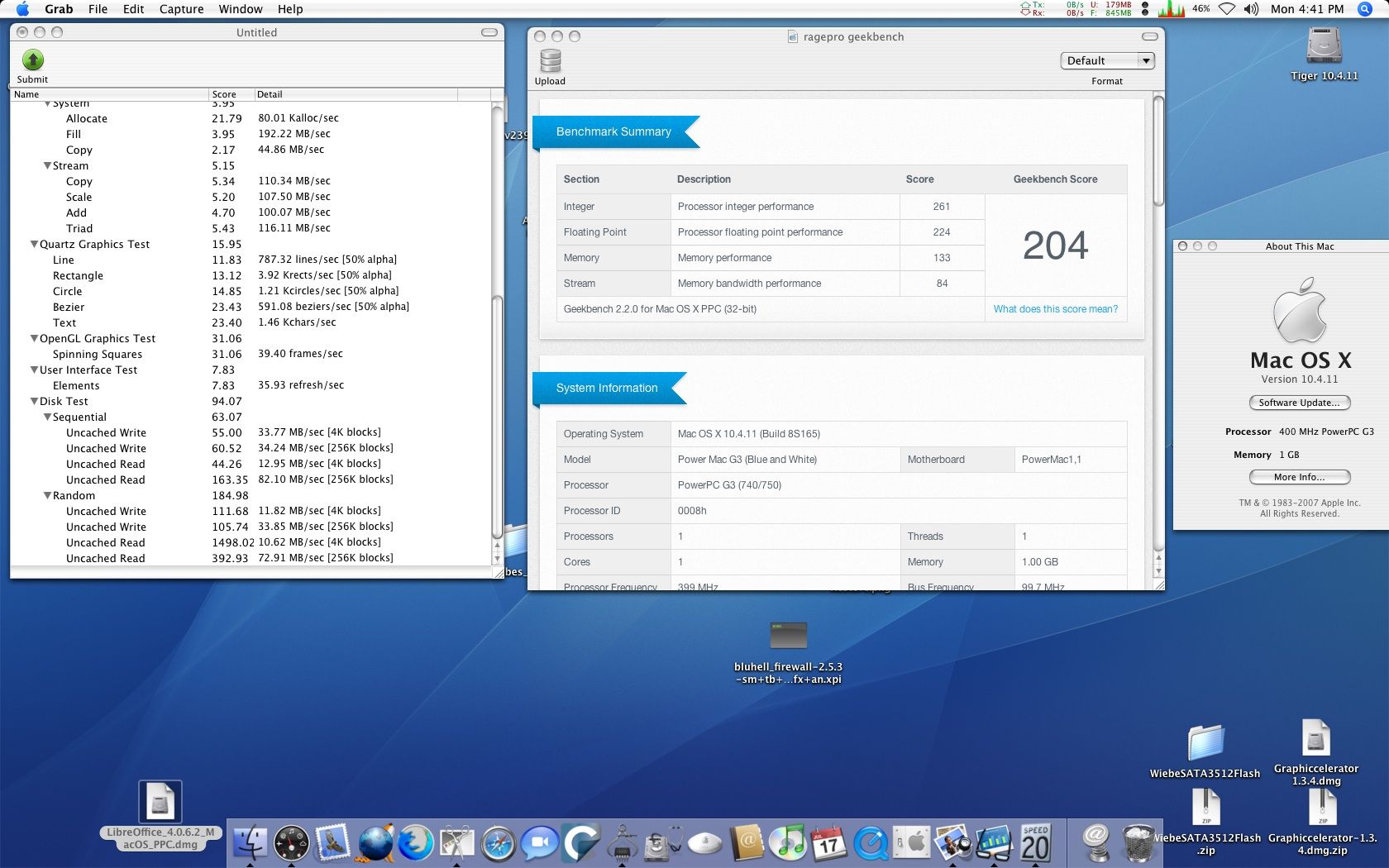

I am a glutton for punishment.
I located the PCI rage gpu and reinstalled it. Instability has disappeared. I have used this across multiple mozilla based browsers with zero issue. With the OG gpu, it also benched higher so the flashed 7000 is definitely suspect.
*spoke too soon. System has frozen up twice in short succession. I’ll play with WebKit later and anything else I can think up. KPs and sleep issues have stopped completely with gpu swap. The instability seems specific to trying to go online (big surprise there 😅) on an old OS and unsupported browser.Fun times.

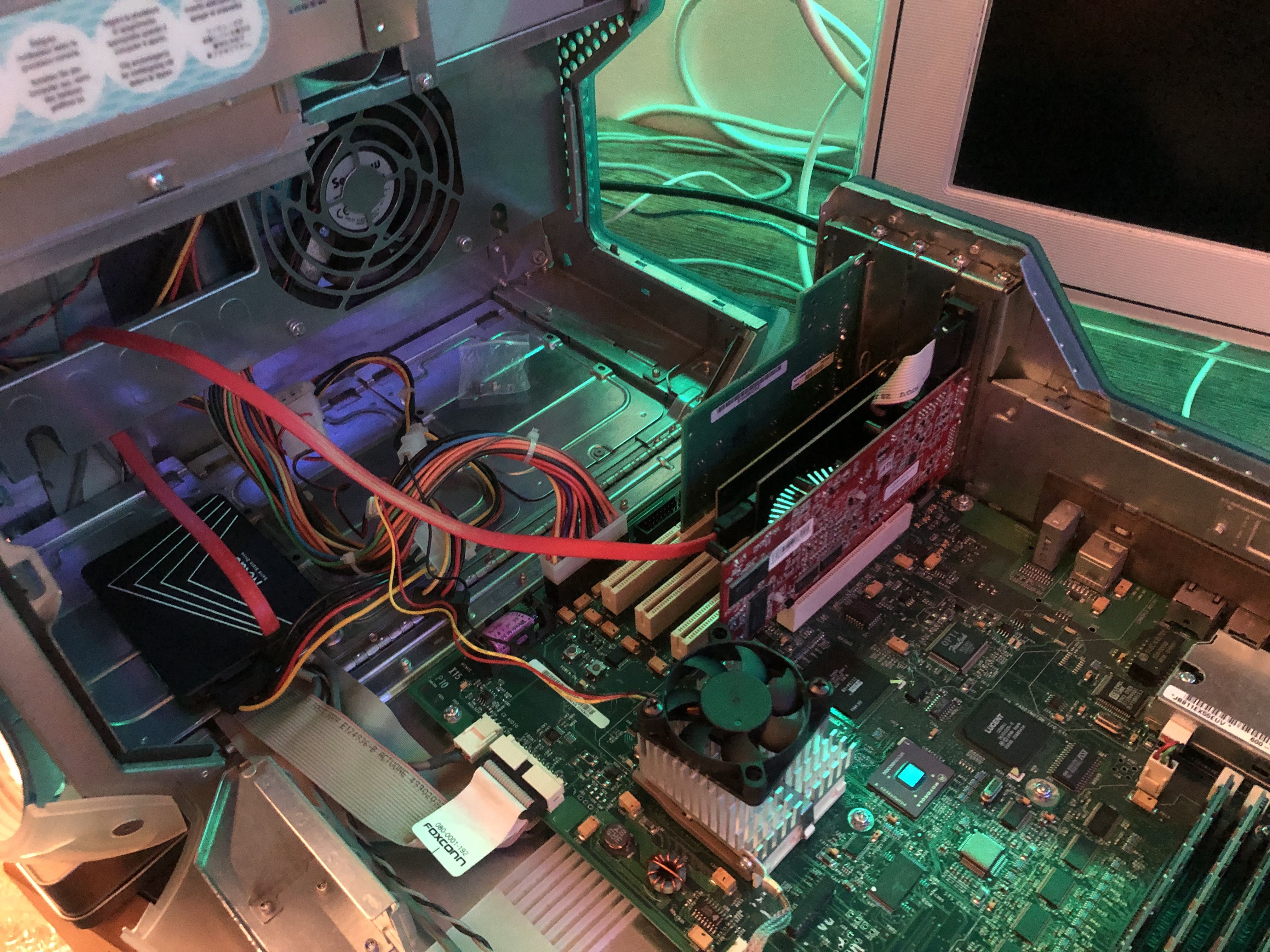

It is odd. I think i will reflash the card and see how it reacts - will research additional roms as well to see if there is a better option I missed the first time round. Right now I've moved onto my Quicksilver (using that now)
but will circle back to the revb B&W and that 7000 this weekend. I think this QS box would make a entertaining ppcc 2023 vid.
