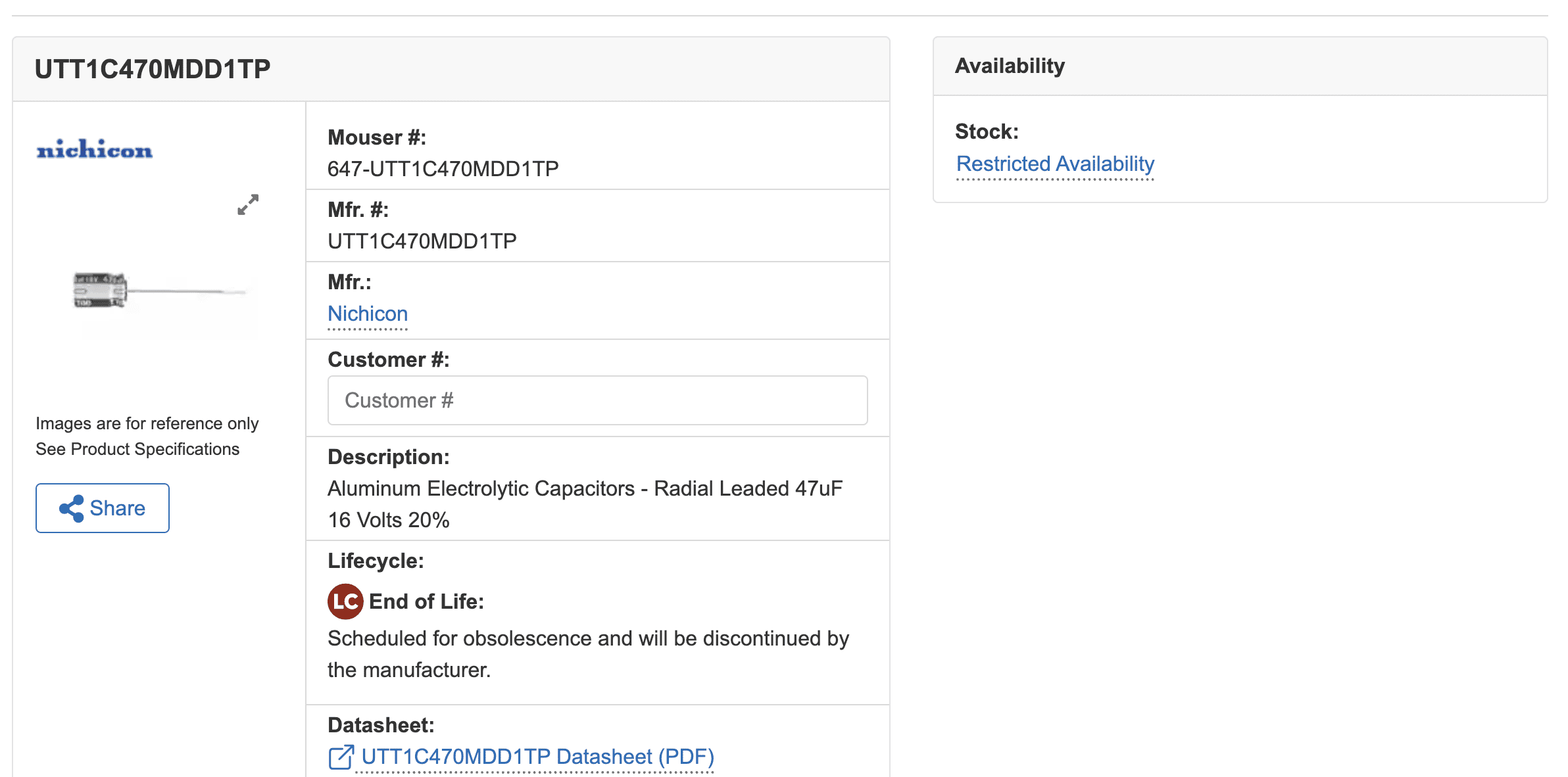

6pcs of 47uF 16V, D=6.5mm, H=8mm, Lead Spacing=2.5mm (Mouser: UTT1C470MDD1TP)

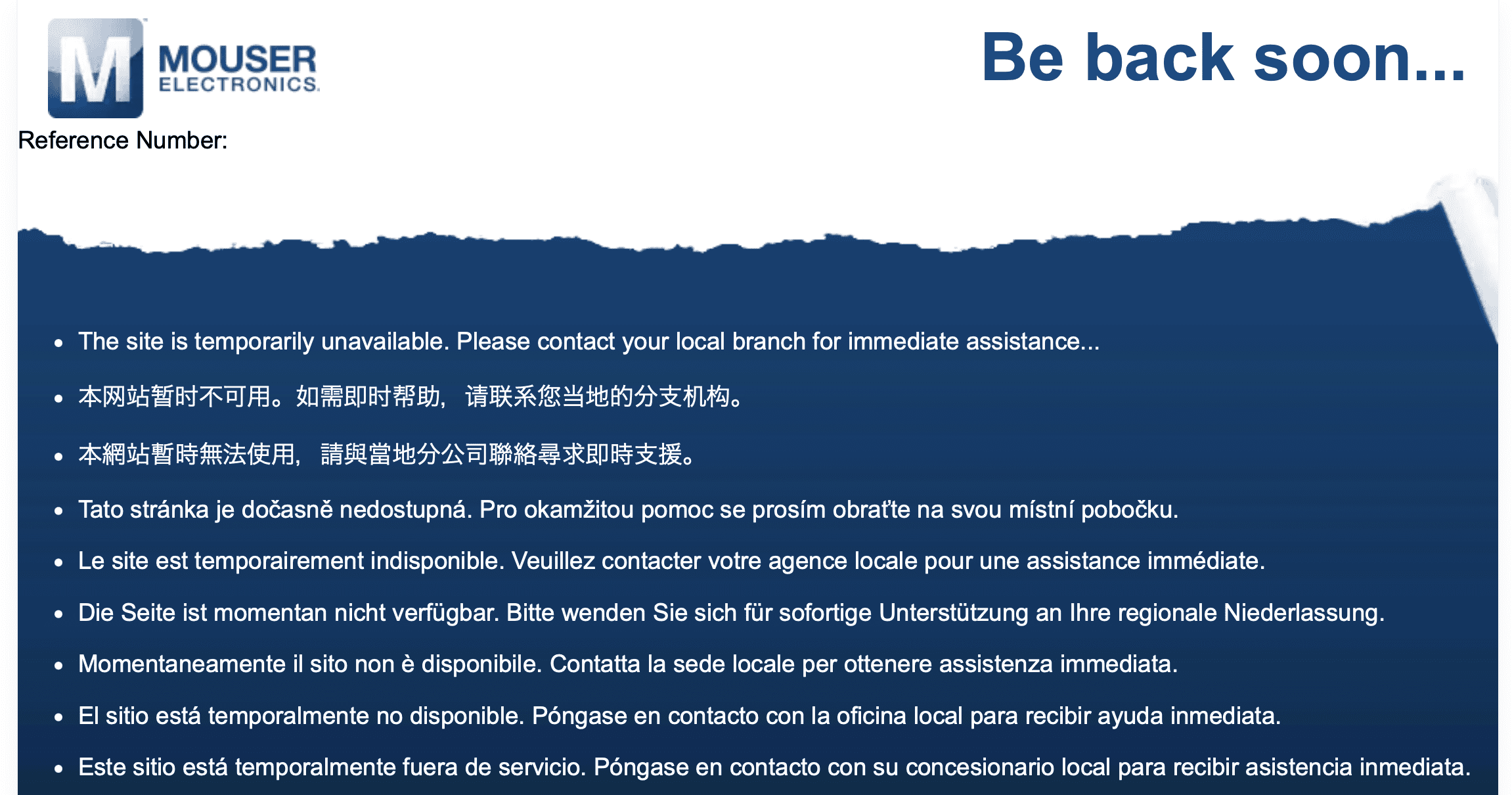

I was trying to swap out capacitors in my two Carts after reading your post, but suddenly the entire website shutdown...
I guess I will need to wait until tomorrow.
Tariffs have wreaked havoc across all my Mouser Carts, I must say. It's very frustrating.
2,745
2,144
The site is working today, but even though I have the site set to the Japan region (where I live), I am getting the same message...
That indicates it may not be sold anywhere, which is very odd.

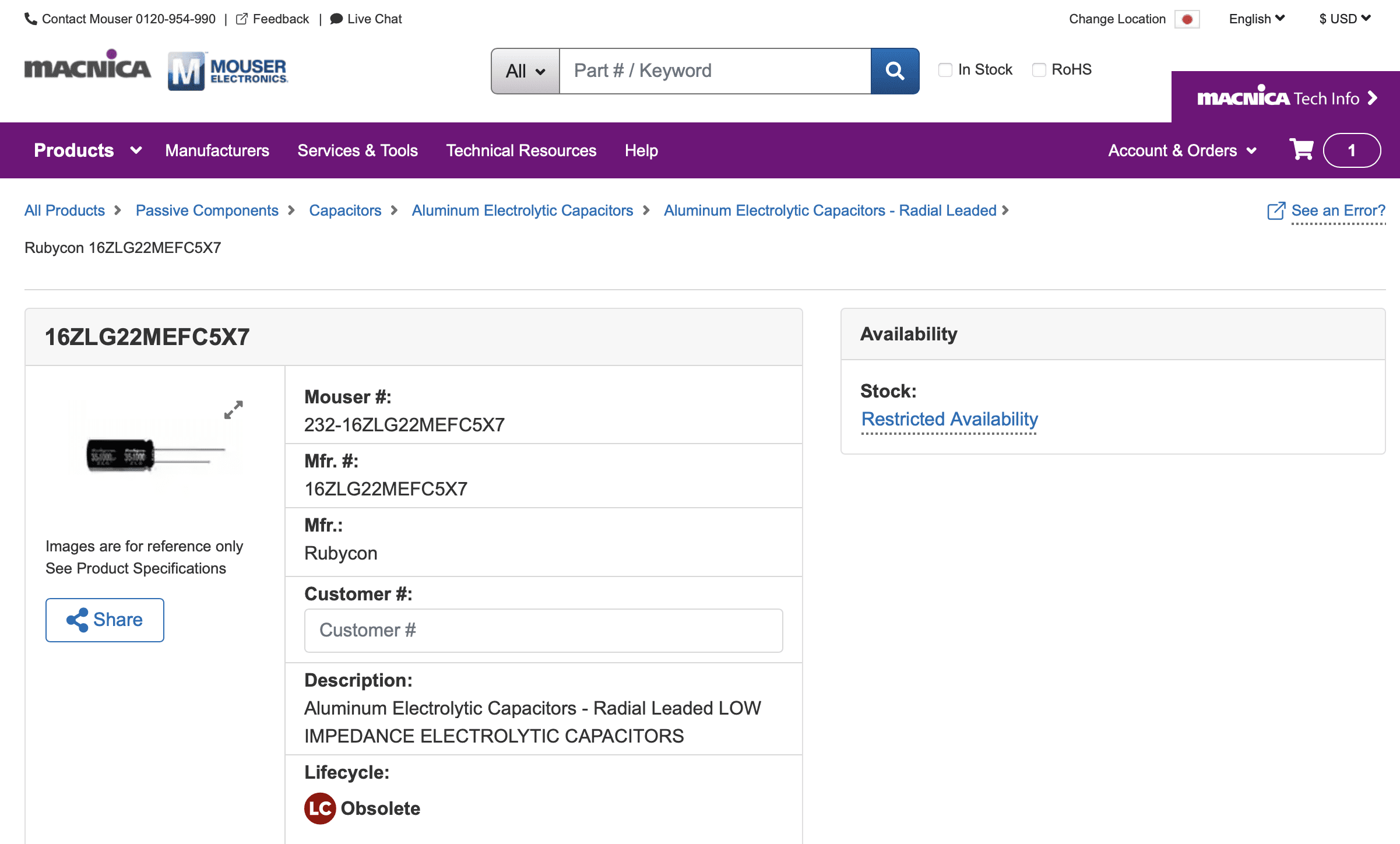

Swapping out the caps is going to take time because the ones in my cart originally were the best caps available at the time. Now I am finding inferior ones. They will work, but have higher ESR. For example, consider the specs of one of the 22uF caps in my 400K Drive OA-D34V-22 Cart, with ESR of 270m-Ohms and 350mA Ripple Current:
An in-stock 22uF cap with the same physical size and lead spacing and capacitance has higher ESR, as evidenced by the tiny 50mA Ripple Current:

I've spent a number of hours on this, both yesterday and today. This issue has become really complicated due to Mouser having killed off the right caps, so this post is long and messy as a result.

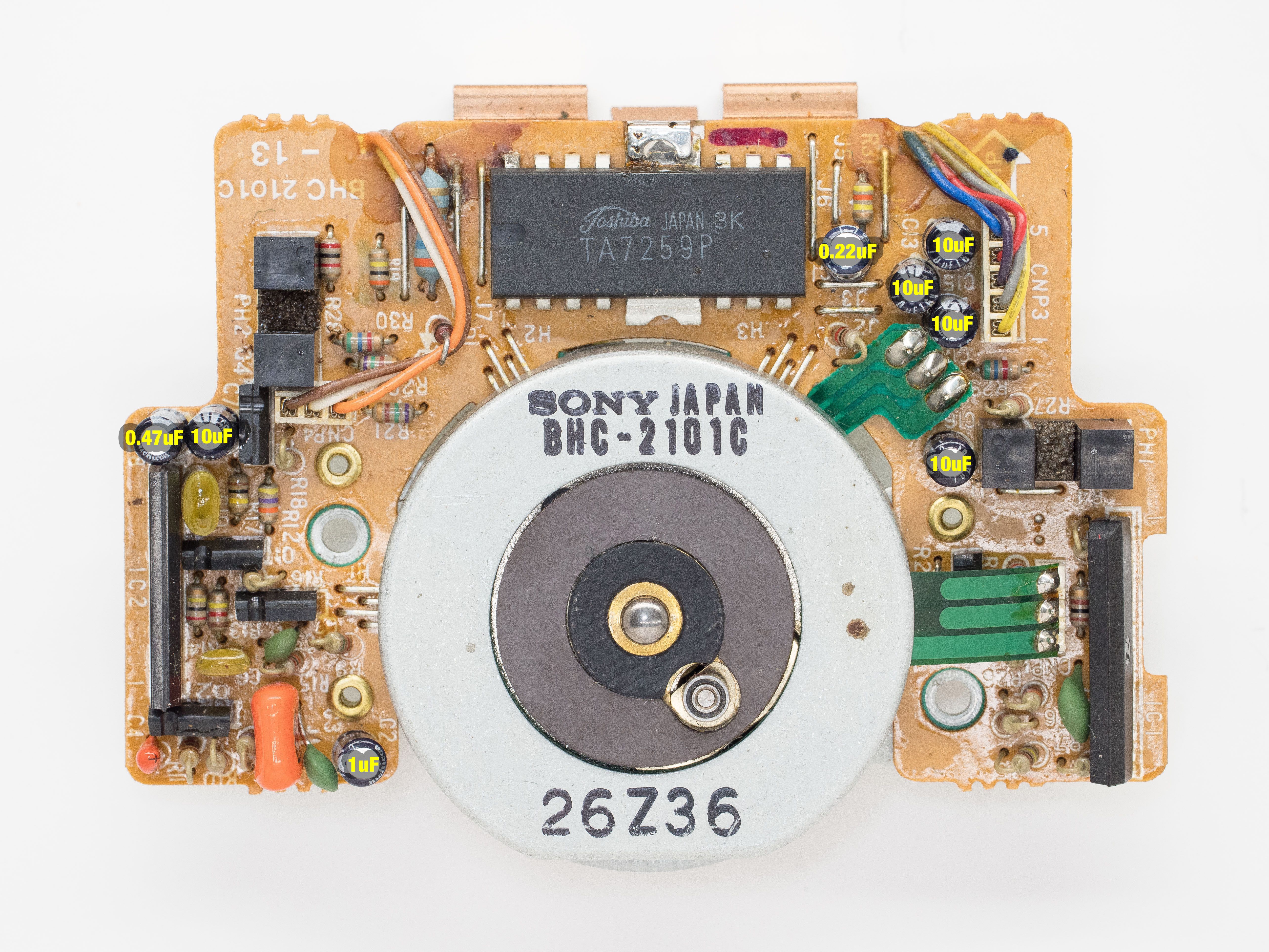

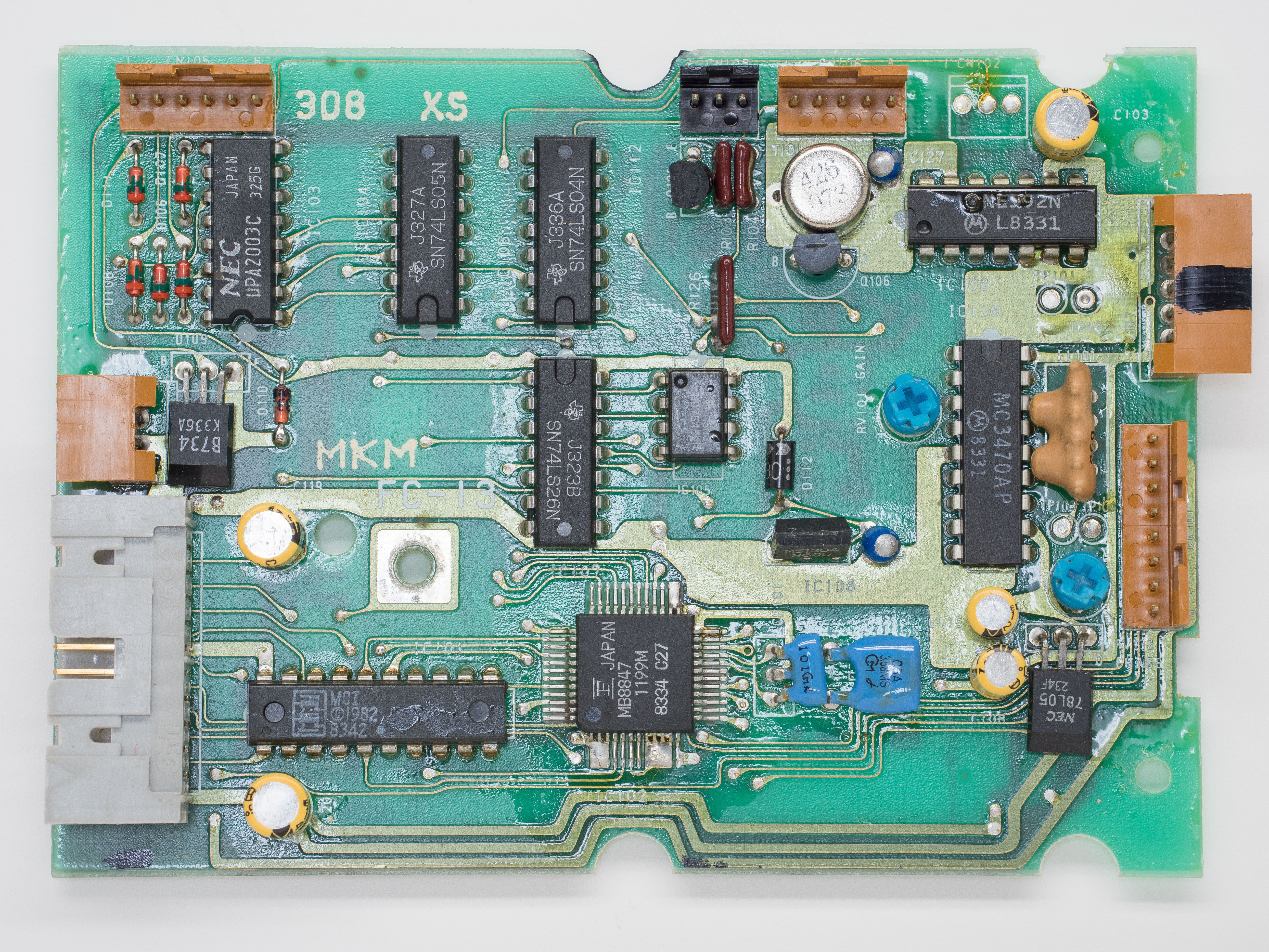

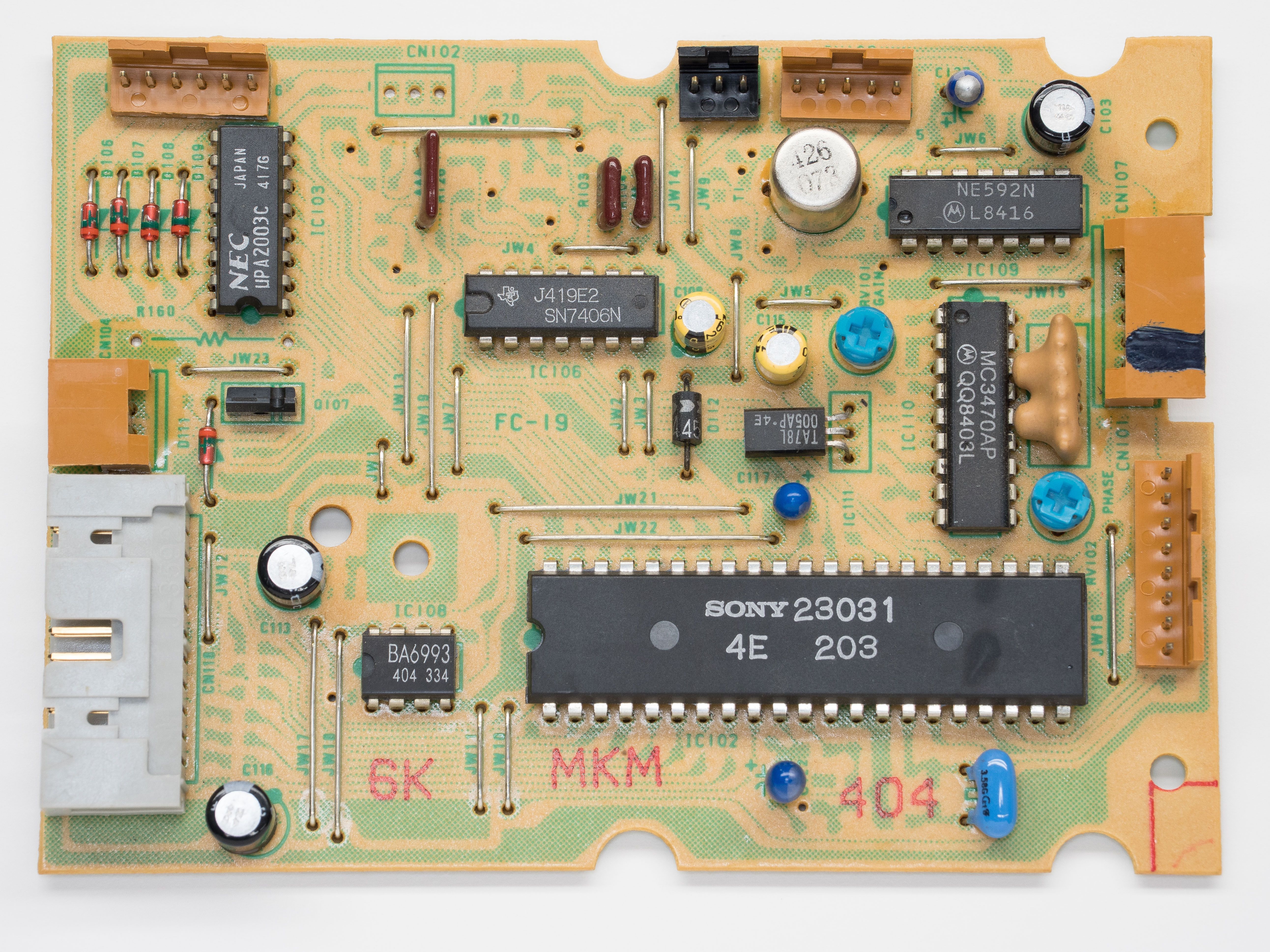

Just to correct and clarify your opening post, the Big PCB on the 400K drive only requires HALF the quantity of caps you mentioned (for a single 400K drive), so the following is correct:
Big PCB:
3pcs of 47uF (stock specs: 16V, D=6.5mm, H=8mm, Lead Spacing=2.0mm or 2.5mm)
2pcs of 22uF (stock specs: 16V, D=5.1mm, H=8mm, Lead Spacing=2.0mm or 2.5mm)
That applies to both Carts listed under my video — two carts because 400K drive types and PCBs differ...

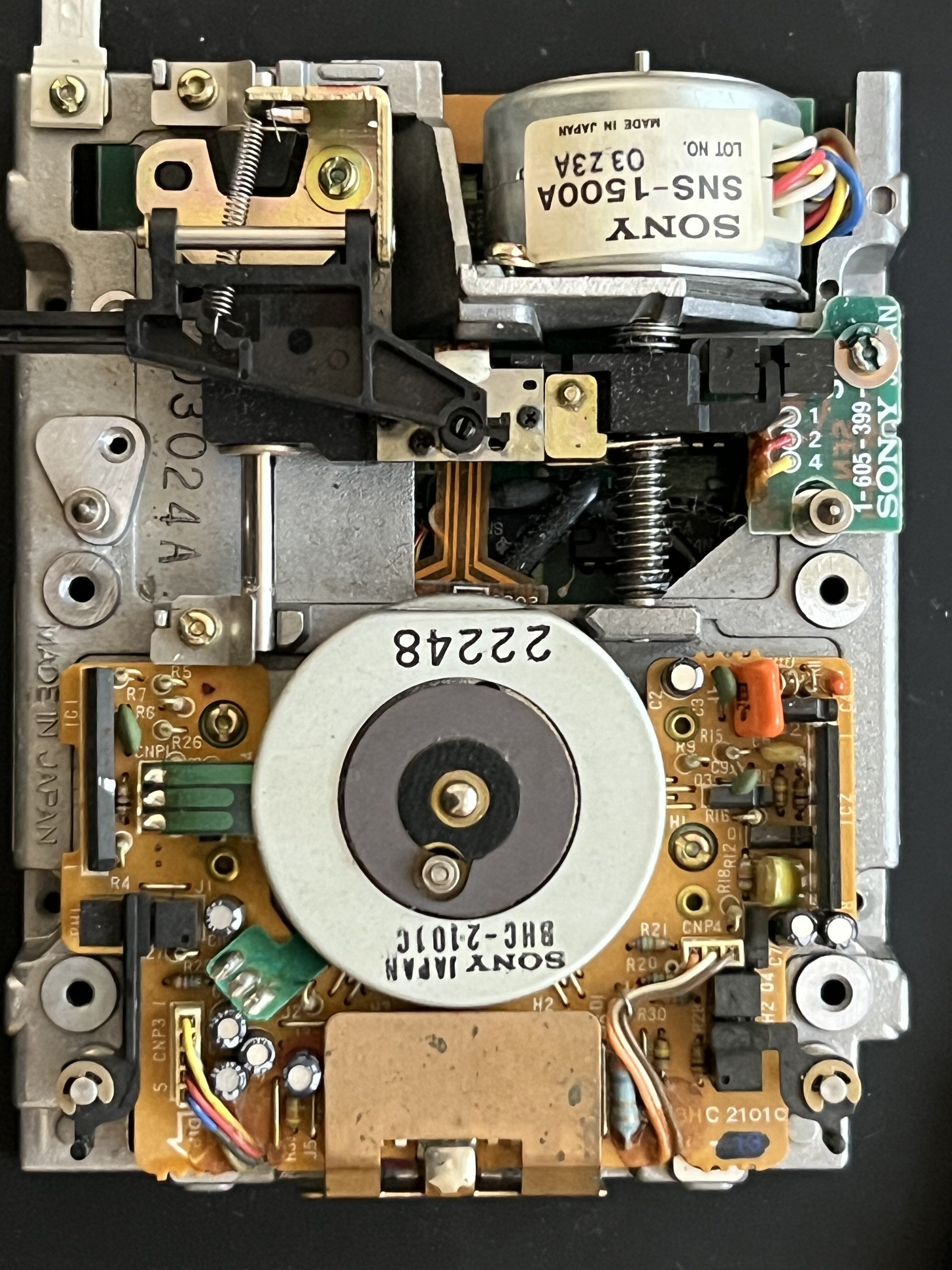

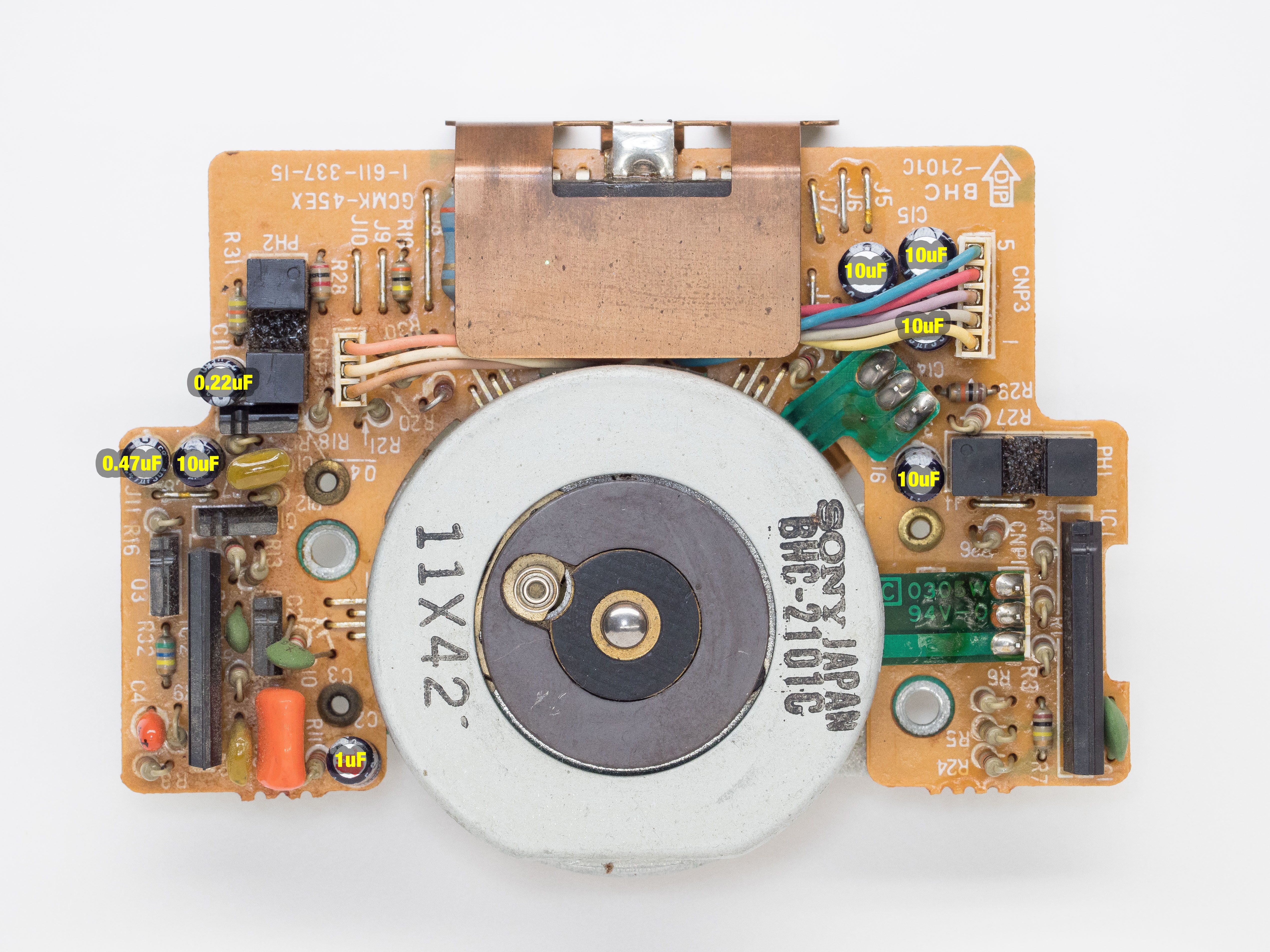

The capacitor-related differences between the two 400K drive types appear on the Small PCB, and the 0.22uF in an aluminum electrolytic type is nowhere to be found on Mouser as of today.
I am, however, able to find in-stock 0.22uF caps in solid Tantalum LEADED form here:
The big issue is that the HEIGHT of the stock cap is 5.8mm or so. Those solid leaded Tantalum caps are 7mm to 7.11mm tall. By far, they are the BETTER cap though because they won't need to be replaced. And although I have no idea if the working voltage is 5V or 12.5V across that cap, even if it is 12.5V, the solid leaded Tantalum caps linked above are rated for more than double that working voltage (35V or 50V) which means you're safe.
So the question is, can you buy the solid tantalum cap and make it fit? Probably because the other caps on that SMALL PCB are 7.0mm.
For now, this is the one I will pick as it is D=4.4mm:
But here's the issue. The stock cap LEAD SPACING is 1.5mm, and that tantalum cap is 2.54mm. That means the cap would stand up on its legs, further increasing its height off the PCB, which I think may pose a problem. But perhaps you could lay down that cap on its side to make it fit, because it is not adjacent to other caps in the area.
That very well might work, but perhaps ONLY on this PCB type...
⚠️ But it doesn't appear possible to "lay down the cap on its side" if you have the following Small PCB type...
Nevertheless, I have swapped in that tantalum cap on both of my SMALL PCB Mouser Carts, because that's all we have!
The 1uF capacitor I had chosen in my carts previously was the best. 20mA Ripple current and low ESR. All the aluminum electrolytic caps in the physical size we need are only 10mA Ripple current, which means about double the ESR...
However, if we do with this 1uF cap as I did with the 0.22uF cap and go with leaded Solid Tantalum (which again has enough voltage headroom to be safe), this one would be my pick...
I've added that to my two Carts. And because it is isolated from other caps, you MIGHT be able to lay it down on its side to make it fit. This is speculation on my part, but it's the best I can do, since I don't have that cap.
Both of my Mouser Carts are now EXACTLY THE SAME. So I will at some point eliminate one and update my video description to reflect that. Both are complete with no out-of-stock caps as of this writing. You can buy either one.

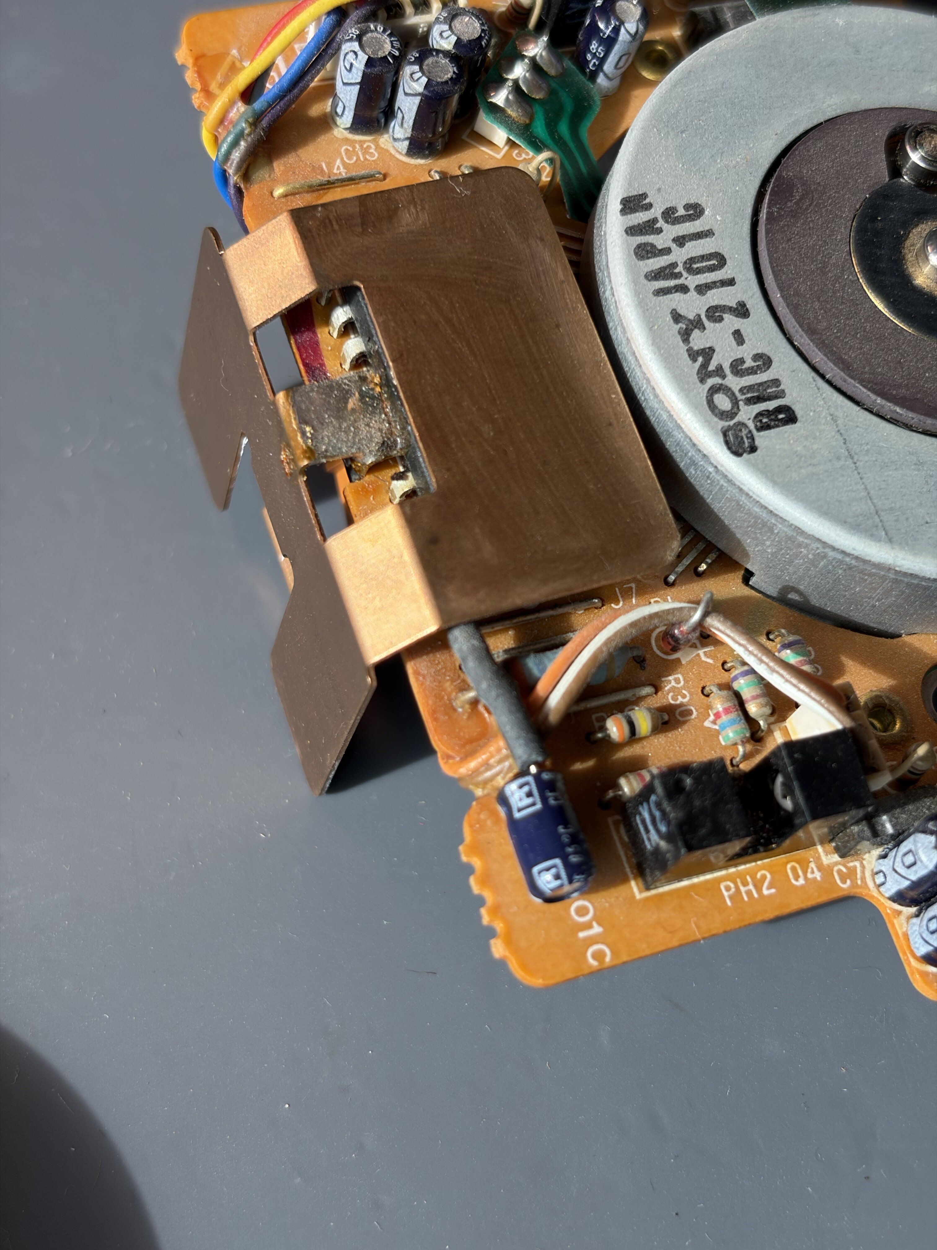

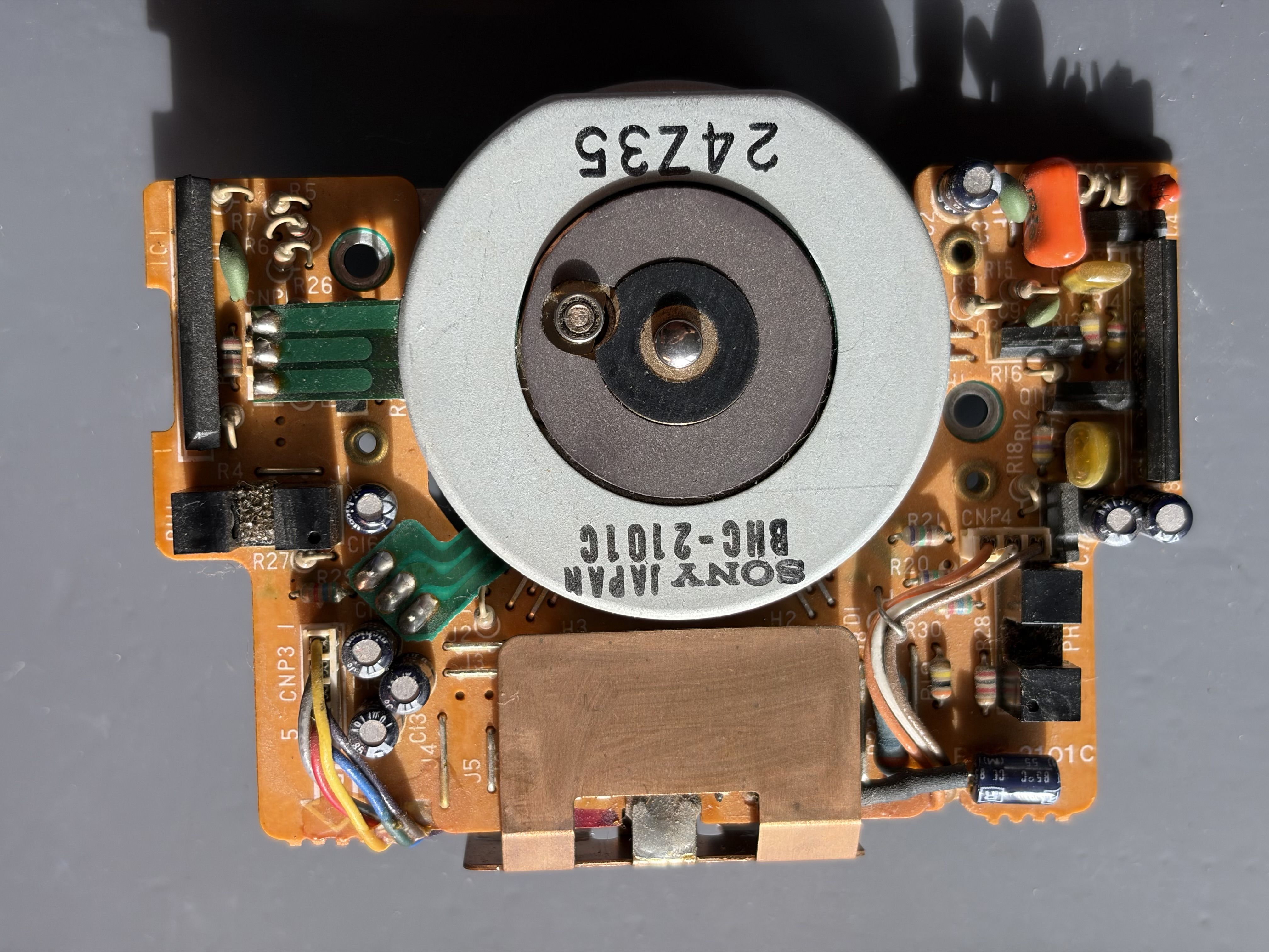

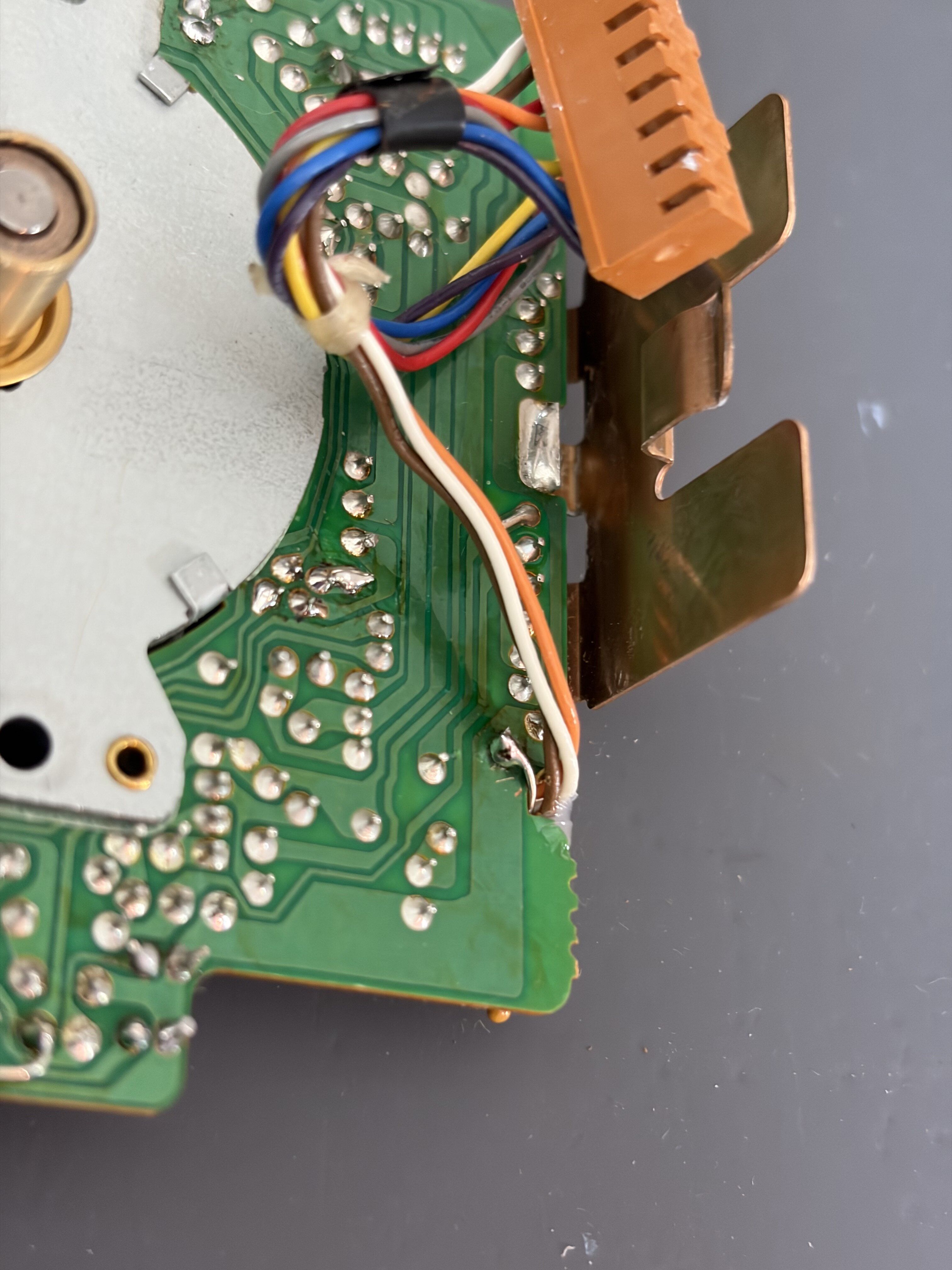

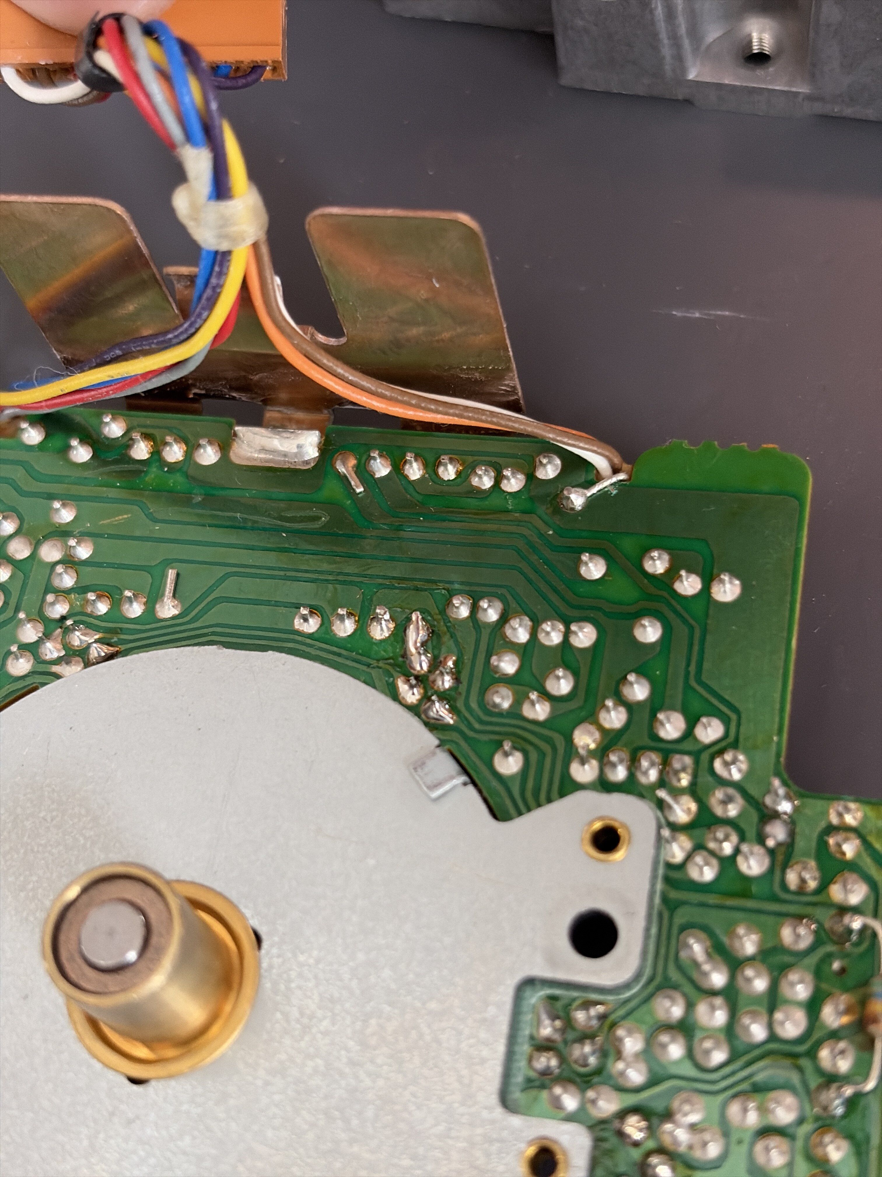

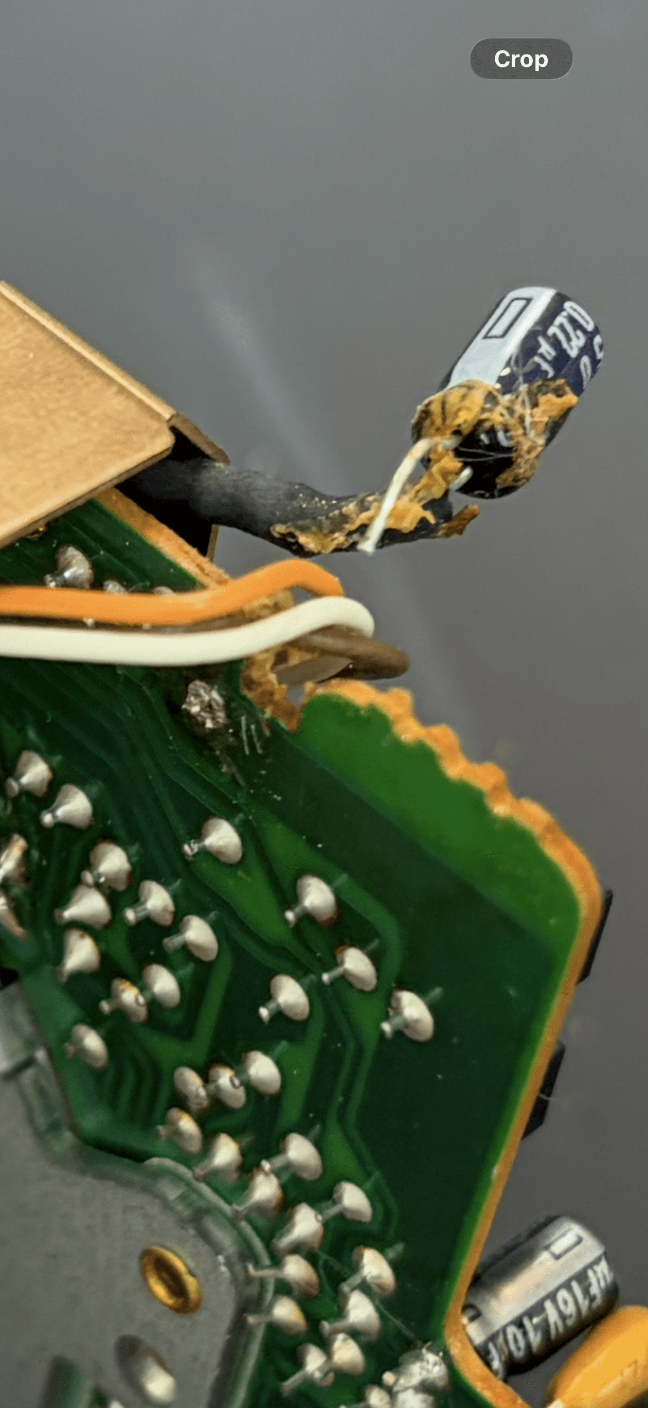

I have an interesting contribution to this conversation. I have recently acquired a Macintosh 128K with the 400K drive from January 1984. The drive is a SONY Model OA-D34V. Serial No 155794. The sticker on the side shows January 1984. The version of the small circuit board differs a little bit, also there is a very interesting altercation to the C11 capacitor. Its location is moved to the front of the board, and it appears to be soldered to the IC and a connection to the bottom of the small circuit board. (See Photo)
I've purchased from Mouser a 0.22uF 35 volts 10% Tantalum to replace this capacitor you see in the pictures. Any suggestions on how to approach this job?
2,745
2,144
Seems more of a private hack job than something SONY would do because: (1) there is heat shrink on it (atypical for a factory build), and (2) capacitor leads ought not to be extended like that.
The photos don’t show where both capacitor legs connect. And zooming in on the heat shrink in you photos show what could be a bulge and possible a resistor inside?

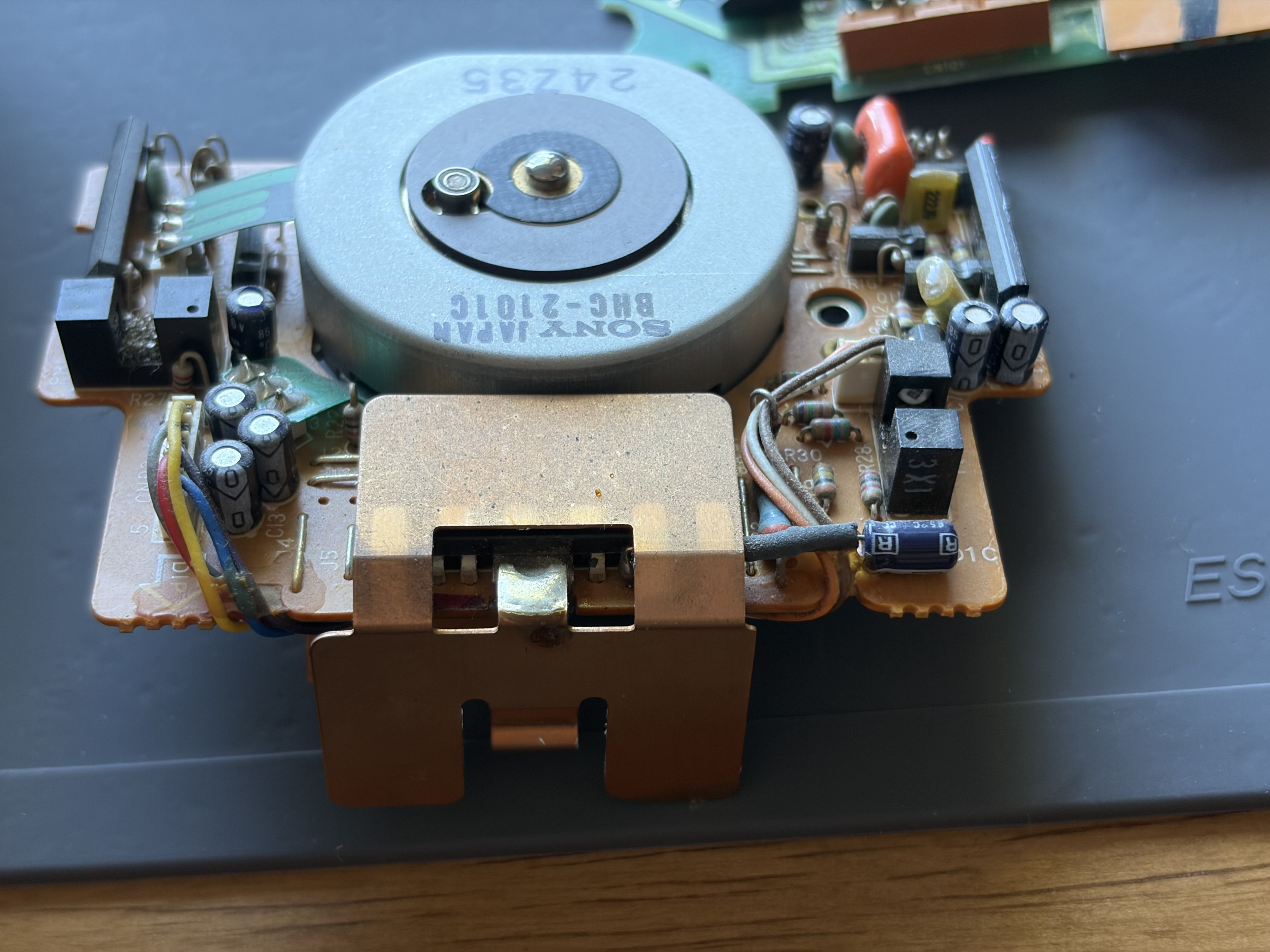

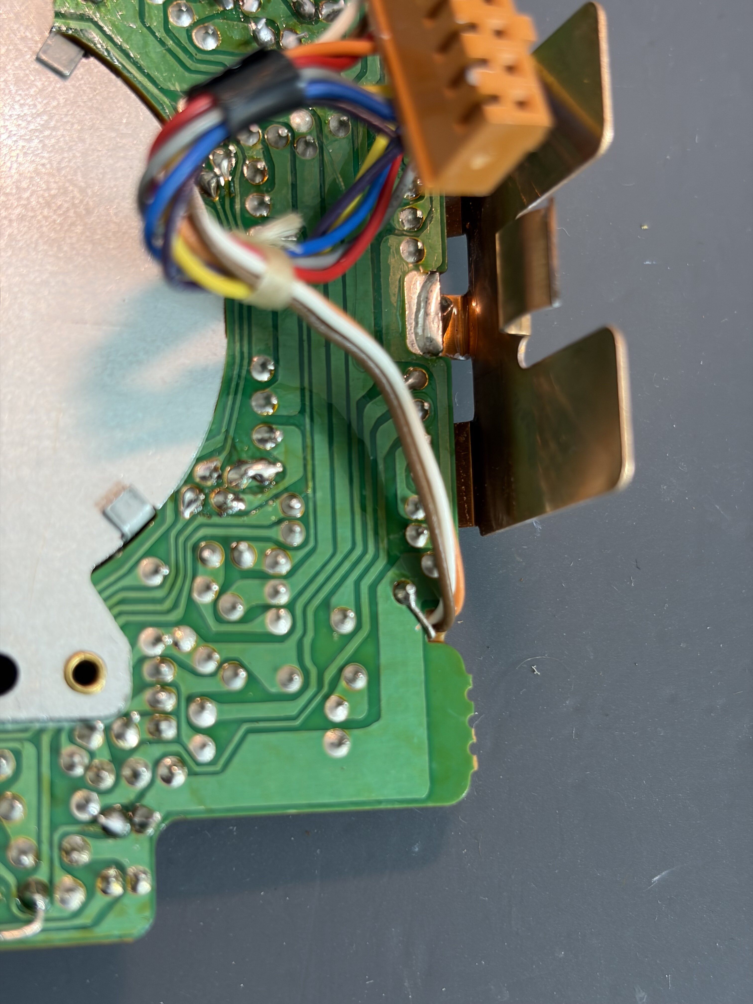

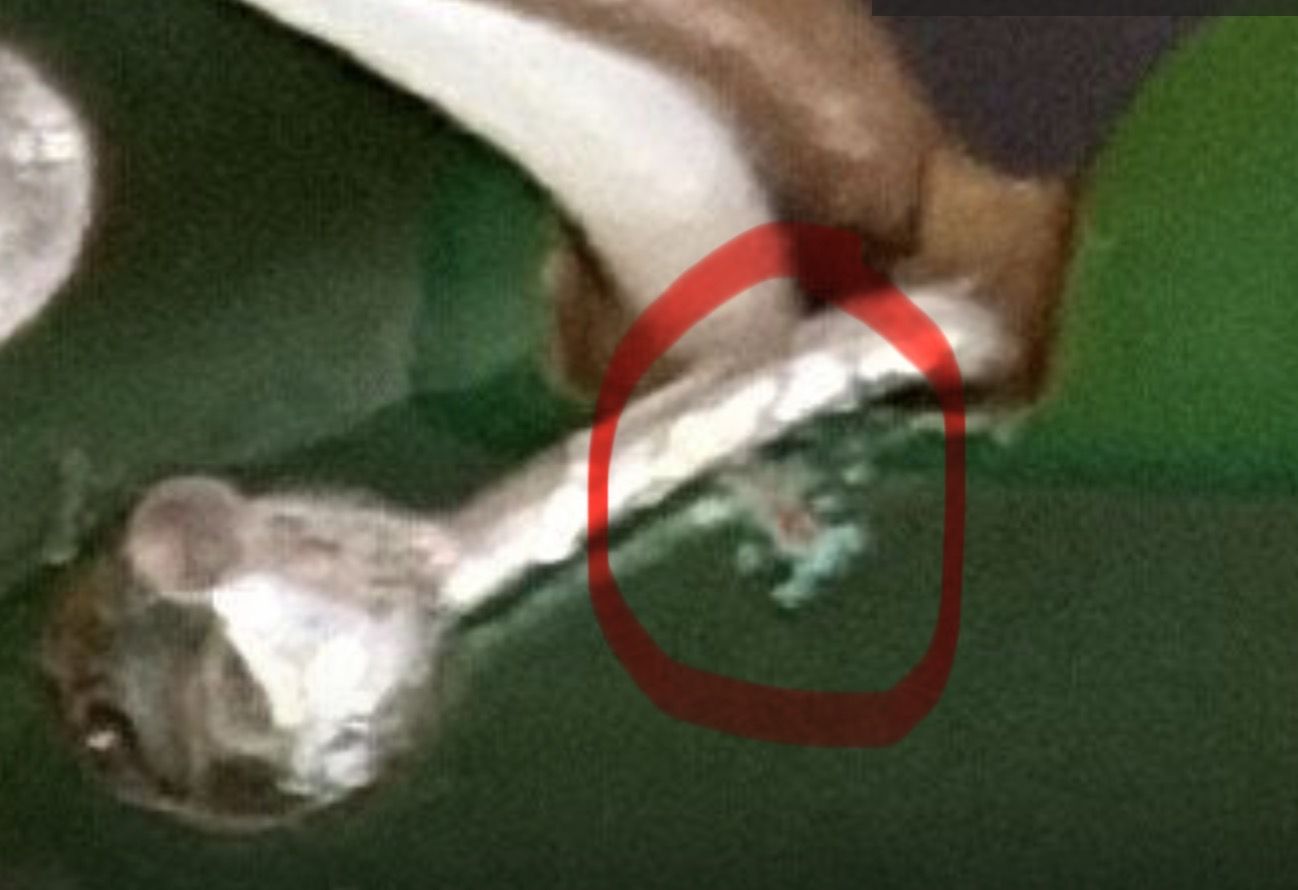

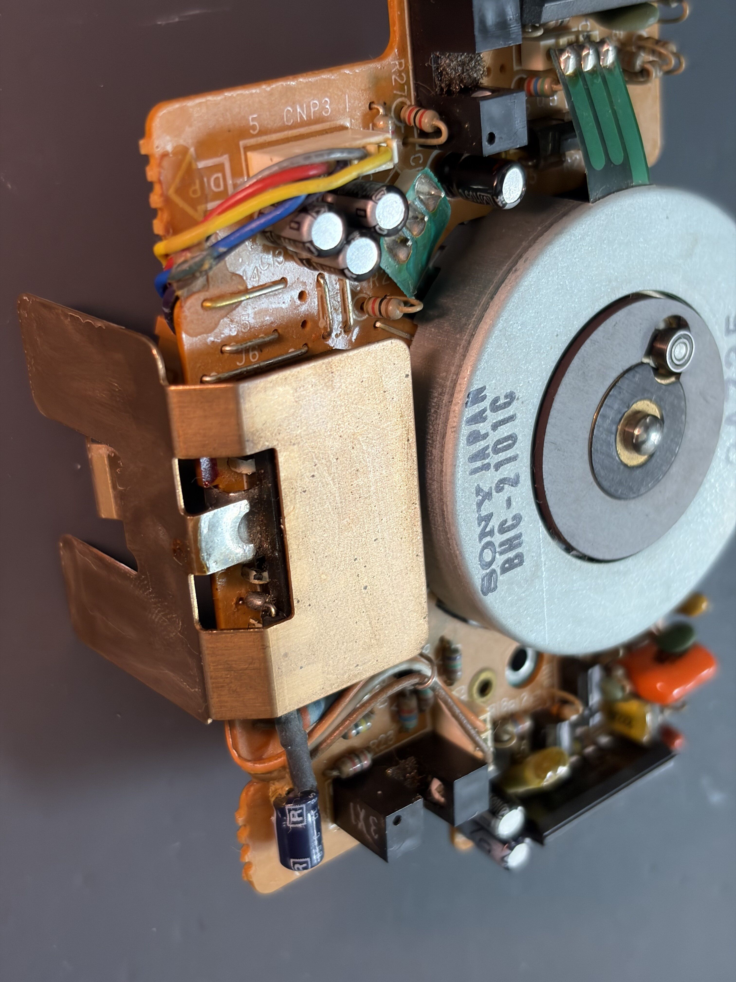

I had a chance to open up the Mac 128K today. I have disassembled the 400K drive once again and had a chance to take a better photo of the capacitor:
it shows how the negative lead folds around the PCB and is soldered to the bottom. The positive lead is soldered directly to the pin of the IC. It’s the second pin to the right of the heat shield.
2,745
2,144
Thank you for the photos. But it just doesn’t seem to look like something that could’ve been done at the factory. Another t tail sign of what I’m saying is the cut into copper that I’ve circled for you below:
It’s all very strange.
OkSort7057
Apr 24, 2026
Agreed. I picked up this Mac from a local Craigslist posting and it was in amazing condition. When I opened it up I could have sworn I was the first person opening it up since 1984…. Oh well. Thank you for your input and insights about this floppy drive, much appreciated!

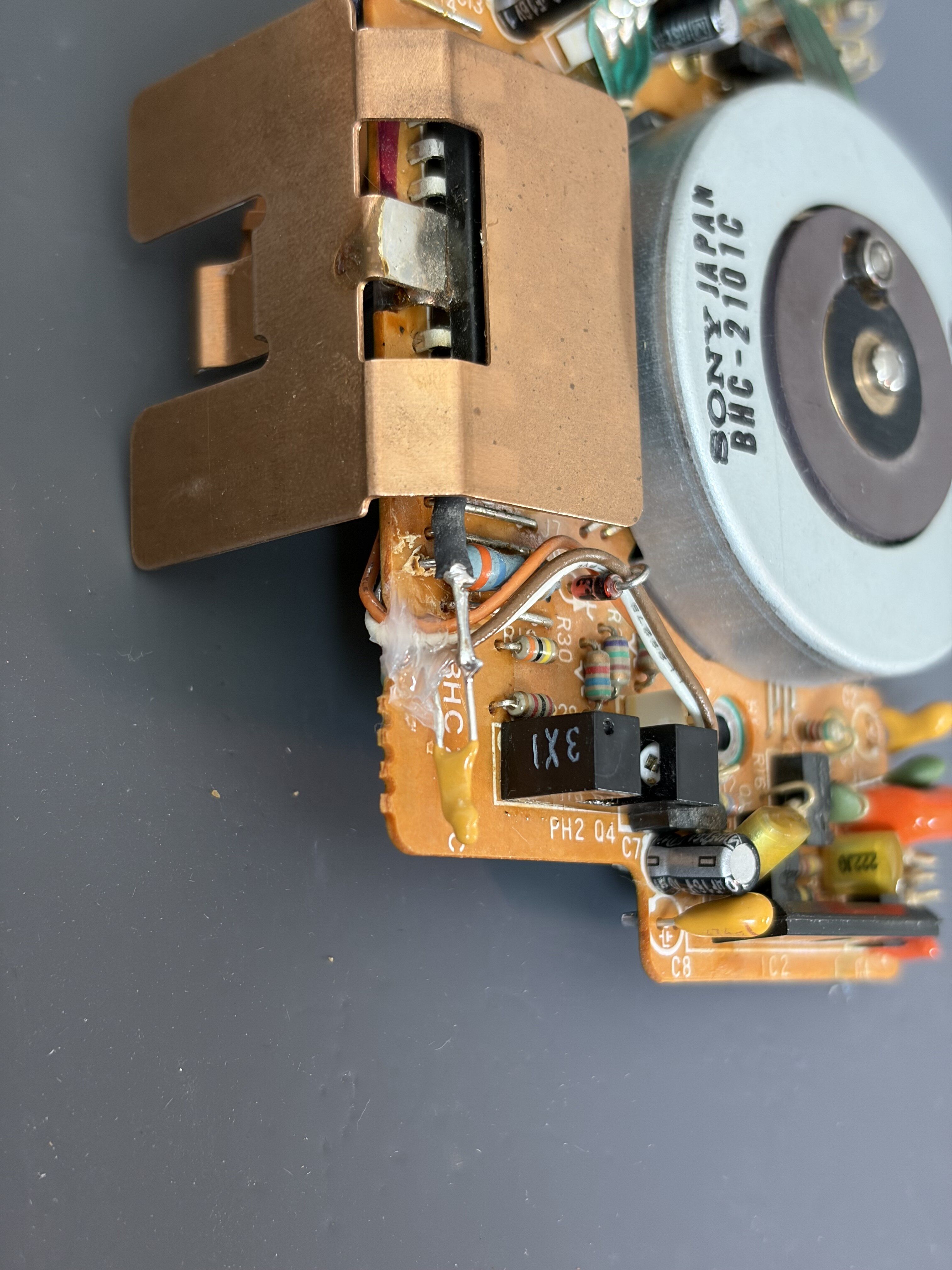

I decided to fix it by simply replacing the capacitor. I traced the PCB connections on the back in an effort to find a potential better location to install this capacitor, but nothing seemed suitable.
Step 1: Removal of the old capacitor. I used the heat gun to melt the glue and tried to scrape it off as best as I could.
Reconnected the negative lead to the back of the PCB
Step 3: I took off some of the heat shrink insolation and soldered the positive lead to it.
I’m not super happy with the exposed solder joint, nor with the fact that the leads are unusually long, as you pointed out.
It seems like the drive works well. I’ll live with it for now :)
2,745
2,144
I recommend you buy BONDIC and a UV Flashlight. Great for insulating exposed legs or even small cuts and gashes in cables too! Just squirt a little out all around the leg, then shine your UV light on it for 20-30 to ensure you get a good hard cure of the BONDIC.
Congratulations on your successful recap. Having a drive that works well was the goal, and it seems you succeeded! Bravo!
