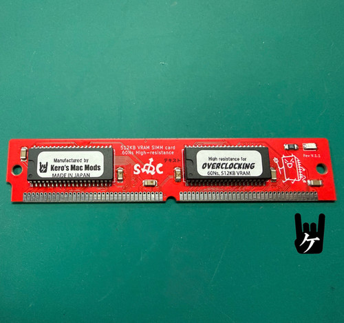

But 60ns VRAM for the Mystic is sold by other vendors as well, including @Kay K.M.Mods here:
There are other 60ns VRAM vendors as well. I just don’t have time right now to Google them all.

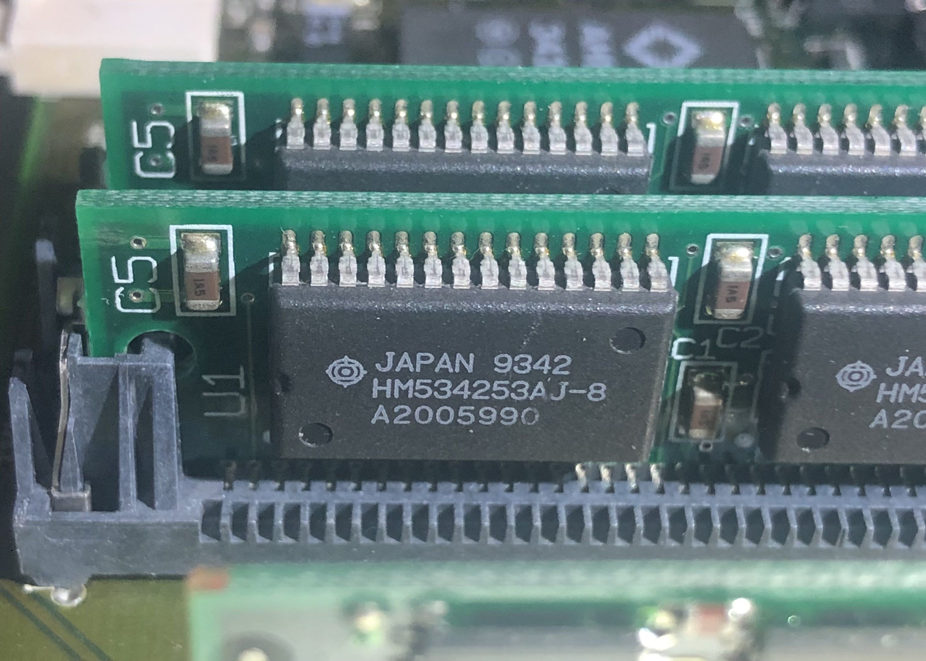

And as to identifying what speed VRAM you have right now, I would recommend shooting a clear photo of the markings on the chips and uploading that to this thread.
Here it is. These sticks are actually Apple branded, and dated 1991:

The -8 at the end shows they are the slow 80ns type, which is typical for stock VRAM in the LC575.
To get the most out of either Kay Koba's Spicy O'Clock or 475 OverClock, you need faster VRAM. Yes, there are the lazy folk who make due with slower overclocks because they don't want to buy faster VRAM, but I'd advise to avoid that mentality and just get the 60ns VRAM so you can remove that bottleneck and potentially have more fun. For me, it's not about 40MHz or 45MHz being "fast enough" but rather a matter of "how fast can this machine go!" Now, there's a difference between the fastest clockable speed and one that is stable for hours on end, but for the most part, I can reach 47MHz just fine and still boot into any compatible OS. I can even go to 49MHz and boot just fine into System 7.1 (ignoring 7.61 and OS 8.1). And for short periods, I can even use 50MHz. None of that fun would be possible with VRAM slower than 60ns.
Now, I have heard at least one person tell me (I think it was @phipli) who said they could reach 50MHz speeds without the need to use OS CON capacitors in their recap. But if memory serves me correctly, he has a 475, not a 575 like I do. When Kay Koba had solid tantalum caps on his 575, he wasn't able to reach 50MHz speeds. I then came along and decided to use lower ESR OS CON caps on my 575 motherboard and I was able to reach 50MHz. I told Kay about that, then he replaced his solid tantalums with OS CON, and then he too (with the aid of fast VRAM) was able to reach 50MHz. So all this means is that if 60ns VRAM alone doesn't get you to higher clocks, you need to consider the capacitors on the motherboard.
Of course, not every 040 is able to overclock to 50MHz, especially the ones made for 25MHz operation. But in my testing I found that the LC edition 040's, without any FPU, tend to overclock lower than the 040's with an FPU. Maybe that's a fluke in my testing, but I can't test anything outside what I own. I'm just reporting it. And the higher the clock rating of the 040 processor, the more likely you will be to hit 50MHz in your overclocks.
Then you need to heatsink and possibly fan to ensure you can maintain your overclocks.
Hope this helps!
