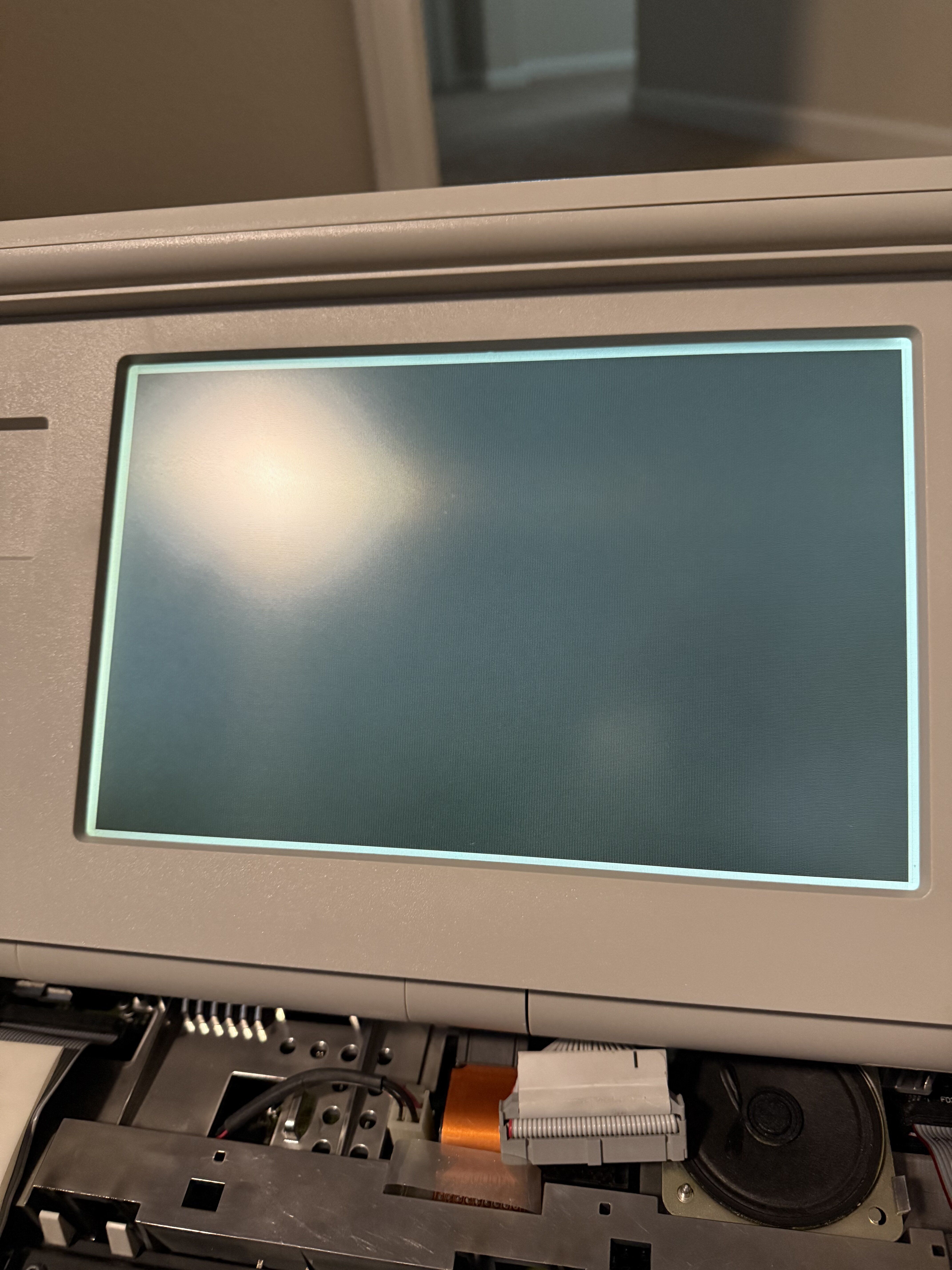

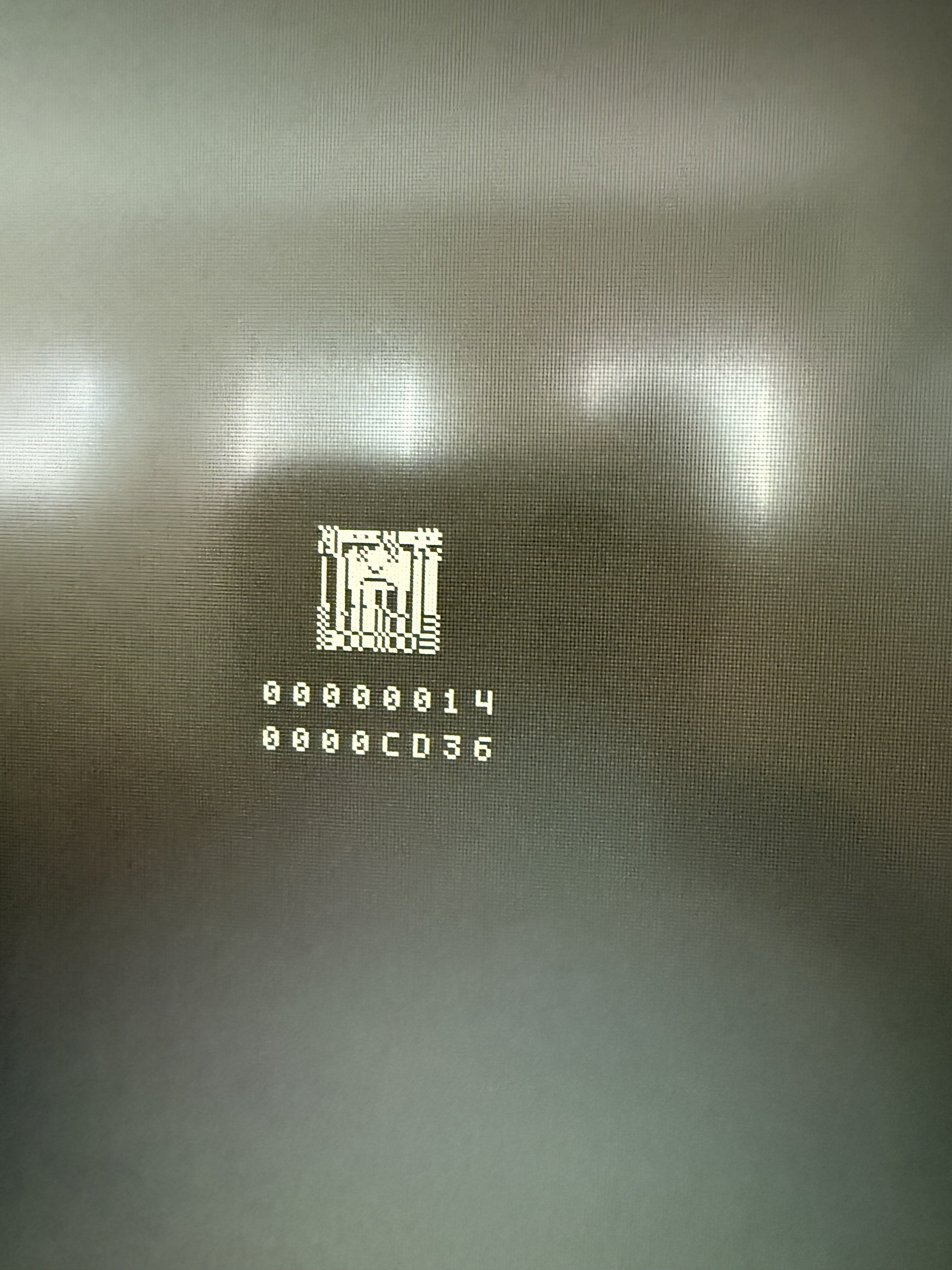

I have been working on my Mac Portable 5126 for a while. I built and new battery, recapped it, and it worked for one boot. Put it back together and I started getting power manager errors. Looked for broken traces and found a couple. Repaired them with bodge wires and….now only get a black screen with a white border.
I am pretty sure I have the broken traces correct but who knows. I’m pretty novice when it comes to this kind of repair. I saw someone had the schematics in Kicad, but I couldn’t figure out how to actually get it to show the traces. I’m stuck!
