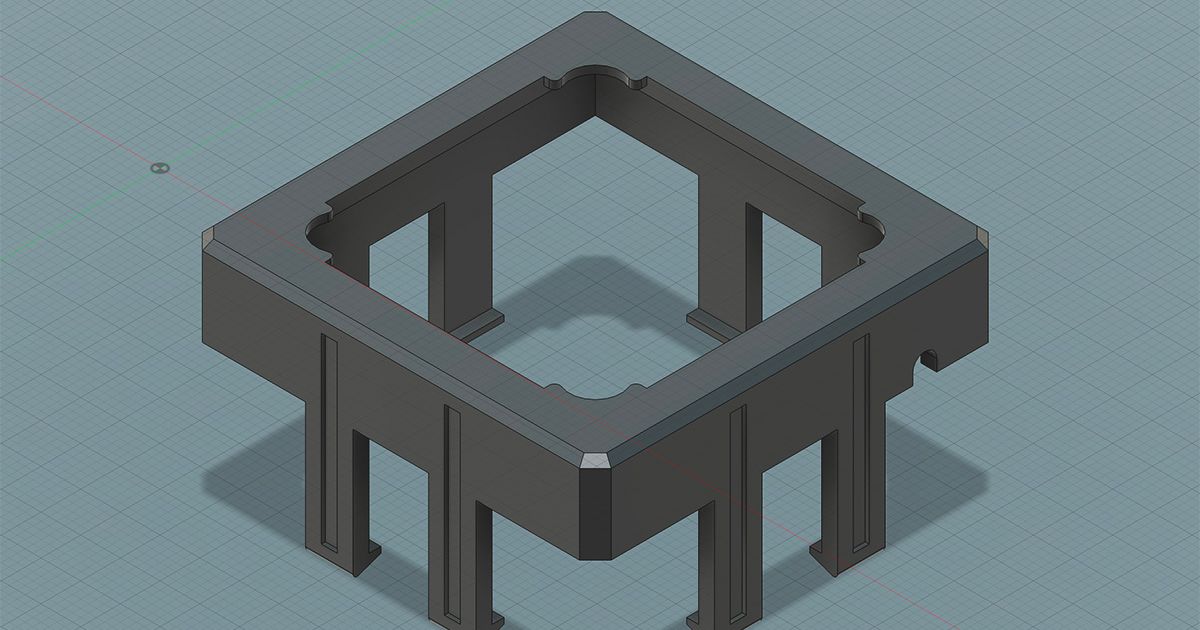

Forum member @jmacz and I have been exchanging PMs for a couple months, and he recently very graciously mailed me a few prints made with PAHT-CF — a carbon fiber enhanced filament. He offers 10mm & 11mm height versions of the clip on his Printables page here:

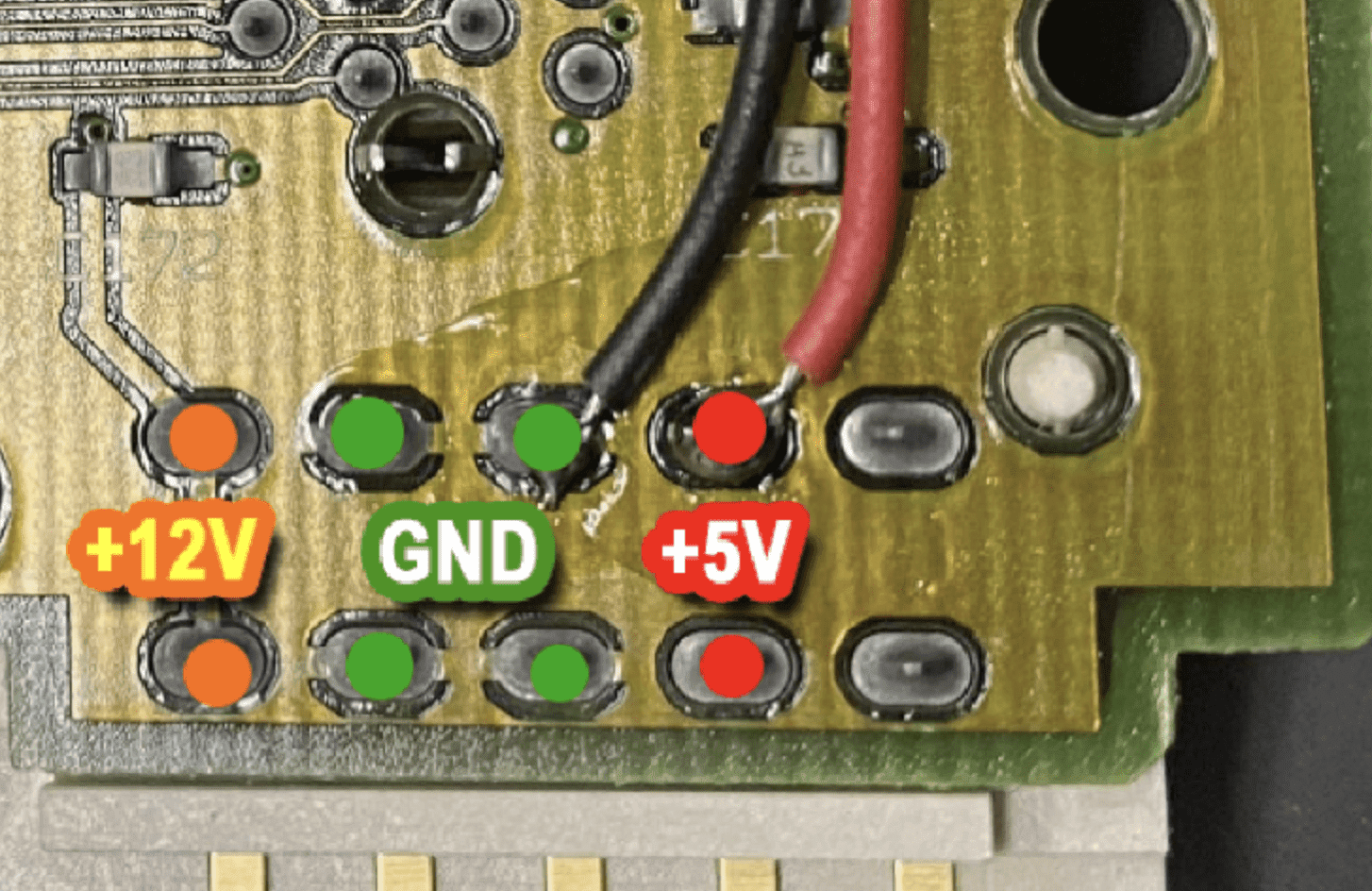

I tap power for the fan on the underside of the LC575 board at the +12v and GND points shown below (ignore the RED wire in the photo because you should connect it to the +12v point marked in Orange).

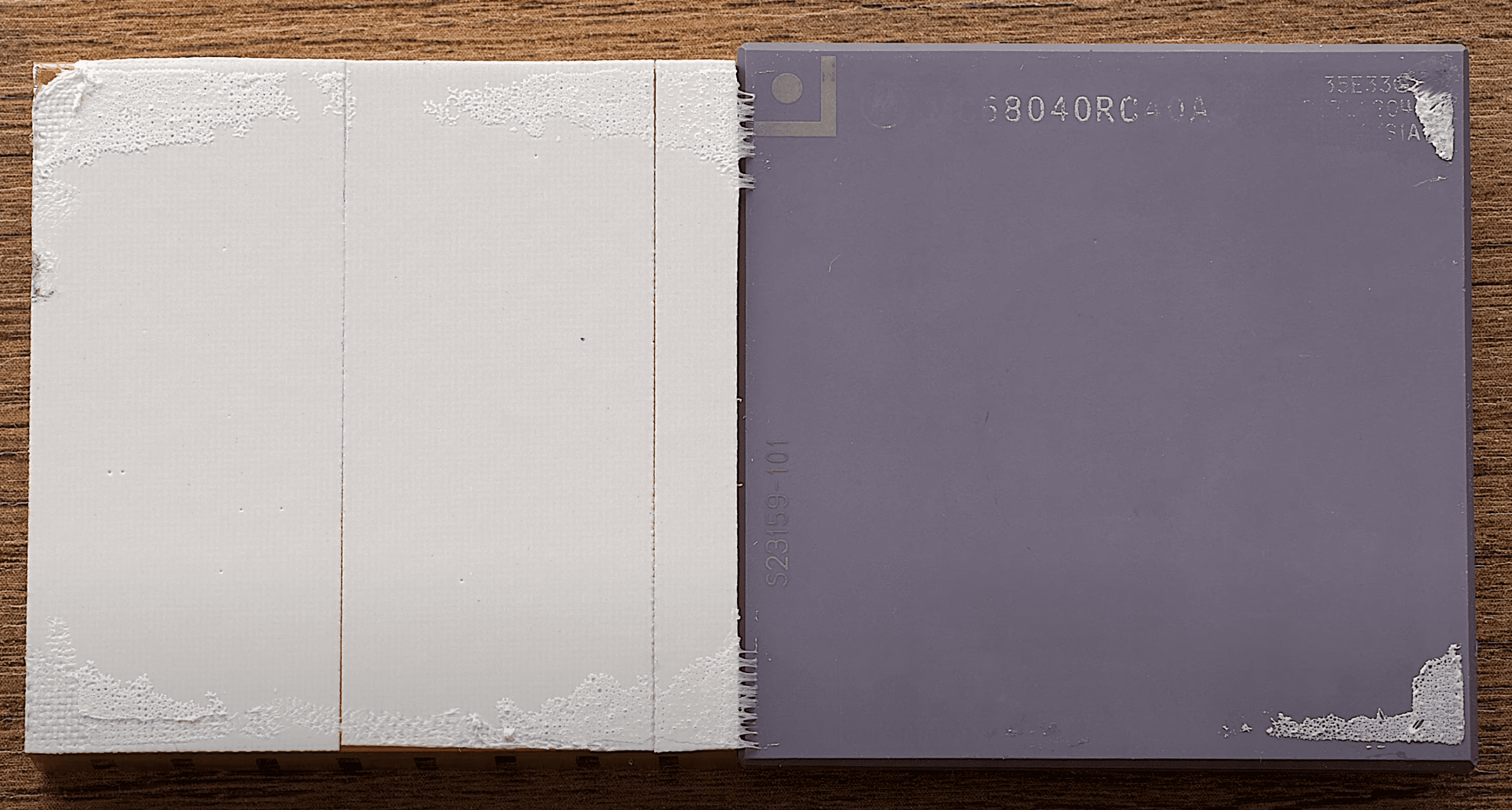

Another disadvantage of using Thermal Tape is that the top of the CPU and/or bottom of your heatsink may not be perfectly flat, resulting in only some of the tape making contact. I know that from first hand experience, as you can see below.
Using Thermal PASTE will resolve issues like that. I demonstrate thermal paste spreading on a 68040 processor using a transparent lens in my video here.

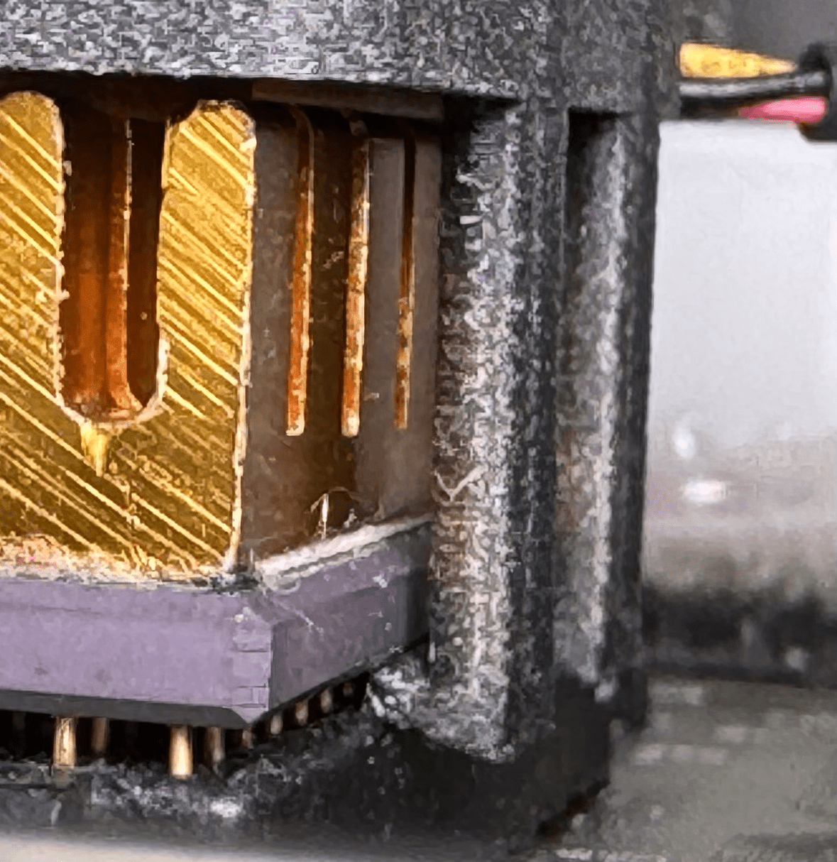

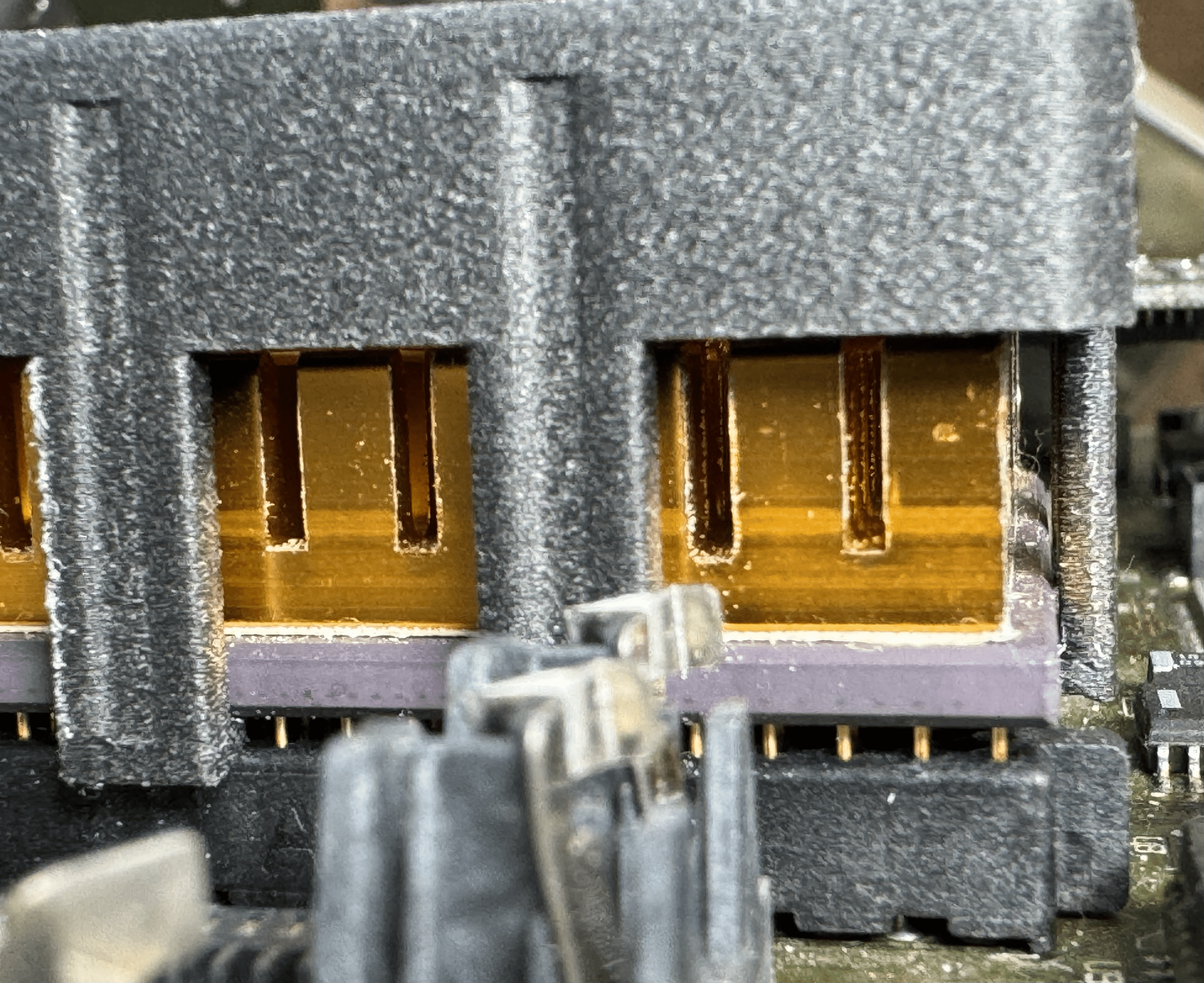

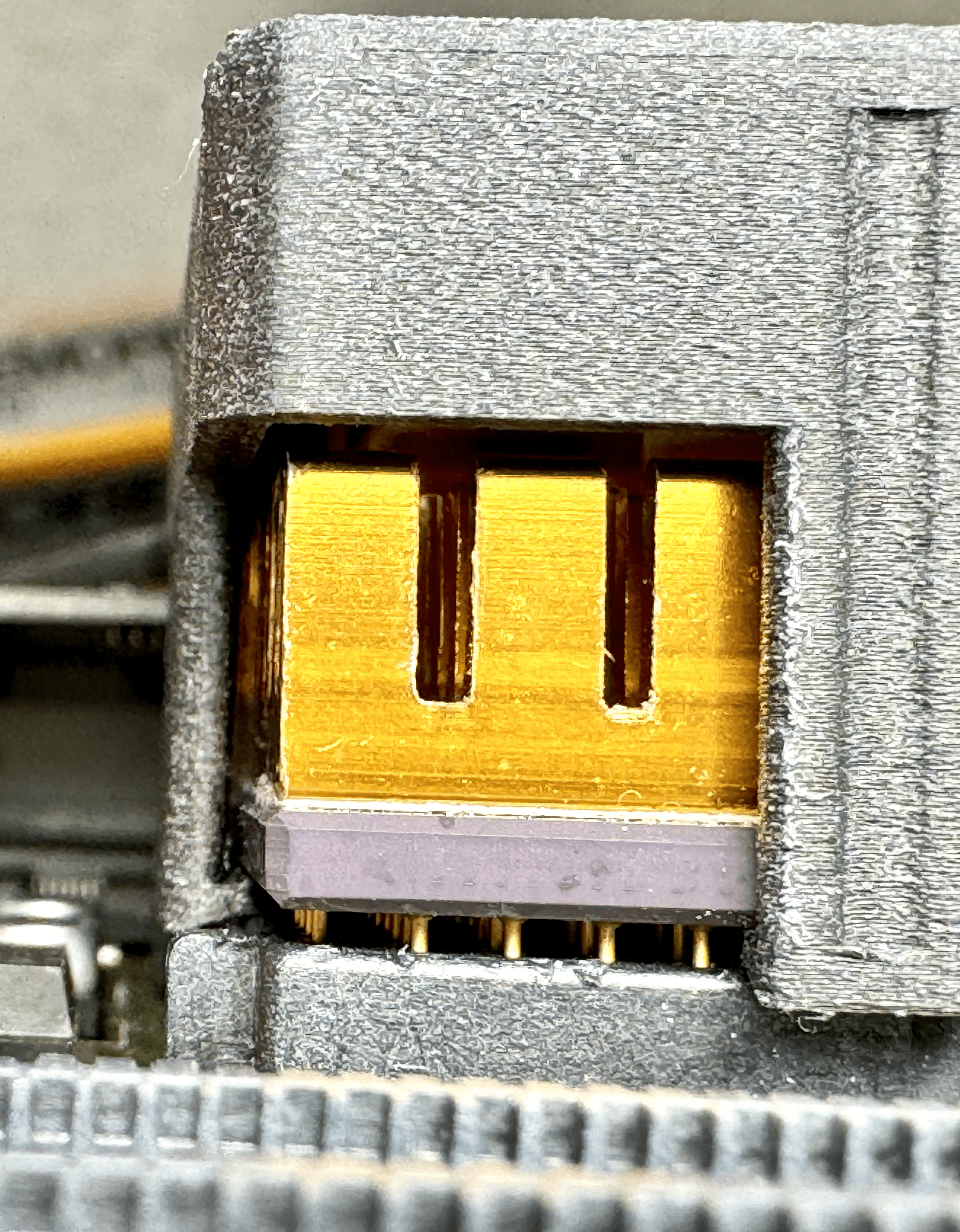

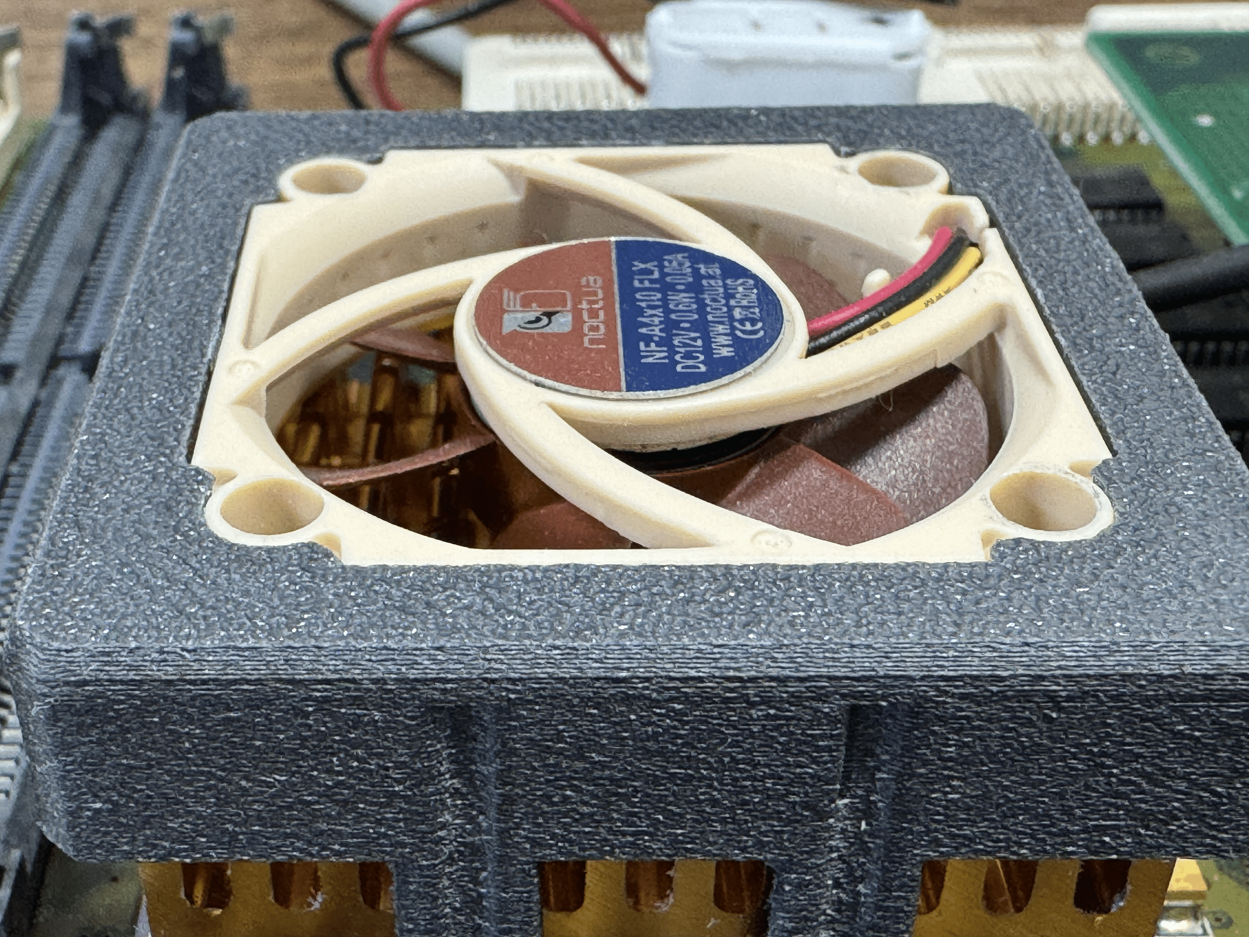

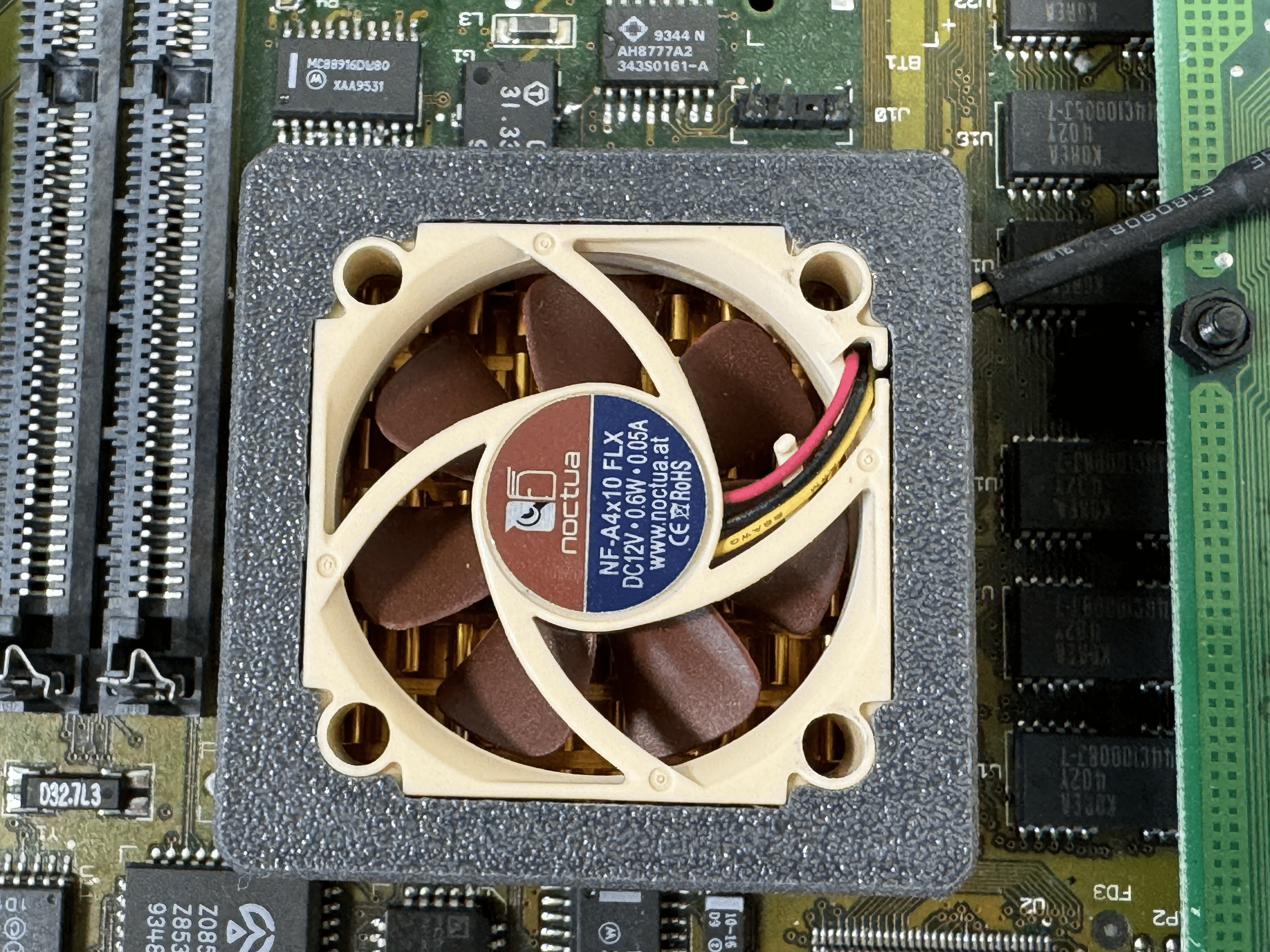

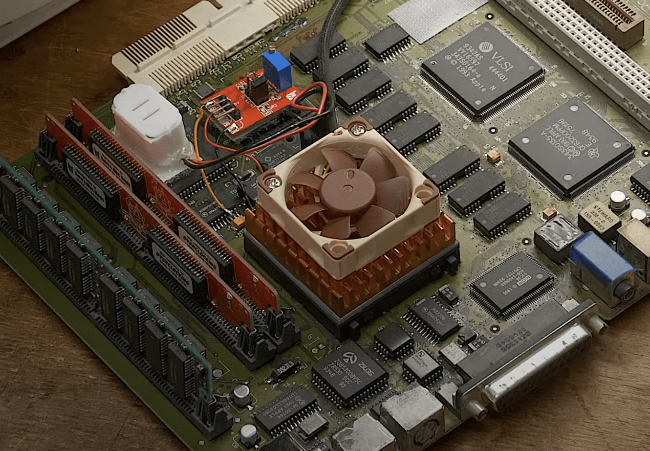

As you can see in the photos below, I now have the clip by @jmacz mounted with the fan blowing straight up, which pulls cool air through the heatsink fins...
Note that you must remove the tiny rubber parts at each of the 4 corners on the sticker side of the fan so that those 4 corners will sink nicely into the clip, as shown in the above photos. There are also 4 pieces of rubber at each corner on the back side of the fan too, but I was able to leave those in place. They touch the heatsink fins, but that wasn't a problem.

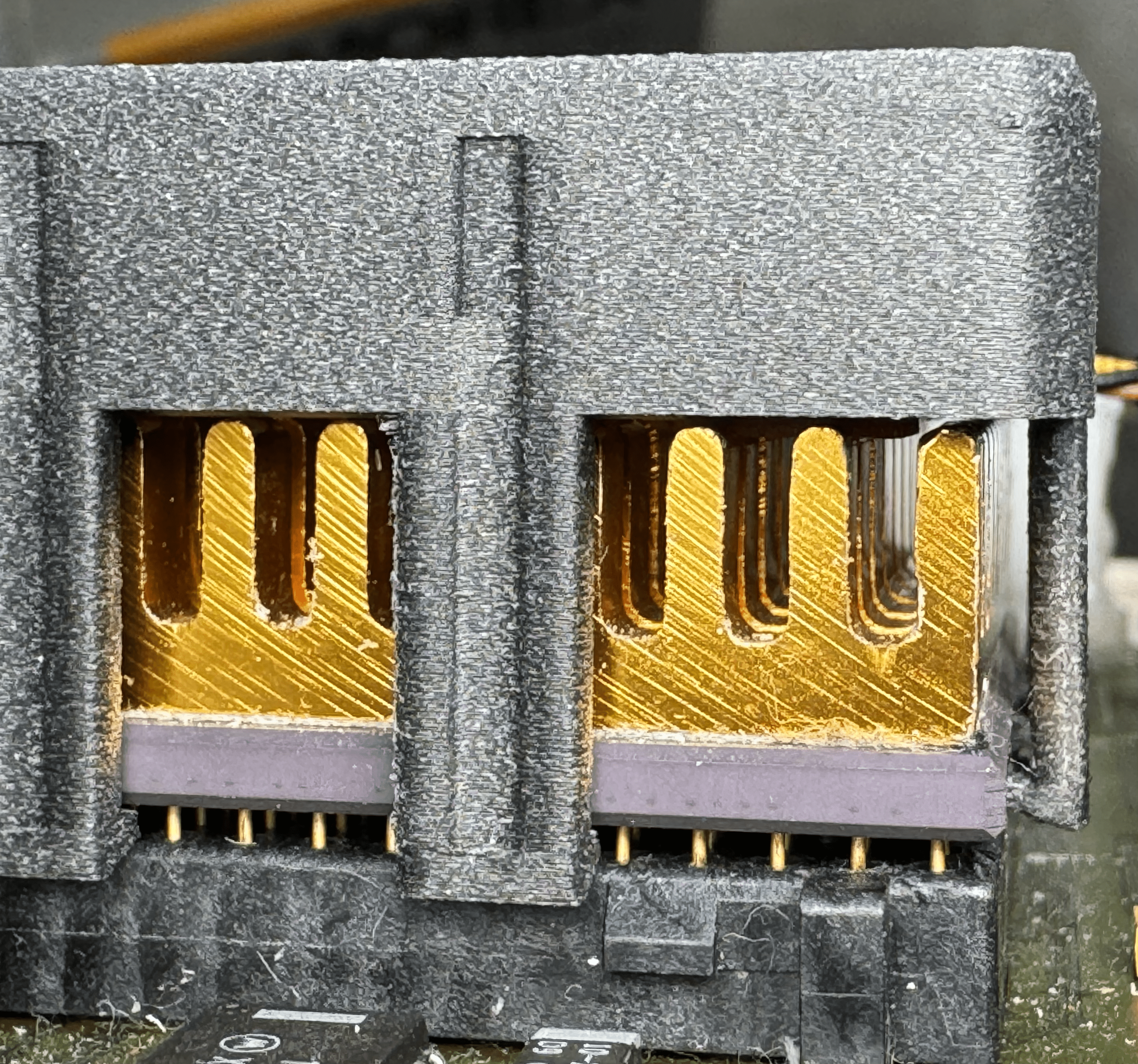

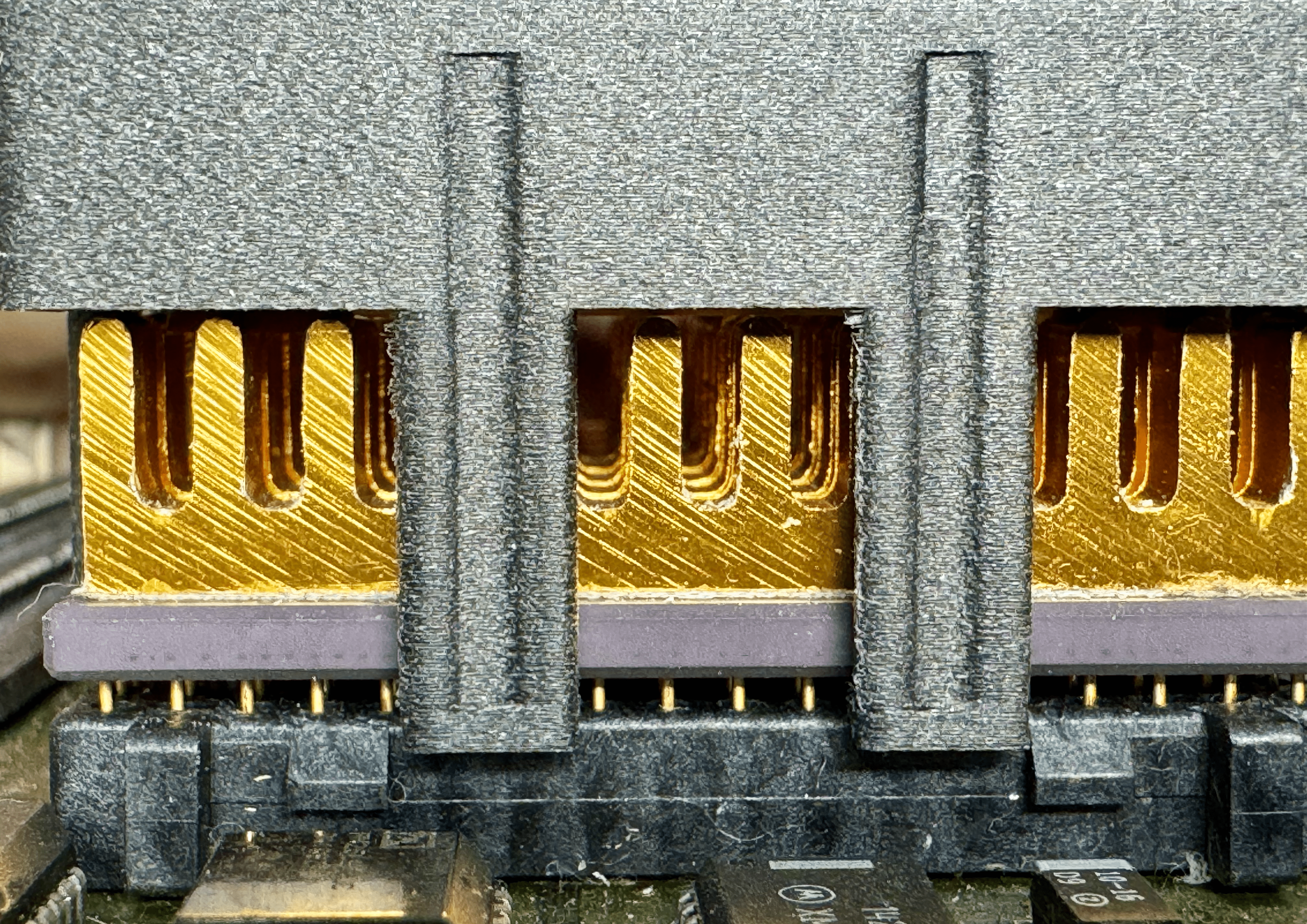

At first, the clip wouldn't take hold on the underside of the lip around the 040 CPU, but I then very slightly pried the CPU up from its socket about 1mm, which allowed the little tooth on each leg of the clip to slide under the lip of the CPU, as you can see...
Even though it's pried up about 1mm, the 040 CPU is still nicely secured to the socket and works fine.

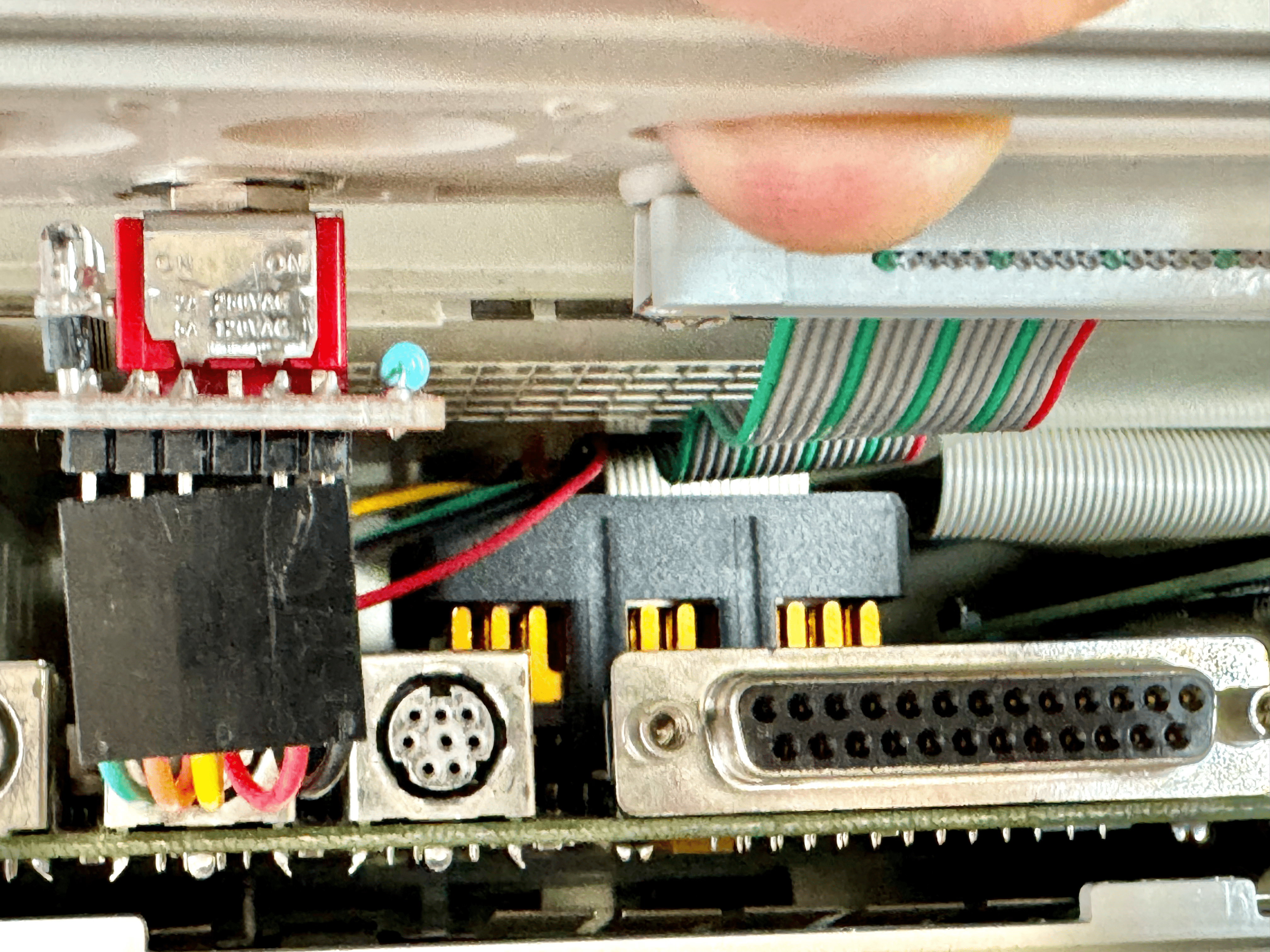

Note that I also have Kay Koba's FlippyFloppy installed, which allows me to use a FloppyEMU with my Mystic — something that otherwise would be impossible. And although there is a floppy drive ribbon cable that comes to the custom back panel, there is enough clearance above the heatsink clip to accommodate it, and there is still sufficient airflow up and out...

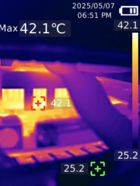

Without the fan, I was getting between 56°C and 58°C, but with the 40mm Noctua fan I measure a much cooler 42°C...

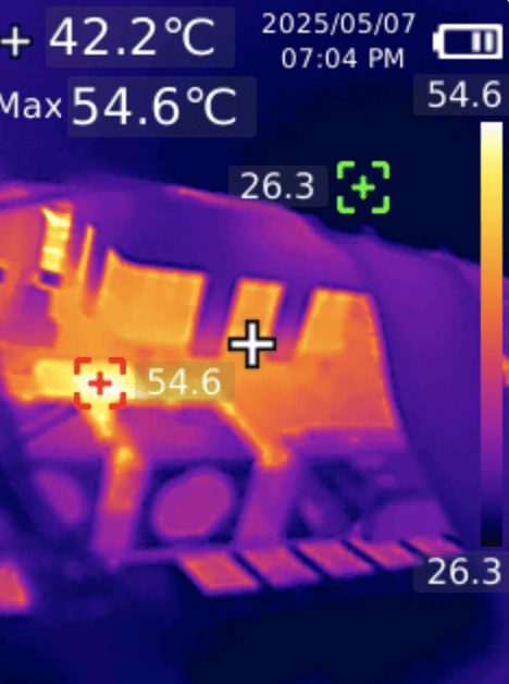

In the image below, you can see that surrounding chips are now hotter (54.6°C) than the CPU (42.2°C), even though I have the CPU overclocked to 50MHz (using the 475 Overclock Control Strip) and left it running for over 1 hour...
The 40mm fan noise is inaudible because the 80mm Noctua case fan is louder. I could not detect any serious vibrations either when holding my finger on the clip during normal operation.
Note that I originally had the clip printed at JLCPCB in Nylon, but I found the legs were not perfectly straight and they are more bendable than the carbon fiber reinforced version @jmacz kindly made for me, so the JLC version simply wouldn't clip down as expected. It needs to be printed in something firmer. @jmacz is not selling the clips, so you would either need to use JLC to print them in PLA or a similarly stiff plastic, or print them yourself. The caveat to that is that, in my experience, PLA prints are much more expensive than Nylon or Resin at JLC. You have to take care with Resin though because a lot of that stuff isn't suited for higher temperature use, although if you are able to get your temps down as low as my 42°C, it won't matter.

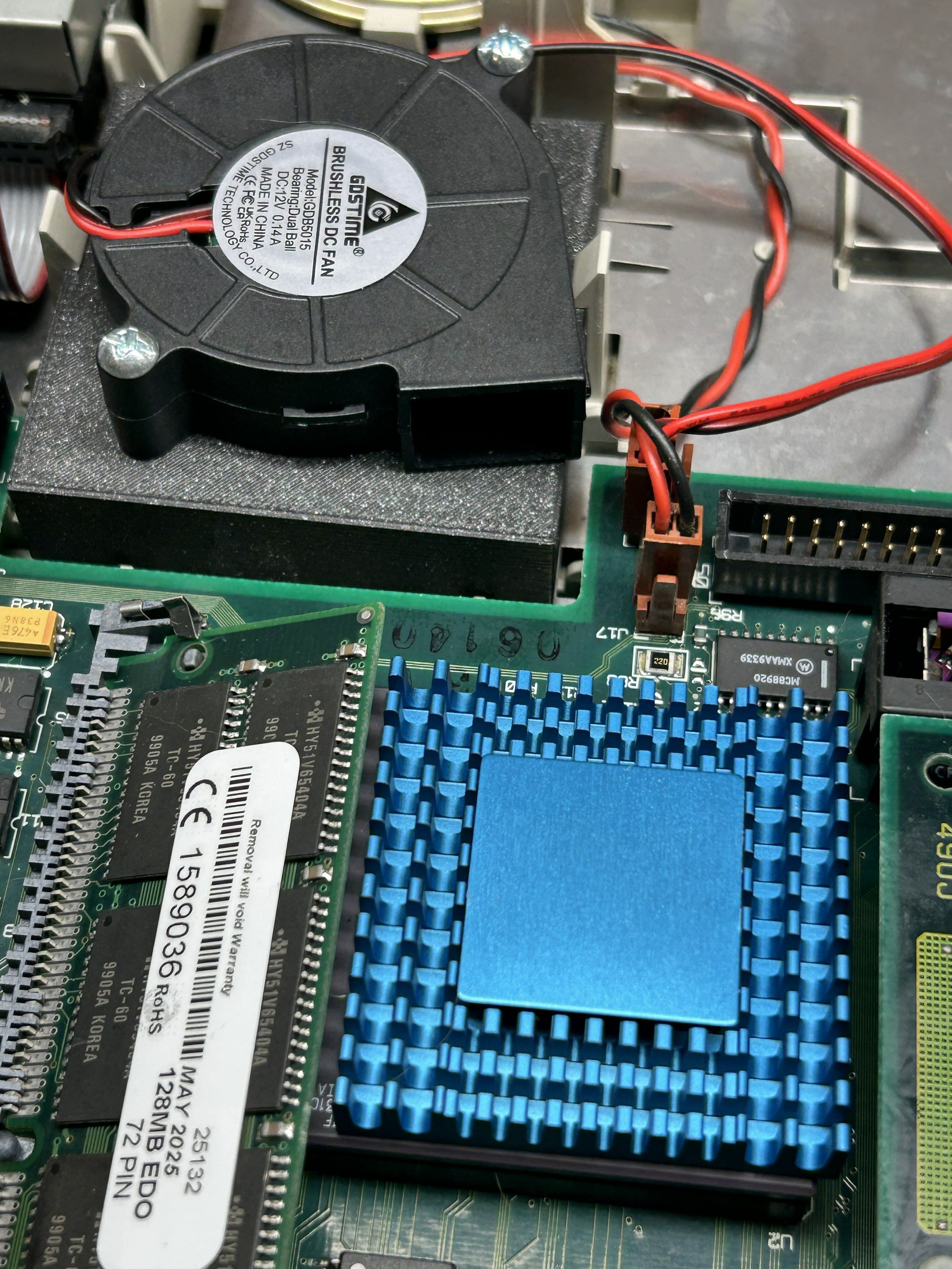

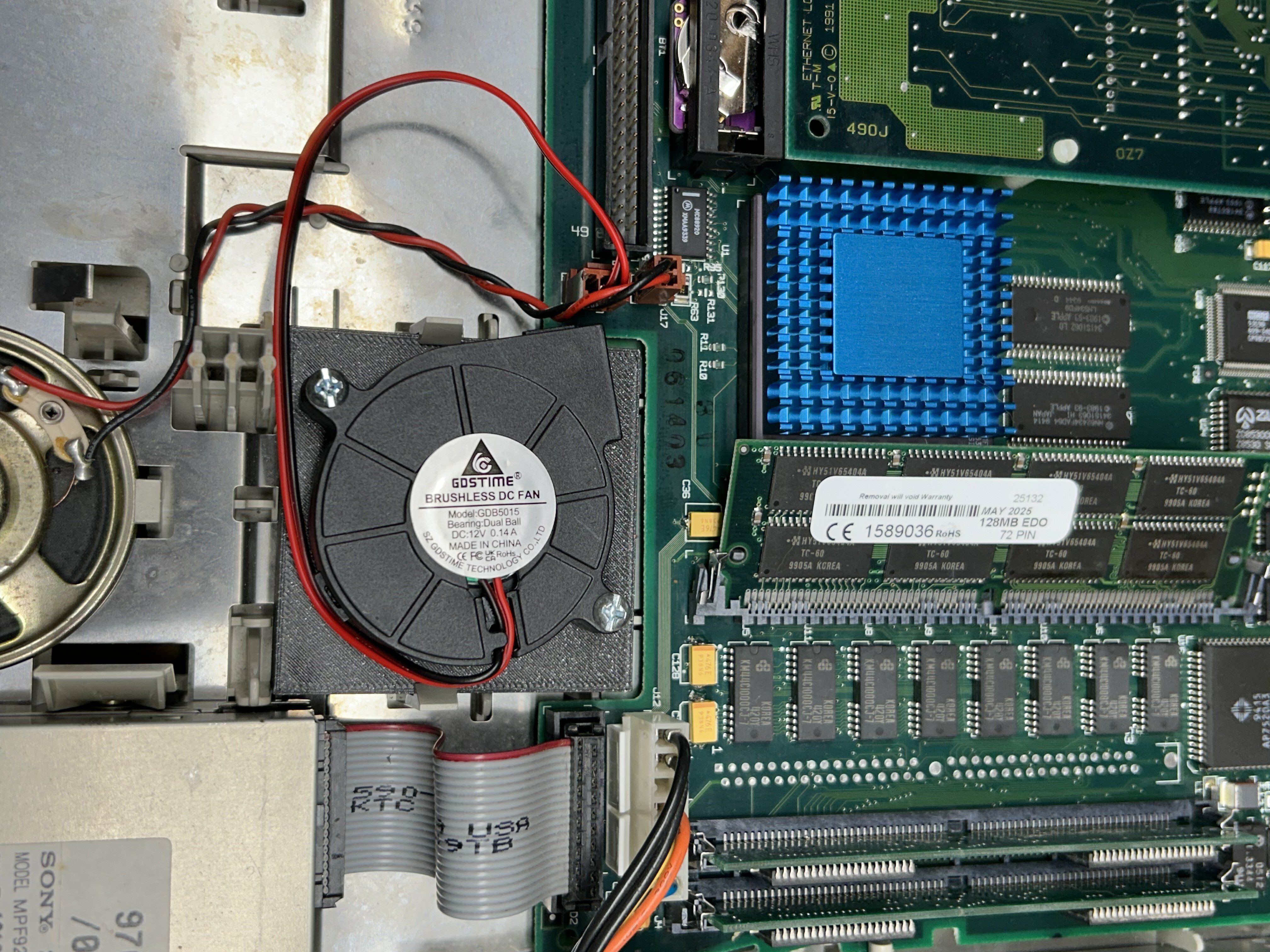

I need a fan solution that fits in an LC case - very restricted height. A fan placed directly on the heatsink has insufficient vertical clearance to move any air, so somehow it would need to be off the side at an angle. The standard fan does not move enough air to do the job. It really needs more direct air flow. Has anyone seen a 3d printable design for LCs?
jmacz
Mar 21, 2025
98
Something like this wouldn't work?
Essentially 90 degree fans like what are used inside laptops.

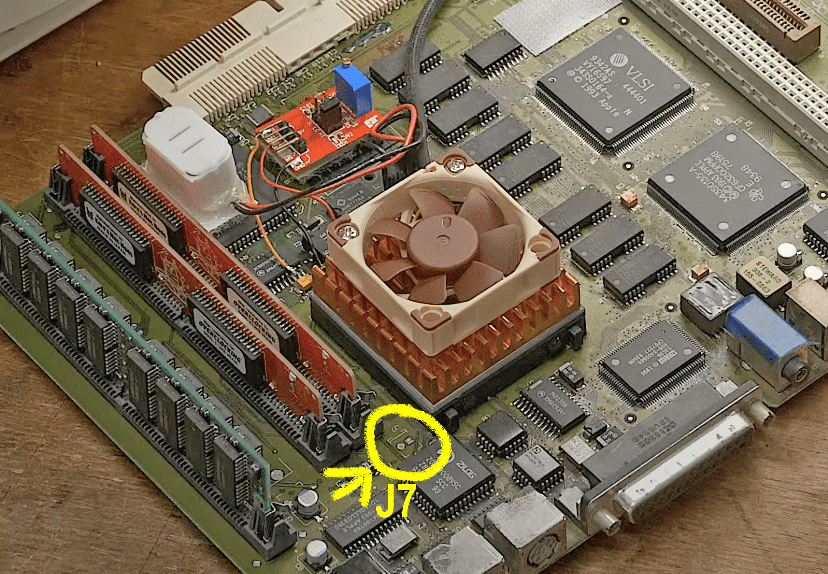

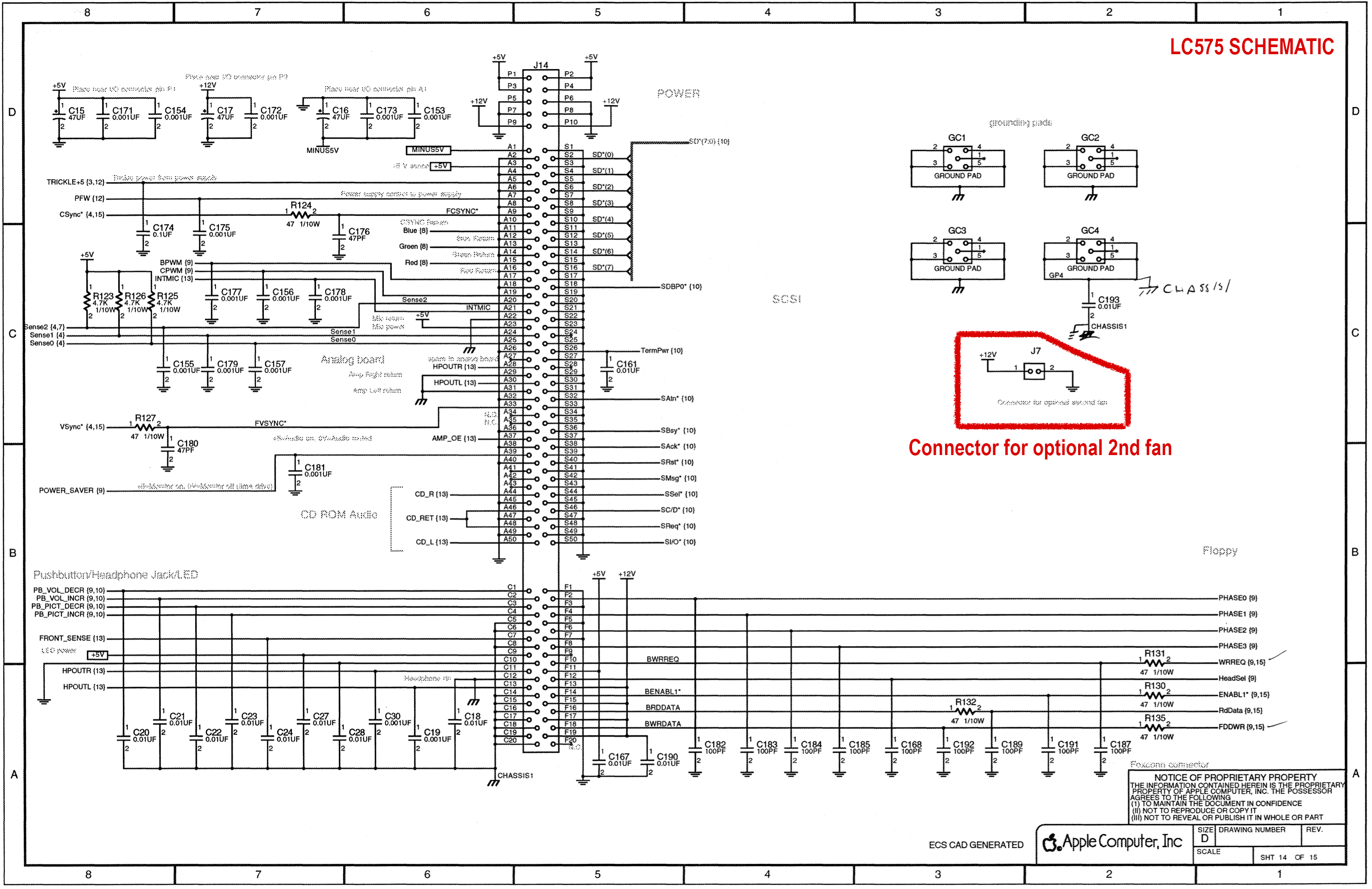

Just wanted to updated this thread to say that an alternative source of +12V power for a CPU FAN has come to my attention. It was right in front of our eyes the whole time...
a
The LC575 schematic mentions it here:
I've not used J7 yet, but it would eliminate the need to run wires to the opposite side of the motherboard.
