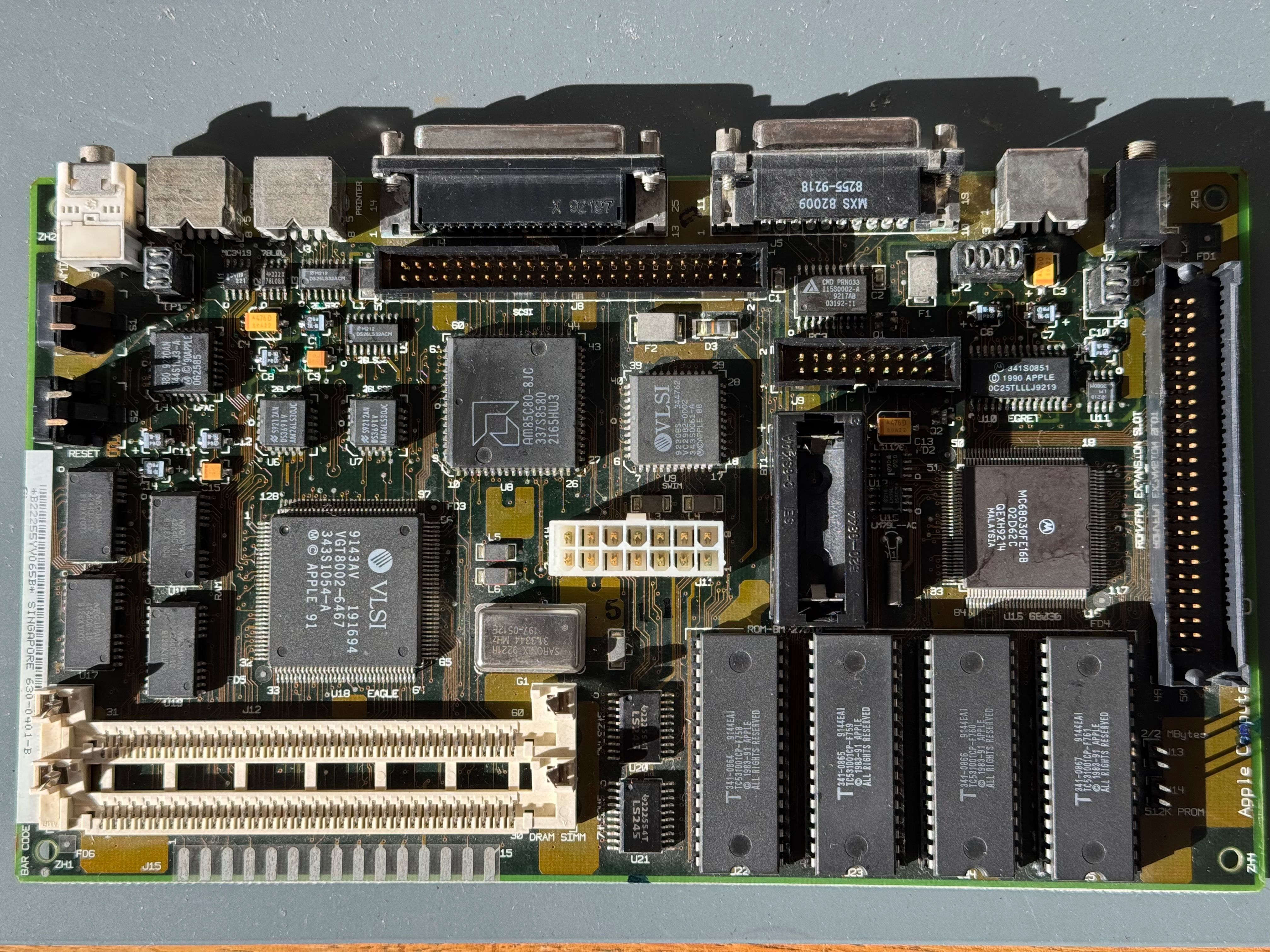

That brought me to the logic board. After I removed to caps with hot air, the board looked like so:
042AA017-EF8A-4672-8239-5CC4A05CAD08_1_201_a.heic
There was some mask/trace damage from leakage around C4/C5 and C8/C9. I beeped out the suspect traces and all seemed good so I cleaned them up and applied solder mask (see later). Soldering new caps yielded:
