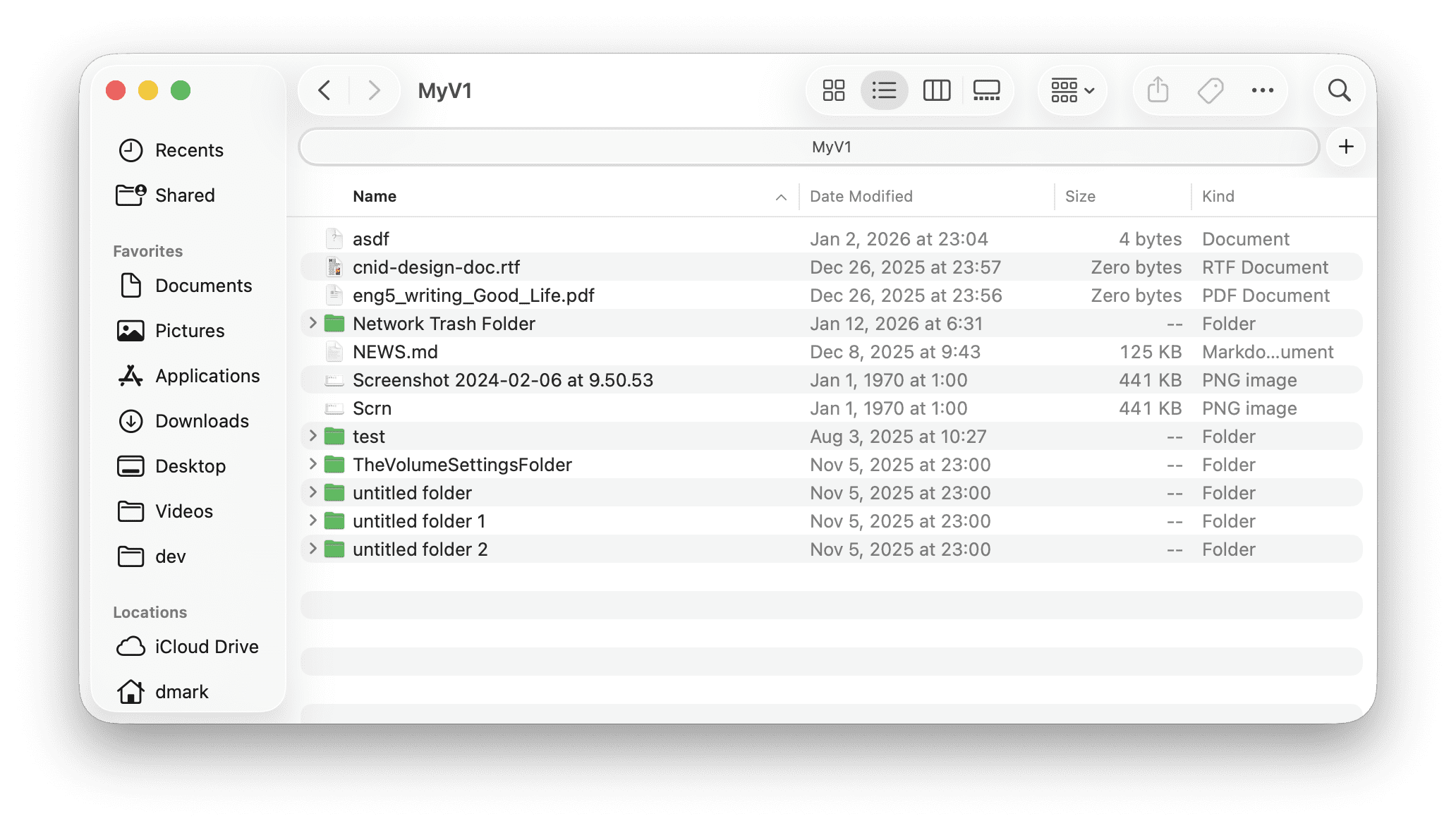

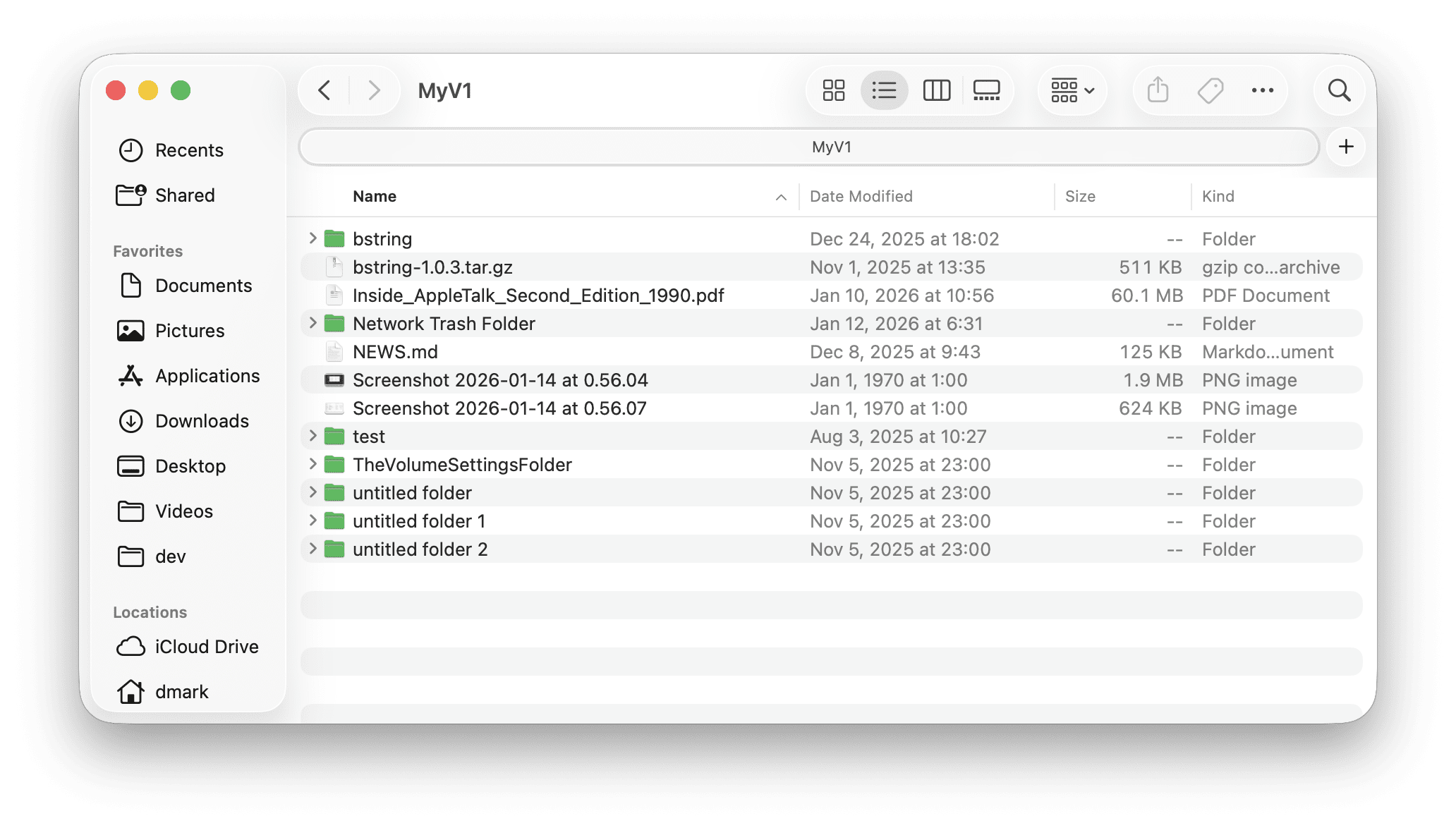

My fork of afpfs-ng can now be considered more or less stable. The other day, the macFUSE maintainer kindly fixed a bug that enabled macOS xattr to be copied to and from AFP volumes mounted with macFUSE. You must use macFUSE v5.1.3 or later otherwise the Finder will throw errors when it sees that it cannot write xattr when copying files to the AFP volume.
The only piece missing to reach near-parity with the Apple AFP client is the ability to read com.apple.ResourceFork xattr. It's a very special Apple hack to xattr since resource forks are typically much larger than what is allowed
Moments ago I tagged afpfs-ng v0.9.2. Would love to get some testing and feedback!
And yes, I decided to move the fork under the netatalk project. Having a "reference" AFP client implementation is in the project's best interests. :)

The HFS MacFUSE file system would be a good starting point to see how to natively integrate resource forks and FinderInfo into the macOS port of afpfs_ng.
Other platforms shouldn't attempt to do this. The existing method of throwing the resource fork and FinderInfo into an AppleDouble folder should remain.
