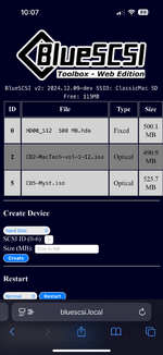

Have you ever wanted to modify settings, create drives, or see what your BlueSCSI was doing but it’s installed in your retro computer and you don’t want to grab it out? Well have I got the solution for you!
Welcome the 9th(!) platform to our BlueSCSI Toolbox lineup – Web!
screenshot-2024-12-30-at-10-06-52-am-png.19125
Desktop & iPhone screen shot
The BlueSCSI Toolbox – Web Edition provides you a similar experience to how PiSCSI’s web works – allowing you to interface with your BlueSCSI over Wi-Fi and make changes to how your BlueSCSI works and is configured. You can do things like:
  • Eject CDs and other Removable devices
  • Create blank devices
  • View the log file
  • Turn on or off features like debugging
  • Restart or reload settings
  • Edit and save back the ini file
  • And a lot more!
The details:
BlueSCSI Toolbox – Web works by using a “Control” Pico-W to run and host the website and issue commands over the qwiic(i2c) bus. Hosting this on a second Pico was required as serving websites while time critical SCSI commands are executing would be problematic!
Open a website and browse to http://bluescsi.local from your phone, modern, (or retro!) computer and take control of your BlueSCSI.
