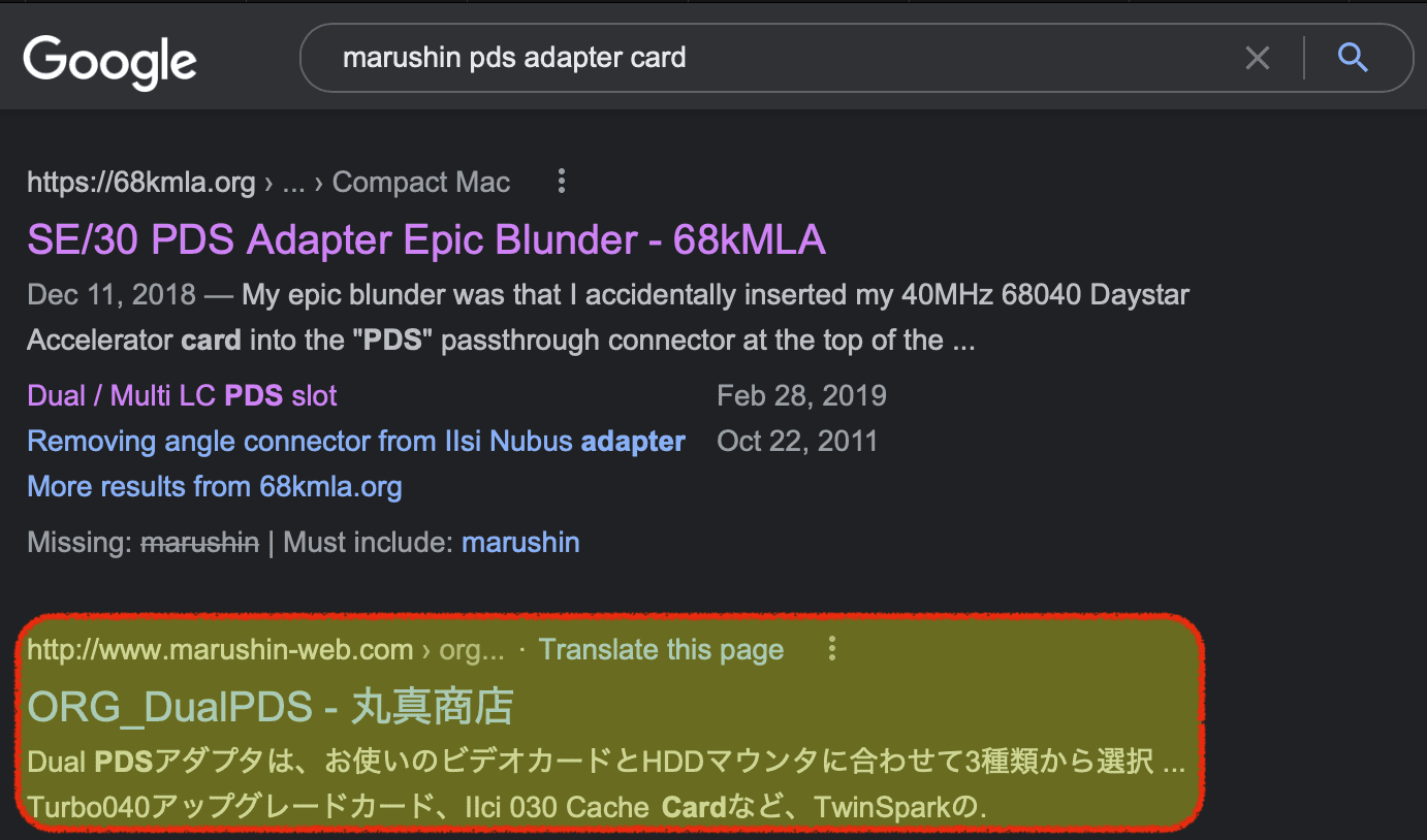

Searched with Google "marushin pds adapter card" and apparently it lists the following web page that explains more about this PDS adapter. However, the page is not coming up.

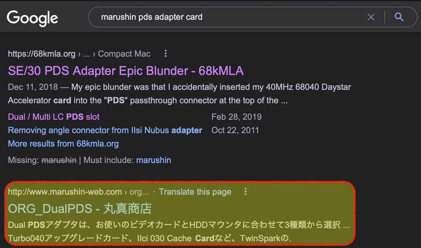

It's for the 120-pin SE/30 PDS slot. The seller's direct web page I found in the screenshot of Google results posted above may have other PDS adapter cards.
@JDW or @Kay K.M.Mods, can you bring up that marushin web page?

*shrugs* Google must have thought the first result was related. I was looking for a web page that may belong to the seller, which might be the second result I circled and highlighted in that screenshot.
Here's the rough Google Translation of that web page (except graphics, of course):
Kay Koba has long told me that the market for vintage Mac stuff is quite large outside Japan, so it is not in the best interest of the gentleman who created those products to not also have a dedicated English page. Due to the current pricing structure and profits sought, it's probably difficult for the seller to do cooperation with Kay, although if Kay did pitch the item in English it would definitely have a positive impact on sales.

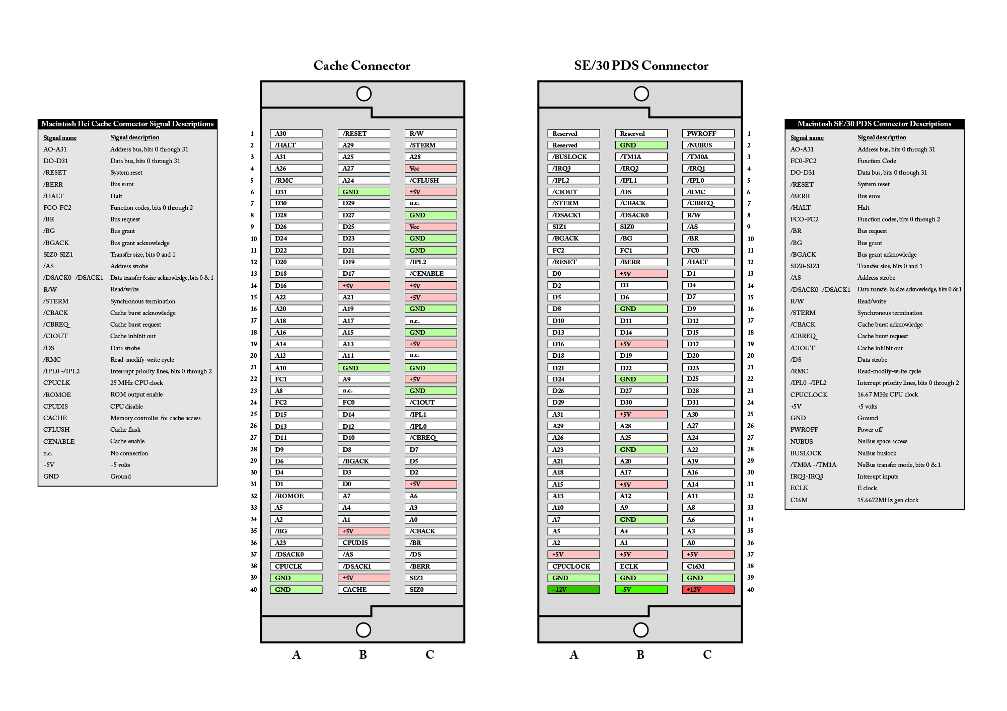

And just to be clear (for those who don't like to read the entire Google translation of the product page, this is a PDS splitter. You get 2 PDS slots instead of one. The TS Adapter and the TS Adapter clone from Bolle (which has added functionality) is not the same in that they offer 1PDS connector (pass-thru) and then a very different connector called "Cache" for accelerator cards which require it. Not all accelerators need the cache slot, such as the DiiMO card which is made for the SE/30 and which plugs directly into the PDS slot (or PDS pass-thru).
Plugging a "Cache" type accelerator card (i.e., one not originally made for the SE/30) into the PDS slot will kill the accelerator. I know this all too well because I accidentally plugged my precious Daystar Turbo040 into the topmost PDS pass-thru slot in the past and it died. More specifically, the big ASIC chip on the card was fried. Amazingly, Joethezombie at the other forum was able to find a batch of Daystar ASIC chips, and he sent some off to Bolle in Germany. I sent my dead Turbo040 to Bolle. Bolle swapped the ASIC chip and tested, and everything was fixed! Simply amazing.
Point learned: never connect an accelerator into the PDS slot or adapter's pass thru-PDS slot unless it's a DiiMO or similar made specifically for connecting to PDS. Cards like the Turbo040 must be connected to the Cache slot (the one that makes the card jut out to the side), and note the dual-PDS adapter card we are discussing in this thread is NOT that type because both the top and side connectors are PDS -- it does NOT have any Cache connectors on it at all.
If the PDS and Cache connectors were keyed and of different types, none of this would matter. But sadly there are the same, so you must be very, very careful.

Here is why plugging a cache card into a PDS slot is a bad idea…
The entire story is in my old thread…
Nice pinout comparison between the cache connector in the IIci and the PDS connector in the SE/30! :) I saved it since I have an IIci and SE/30. Thank you.
And that makes sense how the wrong connector could mess up and fry something.
Wow. I am glad you were able to get your Daystar fixed. :)
