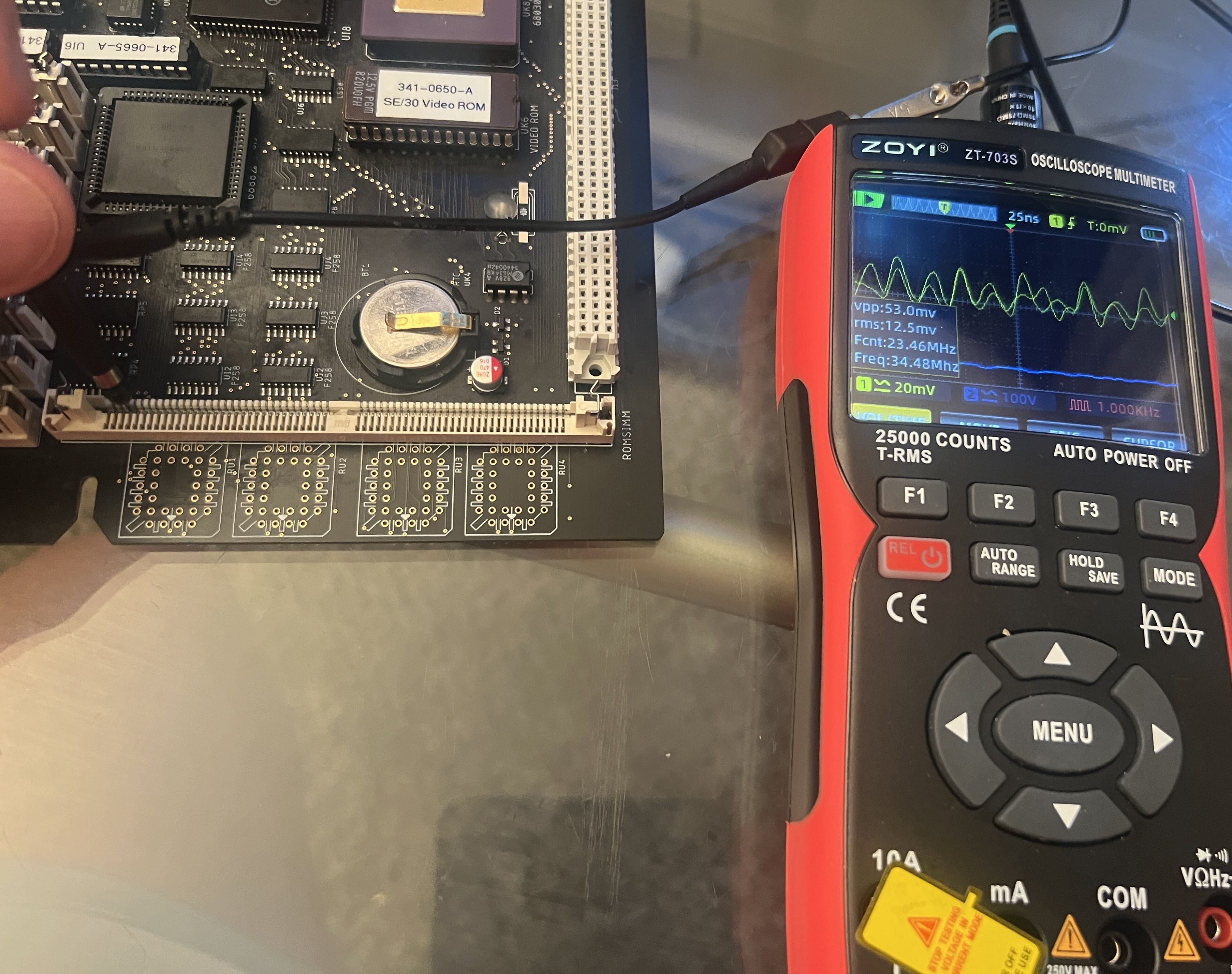

now grounding the scope on pin 38 of the PDS slot for a shorter ground cable. No difference really.

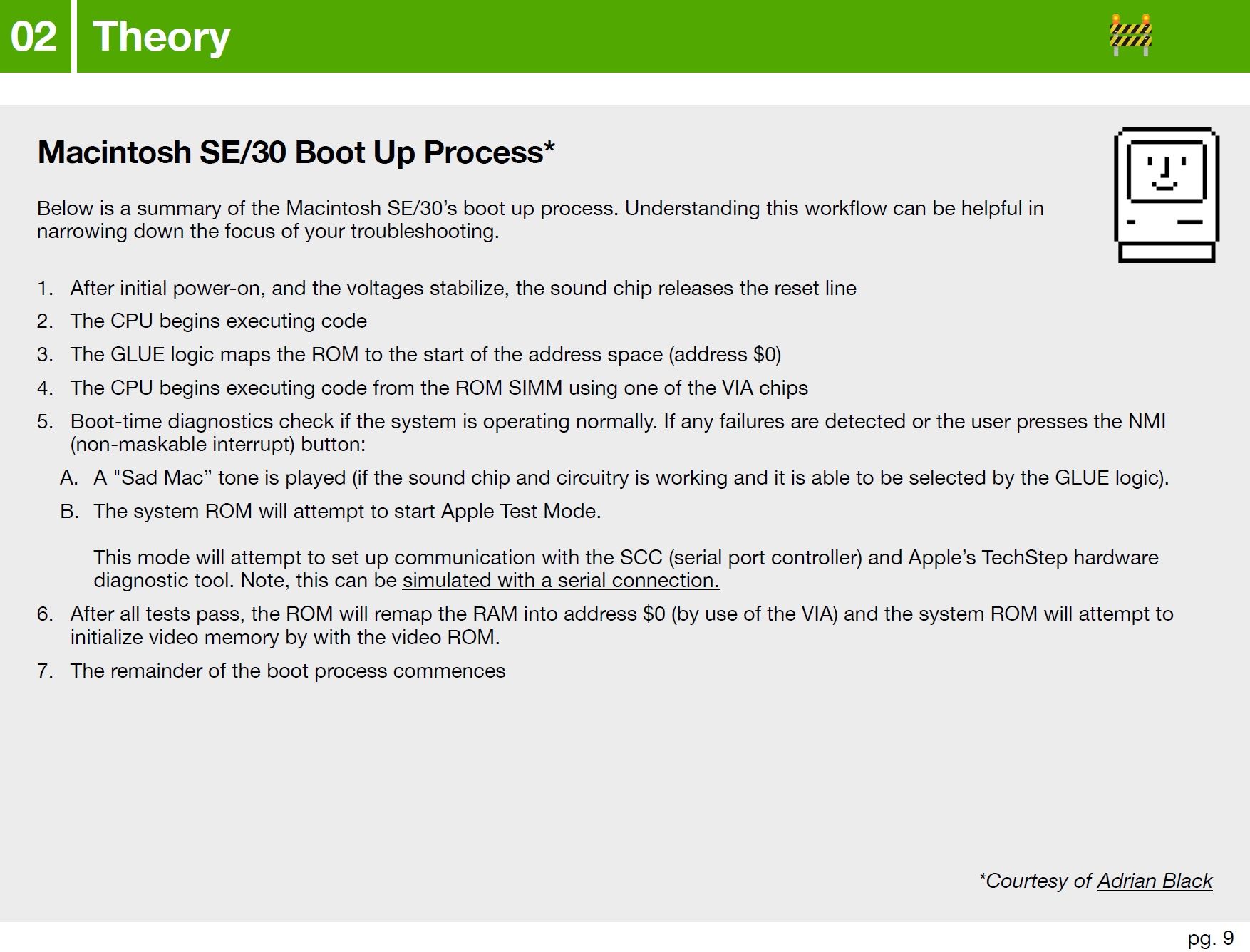

The NMI switch has no effect but it does go to pin 9 on the GLUE and pin 1 of RP8... can see the voltage drop at all positions when I push the switch, it has absolutely no effect and no sound on the system.

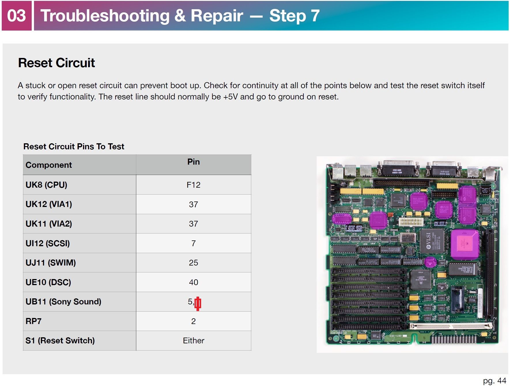

The reset switch and circuit seems to be working at all points.
5 V rail off the power supply reads 5 V but into most chips it reads around 3.9 v . I guess that's normal?

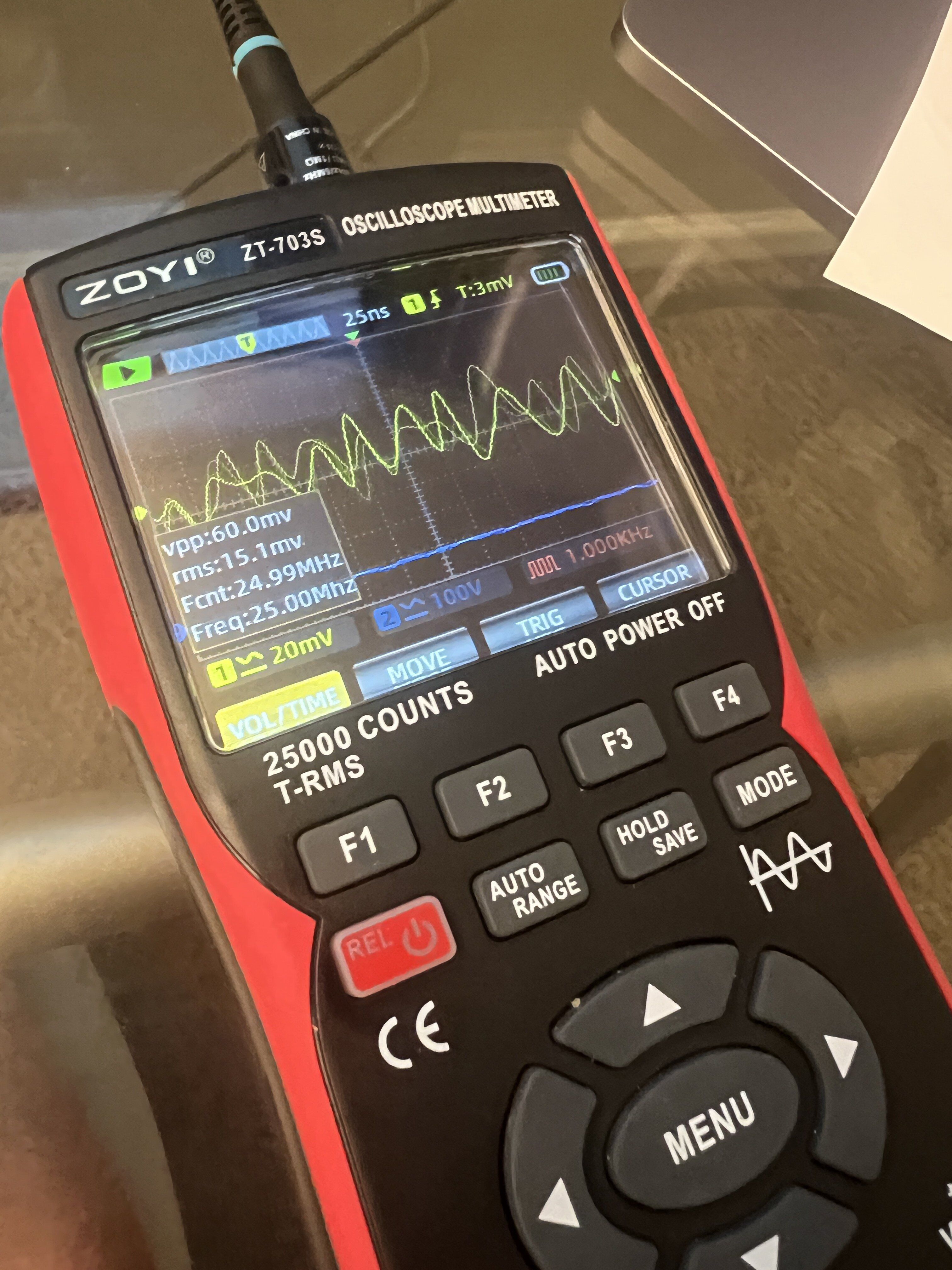

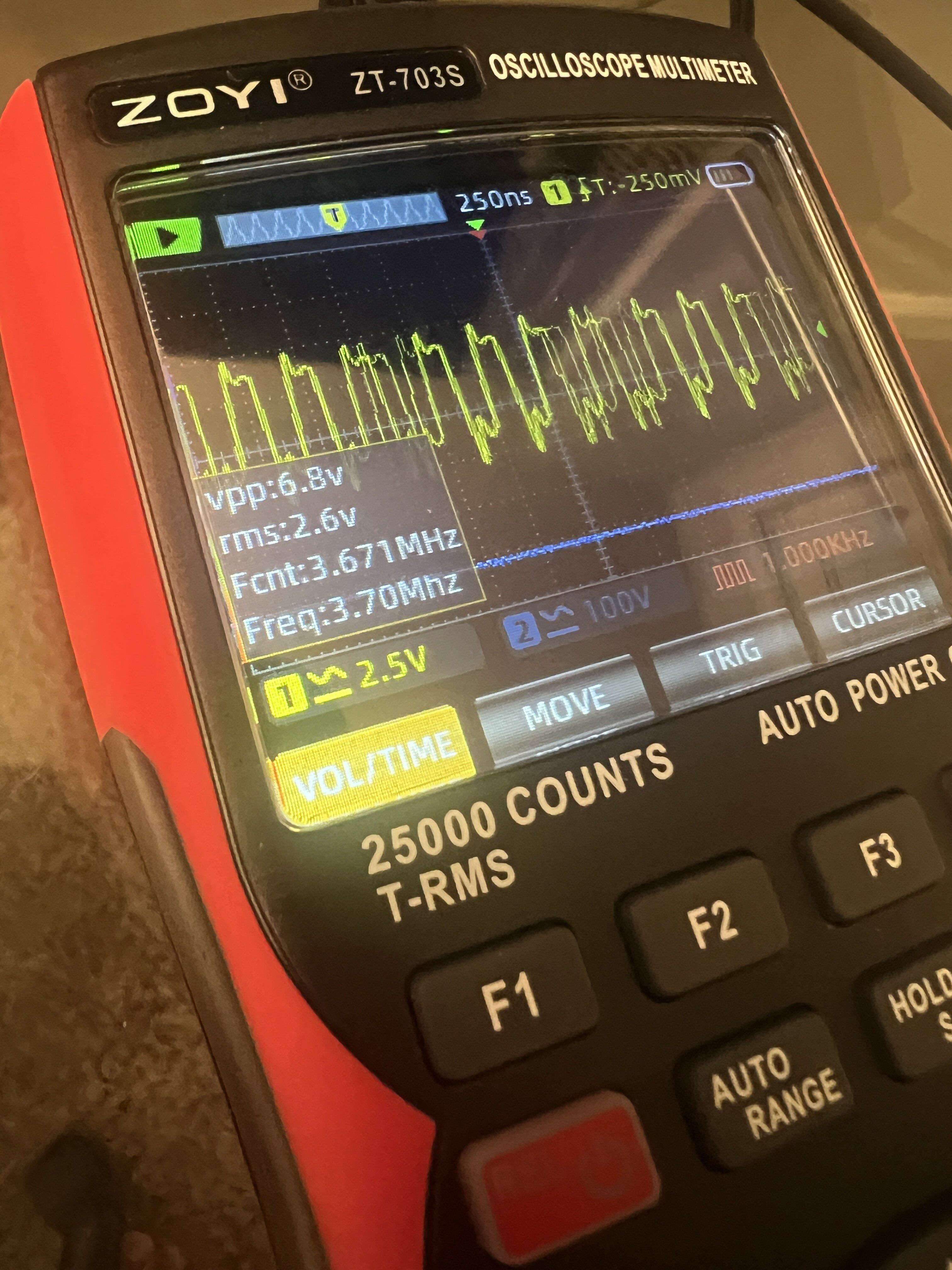

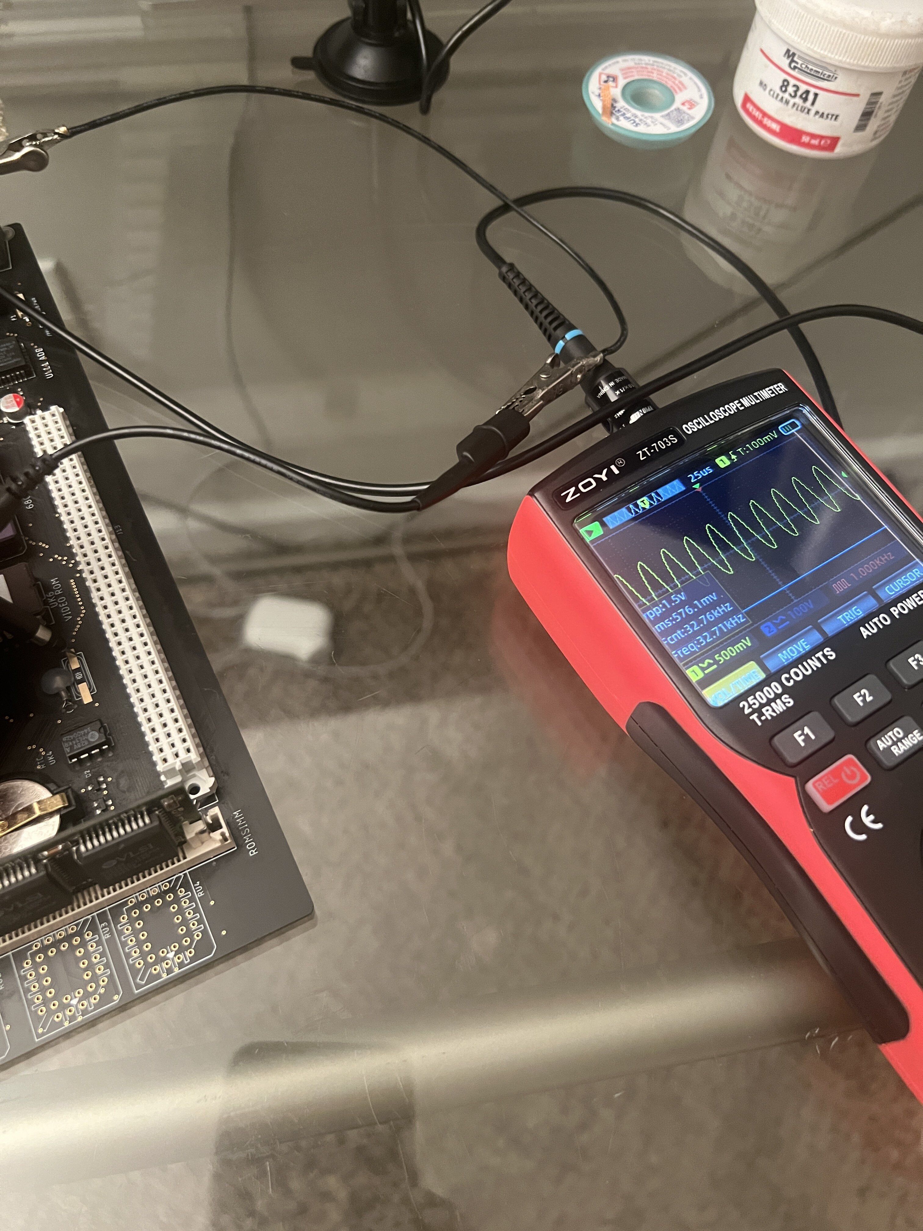

At the risk of playing Captain Obvious: Are you using an x10 probe with that little scope? An x1 probe may cause too much loading on the clock signal.
that's an excellent question. I need to double check it. I am a rookie with the scope for sure but I'm careful and I'm having fun.

No offense taken. Just Simasimac with no sound. From my understanding could be so many things. Checking likely culprits one at a time.
both my scope and probe are at 1X .I set them to 10X. but I'm seeing the same waveforms at a different magnification level? I'm definitely new to using scopes.

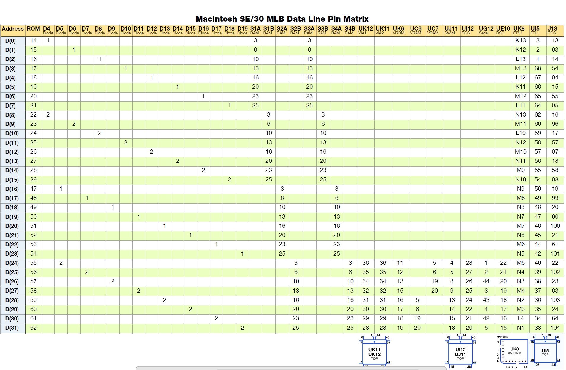

looked at the whole board under a microscope and don't see any broken traces but it's a brand new reloaded board also… Of course I checked all the address lines and data lines and checked continuity on all pins on the glue and ASC. Gonna check the VAIS and the rest of the PLCC's as you suggested today.
