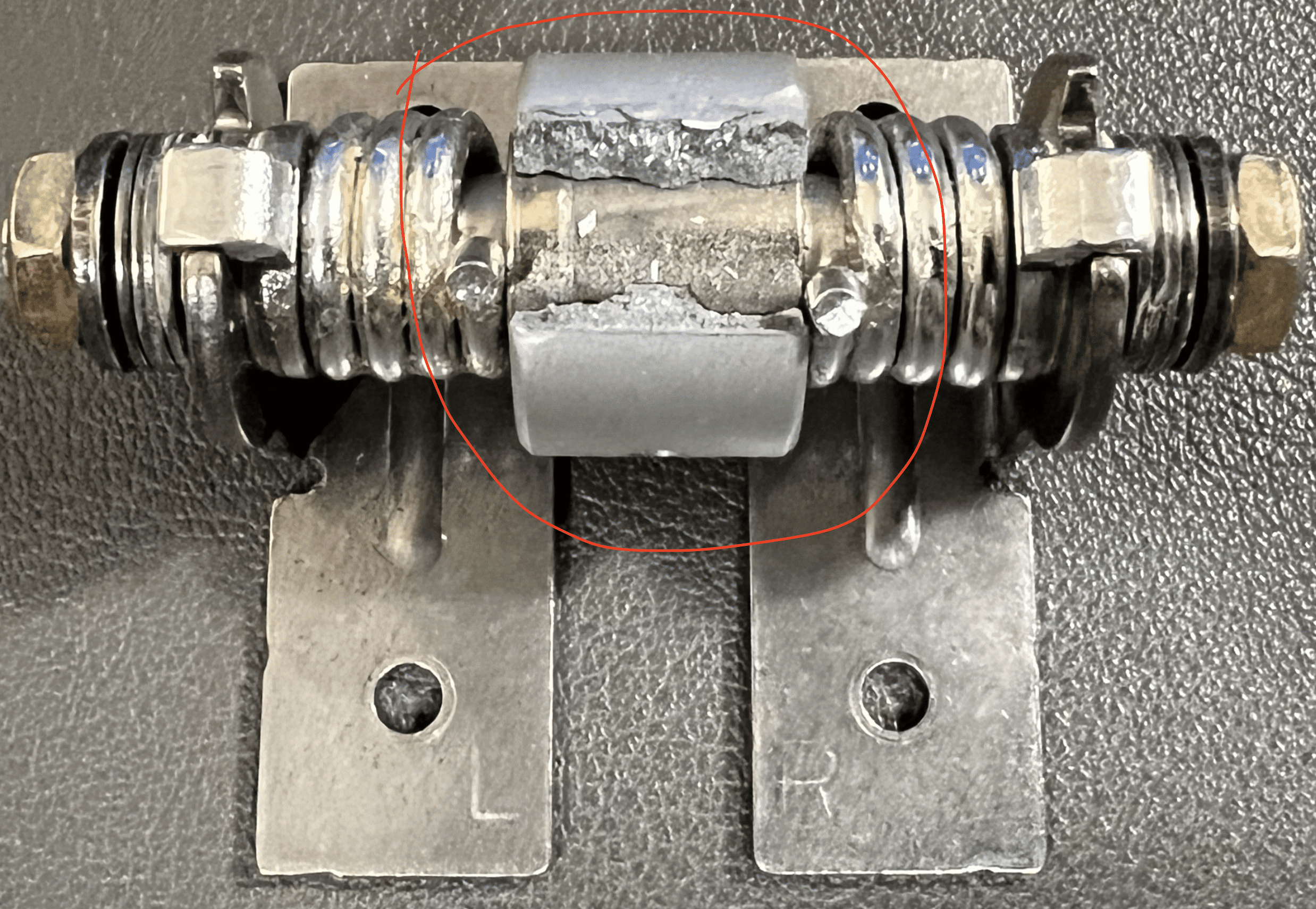

Attached is the picture of the broken hinge from the 23"
