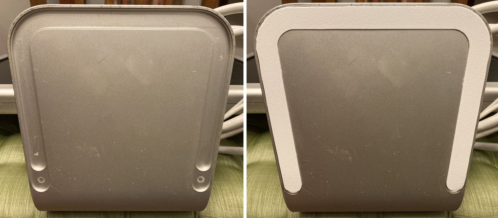

I have both a 20 and 23 inch Aluminum displays with missing foot pad / skit / rubber piece. Model A1081 and A1082.

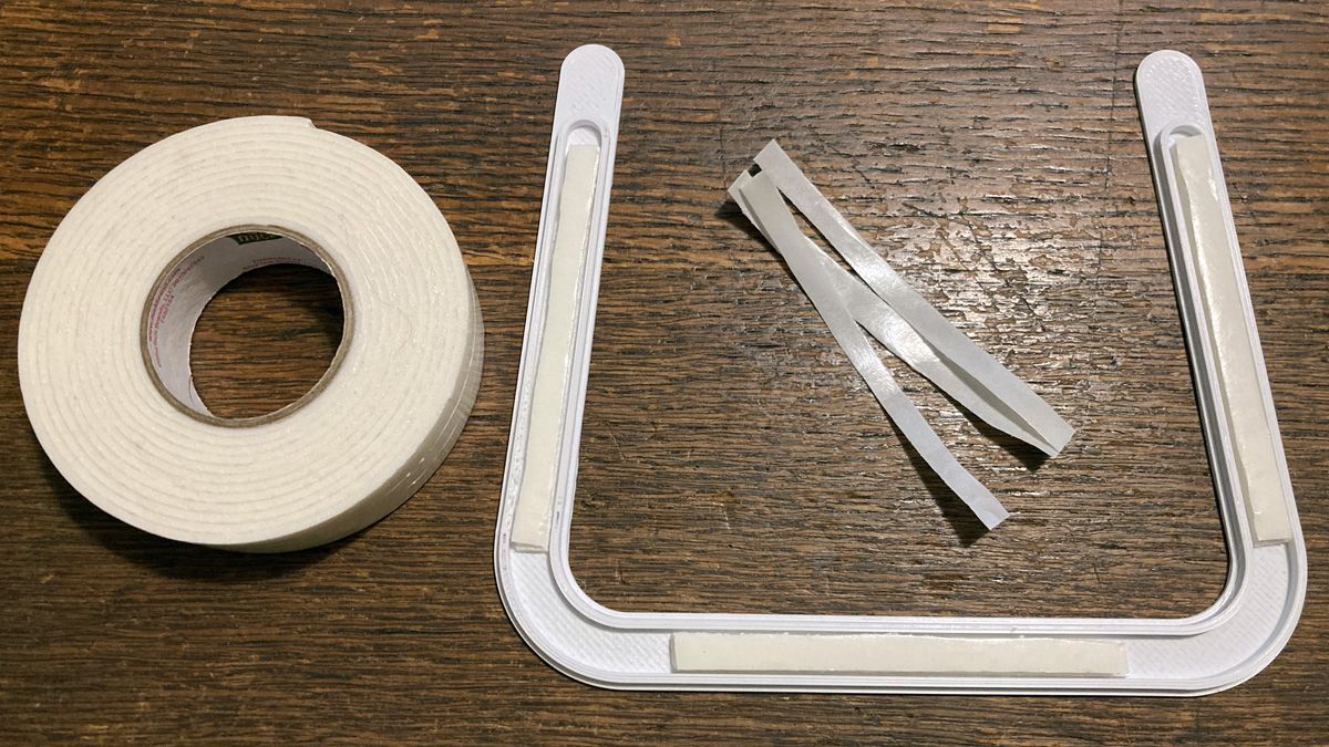

They seem to be held on with tiny double stick pads. I modeled in 3D and printed my own. Two layers of double sided foam.

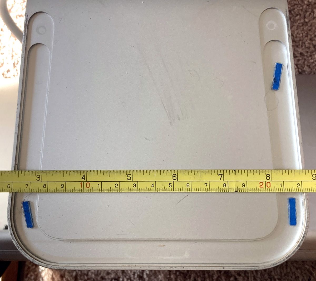

This one is a little short so I modified the file but did not reprint. Close enough for now.
Also adjusted it for length and width to fit a 23" model. Two STL files attached in zip. I printed in standard PLA white... it would likely be best in TPU or TPE in gray or white.
