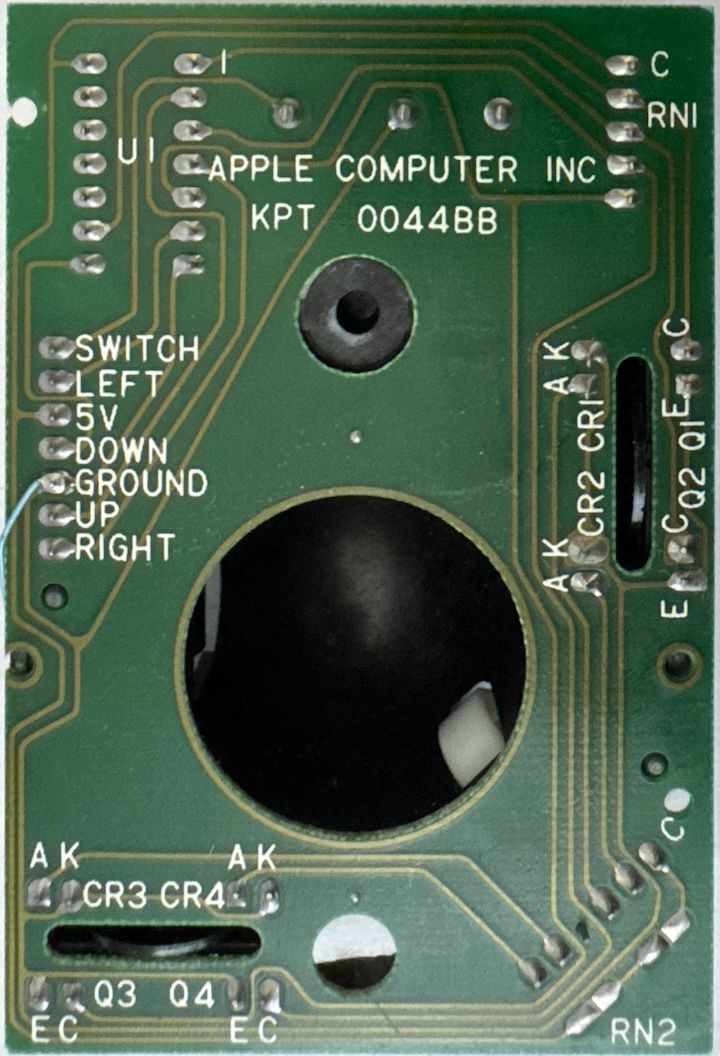

Another interesting M0100 mouse I found has the same circuitry and board layout as the Alps, but has silk screen with component markings and Apple Computer Inc.
I also got an Apple Mouse IIe, model A2M2070, and other than the label, it seems to be identical to the Alps.
Do you know if this mouse works with an Apple iic? I have one just like this, but it doesn't work on my early model Apple iic (no memory expansion pins). I have no other Hardware to test this mouse on, so I can't be sure if the mouse doesn't work or if it simply doesn't work with the iic.
Glenn Anderson
Sep 26, 2022
31
I just did a quick test with my early model Apple Iic (A2S4000, no memory expansion), and it works just fine. The Alps style mice all seem to be pretty much identical electrically, including the one with the silk screen with Apple Computer markings.
Reactions: Billgonzo
Billgonzo
Apr 21, 2025
Thanks, that's good to know. I have been waiting for my Floppy Emu to test software with the mouse, so I have only been able to attempt to test it in BASIC. Maybe I'm doing something wrong with my code, or maybe the mouse just doesn't work for some reason. I guess I'll have to wait until I can fully test it to find out.

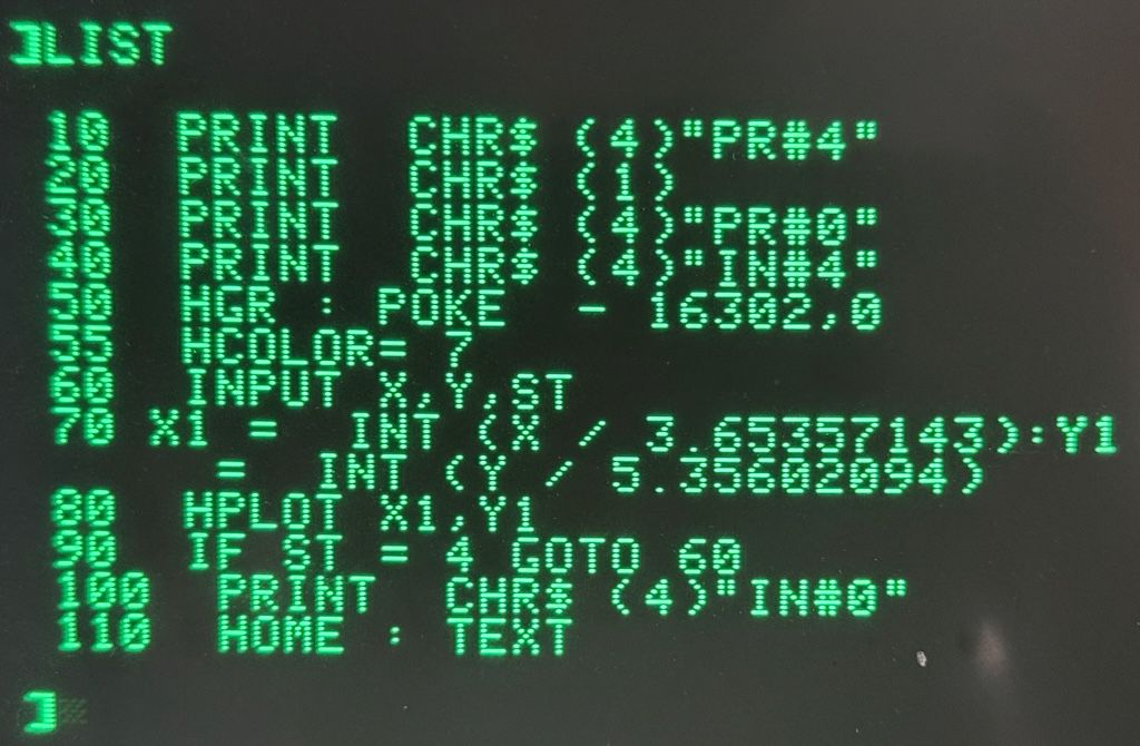

This is the BASIC code I'm using to test mice.
Billgonzo
Apr 21, 2025
Thanks. I used the same program and could never get the mouse to work. I did find some info on how to use the mouse as a joystick input so that pdl(0) and pdl(1) read the mouse position. I have a ROM 4x so my mouse is slot 7. So what you do is type "pr#7" , press "control+A+return", then type "pr#0", hit return, and then run your basic program that uses PDL. This worked for me, and I found that the mouse wire had a short, and I had to keep the cord bent to get a connection. This might be why the other method wasn't working for me.
