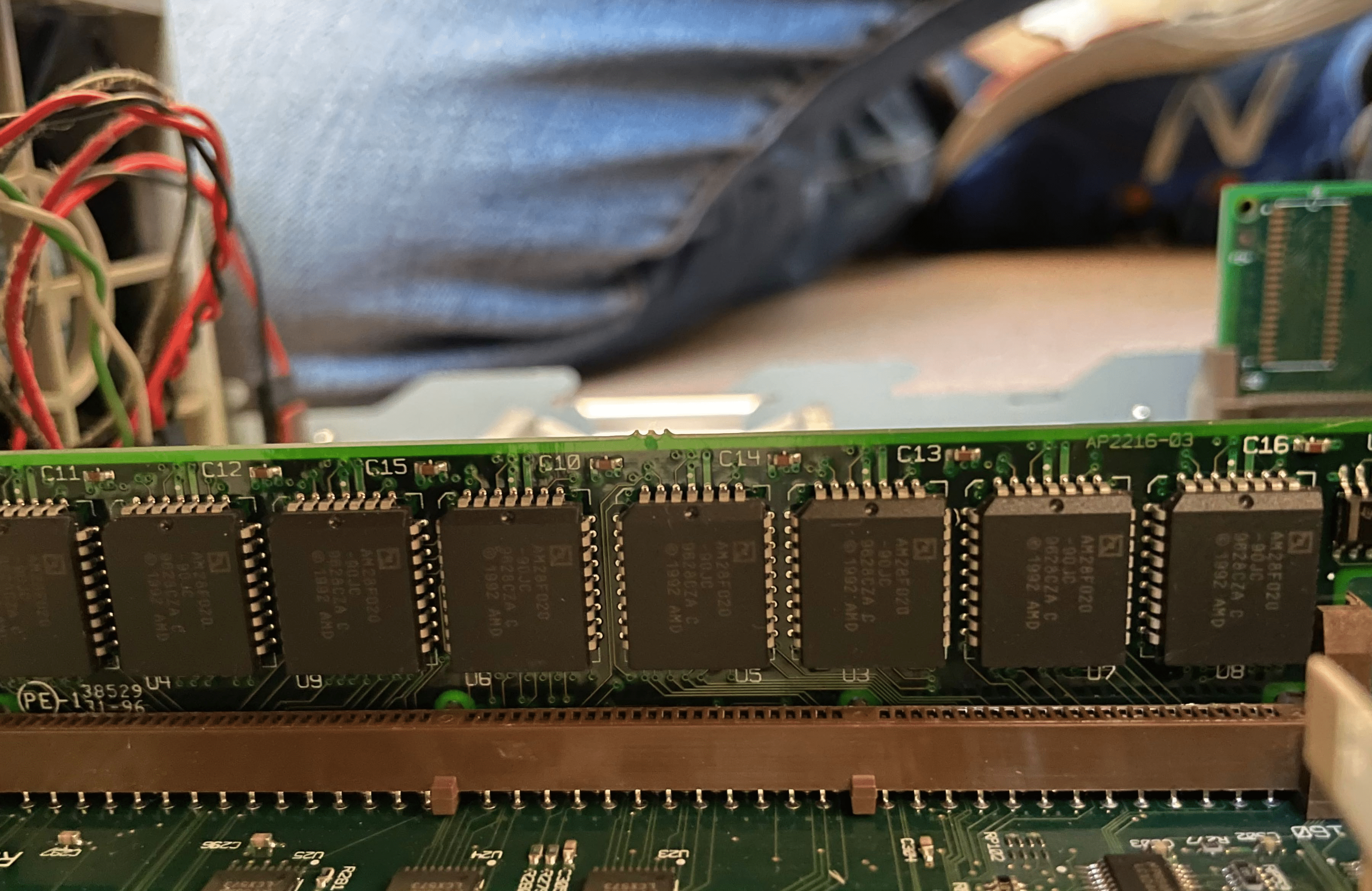

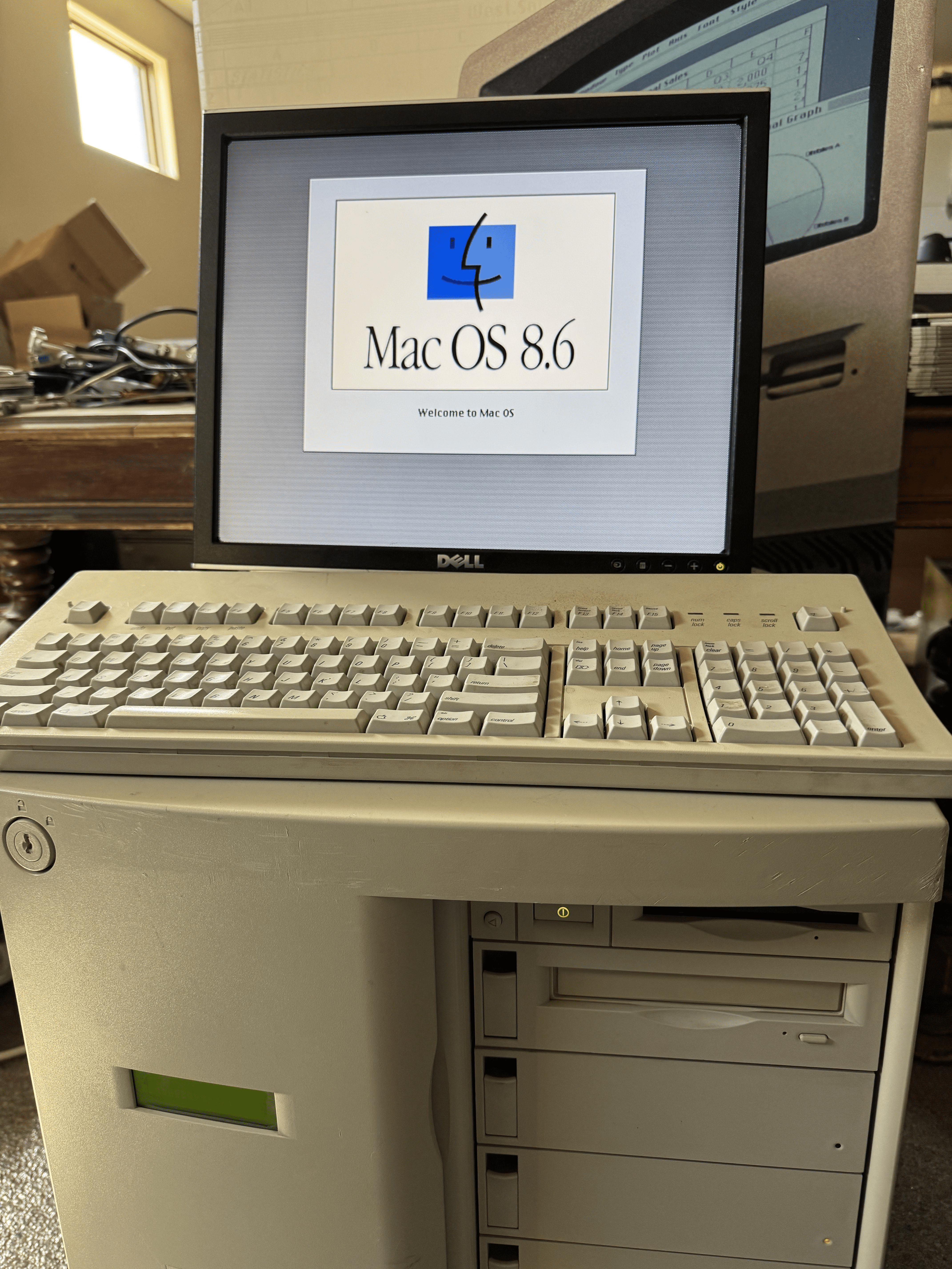

If you've been following my ANS 700 tinker log you'll have seen that @johntucker has recent come forward having a ANS that is able to boot into MacOS! This was a much talked about and sought after ROM back in the day as ANS's only run AIX, until now!
MacOS 8.6 Booting on an ANS via @johntucker
@johntucker, @joevt, @ClassicHasClass, and myself have been working to get these ROM's dumped and some analysis done on them to see the differences (I'll let @joevt post his OF analysis below).
Current Status: We have the ROM's dumped, but now need a way to program them. The ROM board/s are AM28F020 and I believe are the same/similar to what other PowerMacs had (photo via @johntucker )

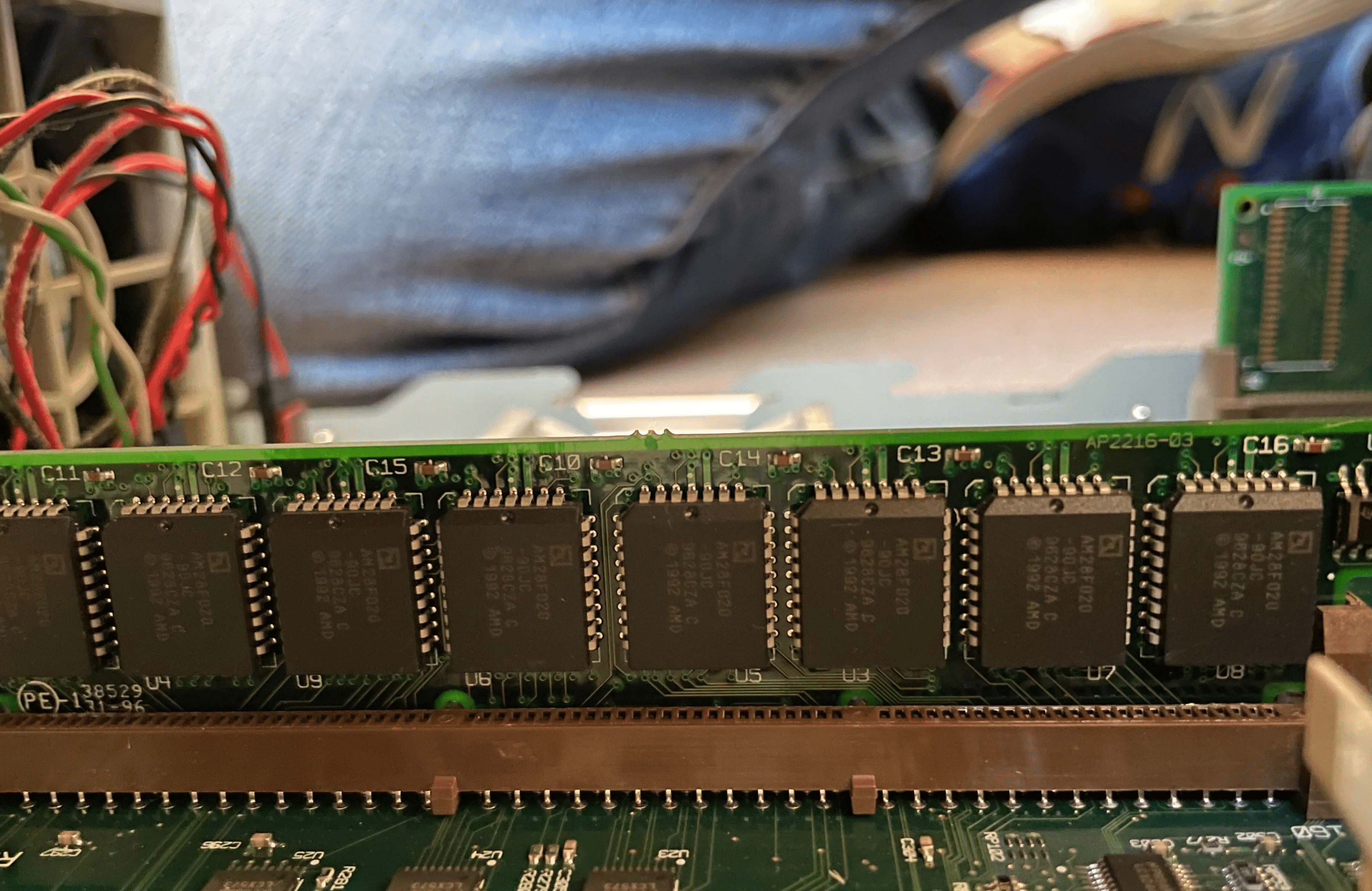

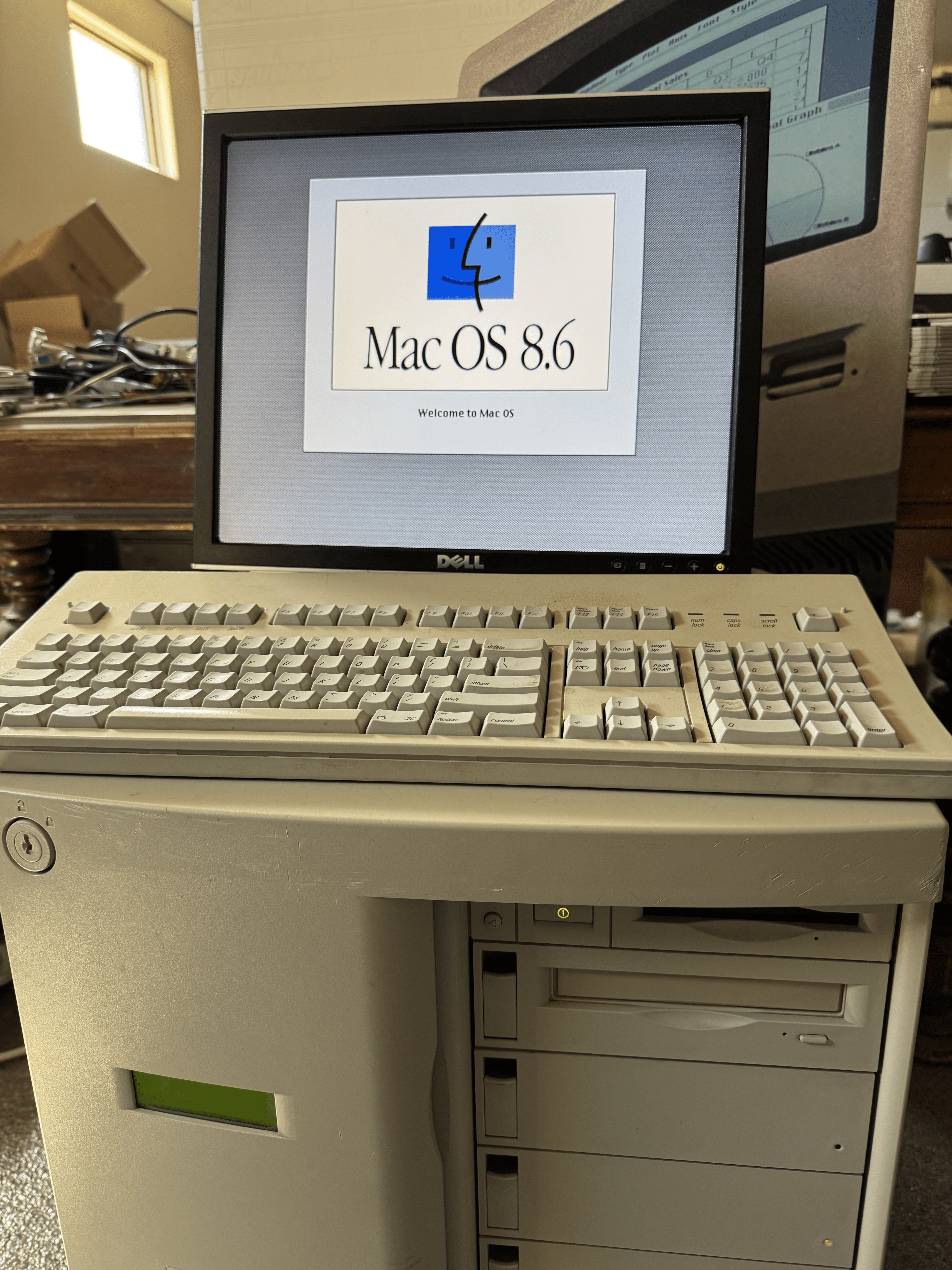

I'll keep this first post updated as all the details emerge.
Isn’t this the same type of flashable DIMM found for the early PPCs?
Probably. Does anyone have schematics for a PPC flashable DIMM?
Something that was pointed out to me a while ago: this PCI Power Macintosh DDK disk has a TNT version of Apple's Flasher app on it. Probably mainly useful for reflashing a flash ROM DIMM that you're already booted from, but on the off chance that it gives you any extra context I thought I'd bring it up.
I'll have a look. Running it in DingusPPC may help show how it flashes a ROM.
