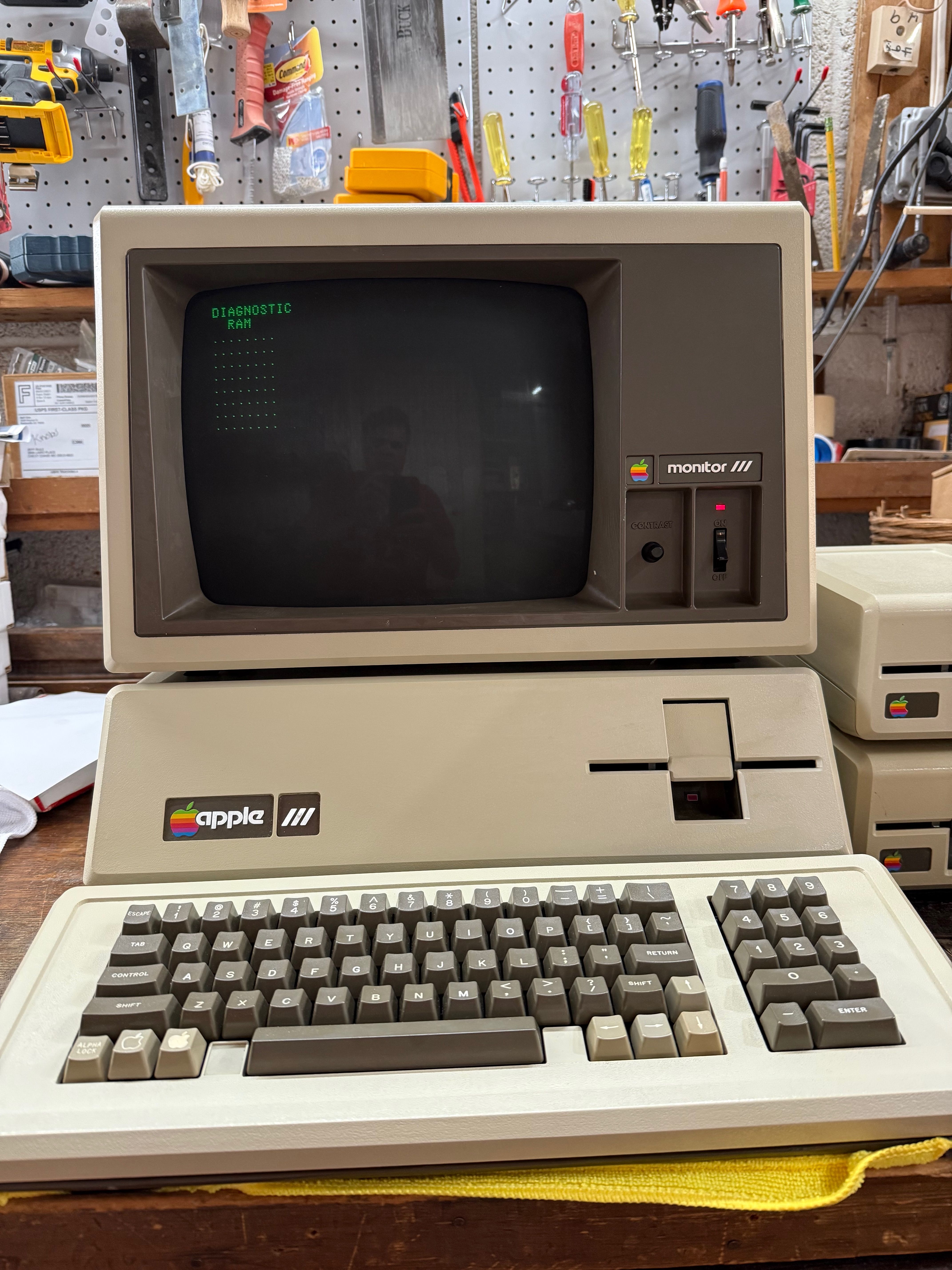

Picked up an Apple /// that appears to be untouched since the 80s, but was in excellent condition and had two external Disk ///s and the Monitor ///.
Apple /// has now been retrobrighted, had the rifa caps swapped out on the PSU, all three drives had their heads cleaned and lightly lubed with white lithium grease.

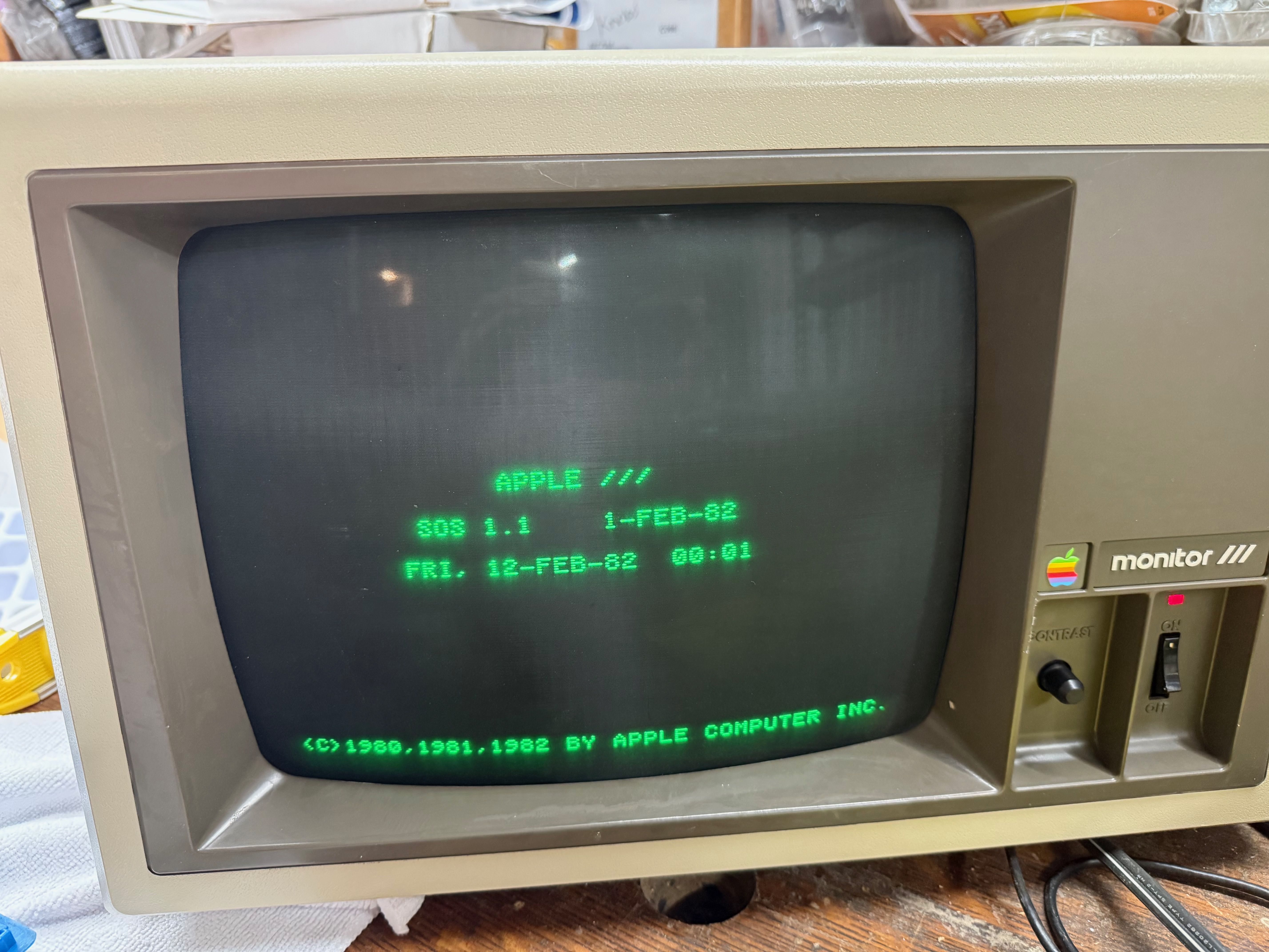

Did my first test boot and pleased to report it is working!

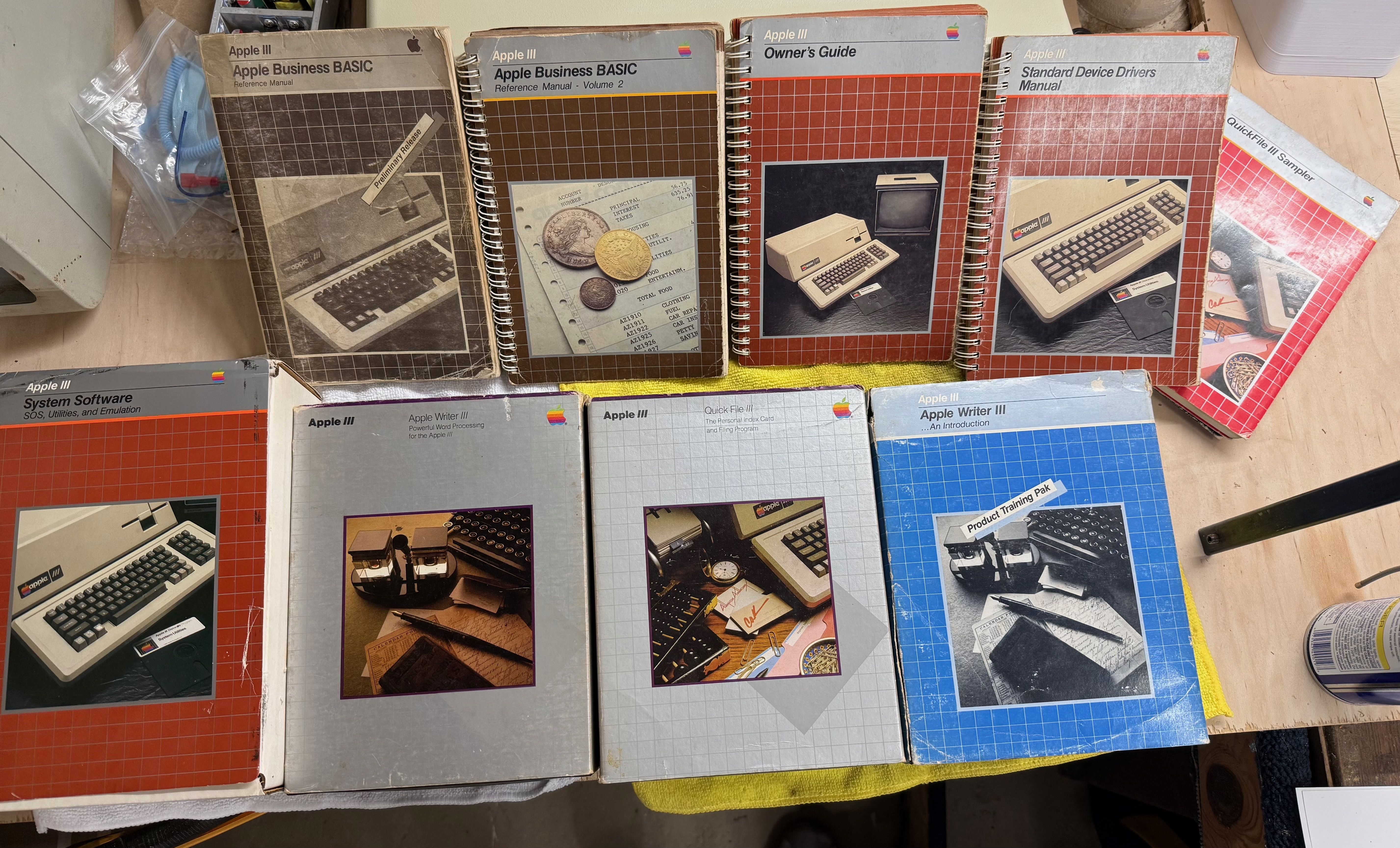

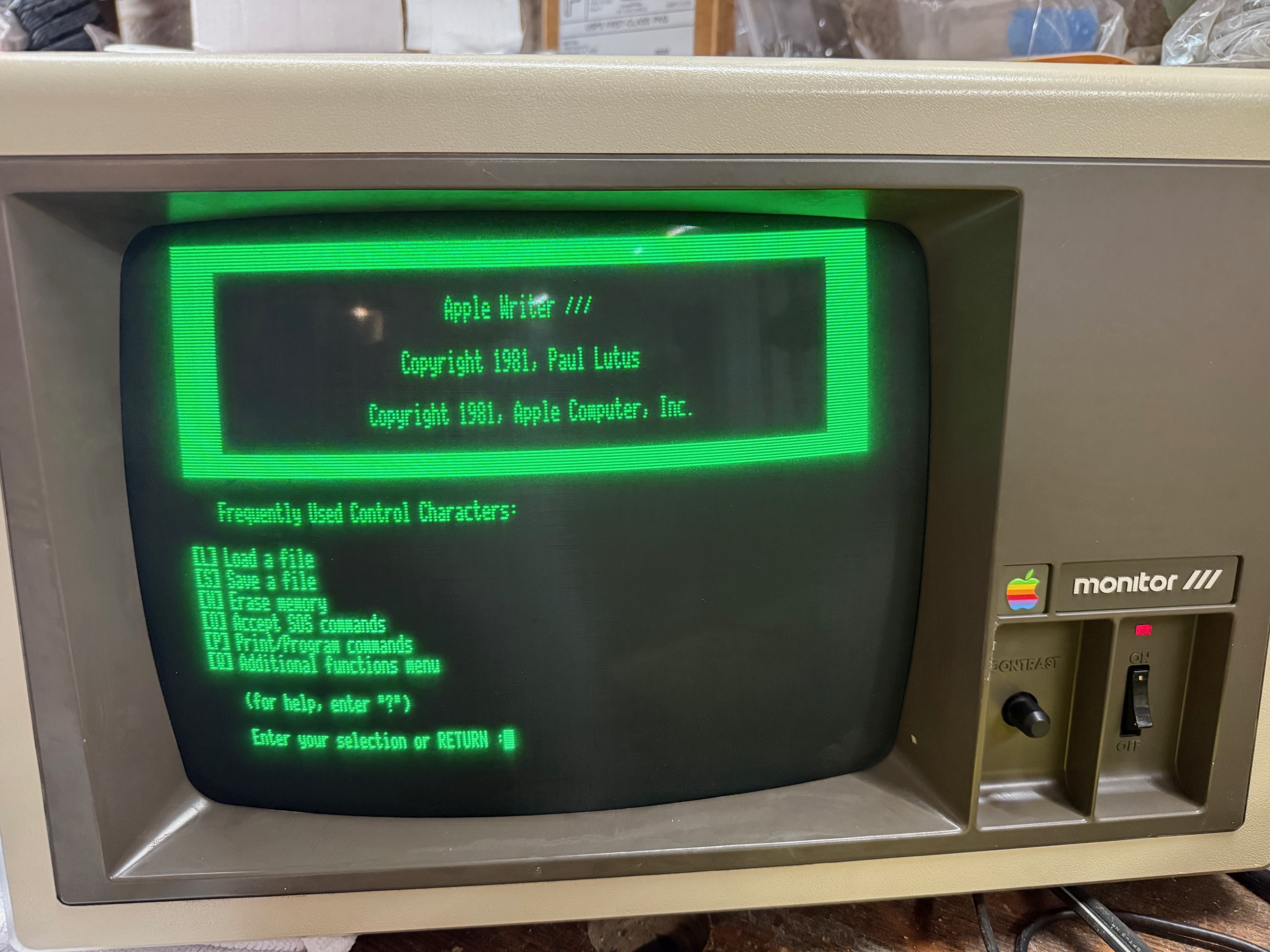

It also came with a lot of software, including the SOS Disk with Apple II emulation software, AppleWriter ///, QuickFile and some great manuals for Apple Business Basic.
