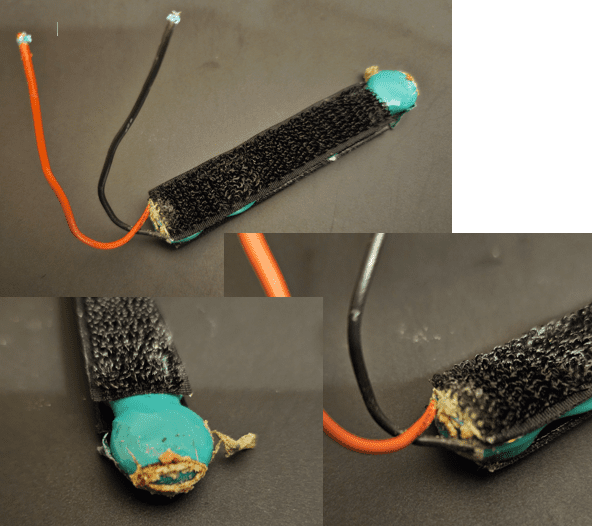

I took the machine apart, and was surprised to find a 3.3v button-cell soldered to the bottom of the processor board (in addition to the ~7v Nicad CMOS battery). My friend Sam theorized that the battery might need to be fresh for it to boot. The old battery measured 0.03v.
It was a CR2023 or similar, but all I had were CR2025's on hand. I soldered one in, and it has been 100 percent reliable since then.
There is almost no documentation about this laptop online that I could find, so I just wanted to get this posted for when the batteries inevitably die on other AST Ascentia laptops, and they don't boot. I hope this helps someone else out!
