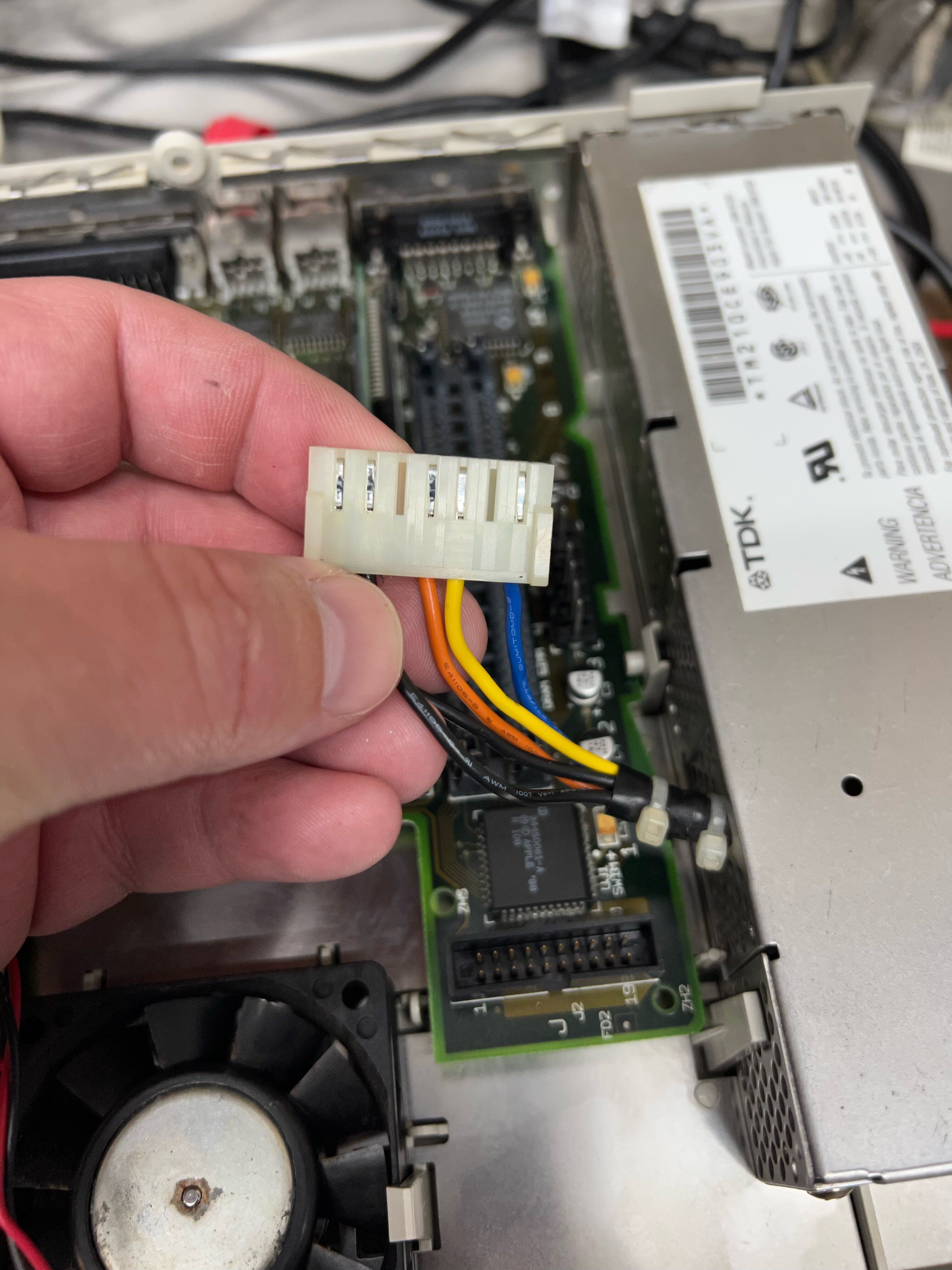

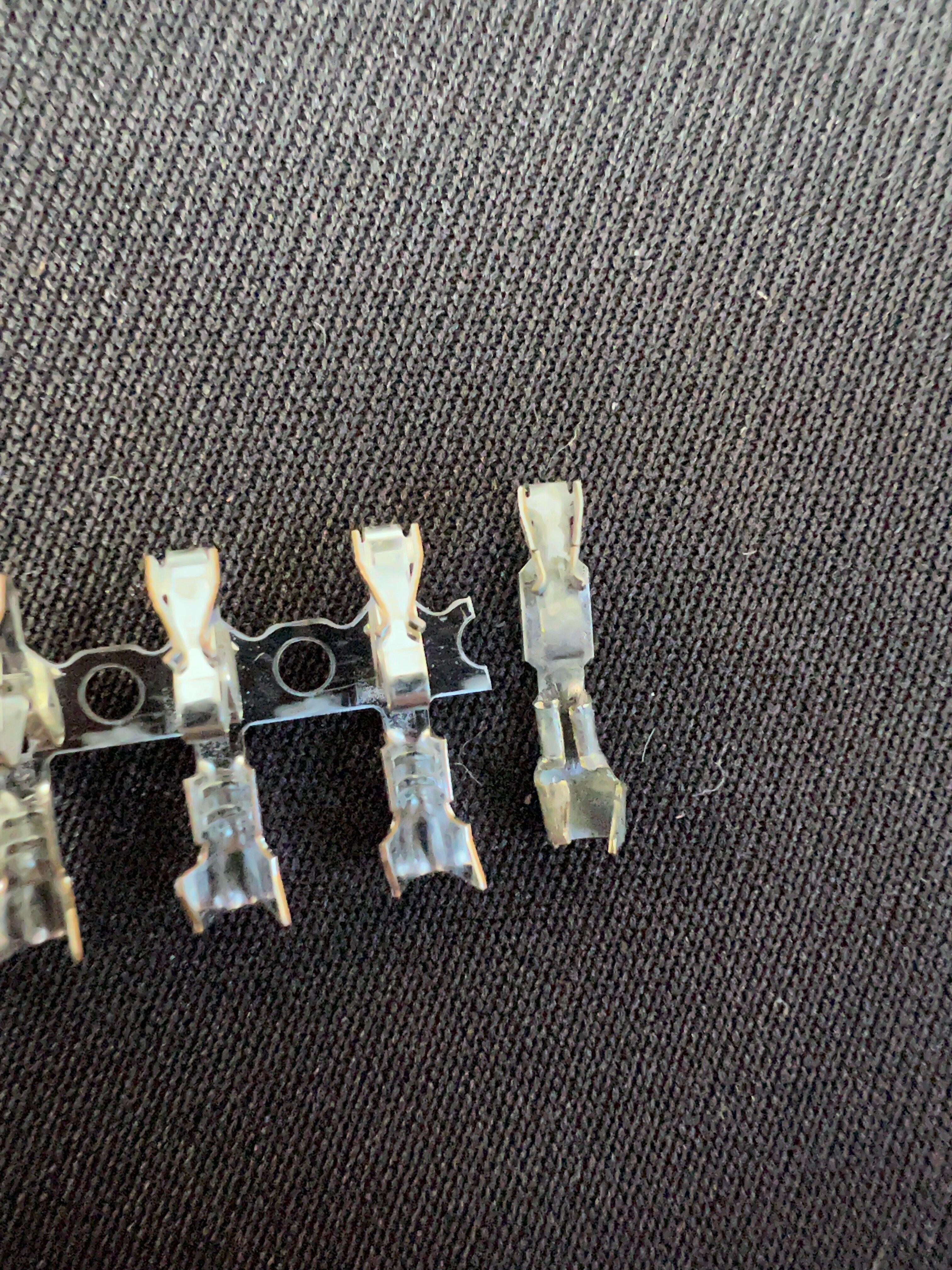

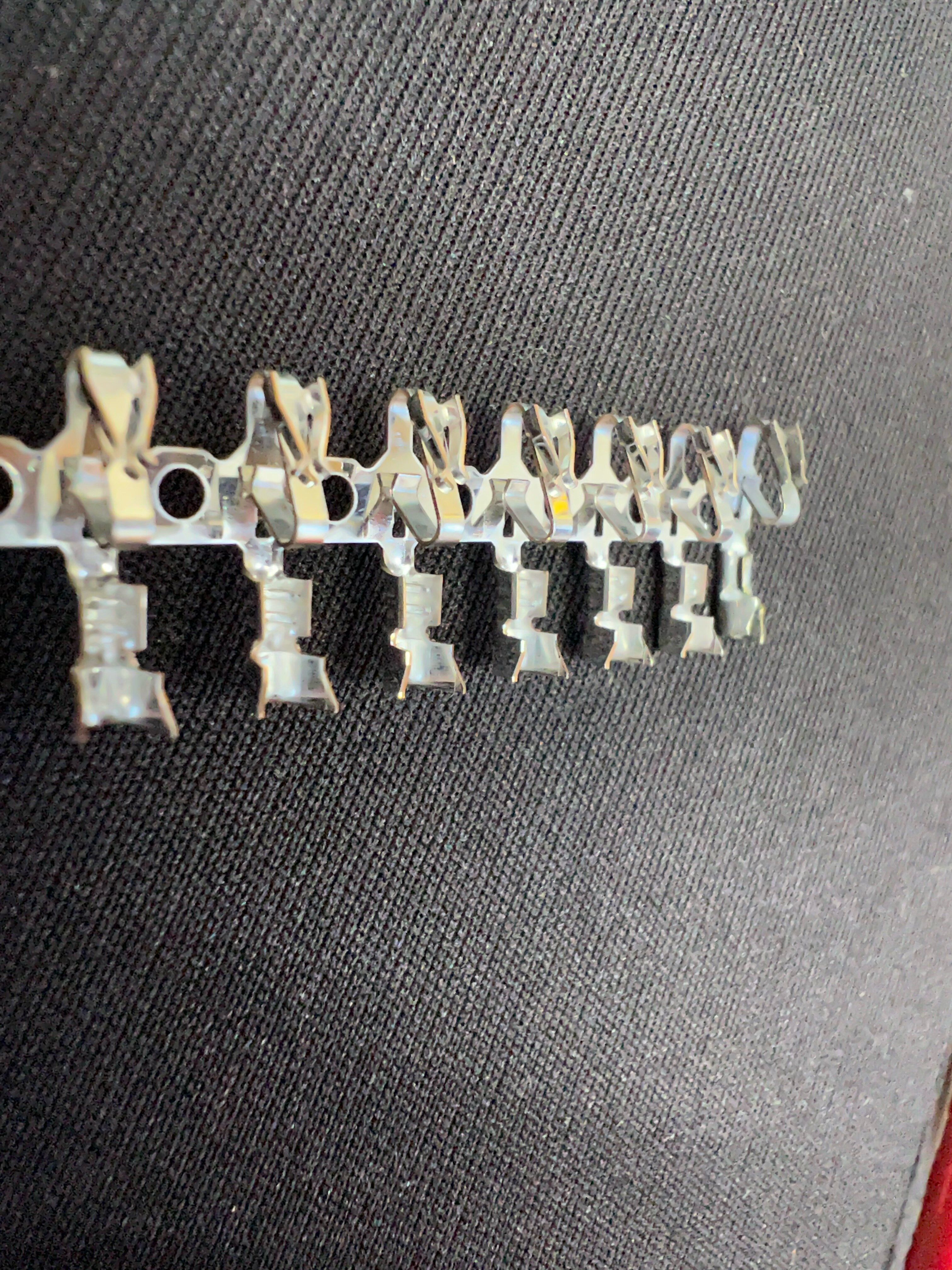

Hey all, just wanted to follow up on this since I had to replace my pins on my LCII and my pins were slightly different that what was listed. My power supply was the TDK branded one, but the pins in mine were these: https://www.digikey.com/en/products/detail/molex/0008520112/1130605 (0008520112 - KK Trifurcon 6838 - Molex)
I've successfully repinned it and it's working great. Here's some photos of the only surviving original pin from my PS and the new ones:
