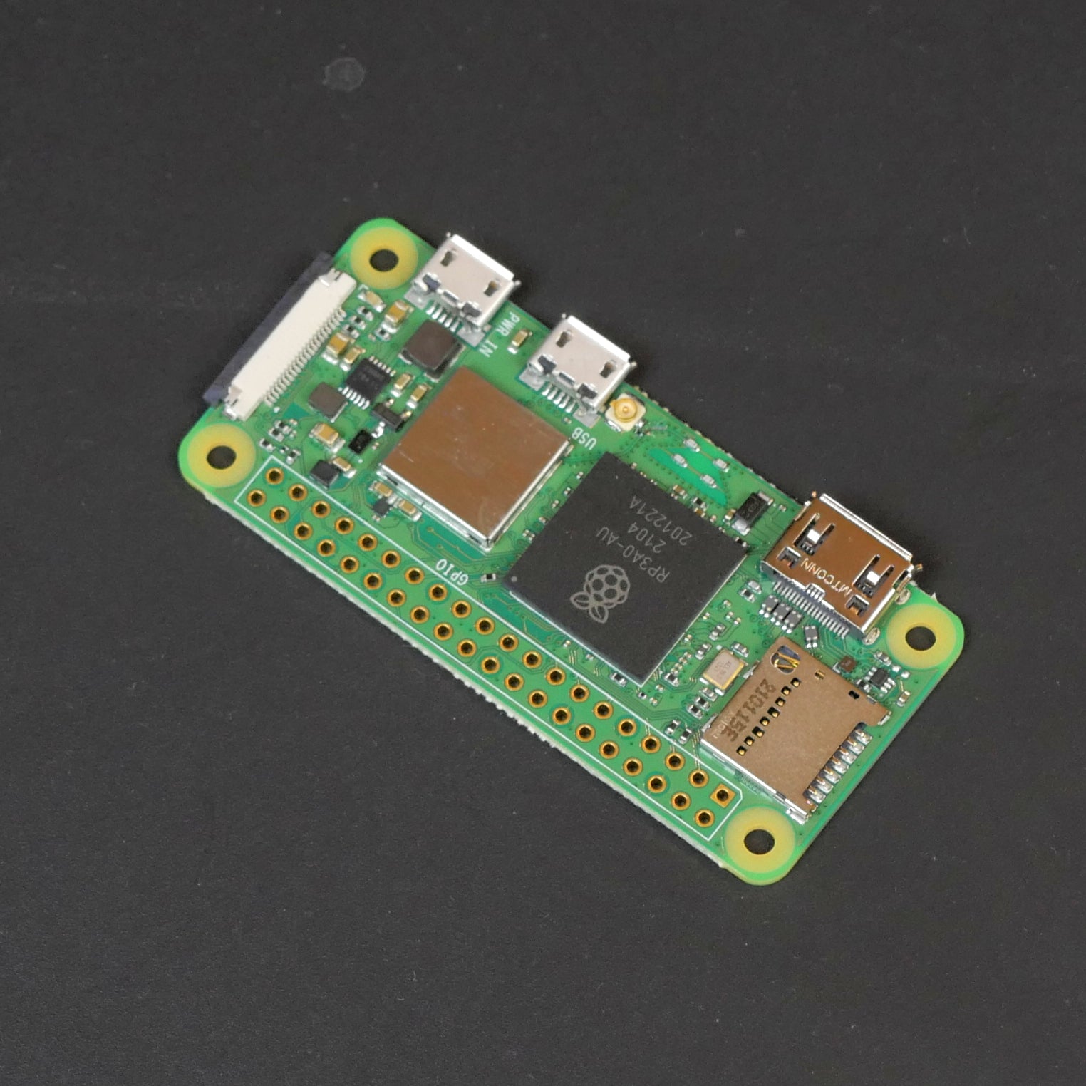

Found an off the shelf solution:
It's massive overkill to treat the SCSI to SD conversion as a HAT on a full blown Linux Computer, but the added CPU cost isn't prohibitive.
Now thinking in terms of an LC NIC format SD/WiFi solution. Far more PCB real estate and cubic available than CS/CSII format and the SCSI connector is right there!
