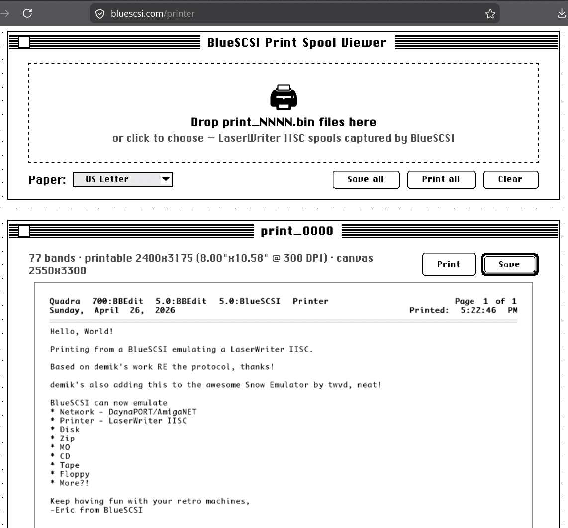

Thanks to @demik we now have a reverse engineered spec for the LaserWriter IISC - and with that now you can use BlueSCSI not only as a disk/cd/network/tape/floppy/zip/mo emulator, but now also a Printer emulator :D
I've only done light testing but things seem to be working. I'm doing no processing currently on the BlueSCSI - only dumping the raw commands/data to a file for post processing at https://bluescsi.com/printer (you can try it out even if you don't have a BlueSCSI, there's a test file there to load).
Give it a try here (must be logged into GitHub for CI Builds) Or wait for a bit more testing and it to be merged in.
