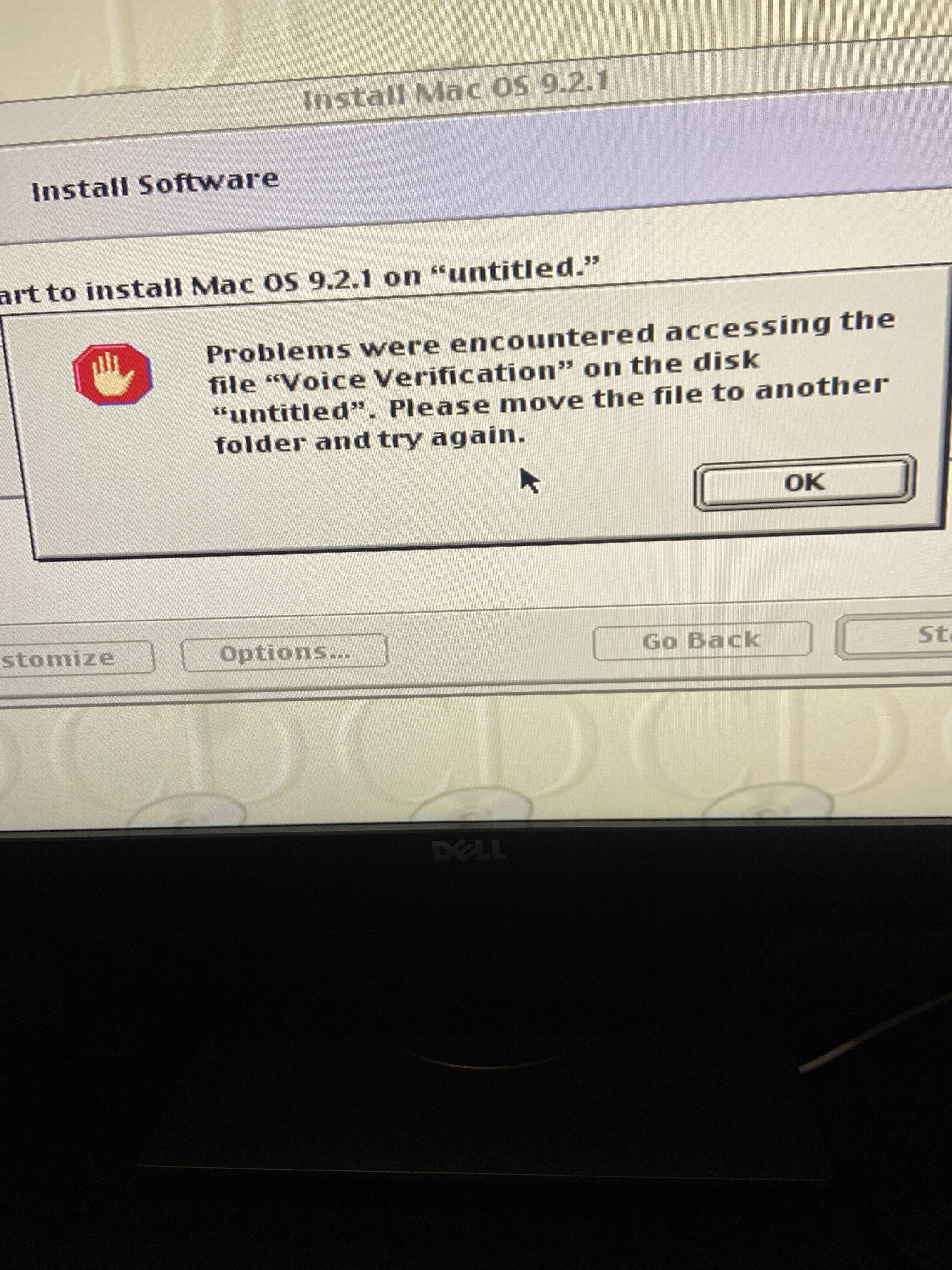

I recently bought a brand new BlueSCSI v2 for use in my Power Mac G3 Blue and White and am having issues.
I keep getting disk read errors on my BlueSCSI despite purchasing a brand new Sandisk Extreme Pro high performance SD card that is 200MB/S read speed / 90MB/S write speed so we know the SD card is not the issue.
I do have the SCSI bus terminated with the built in terminator on the SCSI cable in my Mac so we know termination should not be the issue.
I had to turn off the termination jumper on my BlueSCSI in order for my Mac to see the BlueSCSI
The BlueSCSI is the only drive on the SCSI bus as I have unplugged the 9TB IBM Scsi hard drive.
I am using an adapter JXSZ SCSI HD 68 Pin to IDC 50 Pin Adapter Female-Female in order to use the BlueSCSI with my G3 along with the stock Adaptec SCSI card and SCSI cable that come stock with the G3 Blue and White from the factory.
I know the SCSI card and cable are good as they work perfectly with the IBM SCSI hard drive that i now have unplugged for the BlueSCSI to be the only SCSI drive.
I have tried both the stock IDE CD-ROM drive and the emulated CD drive on the BlueSCSI and both give disk read errors when trying to write to the hard drive image when trying to install Mac OS 9.2.1
I have tried creating a new hard drive image using Disk Jockey and still same errors.

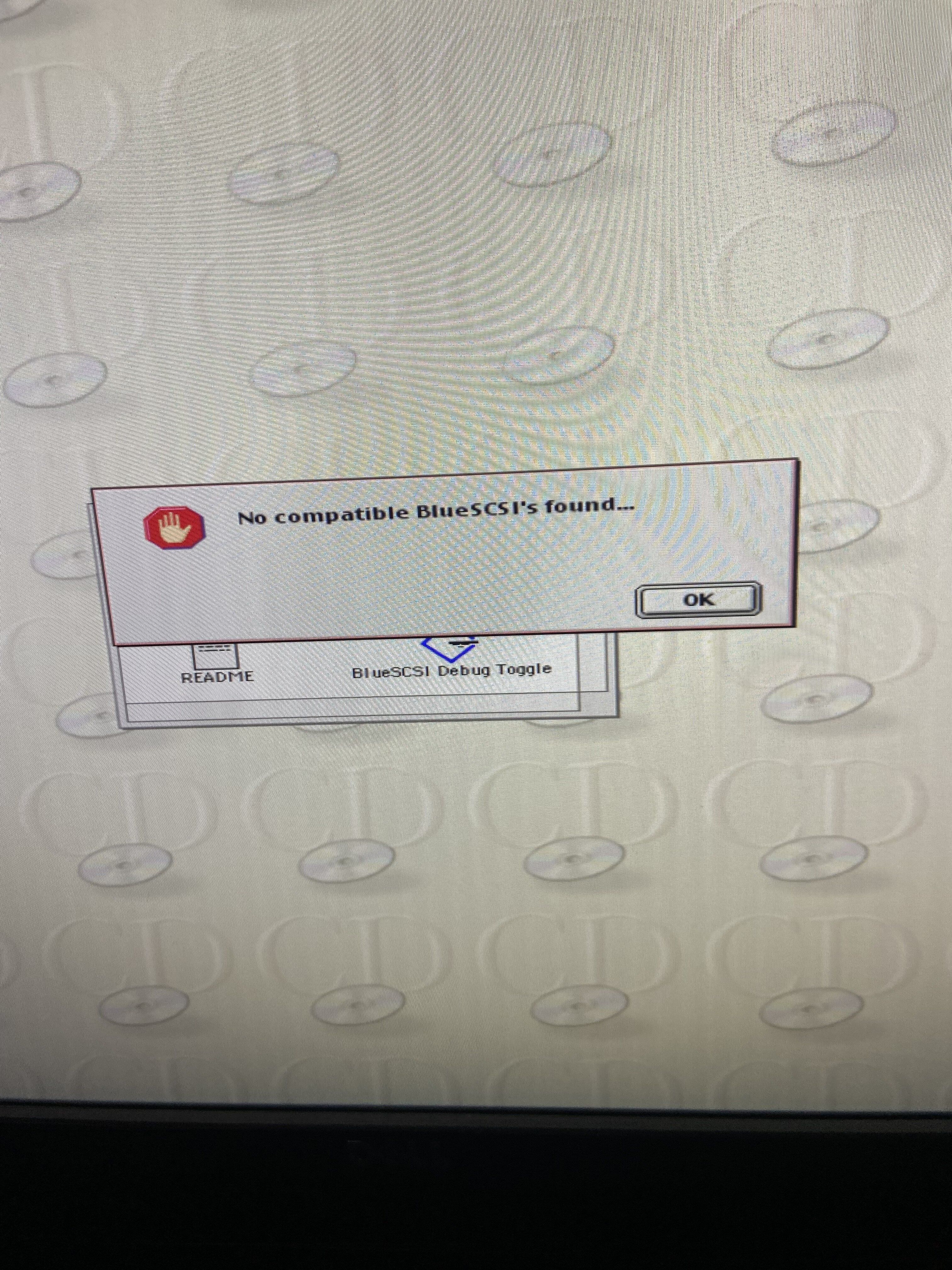

The BlueSCSI toolbox seems unable to detect the BlueSCSI
My Mac G3 BW is seeing the BlueSCSI and booting from the emulated CD drive on the BlueSCSI but writing files seems to be an issue.
If anyone can help me out that would be appreciared.
These are the errors in my Blue SCSI log file with Debug information turned on
These errors occur several times in the log
SD card readSector(49804) slow transfer, buffer0x20029E50 vs. 0x2002FBDC
Found 4 sectors in prefetch cache
435119ms] STACK 0x20081E98: 0x2002170F 0x16F7F800 0x2003EBDC 0x100230A7
[435119ms] STACK 0x20081EA8: 0x2002170F 0x0000000C 0x2003EDC0 0x0000000C
[435119ms] STACK 0x20081EB8: 0x00000000 0x2002C760 0x20046B97 0x00000000
[435119ms] STACK 0x20081EC8: 0x0000B800 0x00000000 0x2002EBDC 0xFFFFFFE9
[435119ms] STACK 0x20081ED8: 0x19EF665A 0x00000000 0x000003E8 0x400B0000
[435119ms] STACK 0x20081EE8: 0x000000E8 0x2001B301 0x2001B30E 0x69100000
[435119ms] STACK 0x20081EF8: 0x00000000 0x20046B9A 0x000000E8 0x2001B301
[435119ms] STACK 0x20081F08: 0x200082F0 0x29100000 0x00000000 0x00000000
WATCHDOG TIMEOUT, attempting bus reset
