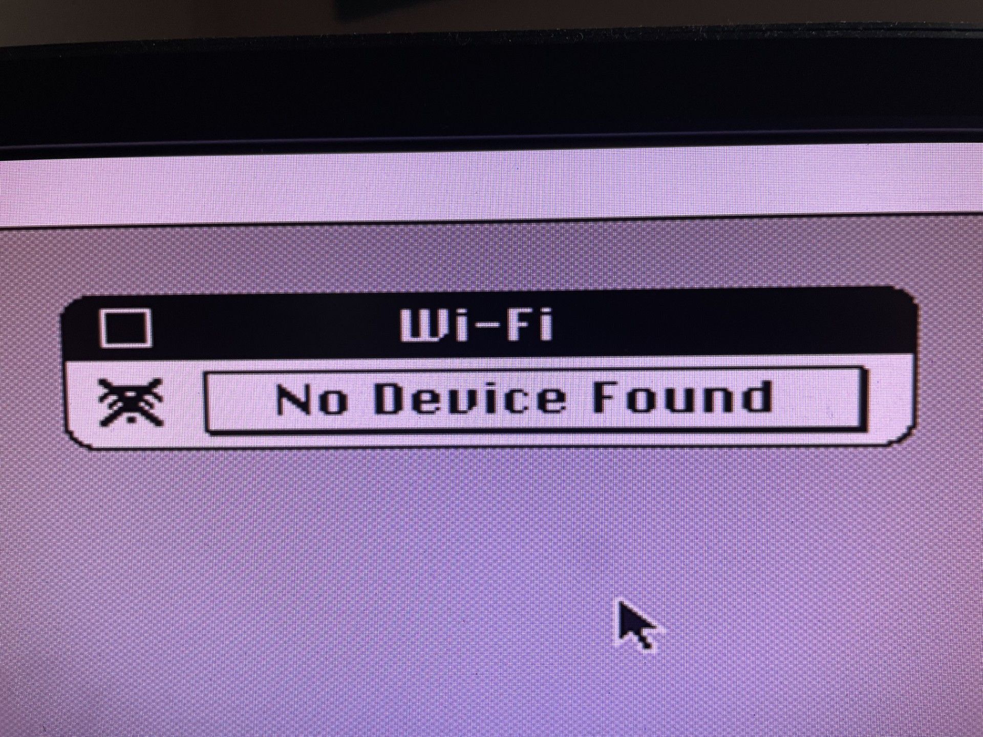

Hi There,
I have a Desktop BlueSCSI V2 - 2023.10a with a Pico W. It is working with my Quadra 650 and I can now browse the internet using the BlueSCSI Wi-Fi, but I have a funny issue. When I open the Apple menu item "Wi-Fi" it opens but then says "No Device found". I have the Daynaport driver installed (I did a custom install and choose the SCSI/Link driver). I have tried it in System 7.1 and 7.5.3 with the same result. I have included a screenshot of the error.

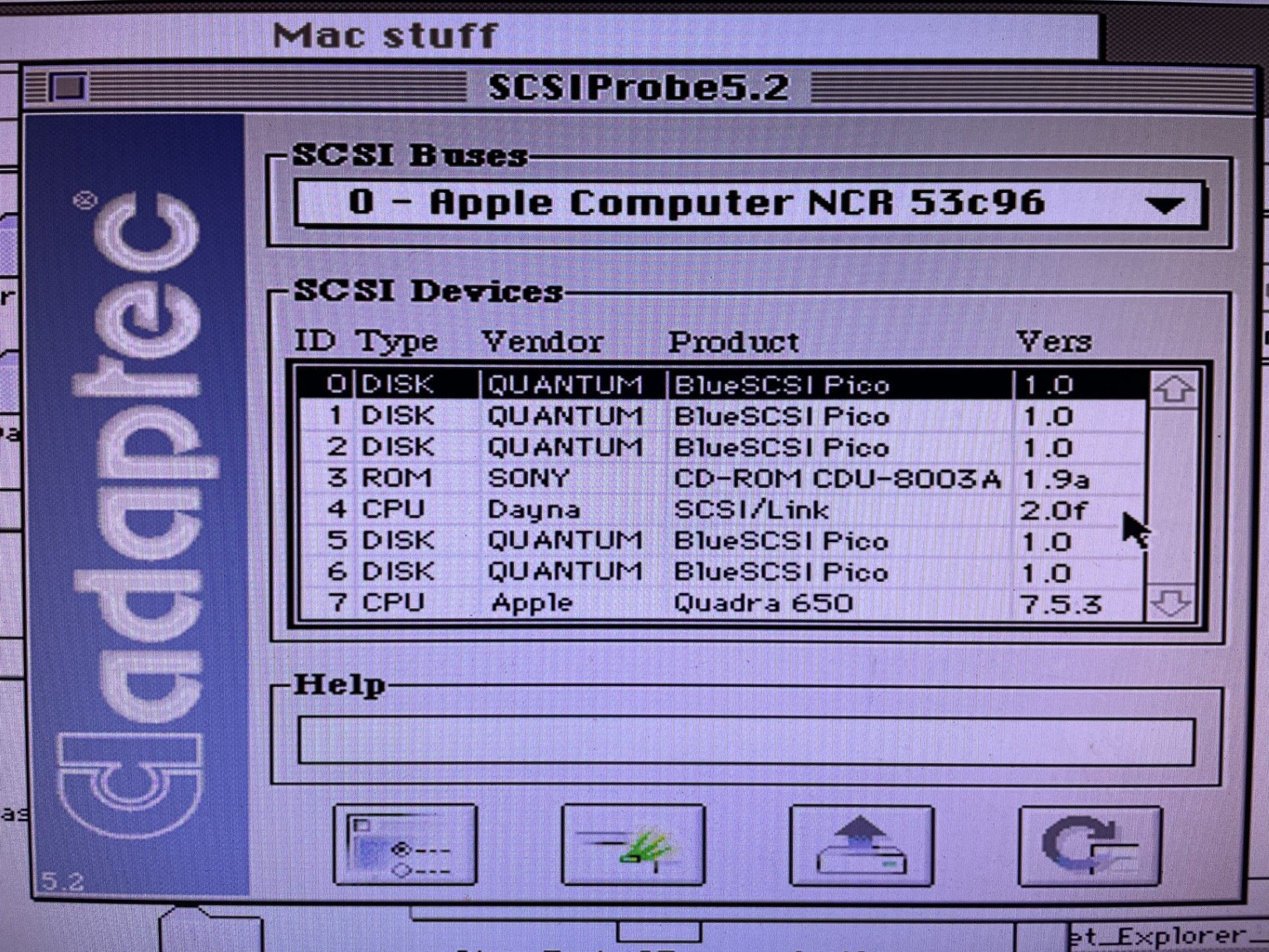

Do you have the HDA and INI file for the network adapter on your SD card? In a tool like SCSI Probe, you should see "Processor" or "Dayna Processor" as one of your SCSI IDs.
Brutus75
Aug 15, 2025
Yes I have both files and it does show up under SCSIProbe. I can browse the internet fine I just get that error in the Wi-Fi app. I have attached a pic. It is SCSI ID 4.

I figured it out. I unplugged the physical CD-ROM in the Quadra 650 and then it fixed the issue.
