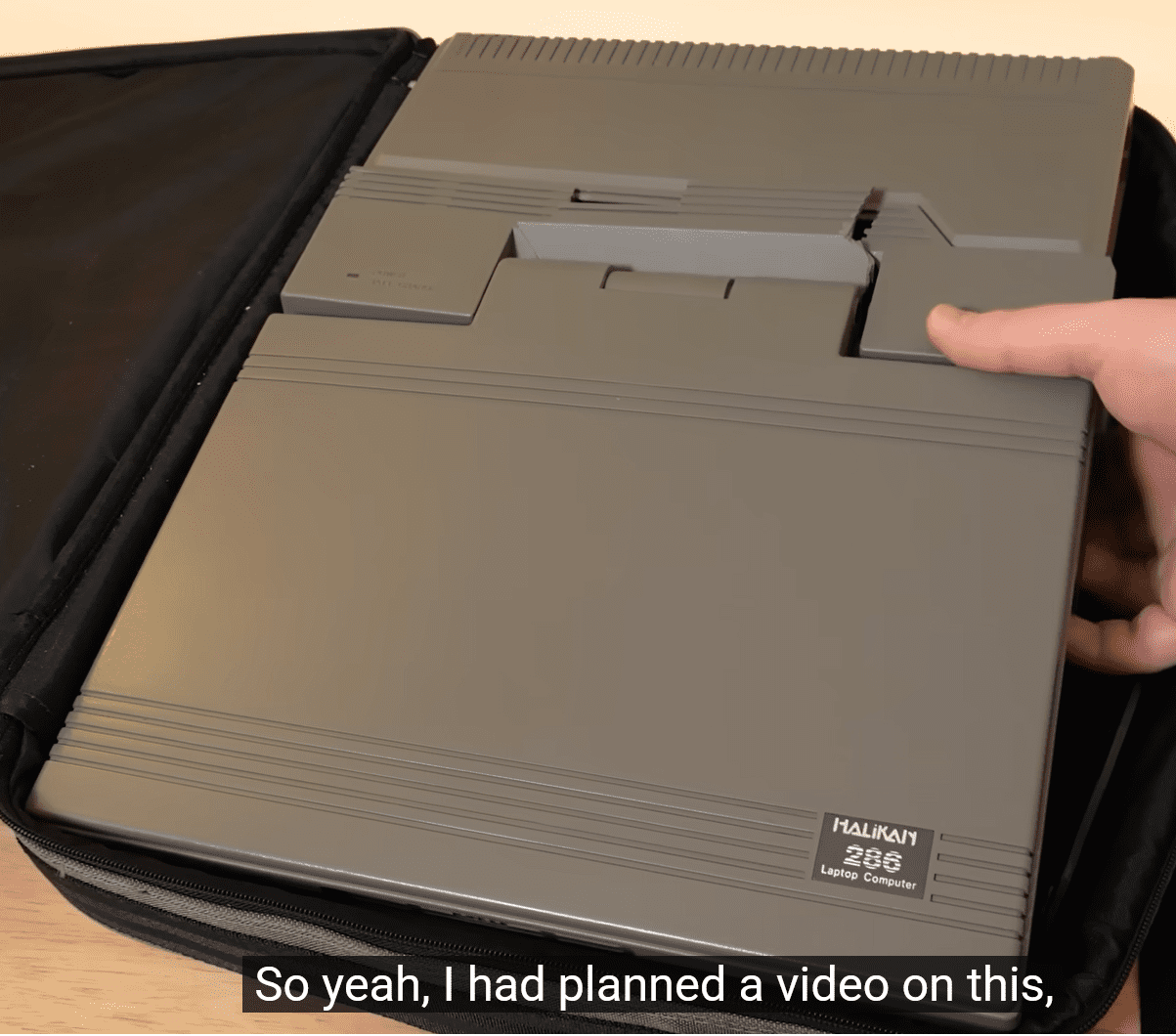

Also worth noting that this doesn't confirm that BFRs are the cause behind plastics yellowing. The Halikan's plastics looked more or less the correct color, based on original marketing photos I have. I'm not saying this isn't true, just that this particular testing doesn't prove/disprove that.
The Halikan's original broken plastics
