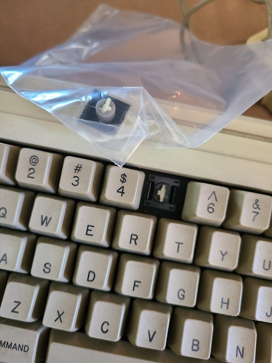

So, I had picked up a Lisa 2/10 a while back. and while removing the key caps for cleaning, the kegs on the Caps Lock key broke. I tried various methods to re-attach the existing legs, but was unsuccessful at getting them attached, at the correct height, and the correct angle. I even tried using heat to correct the angle and ended up melting some of the bottom of the key cap (don't use a heat gun!).
I have a 3d printer and almost no knowledge of 3d modeling, so what better idea is there than to try to replicate the legs and support section of the key caps!
I had a general idea of the sizes I was dealing with from other, intact key caps, so I modeled up 3 different variants at slightly different angles. I then hollowed out the underside of the key cap, put the 3 different leg replacements on my keyboard, and picked the one that fit the best and gave me the matching angle. I am actually not sure, but I think I used the 10 degree version for my Caps Lock key. Either way, I'd print multiple since they are quick to print. I then used plastic epoxy to secure the key to the leg replacement, making sure it was centered in the space with the surrounding keys.
If anyone else has broken legs on their Lisa keyboard, and still have the key cap, you can grab my 3d files here: https://www.thingiverse.com/thing:6287040
