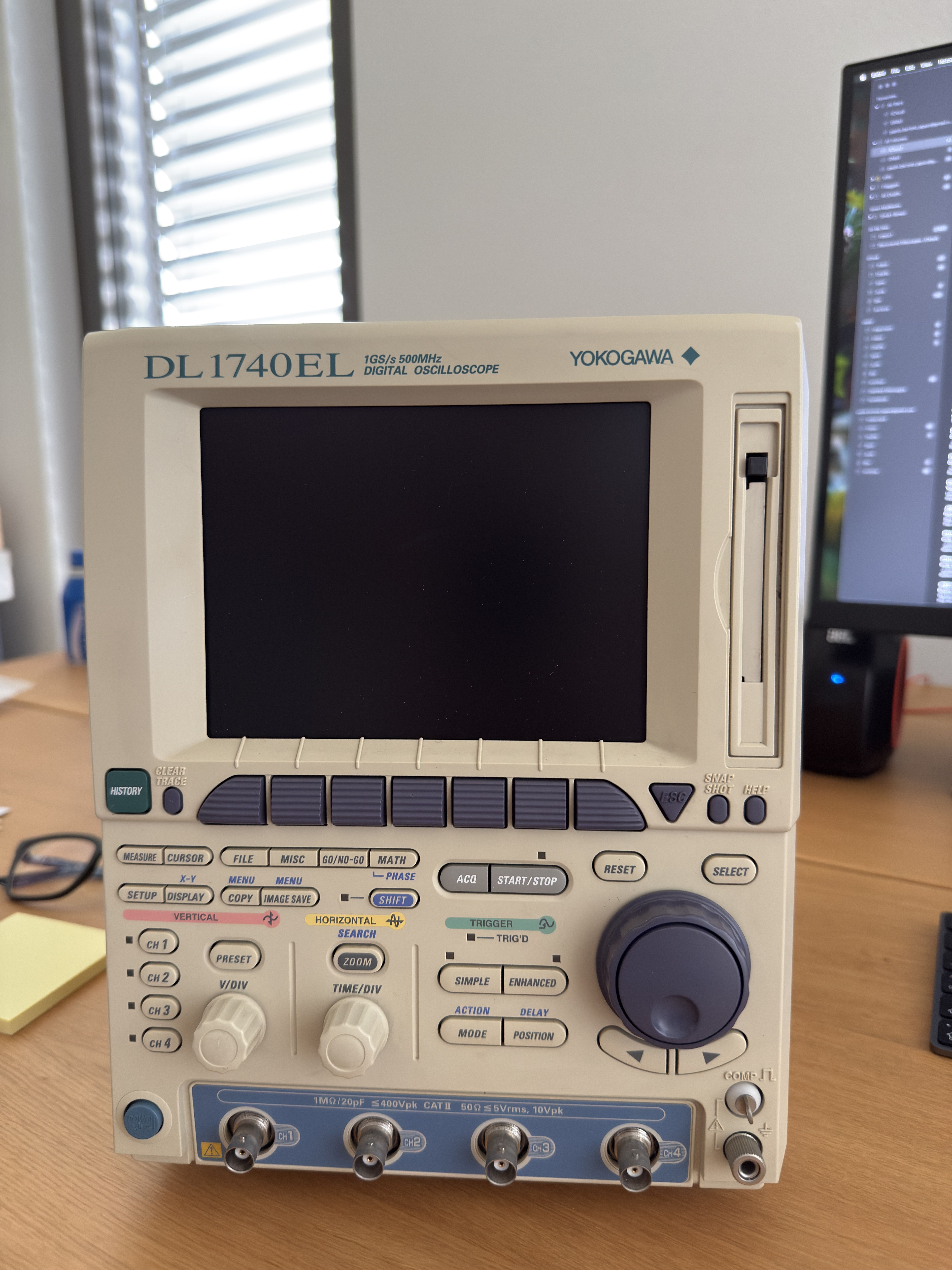

I have poor experience with those miniaturized scopes: they work, but they are indeed tricky to use in practice. Besides, you may probably need at least 2 channels.
So, on my end, not being a pro either, I eventually spent totally reasonable money (in the range of 120 USD) on a used, but still fully operational 500 MHz, 4 channels scope from Yokogawa.

...fully operational 500 MHz, 4 channels scope from Yokogawa.
500MHz!
I've actually never used a 500MHz scope outside my engineering school days. Even the scopes at the office are all 100MHz, as is my hacked Rigol. (In the stock state, my Rigol was only 70MHz.) Quite nice you got such a great bandwidth scope and a fine price point.

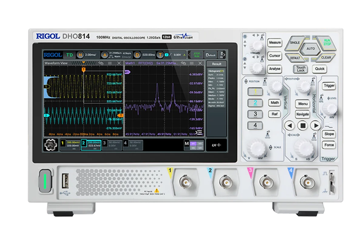

That RIGOL DHO814 vid had me drooling, but I might need to spend a bit on one of these entry level units to get the hang of it?
My primary concern would be buying something "just good enough" to fix a Commodore 64 when the slowest system I'd be probing would be a 16MHz SE/30 and really want to be able to at least do troubleshooting on a 40MHz IIfx level of performance.
Doesn't sound like the cheap ones come anywhere near that, so what's the fastest system on which they're of any real; use at all?

@Trash80toG4
I purchased the Rigol DHO804 in Dec. 2023 for $358.66 (free shipping to me in Japan) from this EEVBlog-recommended seller:
As you can see, the price is higher today from that seller, but searching for the DHO804 on AliExpress yields other sellers with lower prices, although I cannot say which of those sellers would be the most reliable and trustworthy, nor can I say what tariffs would be due for a US-based recipient.
I then upgraded it's bandwidth to 100MHz (and memory too) with the software-only hack described here:
After that, I added WIFI with the tricks shown here:
I have always used 100MHz scopes, in large part due to financial reasons. Even at the office, we use 100MHz scopes for the same reason. 500MHz is great, but it costs a lot more, and the times where we'd actually need 500MHz bandwidth are few, so we make do just fine with 100MHz.
The cost for what I bought is low enough to justify it as an entry level scope purchase, and yet, it's a pretty darned high level scope (12-bit), and with the hacks, you get outstanding value for the price. Four channel (4 probes) too! I use my rather often and haven't had problems with it. Some people complain the fan is a bit loud, and I will agree it's not silent, but since I don't work at the bench all day lone with the thing switched on, I've never found it to be an issue.
