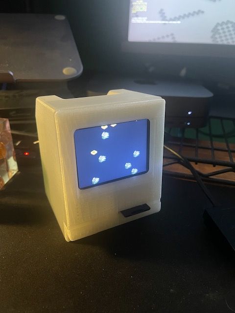

Here is my Tiny Mac running After Dark flying toasters:

fxgogo
Mar 8, 2022
22
15
That looks very cool. I have not delved into the world of 3D printing yet, but you results make me want to. The SD Card as the floppy is genius
