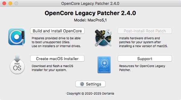

Main screen you should be familiar with.

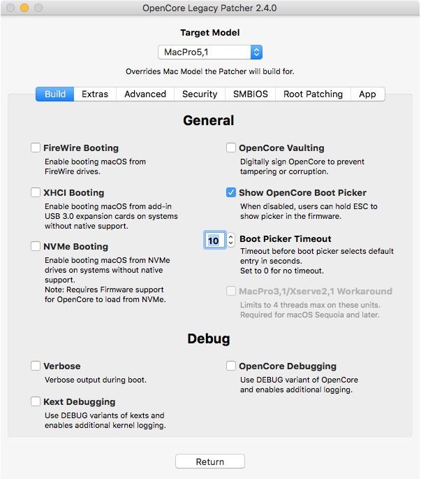

Your target model should be picked automatically. I assume MacPro 2012 is a MacPro5,1 ? You can always click the "settings" button and get to this and change it. Build tab is where your Boot Picker Timeout is located.

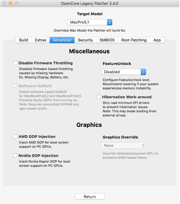

Advanced tab is where you can turn on/off GOP.

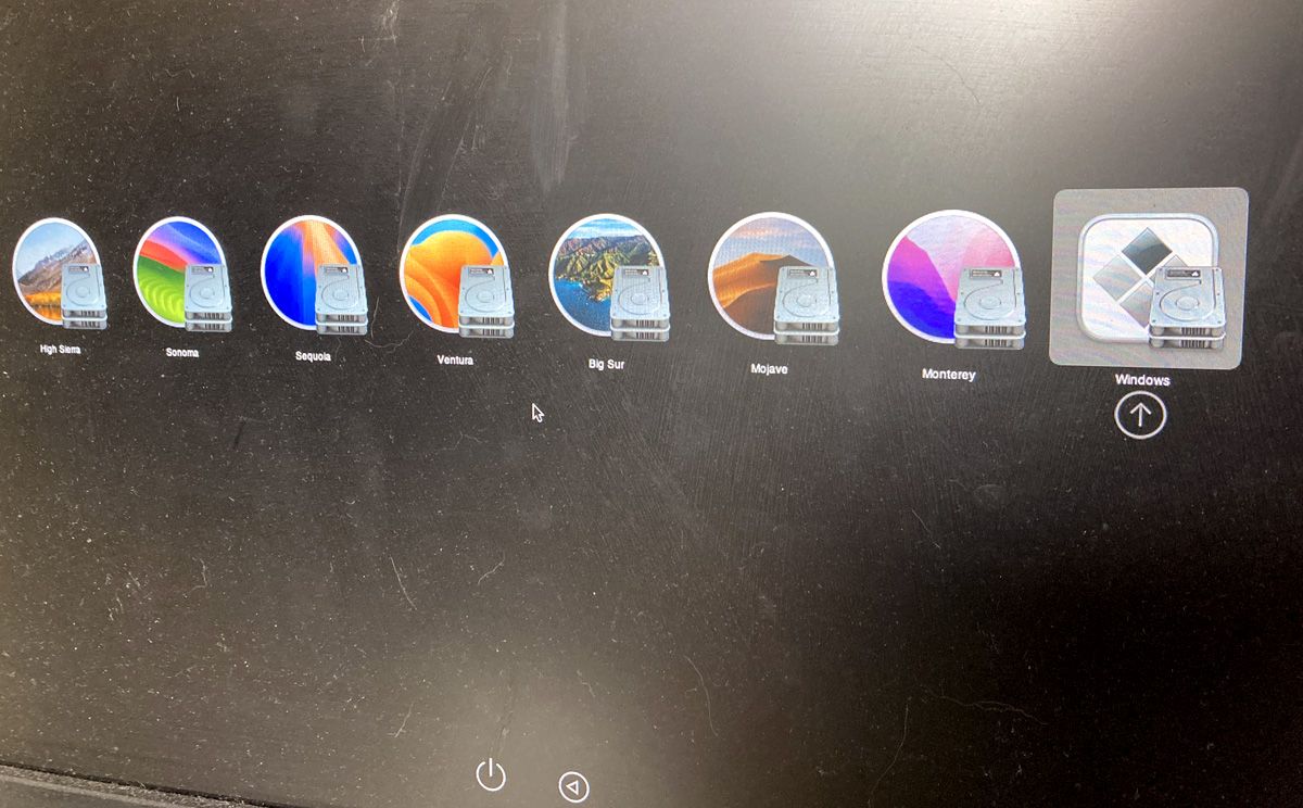

Last month I created a drive for a friend's 5,1 on my 4,1 upgraded to 5,1 ROM. Here is the bootpicker (all APFS Volumes, Windows was a secondary drive). These are not default icons, I added them to each Volume after installation.

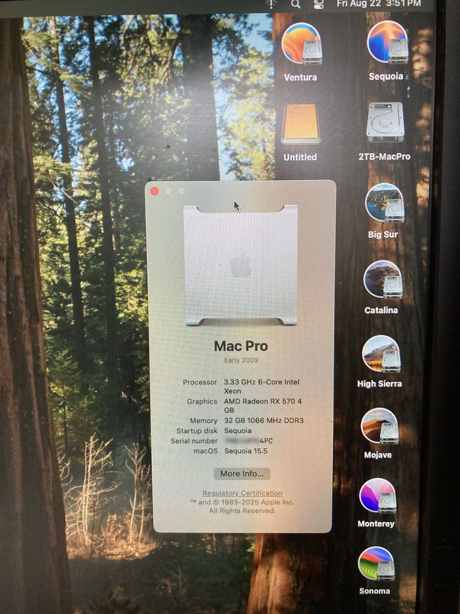

Booted into Sequoia. Once you have installed Sequoia, OCLP should pop up and tell you that you are running without root patches and offer to install them for you.
