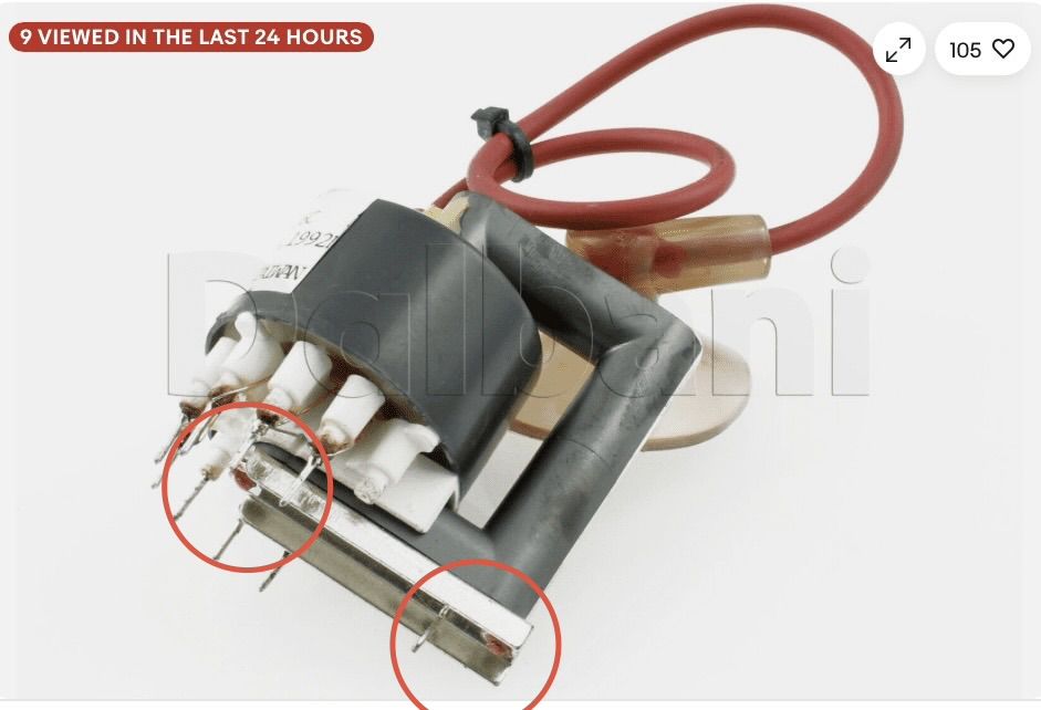

Wow. Those little guys have gotten nightmarishly expensive:
$150 👀

Just a word of warning - I purchased a flyback from Dalbani a few years ago - while it looked new, all the internal windings were melted/shorted together. I never got a refund either.
  • Sad

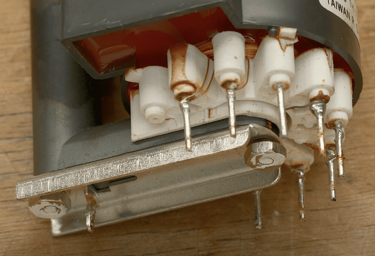

I never installed it because I checked the winding first.
Aha. Could you tell me how you did that? I tried using my multimeter to see if all the pins were shorted. I found some were connected one or more others, but I don't know which one should be connected, so I'm not sure what to make of that.
