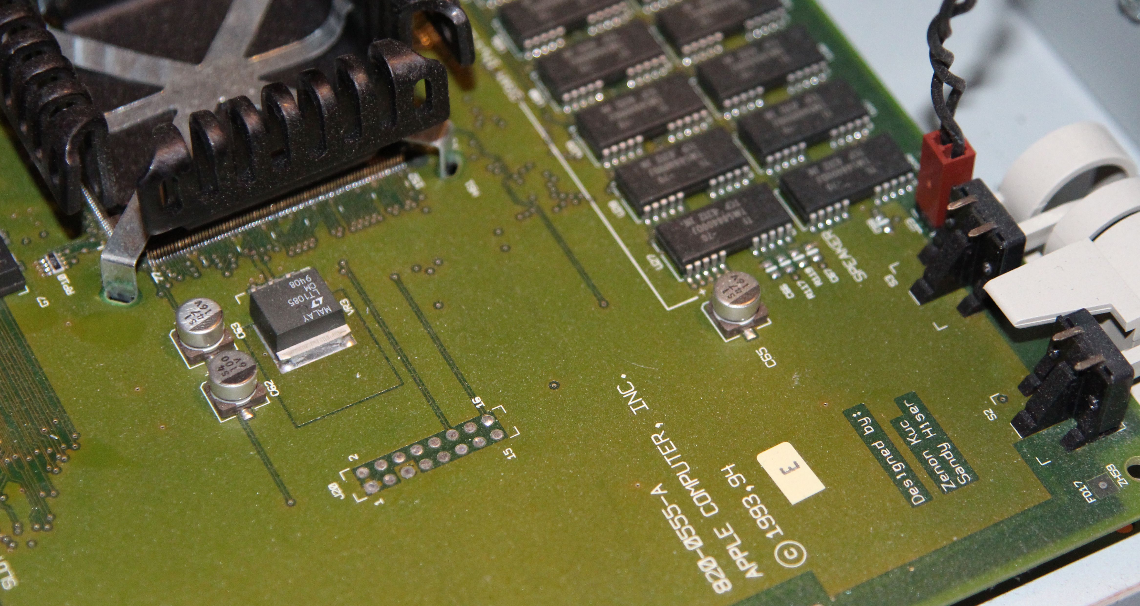

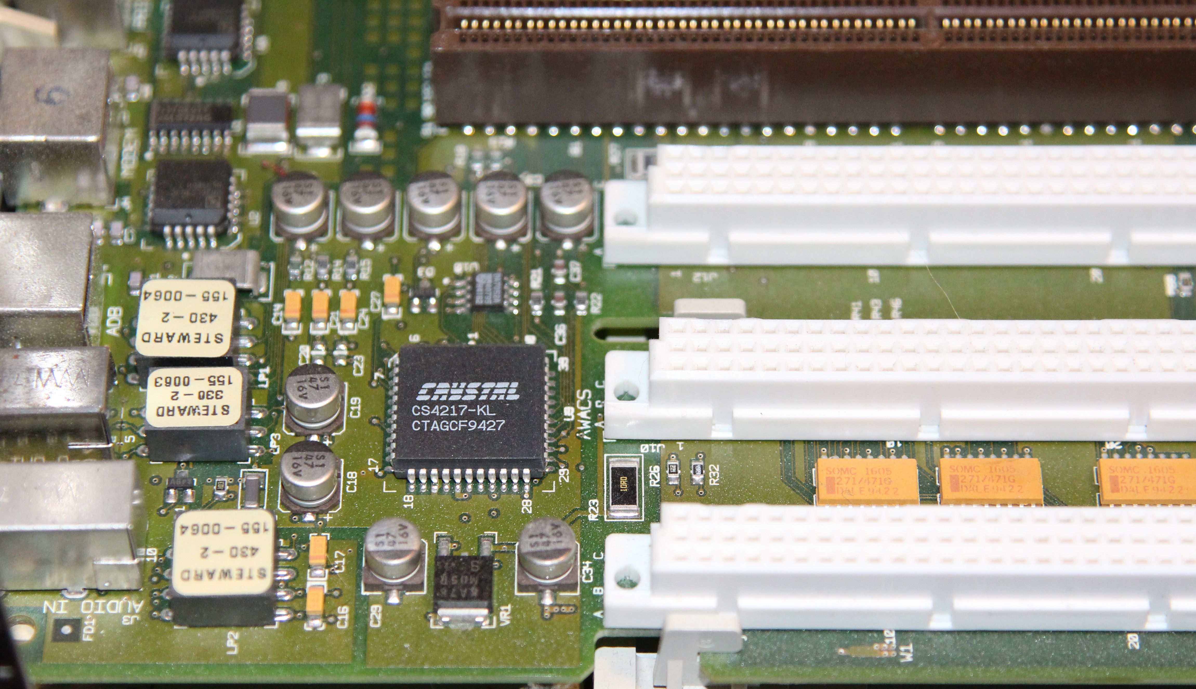

Since my 7100/66 was accessible, I pulled the cover and power/drives and took some photos for you.

Here's some photos of mine.
Mine looks quite similar to yours. So, not bad, it seems.
I see that Colin (TDNC) often performs an alcohol bath. Would that be good here? I used some canned air to blow off dust, but there's still room for improvement.
Any suggestions would be appreciated.
