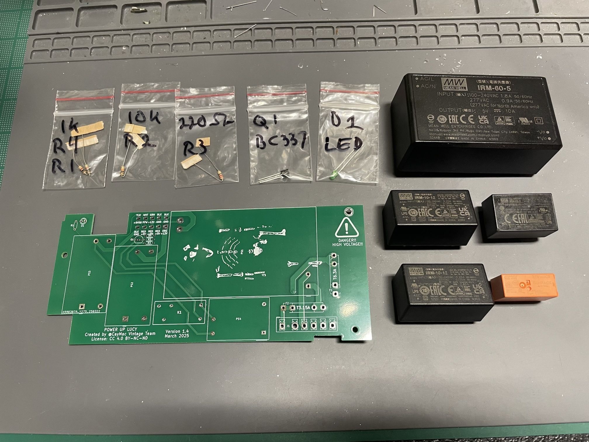

I purchased a couple of the IIsi Power Supply Replacement (Mean Well) PCB kits from CayMac Vintage a while back and wanted to post my build experience.
The kit included the resistors, transistor and LED, I purchased the 4 Mean Well power supplies and the relay from Mouser:
Qty 1 - IRM-60-5 (5V 10A)
Qty 2 - IRM-10-12 (12V 0.850A)
Qty 1 - IRM-02-5 (5V 0.400A)
Qty 1 - SPDT 12A 5VDC Power PCB Relay
I used these fuse holders:
Qty 2 - Littelfuse Fuse Clips ACS PC 5MM CLIP BRASS/TIN-PLTD
https://mou.sr/48qaT8l

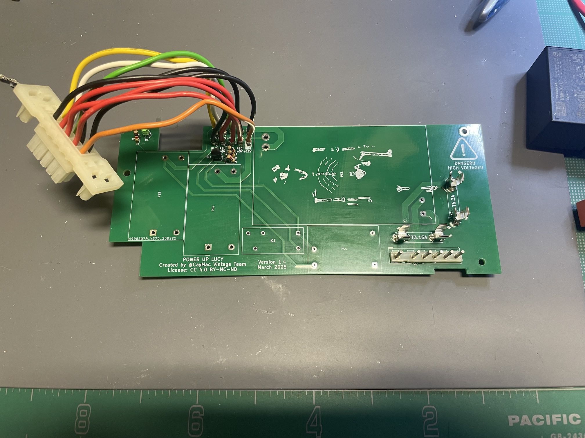

Here it is with logic board power cable harness and internal mains power connector (transferred from a dead original IIsi Sony PS, APS-06, 699-0567) plus the kit resistors, transistor, and LED as well as the fuse holders soldered in:

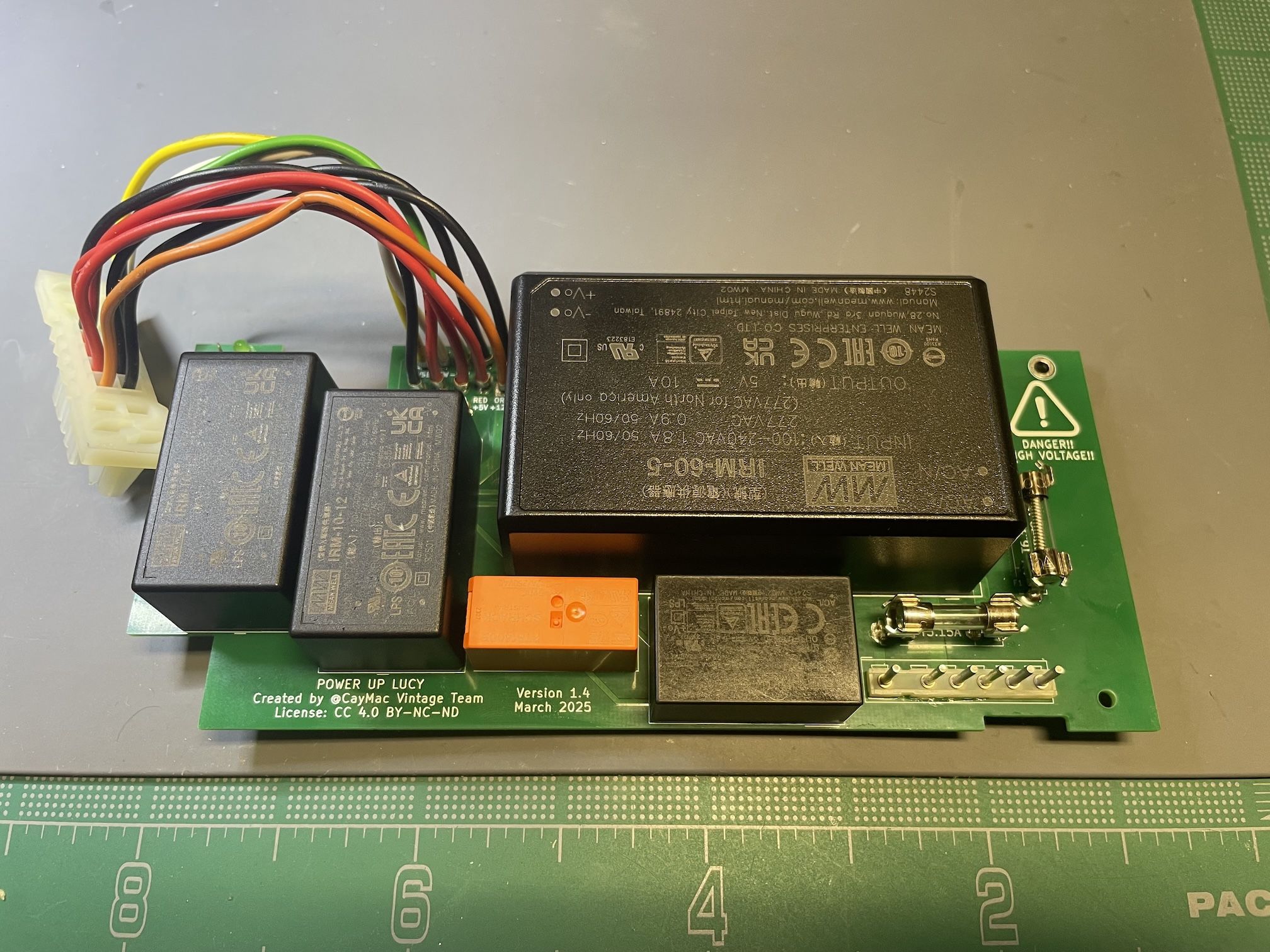

And with the Mean Well power supplies and relay installed:

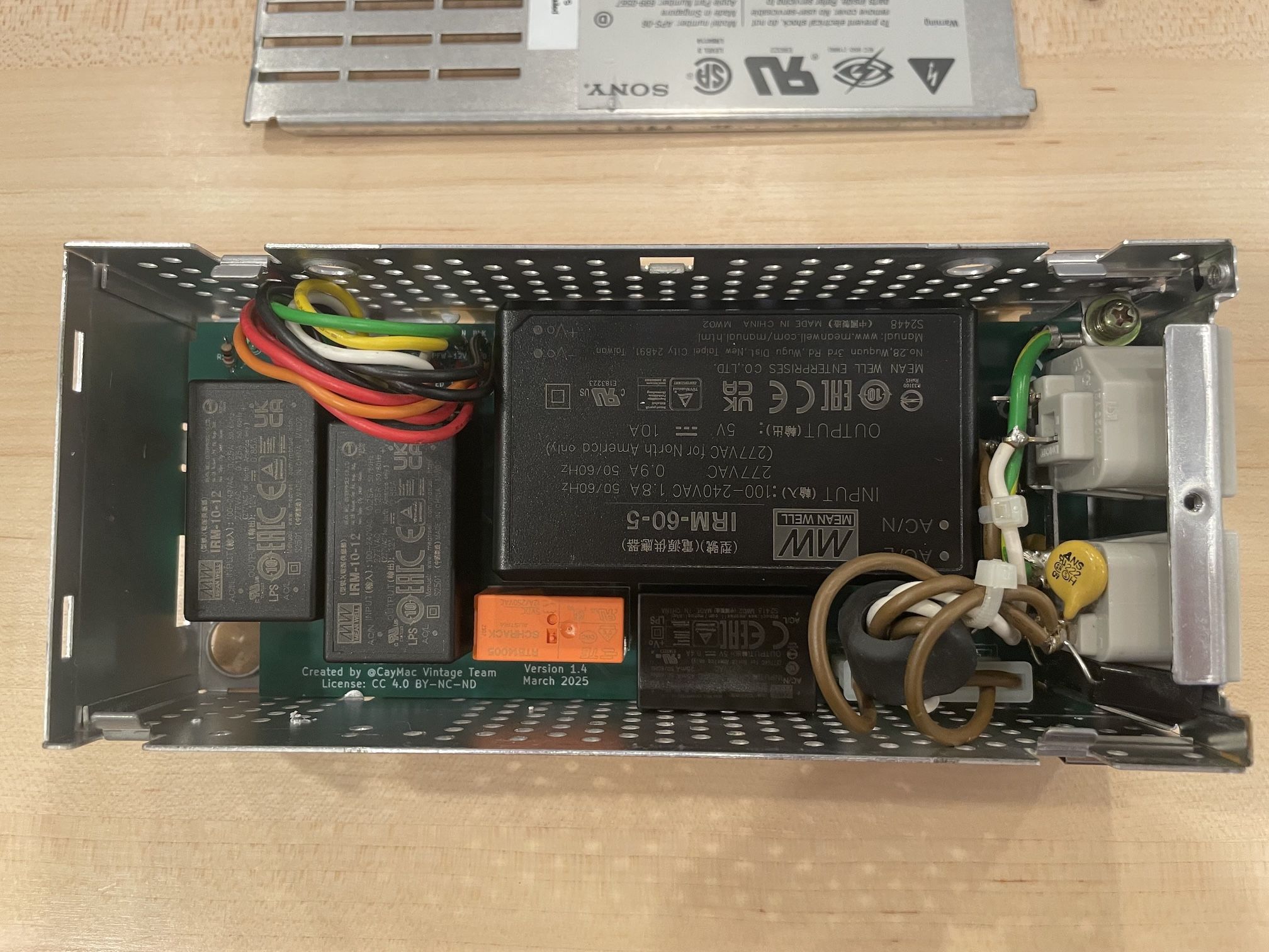

And mostly buttoned up in the case from the dead original PS:
On first test it seems to work just fine! ADB keyboard power-on, software shutdown, relay control of pass through power to monitor. This was in a fairly stock IIsi, 17MB RAM, slightly newer 80MB IBM SCSI HD and with the 25MHz clock crystal swap. I do want to test further with various PDS cards I have. Will report further in this thread when I get to that.
