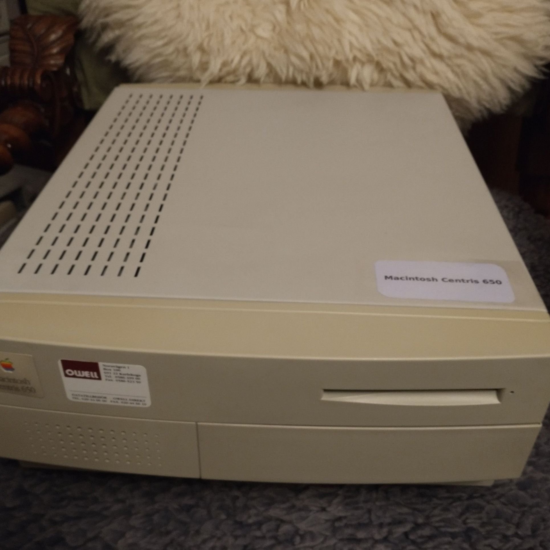

Found a Centris 650 online. I read on wikipedia that the base model does not come with fpu. But I want to run A/UX on it, how would I go about asking a seller about that? Or are there any good tells from the exterior that it has an fpu? Pictures in this ad here:

Hello,
Based on the photos in the listing, it says 16MB of RAM, and one RAM slot is populated. I don't know if a 12MB SIMM exists, so I assume it is an 8MB SIMM in the socket and 8MB on the motherboard... leading me to believe the FPU is integrated. There are 2 SIMMs in the Video RAM slots, so that is upgraded as well.
** O D D D U C K ** - In the photos, it appears there are 5 RAMS slots, all other references only show 4. So this is either a prototype, or somebody has done some work to it. Most references show the 4 RAM slots and an unpopulated pad area next to them where this 5th one appears. It appears that this 5th slot is a ROM socket. Being this listing is from the EU, maybe someone added that socket and did some experimentation on it. While this reference says "Most Centris/Quadra 650's have an unpopulated ROM SIMM socket (but not all, some early models have a socketed ROM)", which may mean it is an early model, I still believe it has 8MB on the motherboard and has an integrated FPU.

Thanks. I agree. The 230MB original Apple drive points in the same direction. It was for the higher spec models.
The ROM-socket is a funny one, since it is obviously running with it unpopulated it uses soldered on ROM. I wonder if I can just populate the socket with a ROM and it runs it from there. It can be a funny machine then....

This unit has the on-board Ethernet (connector to the right of the SCSI port), which I’m 99% sure means it has the full 040 with FPU, rather than the LC040 without.
