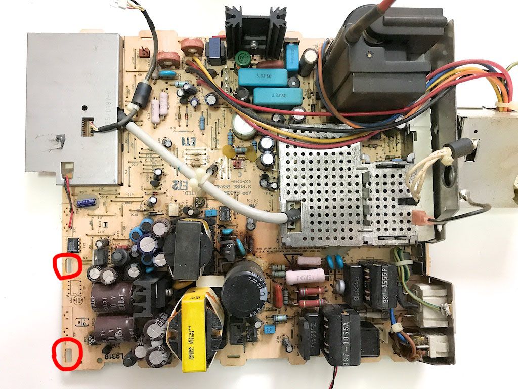

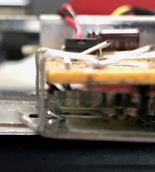

As you can imagine seeing all these random problems freaked me out a bit, so I pulled the board out, checked it over again, cleaned it again with some alcohol and soft toothbrush. Re-inserted it - and it worked! - once. Next bootup was again back to screechy speaker sound and no image. Eventually I realized that this may all be happening because the two metal tabs holding the analog board to the ground shield are slightly bent in such a way that they are pushing against the front case plastic, and angling the board out ever so slightly, and the connector was acting up.
So before you start to despair when the AB recap goes wrong, make sure you straighten out those two tabs perfectly, and insert the board in firmly - and once it works, don't touch it anymore
I really wish there were some locking tabs/screws between the case and the AB, but I guess when the back case is screwed back on, it does push the board in firmly - at least I hope it does.
Make sure the vertical portion of these metal tabs is not bent outwards:
