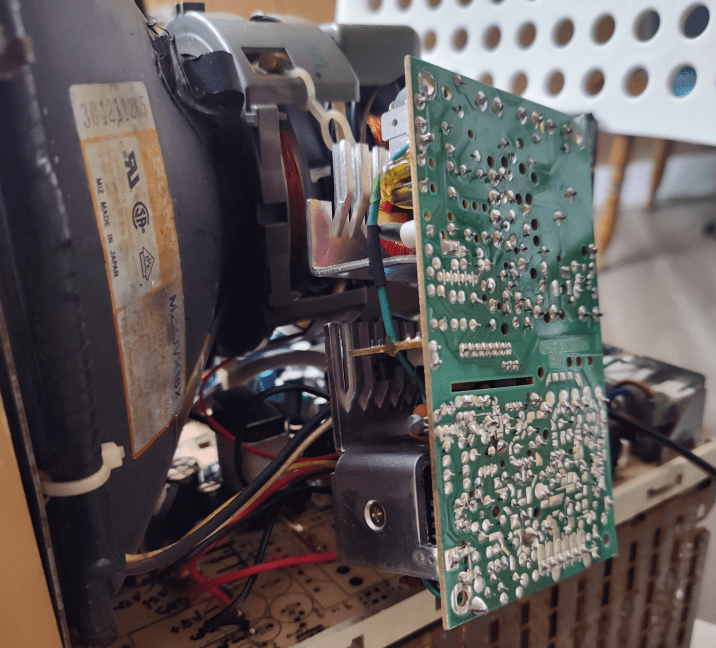

Took out the analog board again tonight for more measurements, turns out there's no voltage at all on TDA4605's pin 6, which should be charged by RP23 on power up:
Checked RP23 and it's showing correct resistance matching color rings. CP34 and TDA4605 has already been replaced. On the other end of the trace it goes to a transistor connected to the optocoupler on crt's power supply section. Checked the transistor and it's not shorted, the optocoupler is new and crt section is working fine, so I guess I can rule this part out.

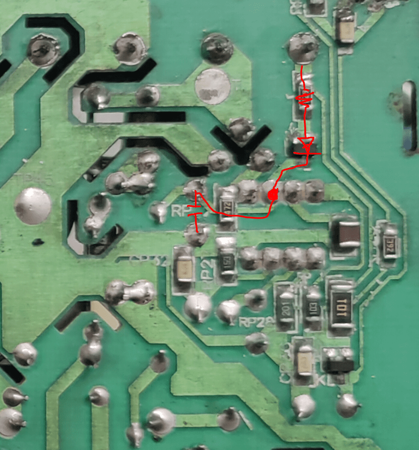

Next I tried to bridge power supply's TDA4605 pin 6 to CRT's TDA4605 pin 6 to jump start it. However this pulled down crt's TDA4605's pin 6 to around 2v and it stopped working as well..

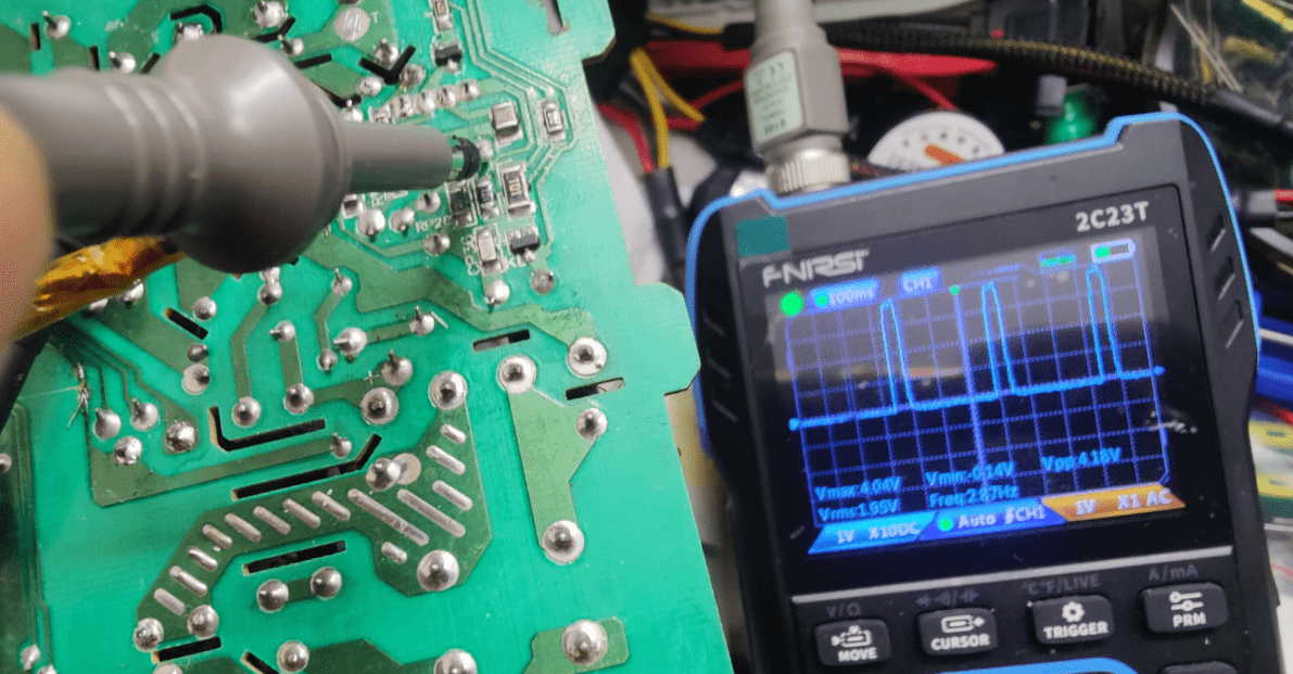

Next I tried to cut the trace that goes to the transistor. This sorta worked, voltage on pin 6 jumped to 10V on power up and power supply tried to start, then it started to make ticking sound at around 3Hz:

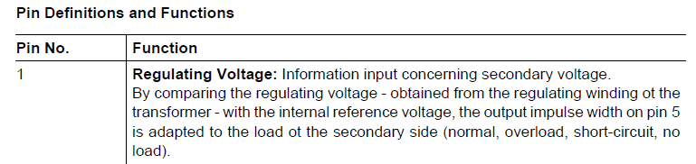

Checked pin 1 on TDA4605 which is voltage regulating pin according to datasheet, it jumped to around 4V for a brief second, which I think triggered the power ic's overload/short circuit protection:

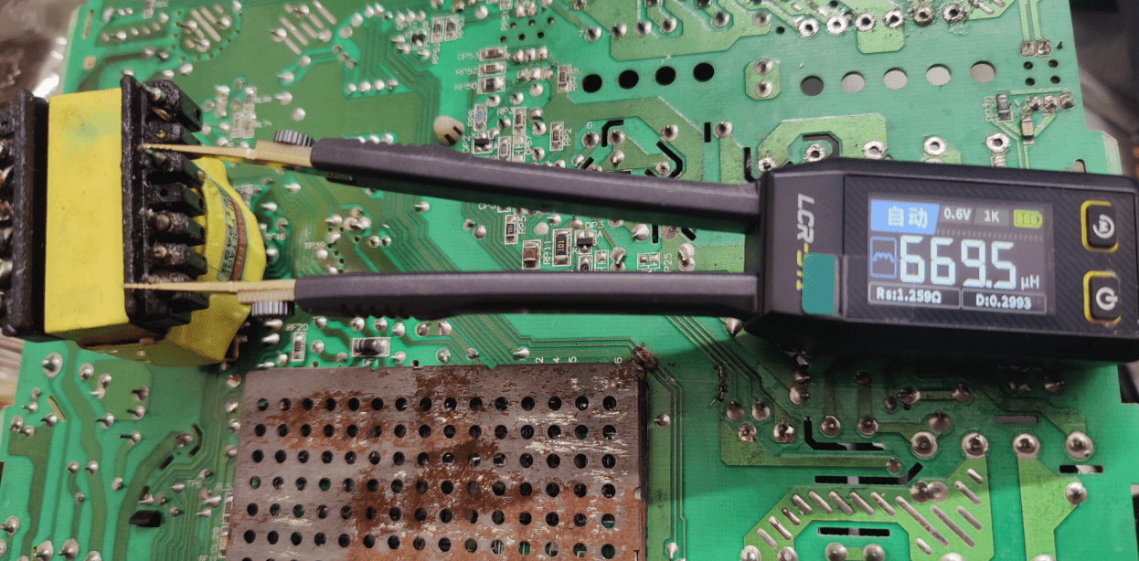

I even desoldered the transformer and measured inductance of each winding, no shorts:

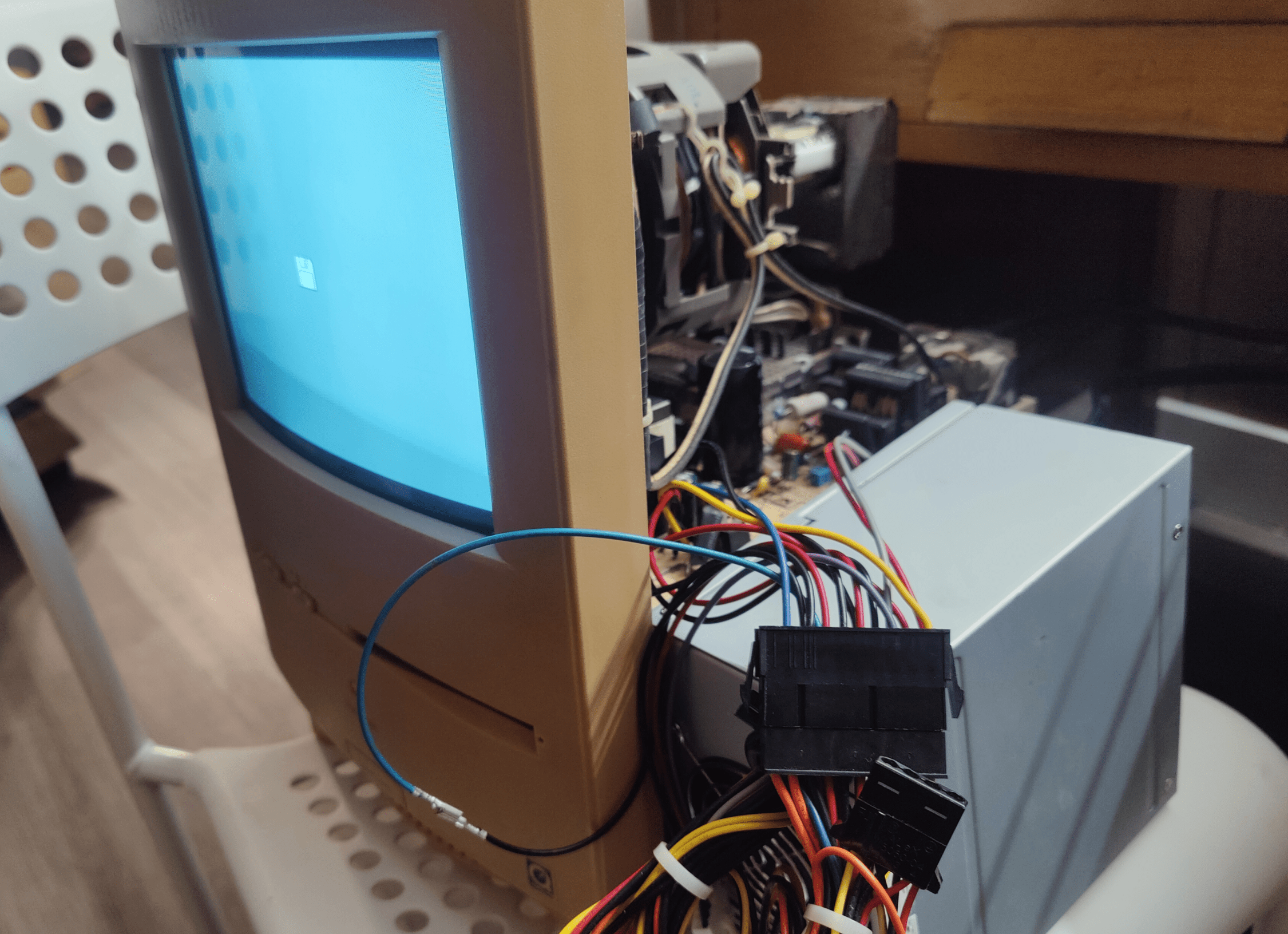

Ok it might seem ridiculous but I got it working!
Bypassed the power supply section (desoldered transformer and switching mosfet) and connected 5v/12v/-12v capacitors to an atx psu, finally something showed up on screen. The image still has some stability issues and has hour glass distortion in the middle. Also need to order a picopsu and figure out how to implement soft power, but at least it's working now

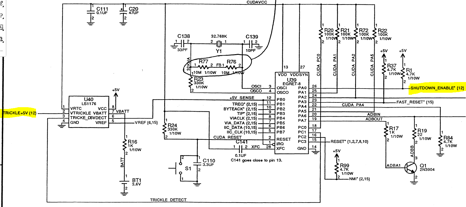

- The standby 5v powers CUDA, which senses the power button on keyboard and sends A7 - SHUTDOWN_ENABLE signal to the optocoupler. If main power supply doesn't provide 5v/12v within ~2s, SHUTDOWN_ENABLE will become low again.
- The trace I cut previously is indeed for soft power control. If SHUTDOWN_ENABLE is low, the transistor controlled by optocoupler will short the capacitor on TDA4605's power pin to ground and prevent the switching ic from working. If SHUTDOWN_ENABLE is pulled high by the logic board, the capacitor will be charged up through RP23 till it reaches TDA4605's power on threshold, then TDA4605 will take over and charge CP34 with the auxiliary winding from the transformer.
For some reason, the SHUTDOWN_ENABLE signal is kept low on my analog board, which prevents the main power supply from working. By cutting the trace I mentioned on first post, soft power control should be bypassed, but it still doesn't power on and keeps triggering protection mode of the power supply ic (i think)..

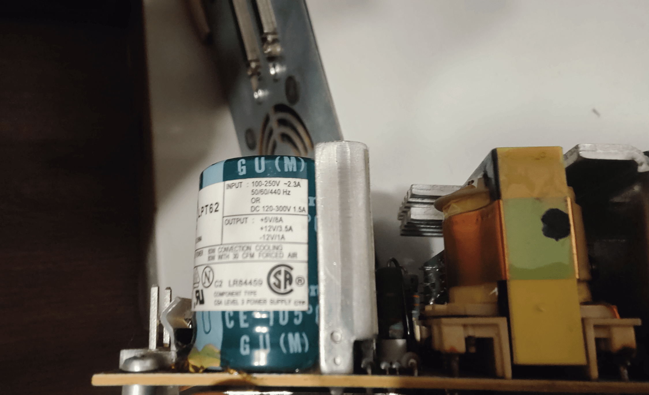

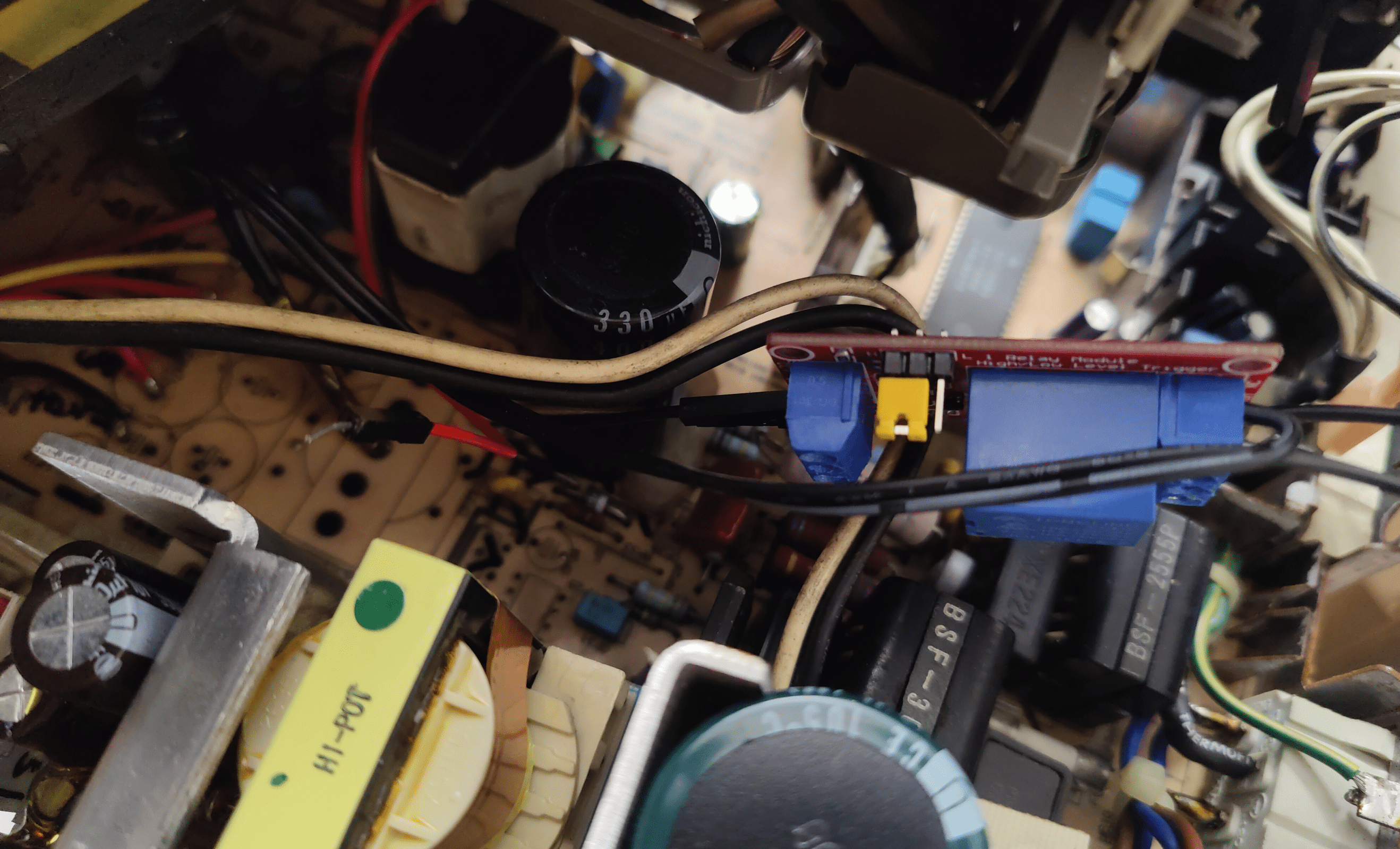

Found this thing inside a Lacie external SCSI drive box, it does 8A on 5V, 3.5A on 12V and conveniently -12V as well, saves me some space for another 12V power supply or an isolated dc-dc module:
Hacked it inside the color classic and it worked!
Well it kinda worked, as only about half the time the CRT turns on when I flip the switch, rest of the time I can hear high voltage sound for 1-2 seconds but then CRT shuts off, but logic board is still on and I can see scsi activity. Guess it's some weird timing issue? Like the CRT power supply needs to be ready before you can switch on the logic board and feed the video signal? In the original color classic you have to wait 3-5 seconds after you connect mains power before you can power it on using keyboard, maybe it's something similar?

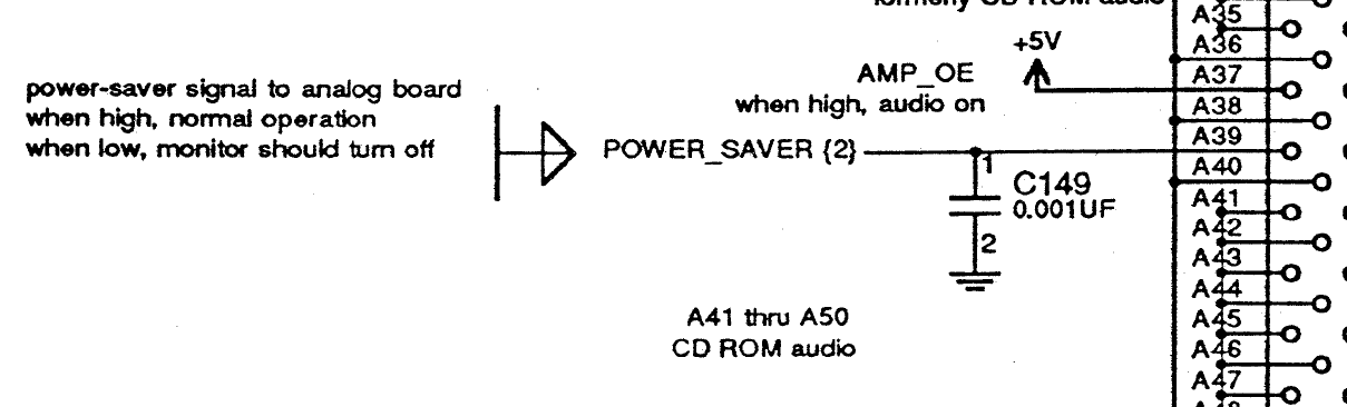

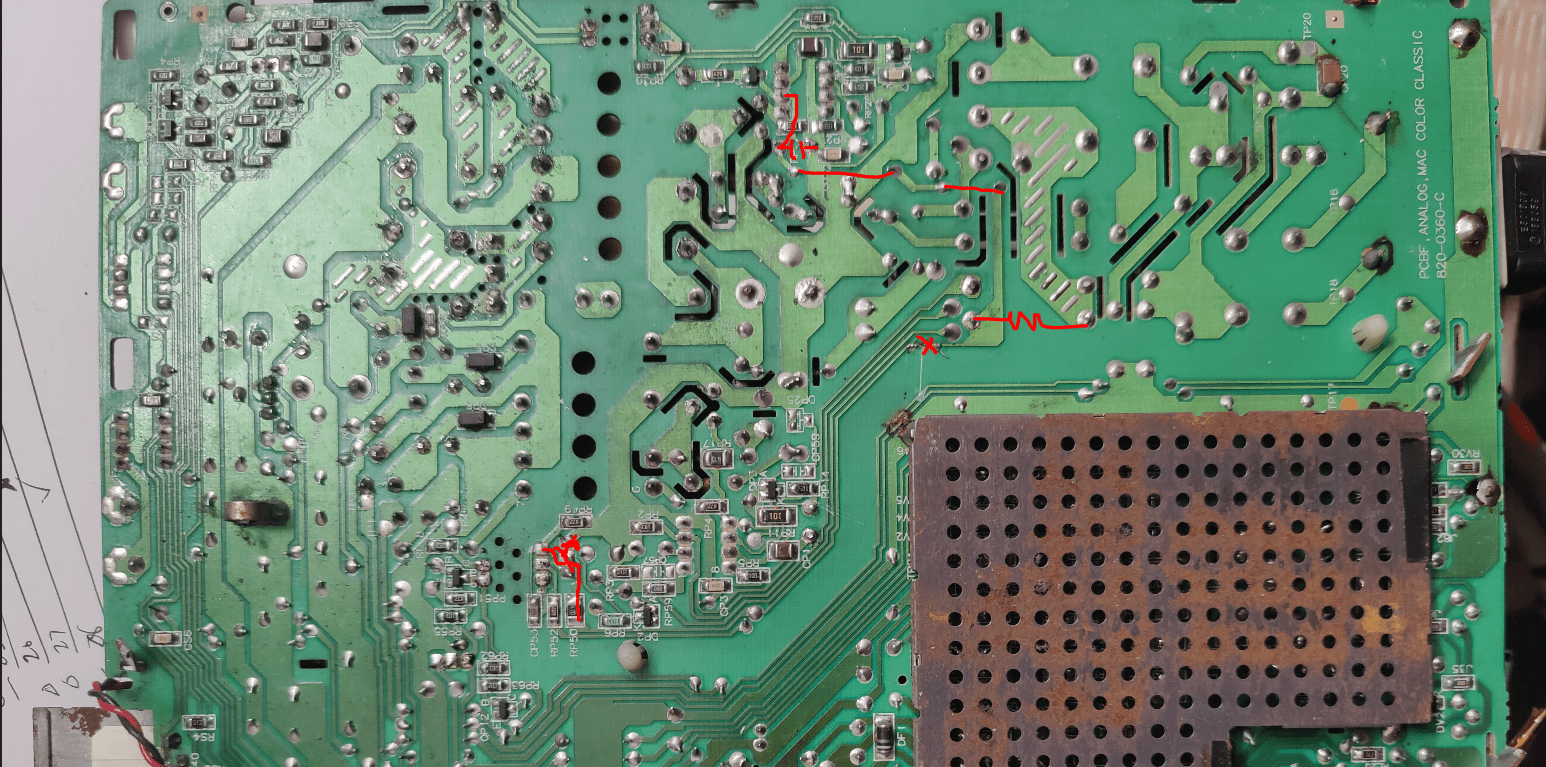

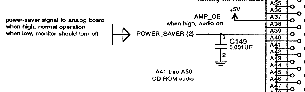

Long story short, after replacing all zener diodes and power resistors as suggested, the crt won't turn on at all. All voltages are present and logic board is booting, but no horizontal output at all. After more digging it turns out the CRT part also has soft power control:
My logic board can pull A39 high when powered on, but on analog board this signal is pulled to ground for whatever reason, which also pulls pin 41 and 42 on XC1186B to ground. I believe these 2 pins are soft power control for the jungle/deflection ic, so I just cut one jumper wire and added a pull up resistor to main 5v power supply, now CRT works perfectly fine. Also I traced the wrong pin of SHUTDOWN_ENABLE signal previously, after fixing it now soft power also works.
