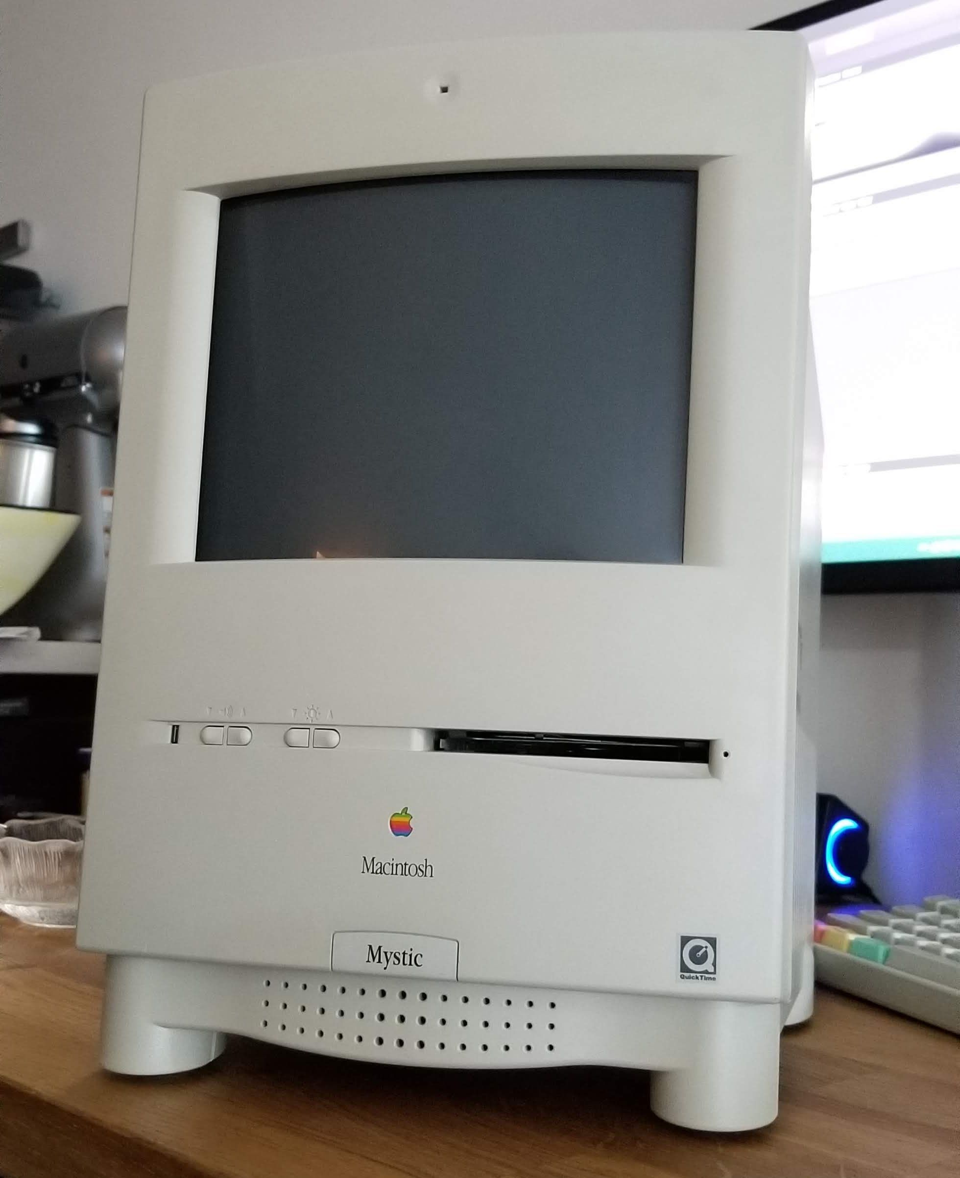

Experimenting with some waterslide transfer paper I was able to produce a nice looking custom bezel for my color classic II.
(This unit is using a seperately purchased LC575 board with resistor swap, I still have the original parts.)
The above waterslide paper was about $15 on Amazon, Once the Apple Garamond font was printed I used clear enamel to brush a thin layer over the print, this protects it from the water and potential bumps/scratches.
Smith & Nephew medical adhesive remover was used to remove the silkscreen from a spare Color Classic bezel with great results.
The finished product is better than I honestly expected and adds a good touch to the work I've put into this machine :)

That looking slick! Water transfer paper is awesome stuff :) It's definitely the way to go if you want it to look like it came like that from the factory.

Very nice work ! I need to experiment with water slide decals. I didn’t really know what they were called until now!

That looks amazing!! Is there a way to 3D print this, or is this a better method?
I'm sure someone here may be able to tackle a reproduction, I could certainly match the specs in my resin printer. I just happened to have a spare bezel from a shipping explosion Color Classic :(
