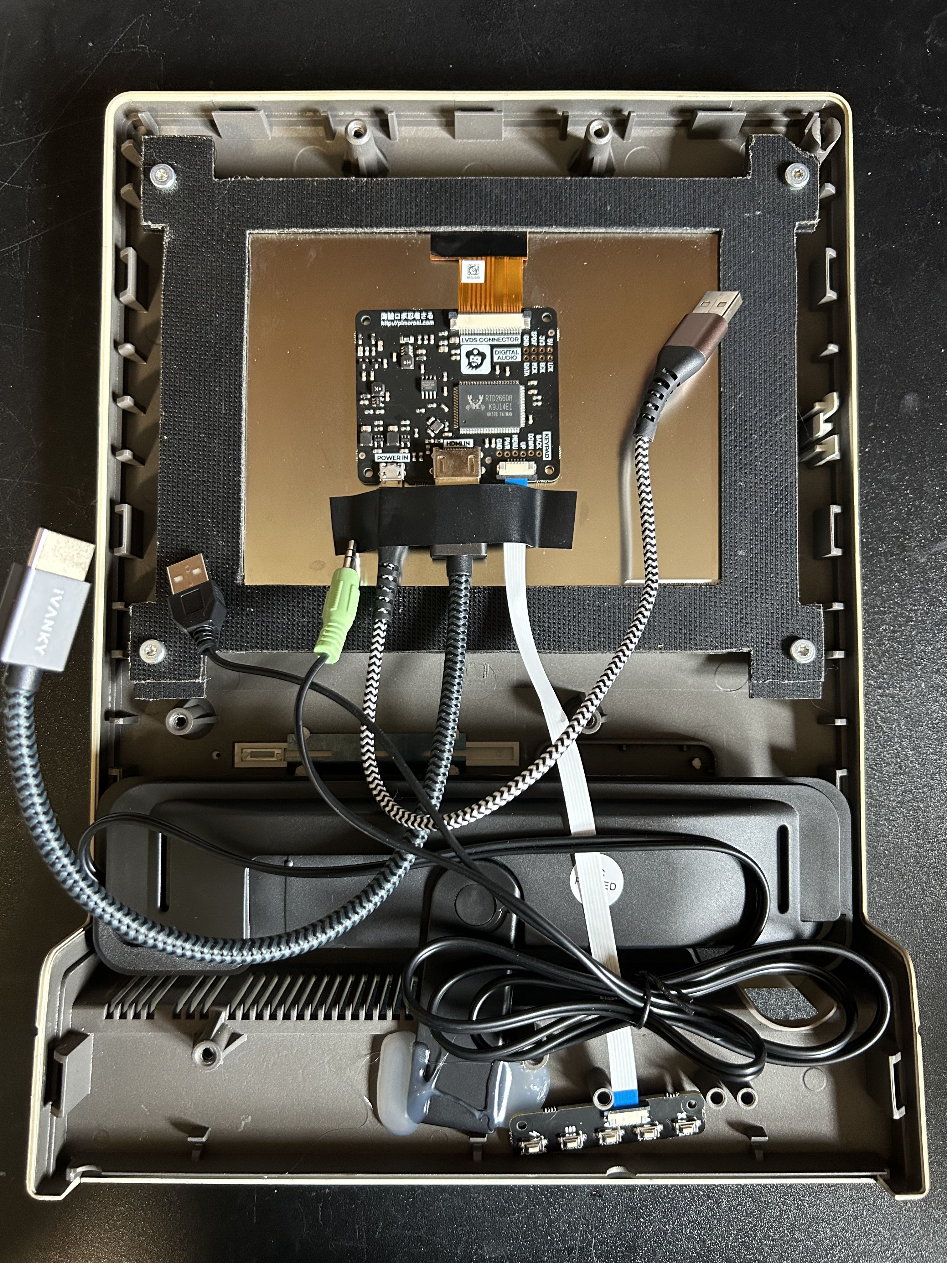

The 8" color LCD screen is available from Digikey. The monitor bezel can be downloaded from Thingiverse here and 3D printed.

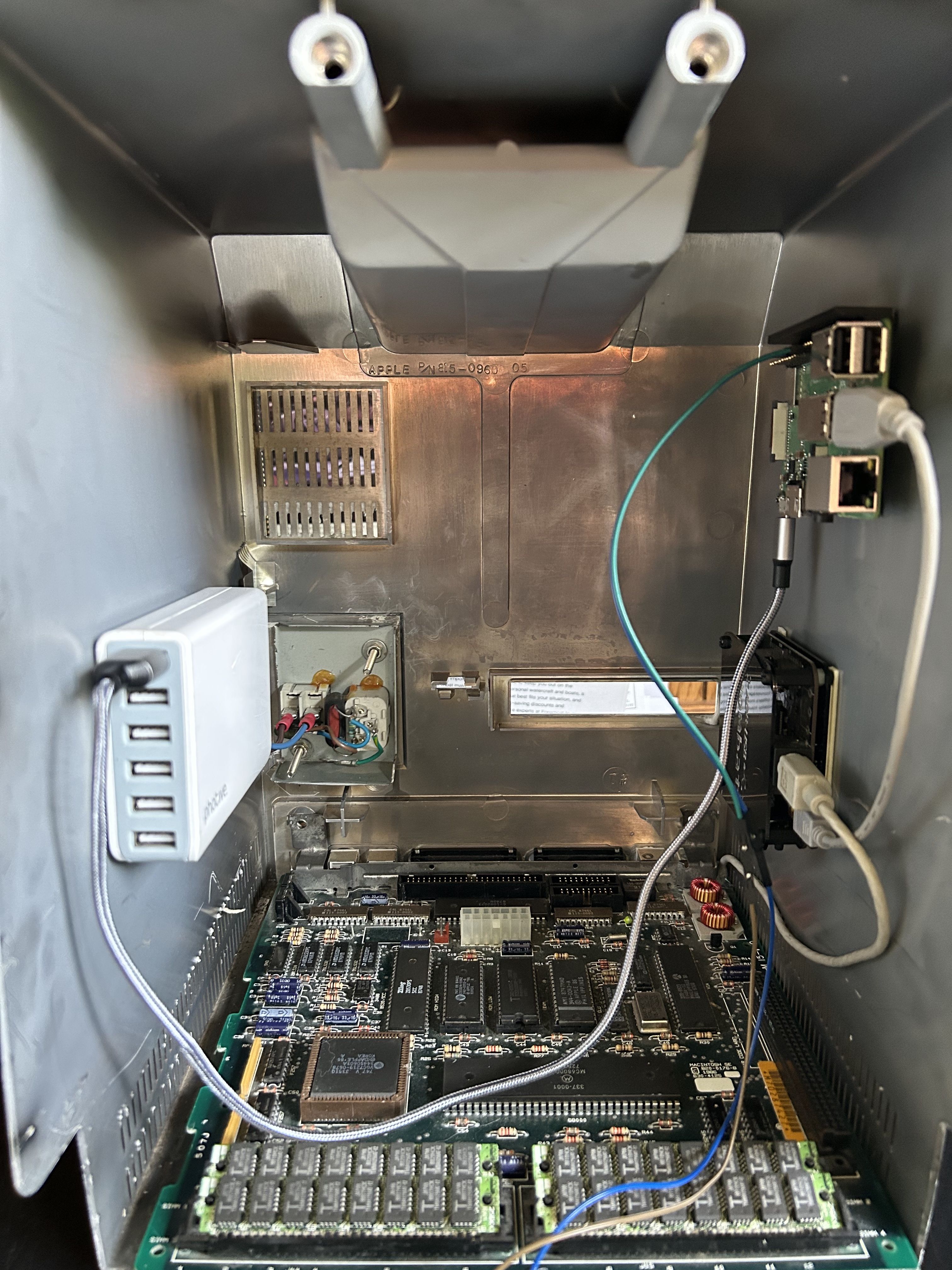

Everything is powered by the USB hub which is wired into the original power switch. I 3D printed a side bracket for the Pi, and everything is stuck to the side of the Mac with double-stick tape or hot glue. The Wombat on the right converts ADB to USB for the Pi. The sole purpose of the SE logic board is to provide an ADB input for the Wombat (and plug up the ports in the back).

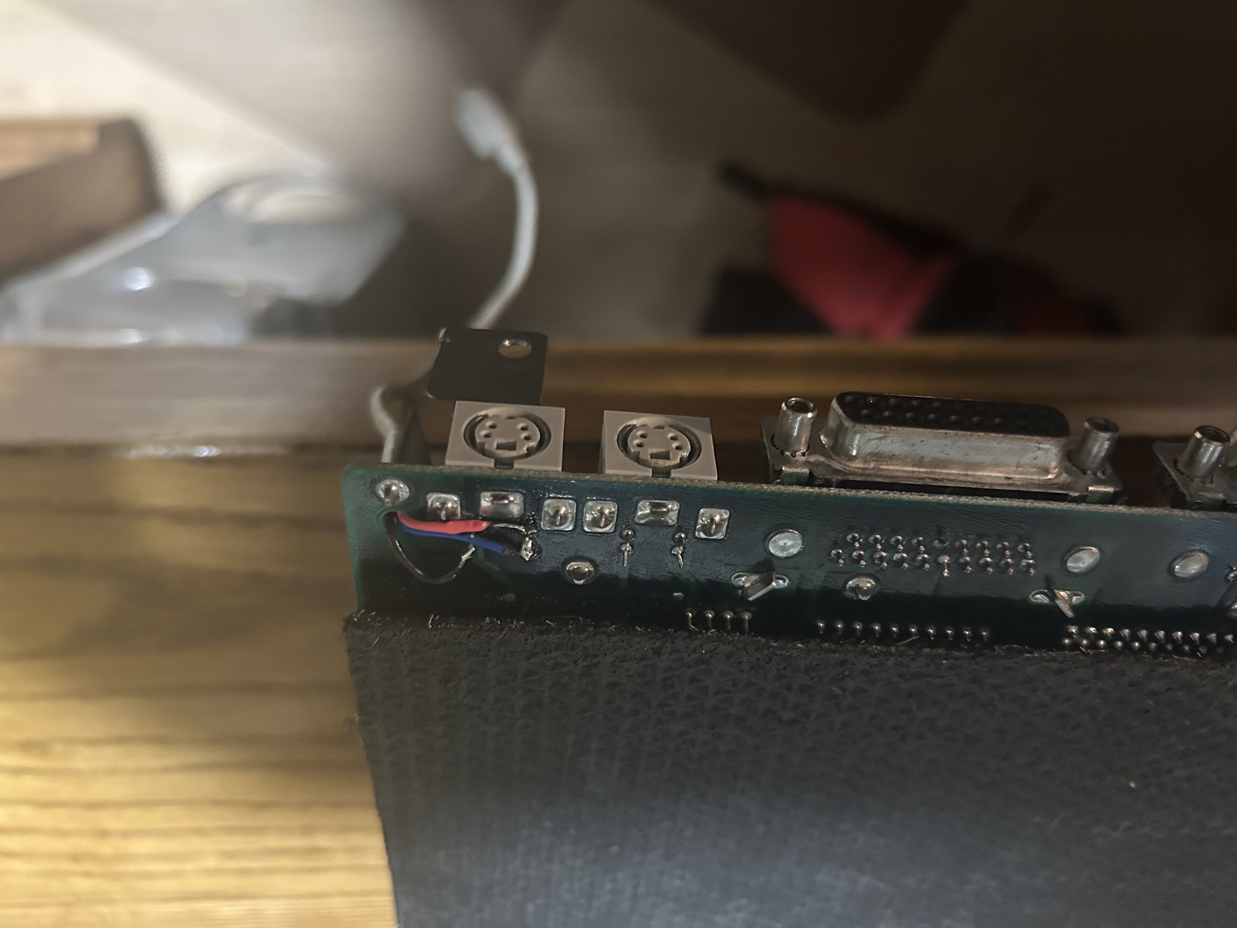

Here's the wiring from the ADB port to the cable that goes to the Wombat.
Here's the backside of the front of the machine with the two-piece bezel holding the monitor in. I hot-glued in a Syba USB-powered stereo speaker bar that I got cheap from Amazon. There are probably some better options out there - I'd go with one that has a volume control since Basilisk II doesn't save volume settings and it's really LOUD when it boots up...

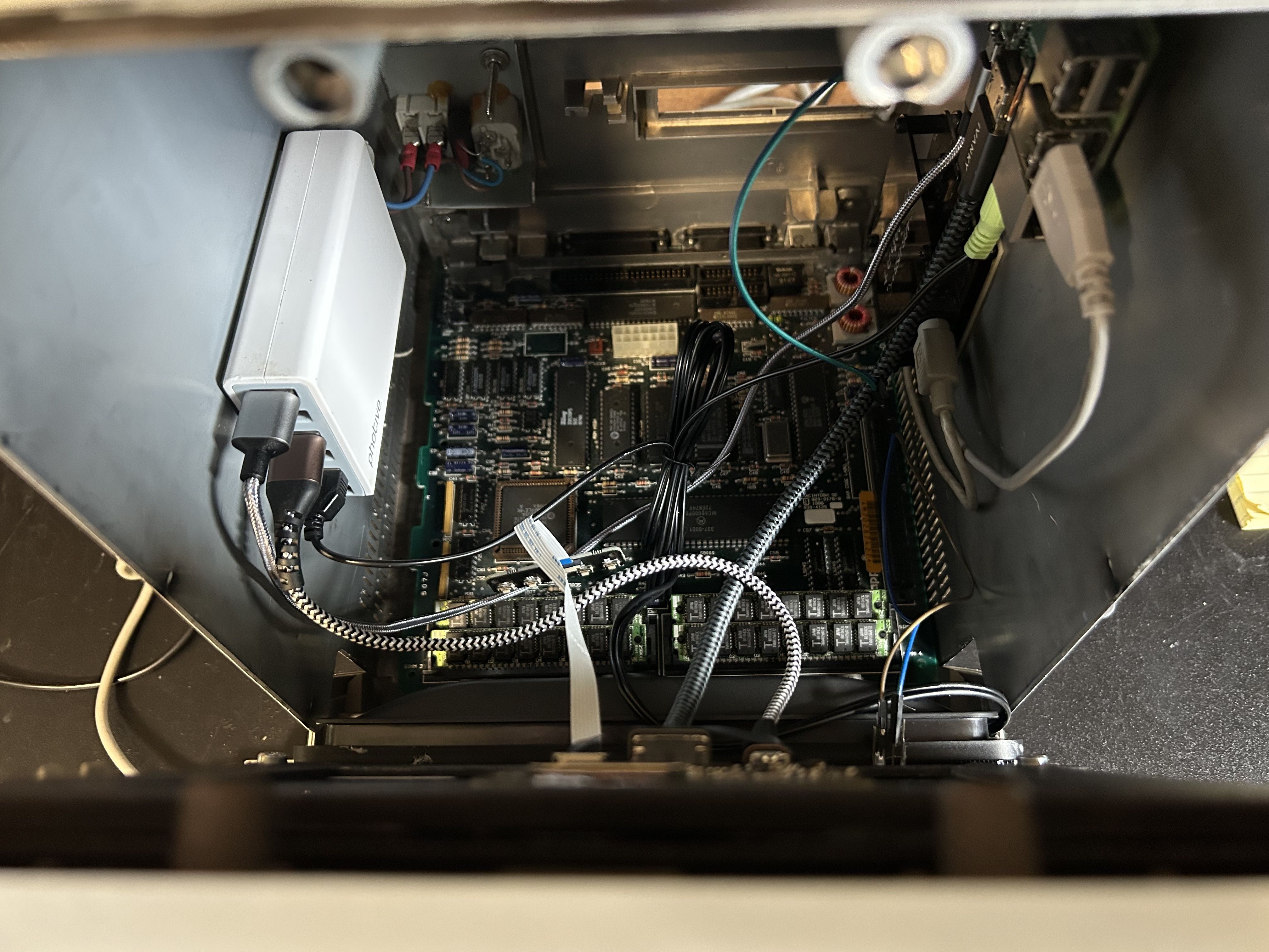

Here's a peek inside with the front semi-attached. I wired up an HD activity light from the GPIO of the Pi by using instructions from this site.
