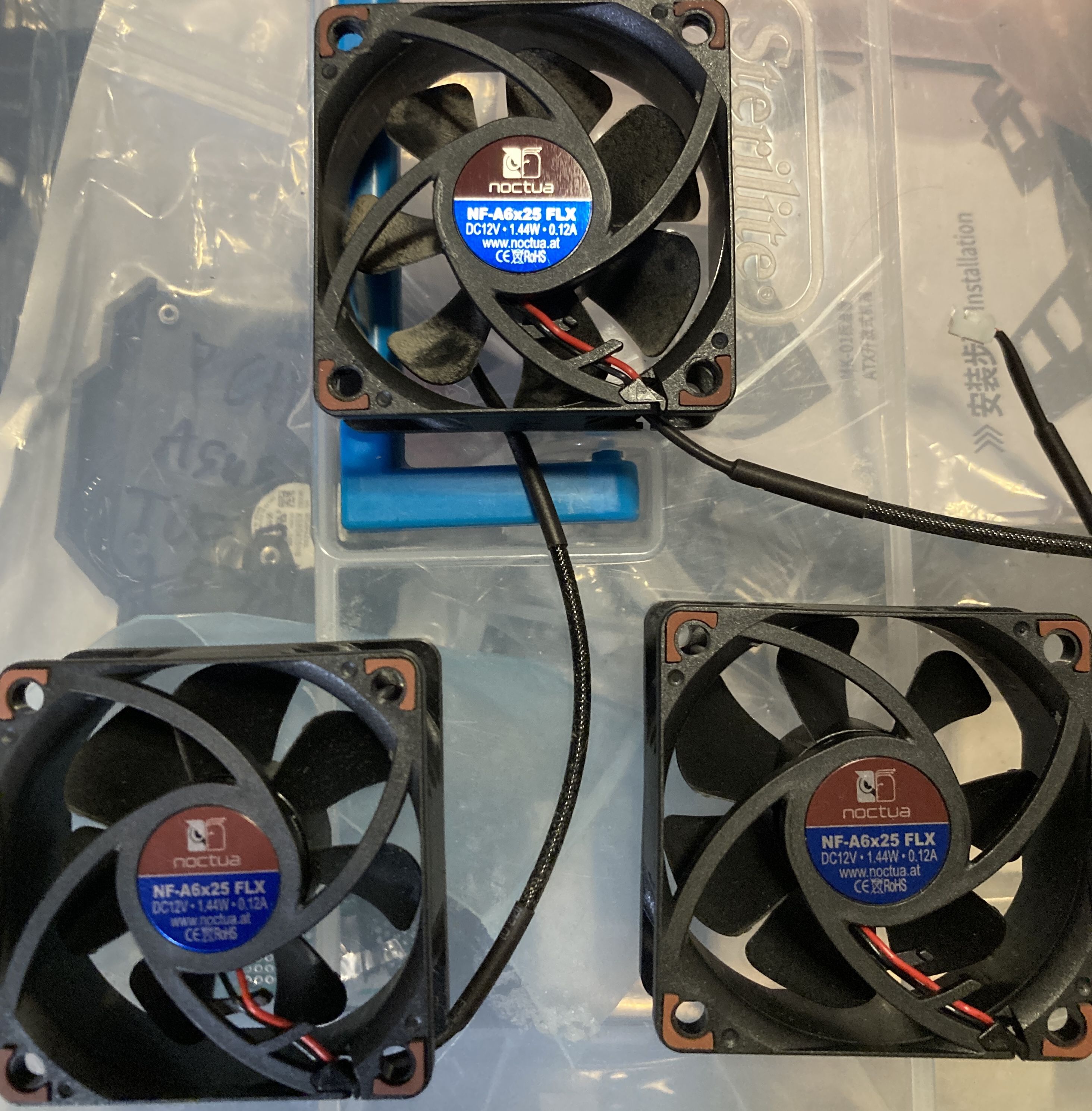

I bought these from OWC a few years ago, but cannot find a current seller. It seems I was lucky.
So boringly pretty! why can't these be their standard offering!?
Noctua: Our case fans are tan and brown because that's the color of PC's these days, right?
Noctua: Our case fans are tan and brown because we think it's an ironic branding choice in the face of trendy clear plastic and RGB lighting options!
Noctua: Our case fans are tan and brown because who cares, you can't see them inside the case!
1,784
1,518
My biggest issue with Noctua isn't the color, although I agree that tan isn't a very brilliant color choice. That's because it's not that easy to spot the tan color inside an SE/30 unless you are constantly gawking at it from the back. No, my biggest issue is PRICE, in large part because they include all those TOTALLY UNNECESSARY cables. Just sell the fan and also sell the cables as an option! They'd make more money selling cables as options, and there would be no waste that way either. Because right now, in their earnest to reduce the number of SKU's they sell, they are selling a bunch of adapters that many people won't need, and when you sell a lot of fans to the same people, those unneeded cables really add up. It's expensive and wasteful!

I thought they had the Redux line which were just the fan in a box at a reduced price? And if I recall they are light and dark grey plastic even.
