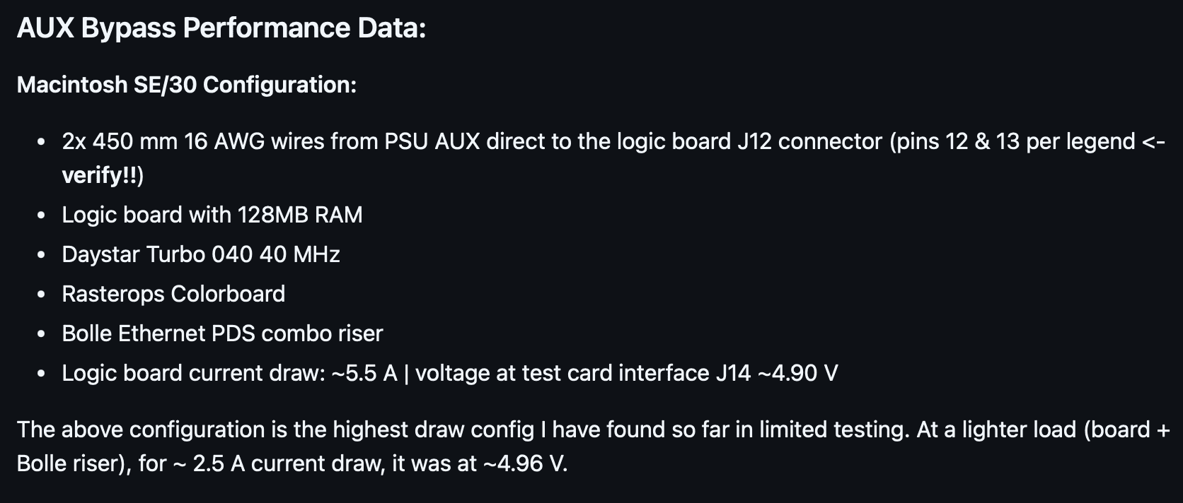

As I thought, even the top end PSU costing $170 cannot get around resistivity losses due to it outputting close to 5V. That is shown by the voltage measurements presented in the documentation:
With that said, 4.90V under such a heavy load on the 5V rail is perfectly acceptable. Whether $170 for that PSU is acceptable or not is another matter. :)
