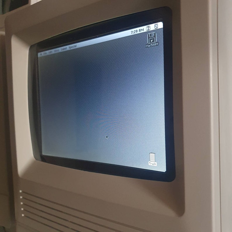

I understand that many like to keep the Compact Macs the way it was back in the day. On the other hand, I want to give them modern enhancements so that they can continue to be useful today and in the future. One of the things I wondered about is converting from CRT to LCD in compact Macs. I understand that it is relatively easy to do.
Yet, there is one riddle I have not fully solved. Will removing the flyback transformer, anode cable, video board, and CRT cause the logic board (LB) to panic based on the ROM and the overall design? There are ways to continue the video output to a small LCD internally. Yet, I wonder, will the LB still panic because there is no communication with the video board that is gone along with the CRT?
Conversely, wouldn't that be unsafe if the flyback transformer and video board were left there after the CRT was gone?
I believe there is a way to remove the CRT, flyback transformer, and video board, and the compact Mac can continue to function through an alternative video out set up. For example, certain wiring modifications adapt the TTF video output to the RGB2HDMI adapter. Please note that this is not the same as the PDS color video card.

On the newer compacts Macs where the analog board is separate from the power supply this may be more feasible, but I don’t see how replacing a CRT with and LCD would be an enhancement that makes it more useful today.
This would be the equivalent of taking apart an old working CRT tv, pulling out the tube inside, and replacing the tube with an LCD screen.
LCD screens are sharper and more precise than any CRT. An LCD with the acrylic sheet preserves the CRT curvate shape from Retro Apple Mods. The guy is willing to make more upon request.
The additional benefits include eliminating high voltage, creating green energy savers, and increasing the hardiness and toughness. The coming modern parts would be more compatible. There would be more room in the case for other expansion options with modern parts. With the CRT, compact Macs are somewhat fragile, consume energy more than necessary, and are not green energy compliant.
Back in the day, people had those compact Mac bags. I have one. I plan to carry it and use it elsewhere like back in the day. With the LCD, the Mac would be lighter.
Another thing, could 12v power be delivered to the LCD from a point on the AB? I messaged Retro Apple Mods to find out more about power requirements. I have been informed a standard 12v power supply with center positive will work. Running from the HDD power out at P5 or the fan wiring from P3 on the AB will supply 12v to the LCD.
Well, yes. However, the high voltage (HV) transformer and HV flyback must be removed for safety reasons. The question is, once those two parts are removed from the Macintosh SE analog board (AB) in the SE or SE/30, will the Mac still function fine with the AB acting as a low voltage (LV) power router to the logic board (LB), HDD, and fan from the LV Sony CR44 or Astec PSU while the video is outputting as TTL to RGB2HDMI to the replacement LCD screen in 1-bit B/W?
Reviewing the Bomarc schematics for this AB, I wonder if removing those HV components may interrupt the necessary HV power delivery greater than 12v for something other than the red CRT andode? I can see that 13kv delivers to the CRT from the flyback, which is HV to be removed as it is not needed for the LCD.
I guess one thing I can do is to hunt down a Macintosh SE AB and do the experiment if no one ever tried that? I am sure some already have, and I am waiting to see if anyone has or knows someone who did.
Do you know @AndyDiags? What about @JDW? @Zane Kaminski? @Kai Robinson? Anyone else?

No card. TTL output 1-bit B/W via header on a simple adapter between the LB and AB. From there will run from RGB DB9 to the LCD through RGB2HDMI.
Without the CRT, no point for HV, but keep the AB to route power to LB and other parts as usual from PSU as it is easier than modifying the PSU to add more wires and then removing the AB.

Well, i can power the SE and SE/30 logic boards just fine off a Meanwell RT-65B Power Supply, without even using the Analogue board. If you were using an LCD screen, that PSU would provide more than enough power to run the screen, too. The logic board doesn't care about the analogue board, there's no 'feedback' to it - just the video output that goes to the analogue board - you can intercept the signal and do whatever you wish to it.
@techav has a SE video adapter that plugs into the PDS slot, that can output to VGA. The idea, iirc, was to take the 512x342 display, pixel double it to 1024x684 and then pad the image by 84 pixels to display it on a standard 1024x768 panel. That way, all you need is a VGA LCD panel that can fit in the space left behind by the CRT, and voila.
So, I could remove the flyback and transformer and continue to use the AB with PSU without any issues with the LCD replacing the CRT?

Yeah i'd use a sheet of acetate or something to mount it - no need to 3D Print - just drill the holes - quicker, cheaper, easier. I never mounted mine in the case, it's role was as an external test bed PSU - but it worked just fine.
With an LCD no analogue board is ever needed, just tear it out and make a mount for a replacement PSU.

How are the reflections when using that acrylic sheet versus the antireflective stock CRT? Although an LCD will be more crisp and pixel perfect than a CRT, I'm curious if the reflections diminish the overall look of the screen. No doubt it's more reflective than even some older iMacs due to the utter absence of an anti-reflective coating on it.
Hi @JDW! That is a great point. I have not yet ordered the LCD screen with an acrylic sheet as I am working on restoring my SE/30 to its original condition and would instead find a defunct SE/30 for the fun modifications. The acrylic sheet is reflective like my daily driver MBA M1. I have experienced both, and no doubt almost all of us have. Yet, if I wanted the modified SE/30 to be anti-reflective, I could place a 3M Anti-Glare Filter on the acrylic sheet. Using a tape measure, the correct size can be trimmed before installation.

I'd not worry about the reflections, Laptops and Displays have had high gloss LCD finishes that it would look perfectly fine today, if not period correct.
