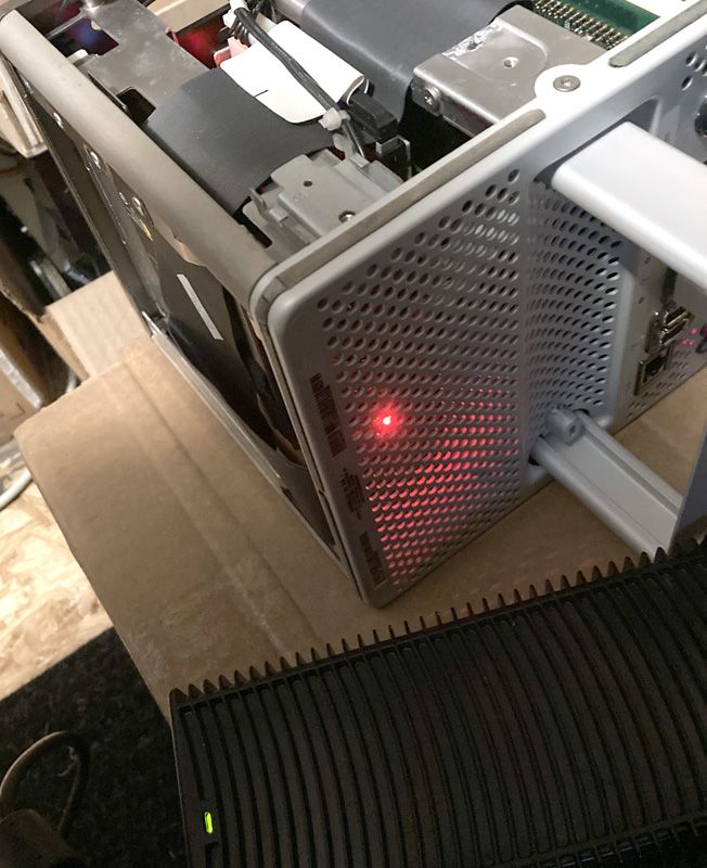

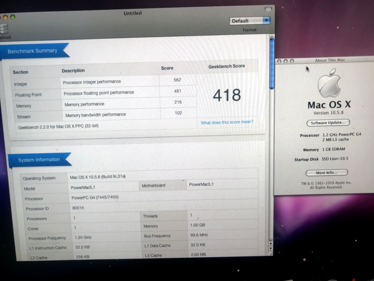

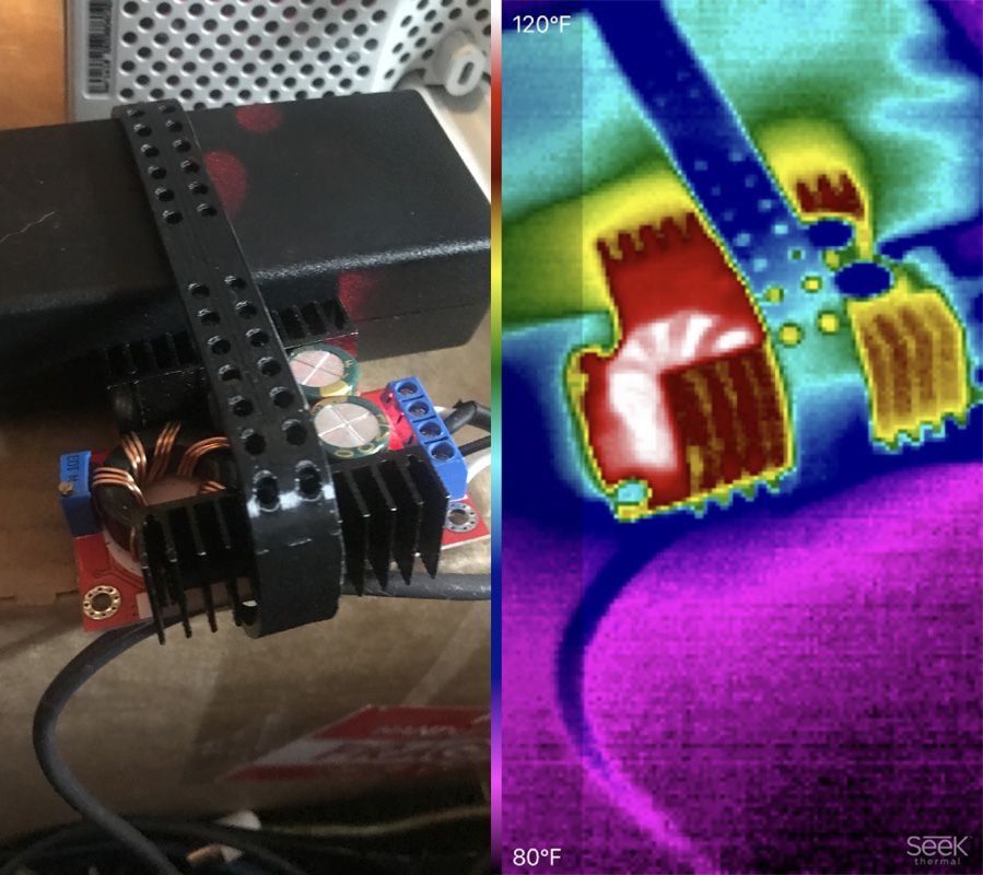

I do have the original GPU, and I could swap it out and test with some ADC Acrylics (I have 17, 22, and 23 models) but they are CCFL and probably don't draw as much as a CRT would. I do have a modified HP 19V 90W laptop PSU with a buck converter to 28v. A Cube should run on anything from 15-28V, but the ADC LCDs and CRT may be more picky with the voltage. Here is the 90W powering my cube under load (with DVI lcd monitor under its own power).
I don't have a finished case for it. That thin black stripe with holes is an 60% sized clone of the original, I just haven't printed it yet.

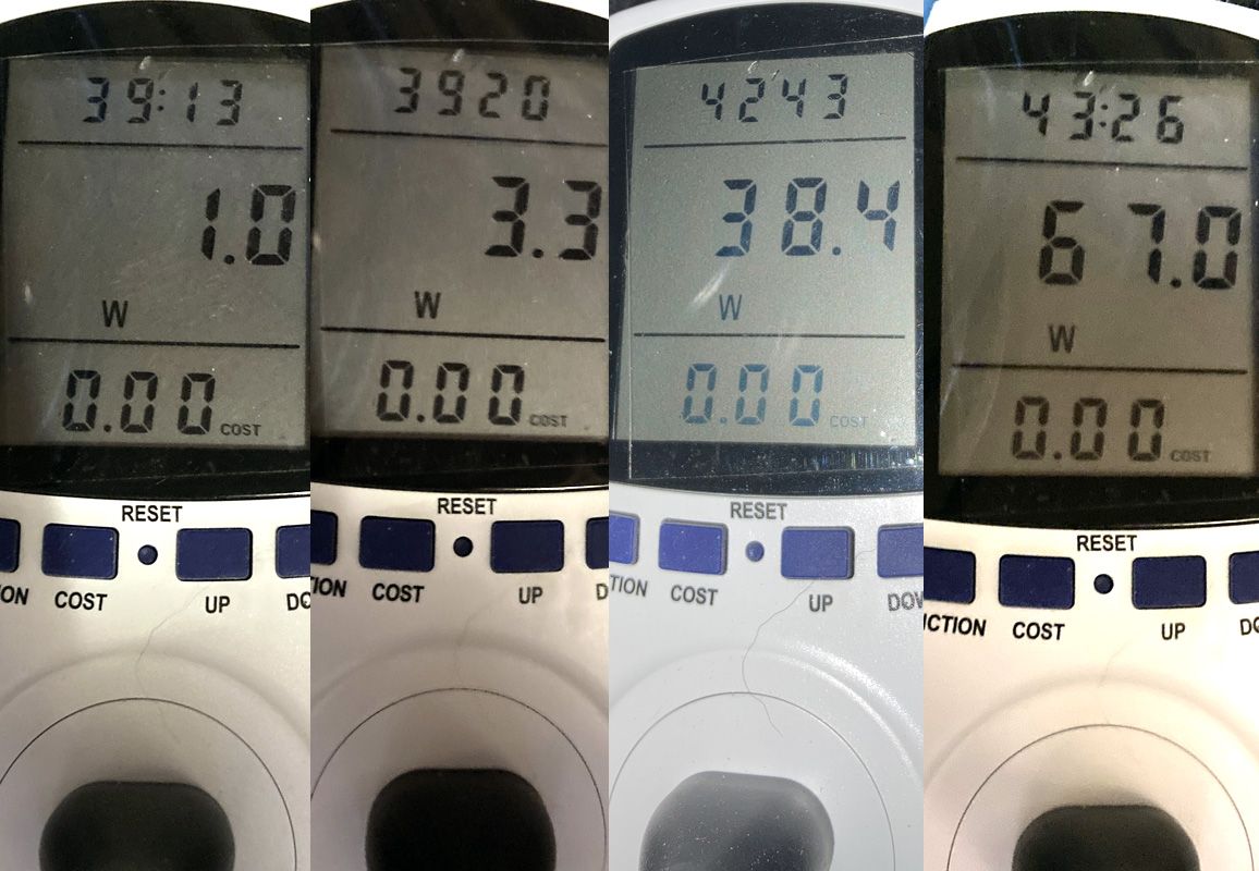

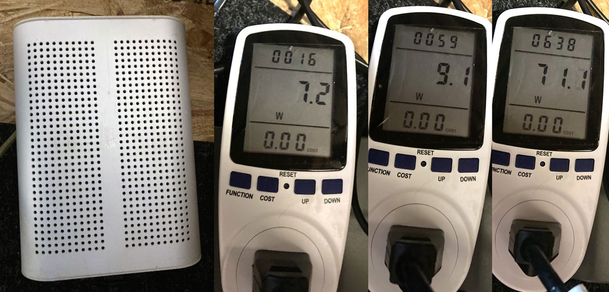

Here are my power consumption tests with my modified Cube and the original PSU. Just the PSU plugged in, Cube plugged in but not powered, and under GeekBench load.
Here are my power consumption with my 90W BUC to 28V. Just PSU, Cube not powered, idle load, GeekBench load.

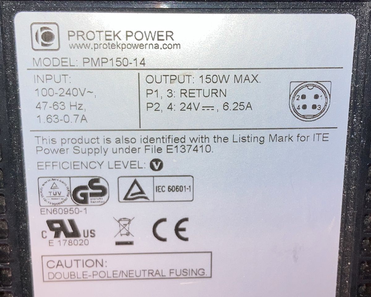

I also have this 24V 150W PSU that is pinned wrong, so I will be disassembling and swapping the pins.
This one should NOT need a BUC converter to power a cube with an ADC LCD monitor (80W to spare for the LCD).

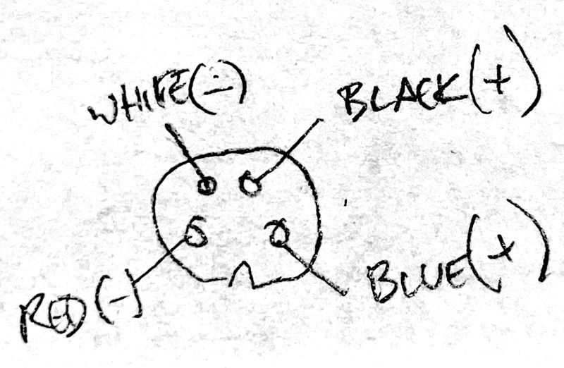

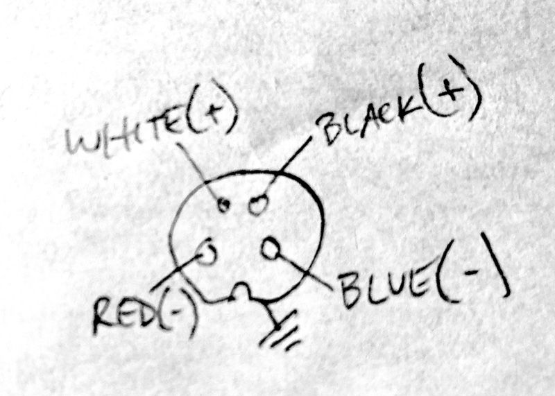

I found this diagram of some of the pinout "standards". But this diagram is misleading, as the flat edge should line up with the indent alignment node (show in the line diagram), but the photos are rotated 180. So the photo of 4PIN1 is correct for the pinout, the line art is opposite. Most other power supplies I have found (old hard drives, raid systems, Prussa 3D printers) all use the 4PIN2 or 4PIN4.

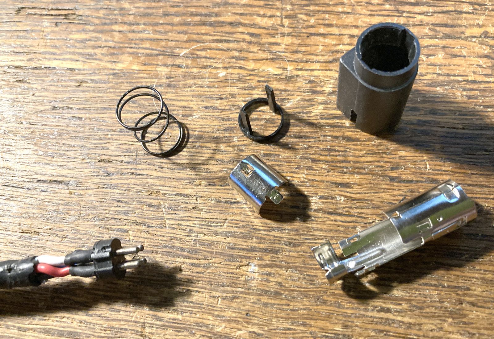

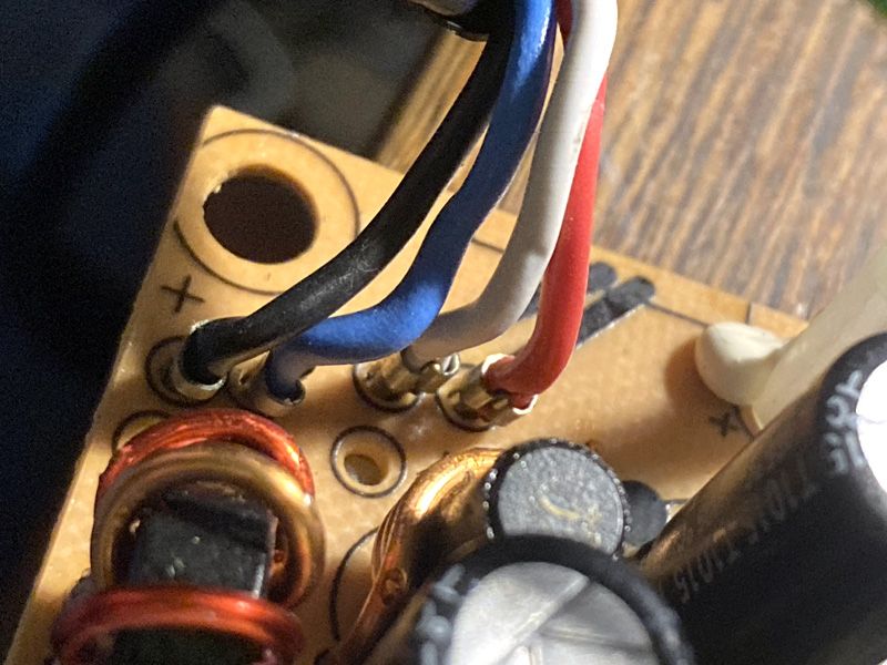

Just following up on the 150W 24V PSU I converted. I disassembled the end connection (It is a nightmare).
With all the wires so tightly shrink wrapped in there, I did not want to redo it, so I put it back together. But it appeared to have 4 separate wires, where some of the other mentioned PSUs with left/right wiring only had two wires and the pins wired together.
I then disassembled the brick and decided to just move the Blue and White wires and reassemble. This is the photo before, I did not take one after.
Original wiring:
After swapping blue/white internally.
Power consumption of the PSU alone with no cube attached is pretty low. 2.2W with the Cube connected but not powered on.
The VRM light up, and it powered on fine at 24V.
