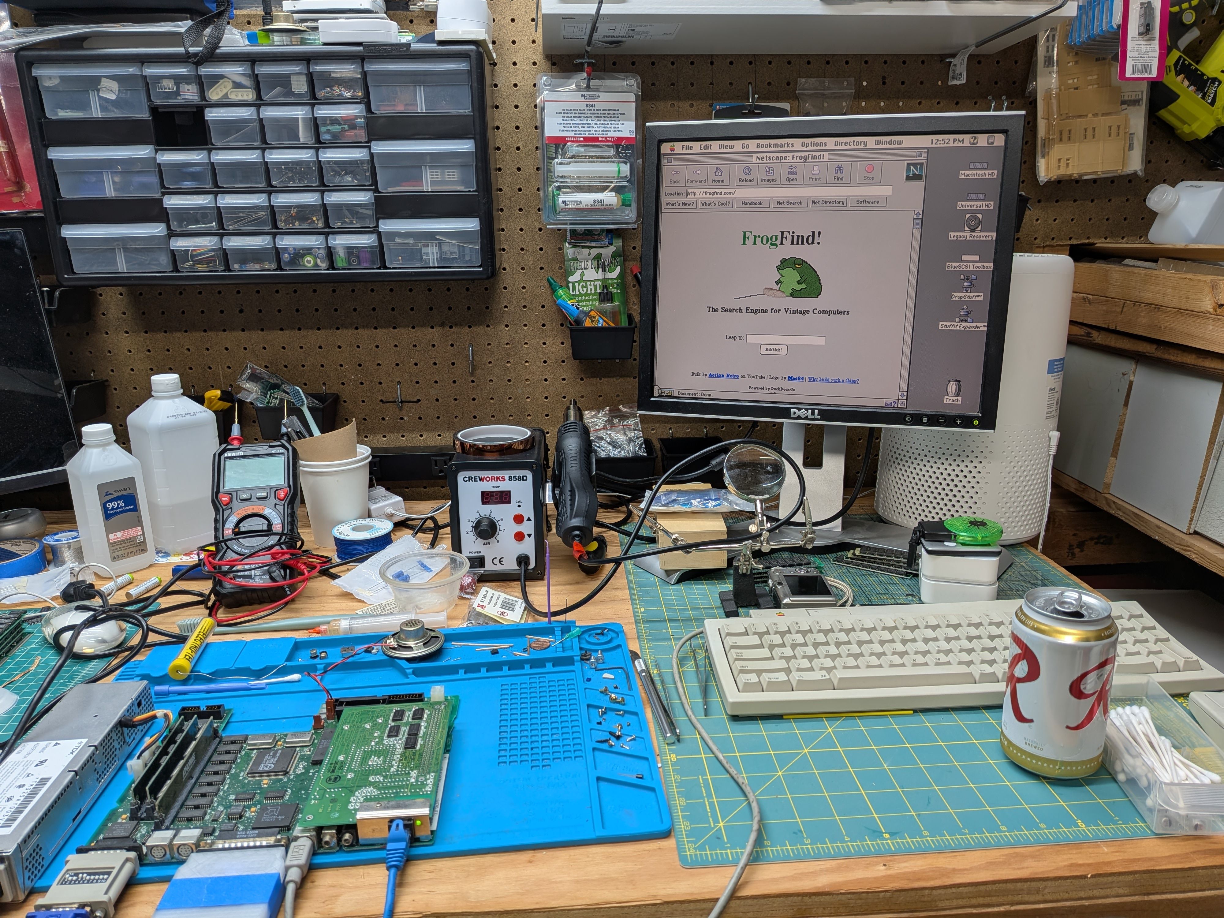

Here's a picture of the card:

It's got a different chip number, 5000112-00-01. I blew some compressed air on the slot connector and the pins tonight, there was a sneaky cobweb in there, tried it again but no change. I'll give the oxidizer a try when I have a chance to pick some up. As far as I can see from a visual inspection, there's nothing obvious that looks out of place.
That chip is the ROM, it is the one with S9406AN on it that I would check the pins on. I think S9406AN is a date code (probably 1994 week 6), under the label it will have "DP83902AV" and "ST-NIC™", that is the ethernet chip. The label sticking over the edges might be obscuring something.
The ECLIPTEK 20MHz oscillator is the other part that I'm wondering about. Oscillators sometime fail or become unstable due to mechanical shock, but there is no way to visually detect that.
