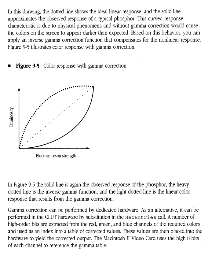

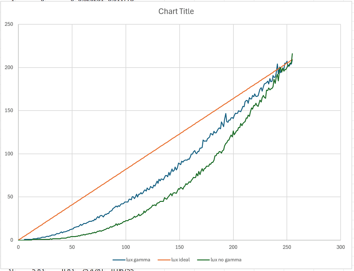

Gamma correction is for correcting the brightness of midtones rather than lows or highs. Practically, grays become somewhat brighter so it feels like the entire picture is brighter.
Why: CRT has a nonlinear response curve. Excerpt from DC&D.
I did some cursory testing with a brightness sensor and baremetal code with and without gamma correction. This setup is non-calibrated and not the most accurate, but you can see how the response is more linear with the correction applied.
