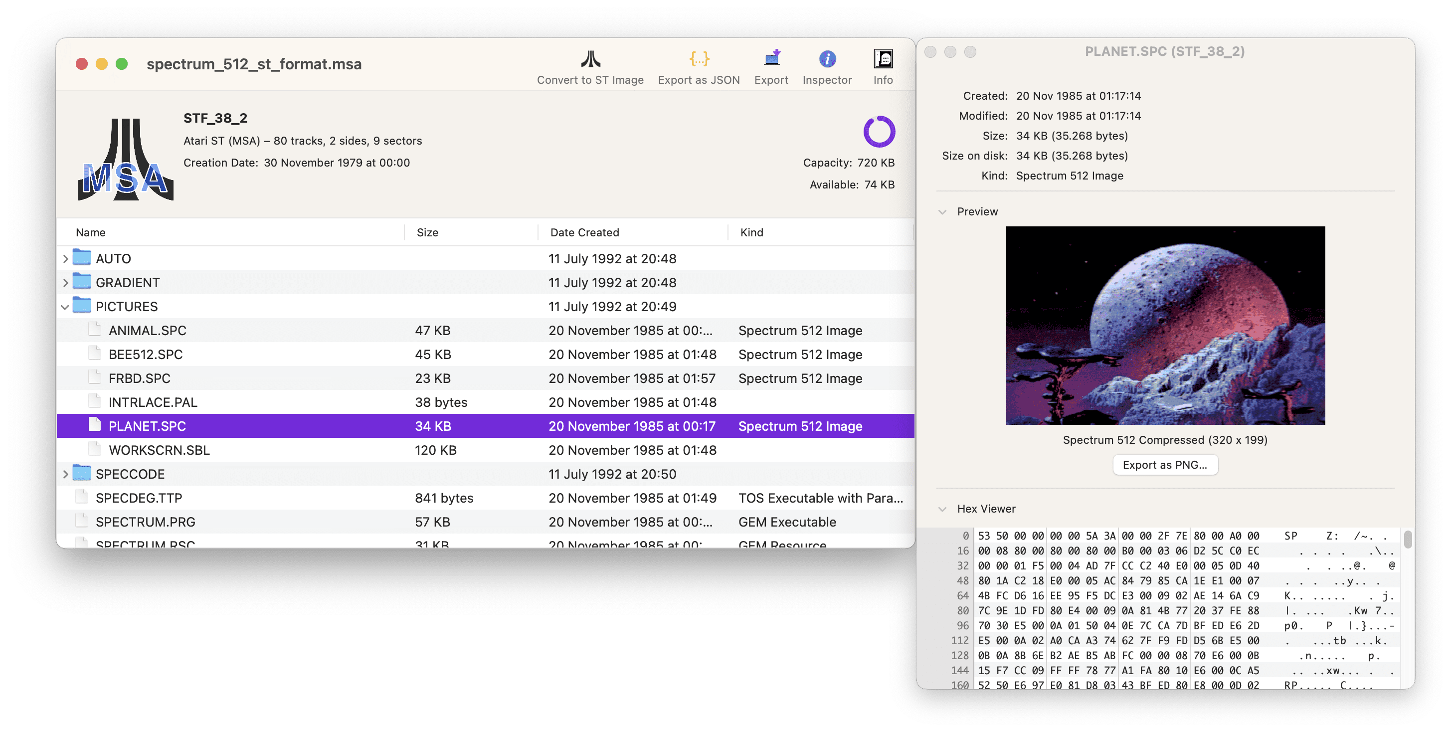

A better interface, a brand new Inspector for your files, support for more formats (NDIF, UCSD Pascal, Atari ST hard drives and more).
See your files' data as hex, preview their contents when possible (for example: read your AppleSoft Basic listings directly or check out Atari ST images in Degas format).

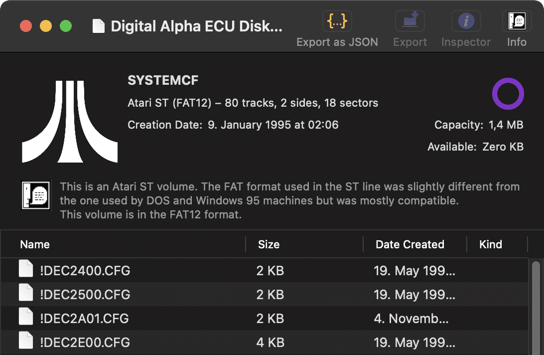

I really like the new version, and as already said elsewhere, thanks for keeping up support for "old" host OSes. (Keeping High Sierra around for 32bit Support and EFI experiments.)
However, it still believes all of my FAT12-Floppies (MS-DOS, NT, firmwares like ARC, EISA etc.) were Atari ST. And while the infotext claims they would be not exactly the same as MS-DOS-formatted disks, it can´t differentiate the formats. ;) As many retro people also like MS-DOS, I personally expected it should be able to either differentiate or be more generic when it comes to FAT12. Are there any plans?
OMG what an oversight on my part :) Apologies for that.
Would you mind zipping up floppy images from a couple of different platforms that support FAT12 and sending them my way? Non-DOS preferably so I can spot the eventual differences.

a) Rather detect the ATARI OEM signature "Loader". Because PCs would use OEM signatures "MSDOS", "PCDOS", "SYSLINUX", "VGACP", "MSWIN4" or others + version numbers … plus accidents like "G8q3IHC" ("xxxxxIHC") that result in mangling by 32bit Windows. Even my Alpha FW Update and EISA ECU Diskettes use "MSDOS" for compability.
As this is complicated …
b) Just switch by extension, use ATARI if the ending is ".st", as the others could be ".img" or ".imd" or ".vcp" or ".dd" ;)
Anyway thanks for listening to these ideas :)

The (completely self-imposed) constraint regarding file extensions is that I don't want to use them as an indicator of the file type. They are unreliable (people can change them at will) and, once you start supporting formats coming from different systems, they name clash (an ".img" is different on a PC or on a Mac and, on the ST and others, it's a picture format :) ).
As for signatures, "Loader" only appears on bootable ST floppies so that's not sufficient. It's a bit of a pickle.
But I'll figure out something eventually :)
