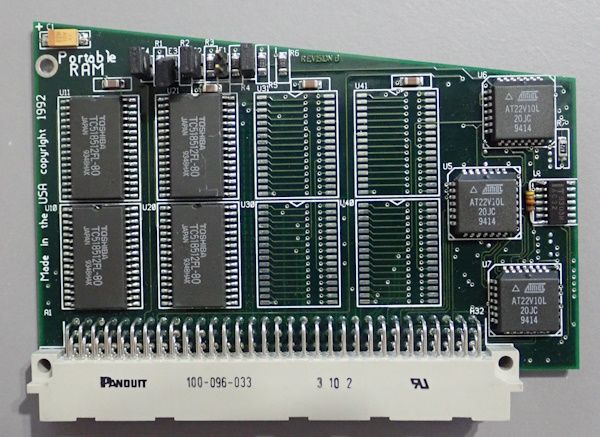

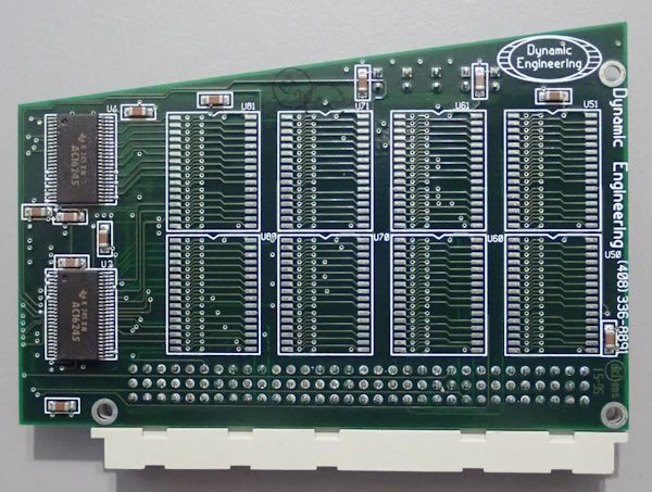

I just bought a Dynamic Engineering Macintosh Portable RAM card with 2 MB of RAM installed.

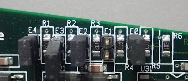

I also purchased new old-stock Toshiba TC 518512FL-80 PSRAM chips to bring the card up to 8 megabytes. My plan is to use this on a 5120 (non-backlight) Portable.
The jumpers on the 2MB card are all installed except E1. I've seen a picture of this model of card with all the memory populated, where only jumper E3 is removed. So, that's what I intend to do.
Can anyone tell me (@techknight?) the jumper configurations? Is there anything I need to do with them to switch between a 5120 and a 5126? Is there a jumper to reduce memory to 7 MB on the card so that this can max out a 5126 but then be switched back to 8 MB to max out a 5120?

I have soldered on all the RAM. It works great in System 7.1 on a 5120 Portable. It shows 9MB total and passes all the memory test applications.
However, in System 6.0.8, it crashes when doing something as simple as displaying the About box in the Finder. I recall reading about a solution for this, but I can't seem to locate it on the forums. Does anyone remember?

Great work! I saw this card on eBay as well - glad someone here snatched it up. Looks like the same RAM ICs that the PowerBook 1xx series uses. Did you have to tinker with the jumpers to get it working? I wonder why Dynamic Engineering didn't use the dedicated RAM expansion connector, but rather the PDS interface... access to more signals not present on the RAM slot?
Yes. For 8 MB, I moved E3 to E1. So, all jumpers populated except E3. I will play with it further to figure out how to make it 7 MB for use in the 5126.
I believe the RAM slot is limited to 4 MB (recent recreations use an extra wire to provide more). Additionally, the system provides the refresh and data ready signals for the RAM slot. On the PDS slot, the card has complete control.

It looks like the jumpers follow a predictable binary pattern
EO=+1MB
E1=+2MB
E2=+4MB
E3=+8MB
E4=unknown
So, to get +8MB (9 in total with motherboard 1MB), pull jumper E3. To get +7MB (8 in total), keep E3 but pull E2+E1+E0. This explains why the board with 2 megabytes already soldered to it had E1 pulled.
