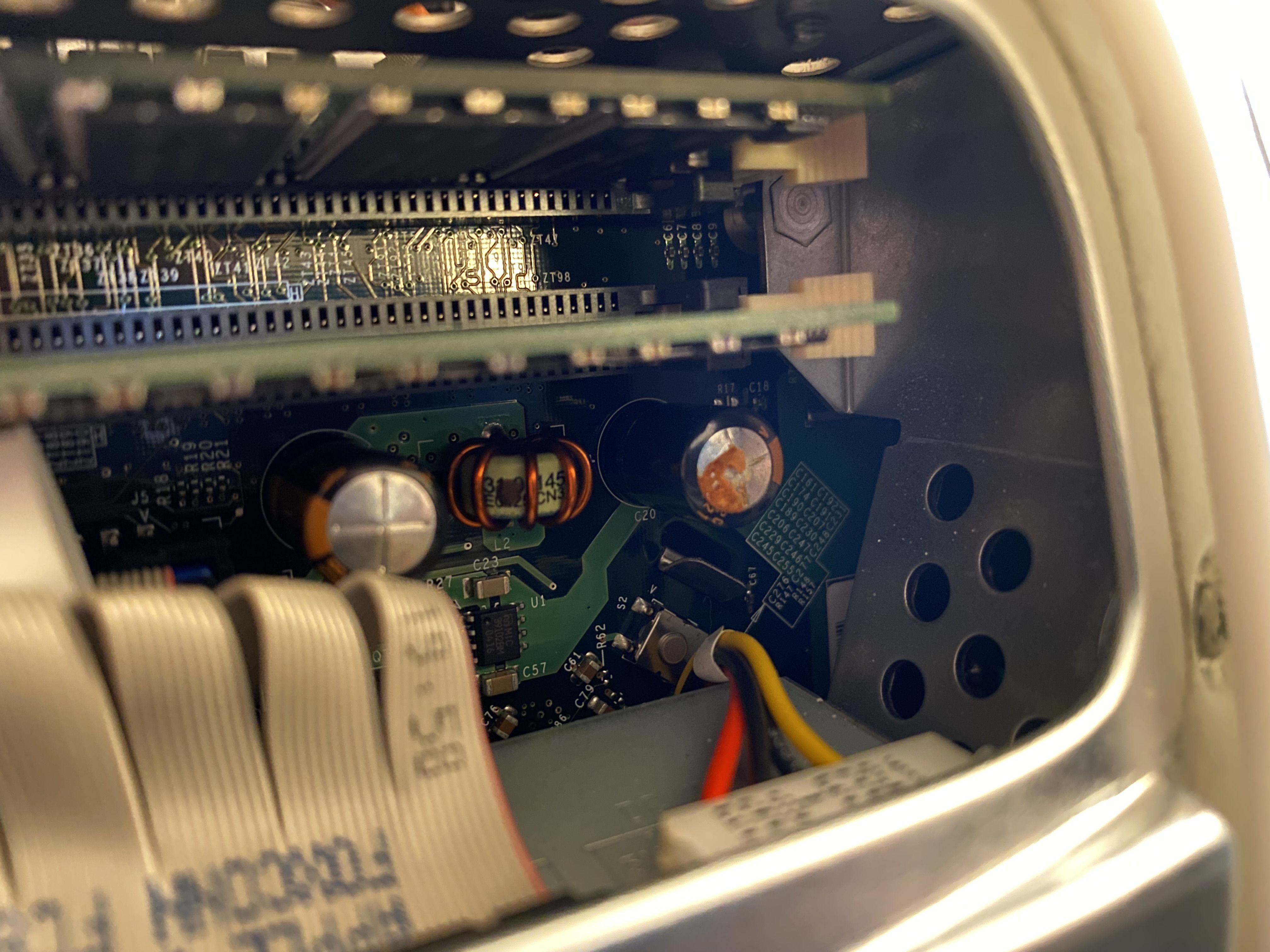

I think I need to do a recapping sessions on my eMacs (recently picked up in Berlin) and probalby ALL of the boys and girls from the G4 era. (approximately 7 computers with their Logic Boards and PSUs... 🤪)
But at first, the very beautiful eMac 1.25 with original boxes and packaging... I changed the PRAM battery and look what I found:
The only luck with them is they are at the bottom side of the PCB and thanks for the gravity, hopfully they won't destroy the Logic Board's traces.

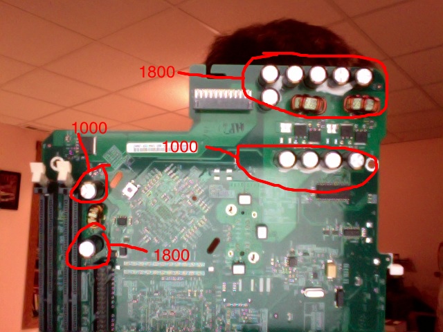

So this is the logic board and there are a lot of caps: Source of image
