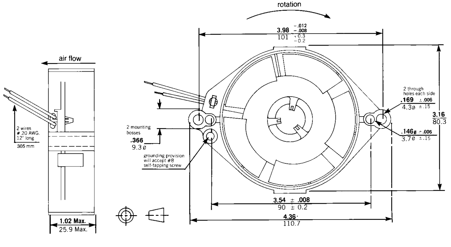

Pretty sure you've got the airflow backwards in your diagram. It sucks air out of the computer, not blows it in. That being the case, I think a normal blower fan like the original would be best (not sure how well those radial blower fans work in "reverse"). 115V AC like the original would make the wiring easier. Finding one that spins slow enough to be acceptably quiet would be important too. Knowing the required dimensions of the fan would be necessary for identifying specific make/model candidates.
200
245
Pretty confident that the original is 80mm from mounting point to mounting point. I’ll confirm general dimensions this evening.

This is the datasheet for the Etri 146DJ-2182-030... it's 28 dB @ 115vac / 60 hz :)
  • 146ac.pdf
