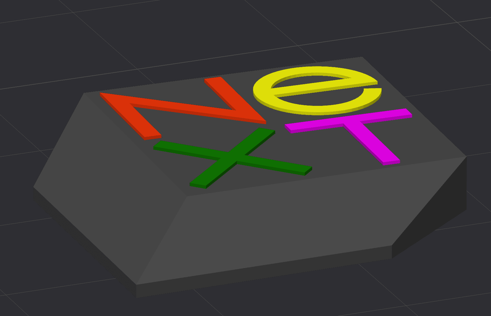

The other part a little disappointing is that it has a 3d printed logo that isn't super nice. The colors are a bit off, and it has a rough finish. So, the real reason for this post is that I'm going to try to improve this by making a new one. I've always wanted to try out the WLJ full color 3d printing at JLC3DP and this seems like a perfect oportunity
So I found a model of it online, it was scaled a bit wrong, so I resized it. I then sliced the letters off the base colored them according to the official NeXT colors, and am getting it printed in full color resin from JLC3DP. It cost me about $7 plus about $3 shipping. The model I got has the NeXT letters raised. I'm not sure if the original logo had that or if the designer did it because it made it easier to color the letters after printing in a single color if they were raised. I may print another with the letters basically at the same level as the rest of the cube..
I will send an update when the print comes in to show off the quality. This is my first color resin print, so excited to see if the quality is close to the single color resin prints I've gotten from them.

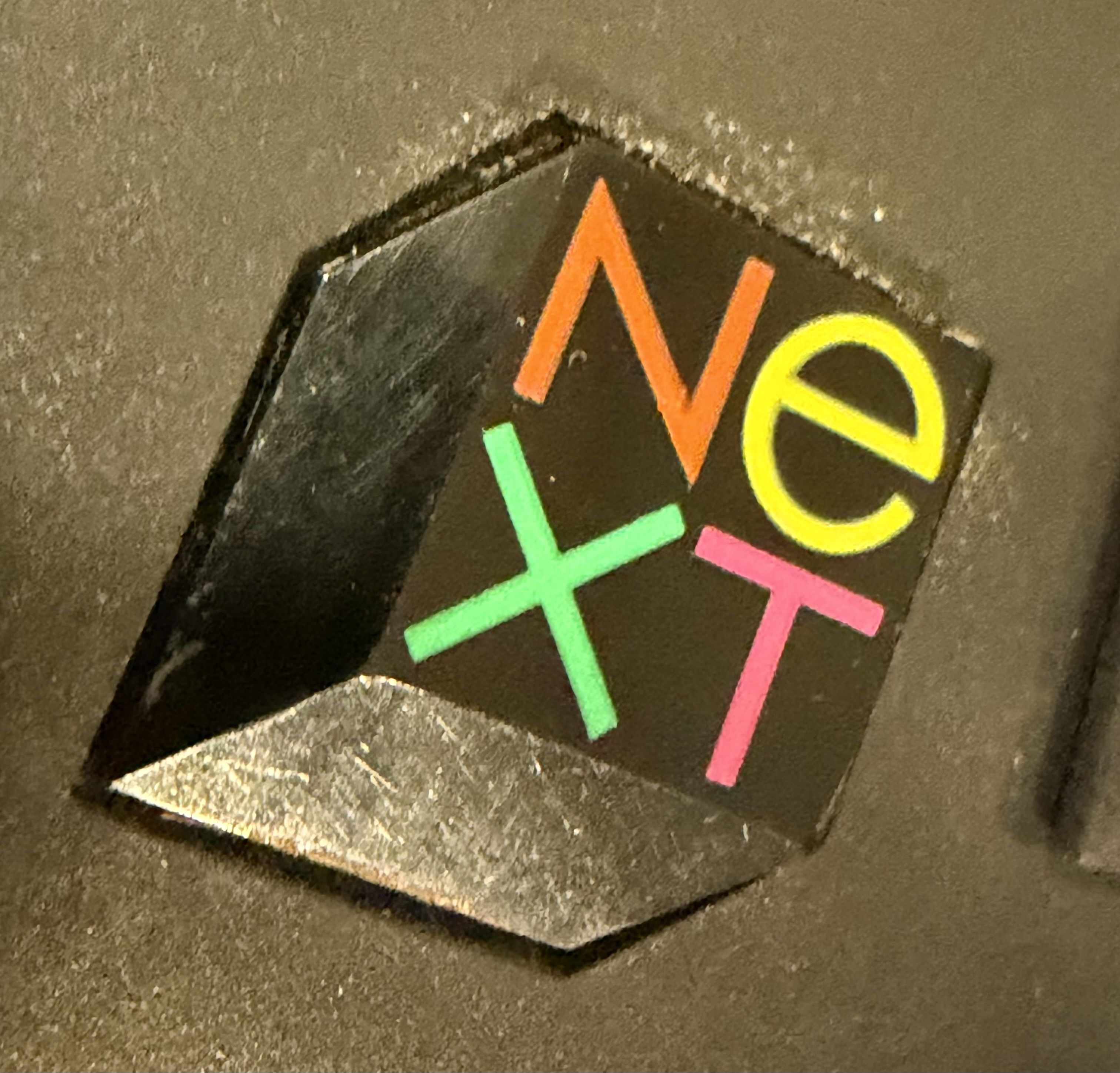

After about 6 back and forth interactions with the very patient support person at JLC3DP, I finally got a printable, full color model that they were willing to try to print. It's a bit thicker than the original, but it meets their requirement of prints being at least 1mm thick. The order is now in production, so I'll post the files (obj file for the 3d model, mtl file with the material / color) if it prints properly and produces a good result. I ended up getting a closer look at the original logos on my keyboard and mouse and the letters are not raised, so I adjusted my model to have the letters flush with the top. I can probably adjust if the result doesn't look good.
Can anyone with an original NeXT Cube badge confirm if the logo has raised letters?

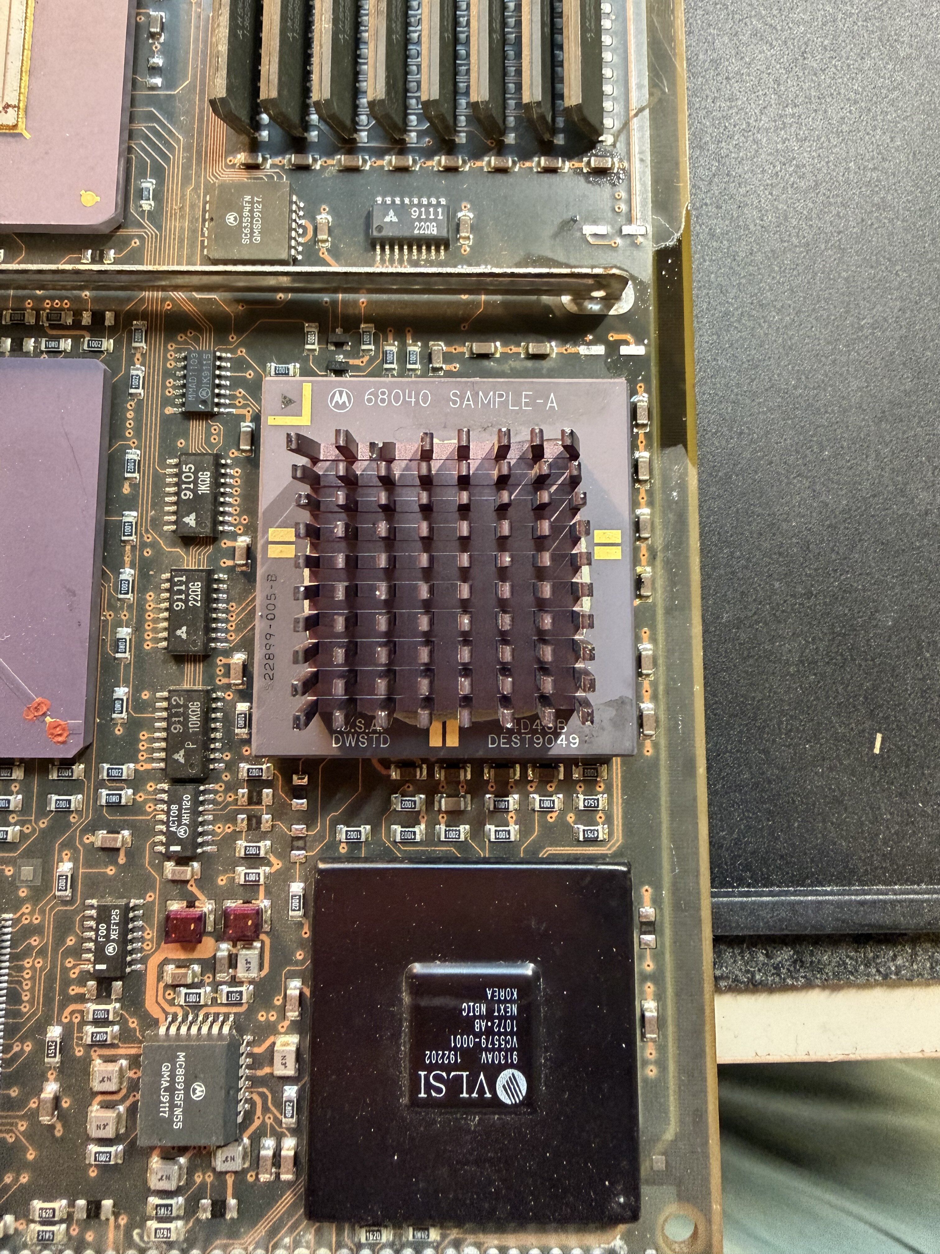

So, I just recapped the logic board (it looked like someone had recapped, but the surface mount caps were poorly done, and I wanted to get some OS-CON caps in it for longevity.
It looks like maybe this machine had an engineering sample installed?
Is it possible that this was a reason it might have been running slowly? Any Risk to throwing a 68040 from my set of 040s from Macs that have been battery bombed? As long as it is a 25MHz or faster, I should be OK to do, right?
And probably figure out a way to add a heatsink similar to this one...
I wouldn't think that would be a problem, but is your board socketed? Mine isn't, but I know some Cube boards were.

I will also likely swap out the 68040 for a standard one and keep the engineering sample protected separately. It's also worth noting that my NeXT Cube seems to have a pretty low serial number: AAK0000697. Not sure if it was an early run of the 68040 Cubes (still being called NeXT Computer)?
Yeah, from what I’ve read, some early 68040 cubes had socketed CPUs and it looks like I have one of them. Although with how bad it looked (burns to the board, a ton of flux around the pins to the bottom, it could have been someone doing it second hand. It looked very out of place on a NeXT board, where I like to imagine Steve was at the end of the line inspecting each one.
Given it’s now performing well but I want to open it back up to test the ZuluSCSI with a clean SD card, I’ll probably throw in one of my stock 25MHz 040s and store the engineering sample someplace safe. Probably not any real benefit to it except maybe to someone who might be able to use the exposed pads on the top of the CPU for diagnostics.

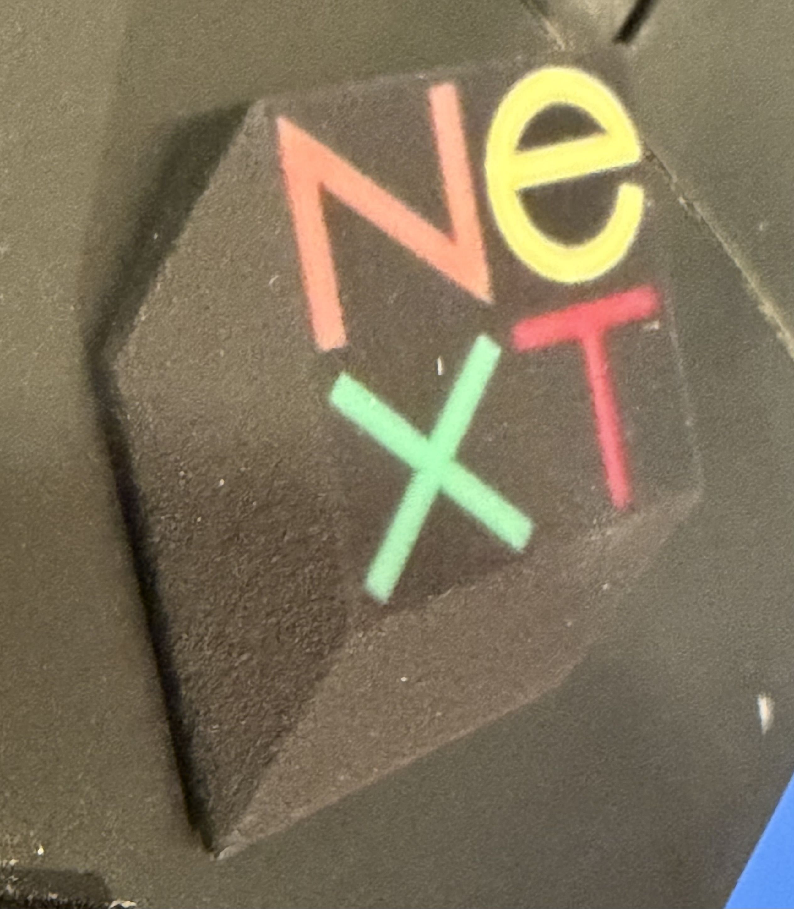

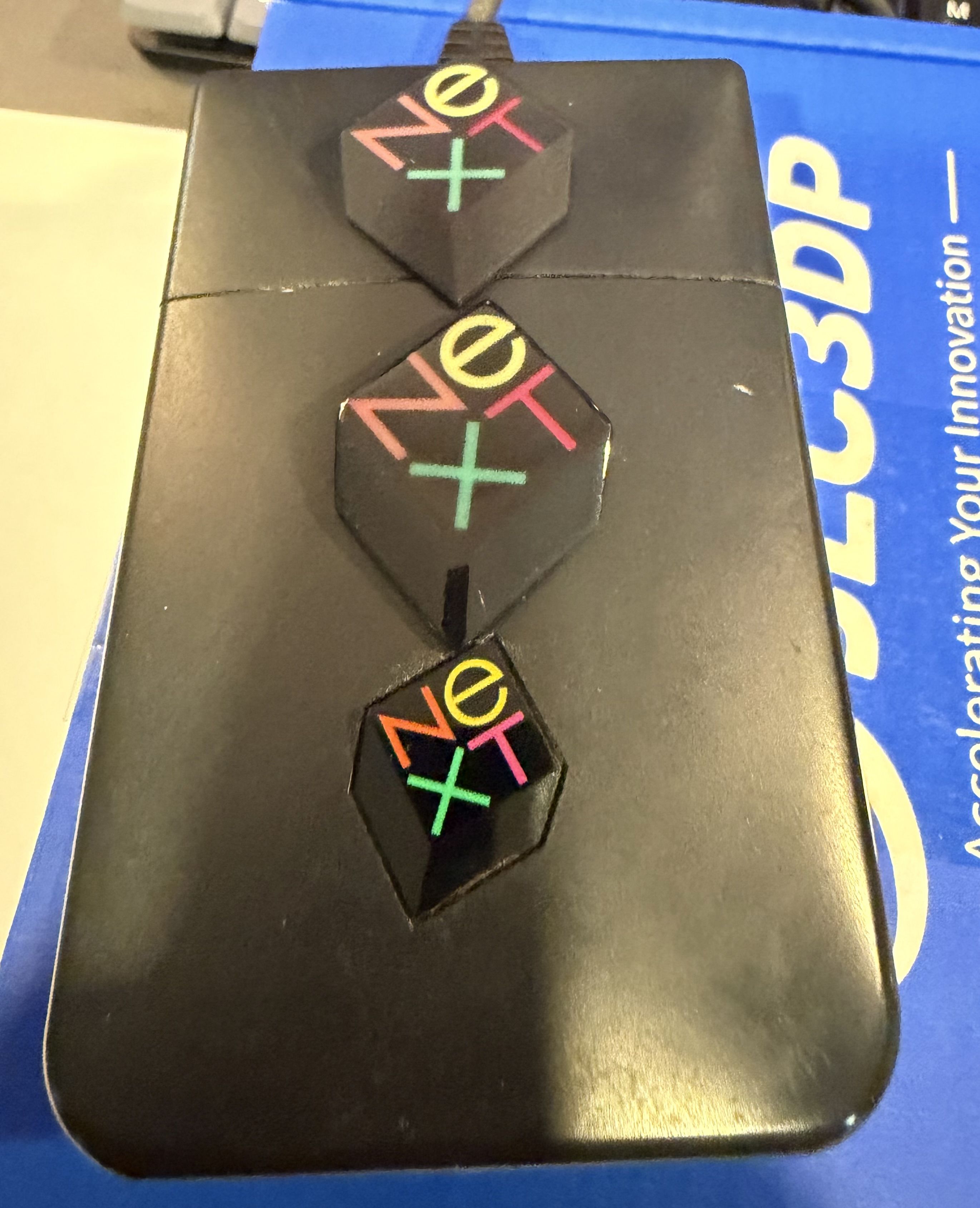

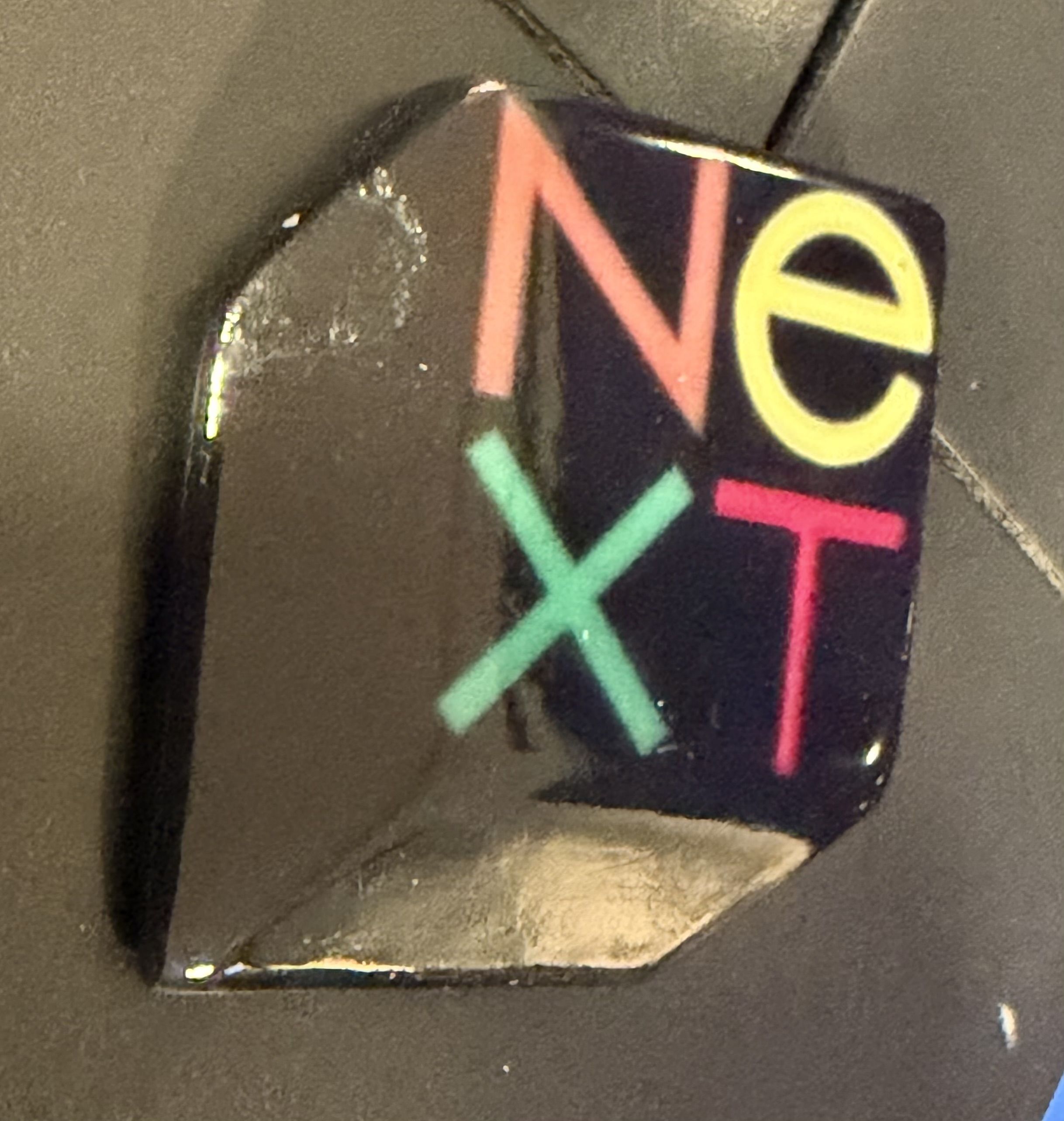

OK, so the full color resin prints came in. They're good, but might be better with some adjustments. The gloss finish really softens the edges so iy doesn't have the sharpness of the original logo. The matte one retains the crispness of the angles, but doesn't match the gloss of the original. I'm going to try a gloss spray paint to see if I can get the best of both worlds.
The colors could use a little adjusting. The orange and magenta are a bit too dark (may be due to printing bright colors over black?). Not sure how easy that will be to correct.
Here's some more detailed shots (original from Mouse, glossy, flat. next to FDM printed one on my Cube) :
