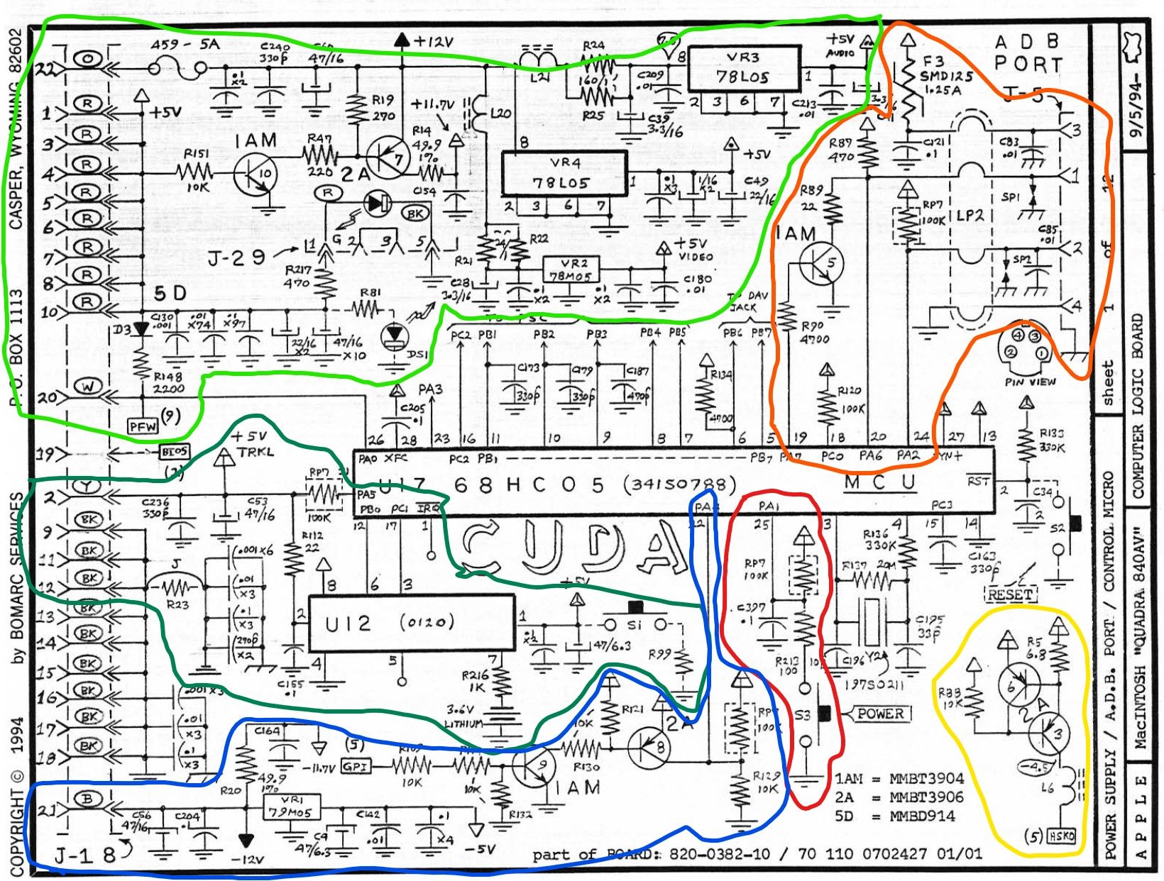

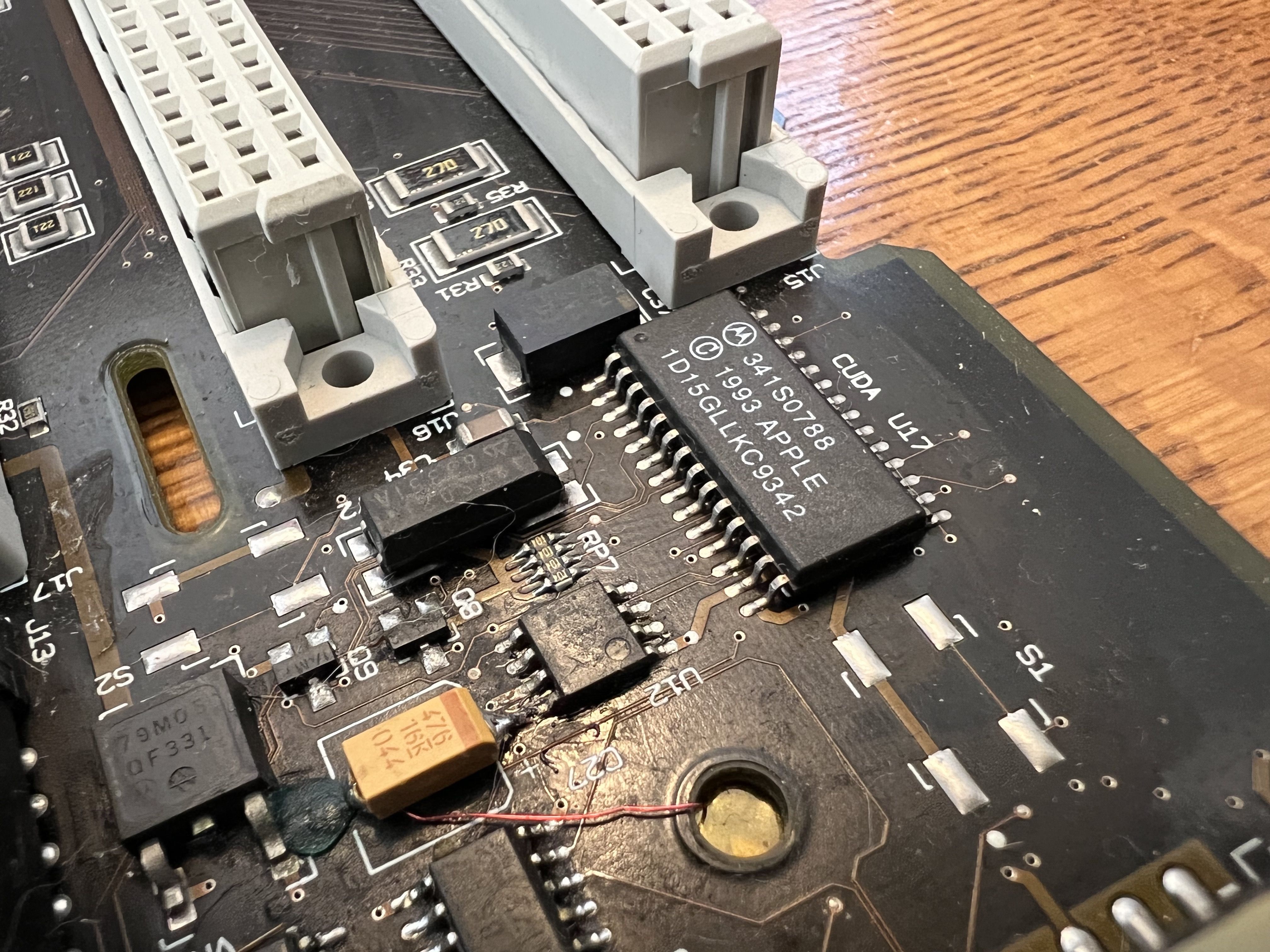

I started working on this one today. The power button does trigger the power on circuit and voltages at the MLB PSU connector are all okay. The caps were quite crusty as well as a couple of the serial ICs and U48 which looks like it might deal with reset. I cleaned up all of that. Just need to check traces and lay down new caps. Hopefully this will be an easy one.
