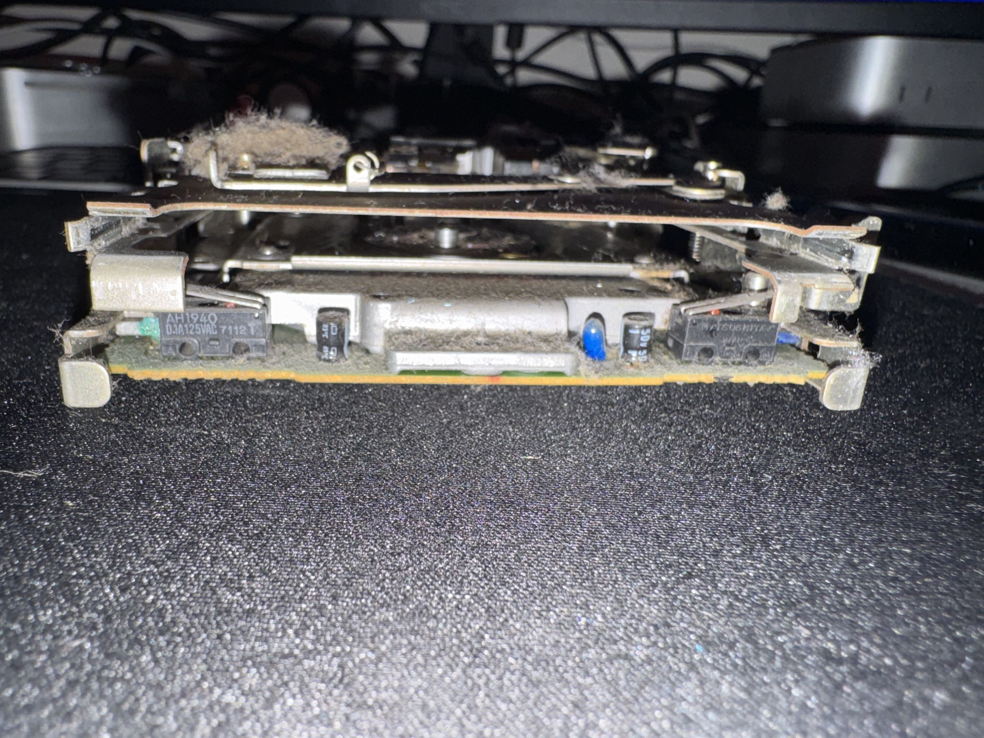

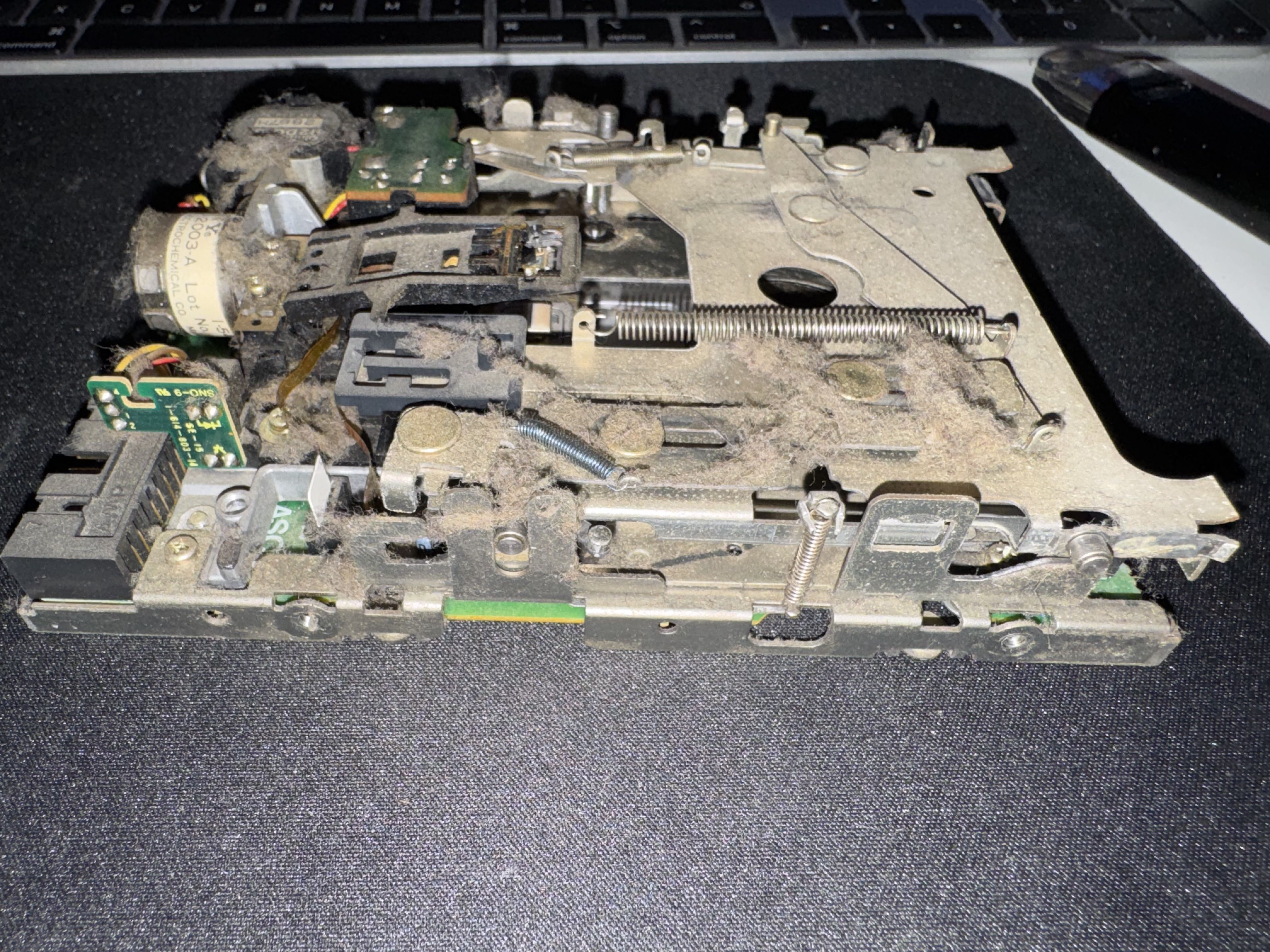

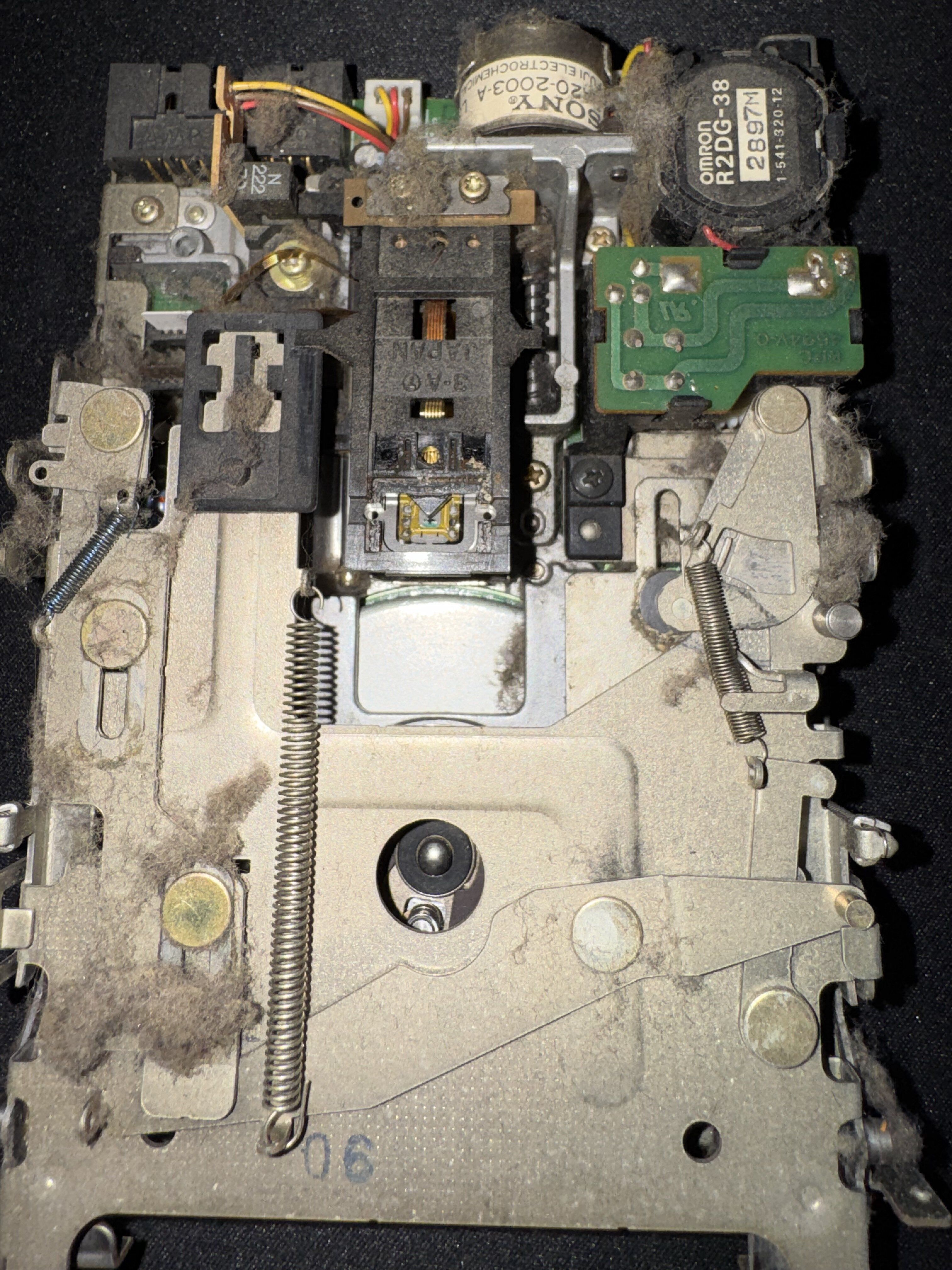

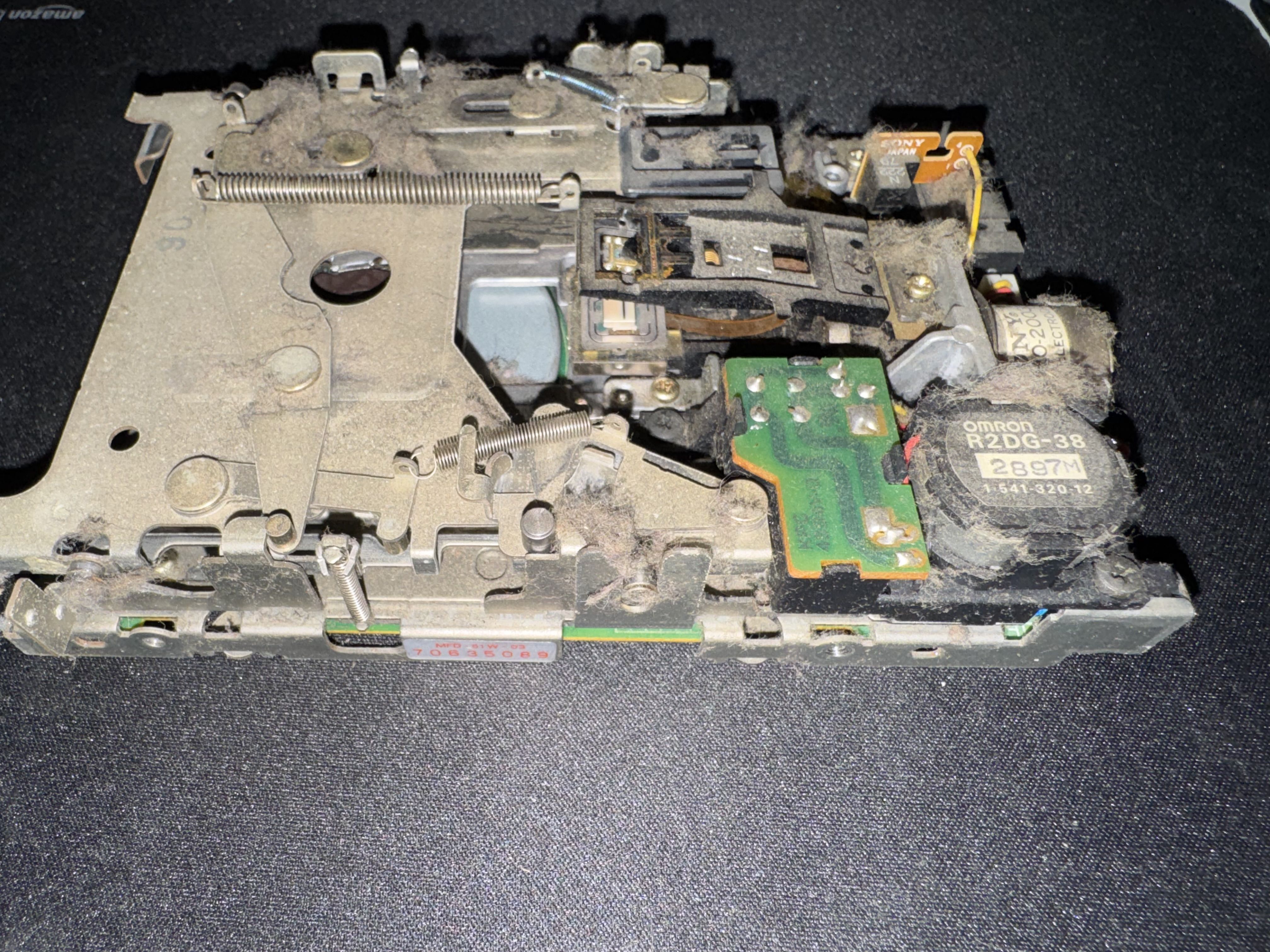

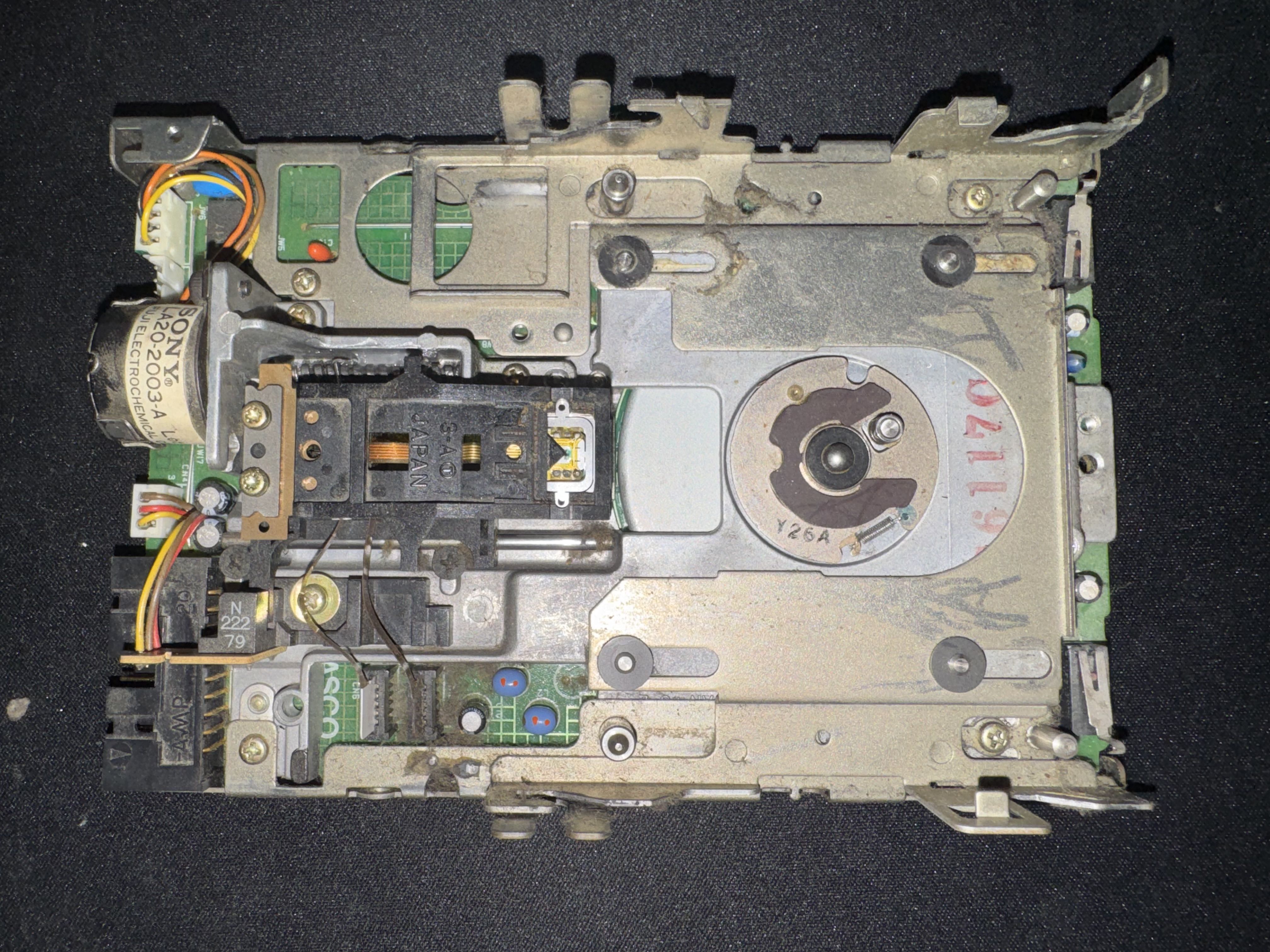

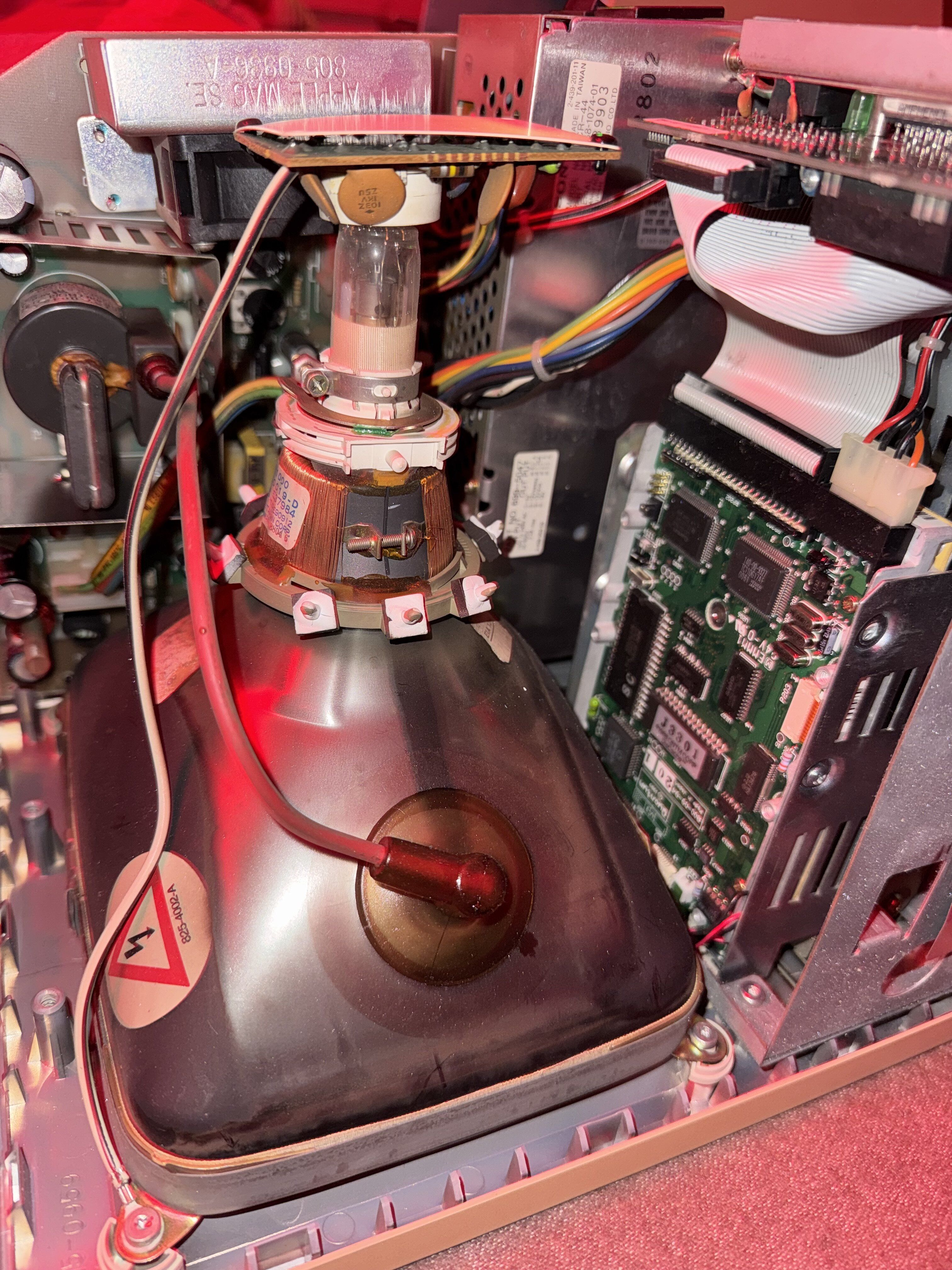

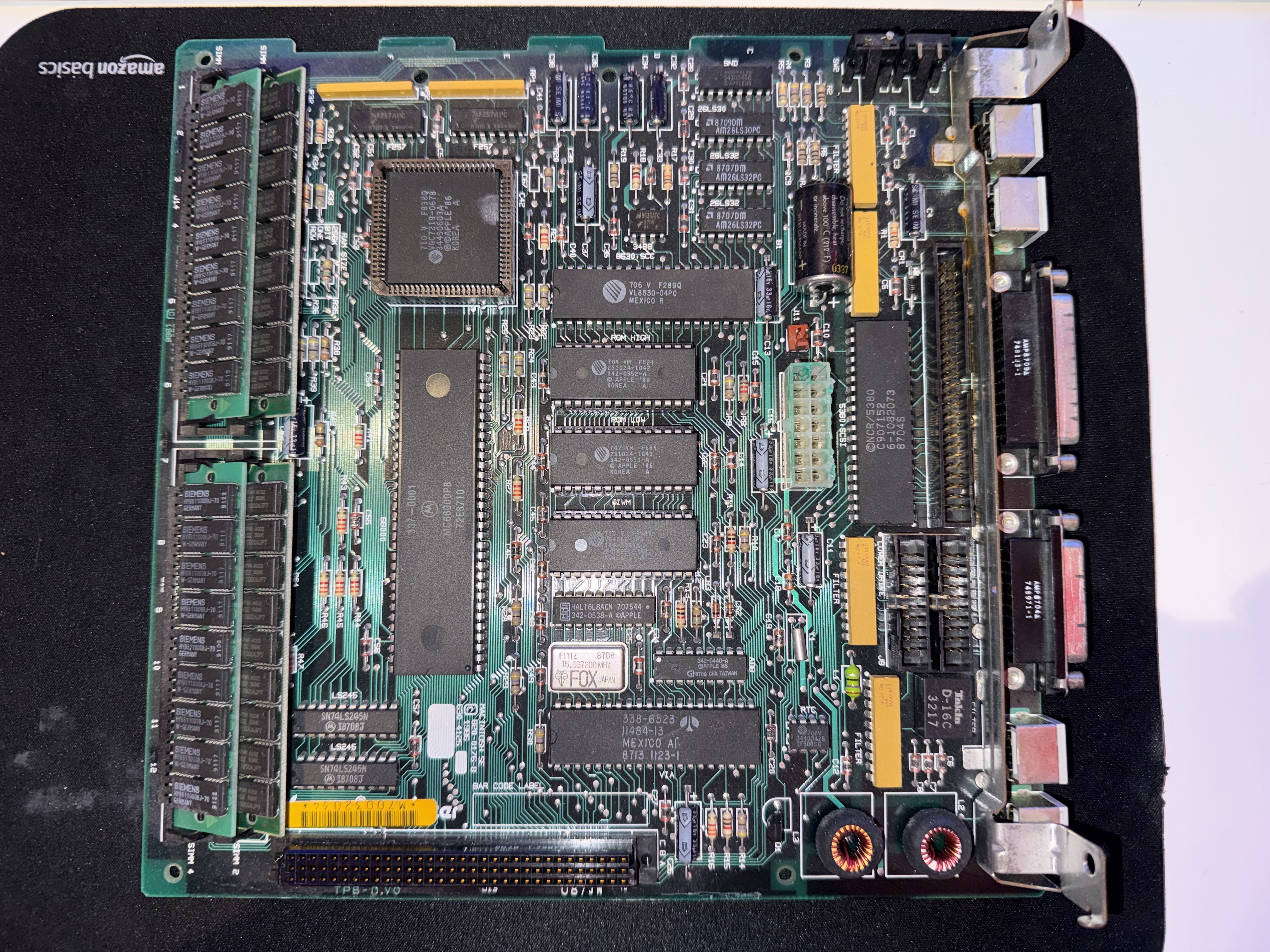

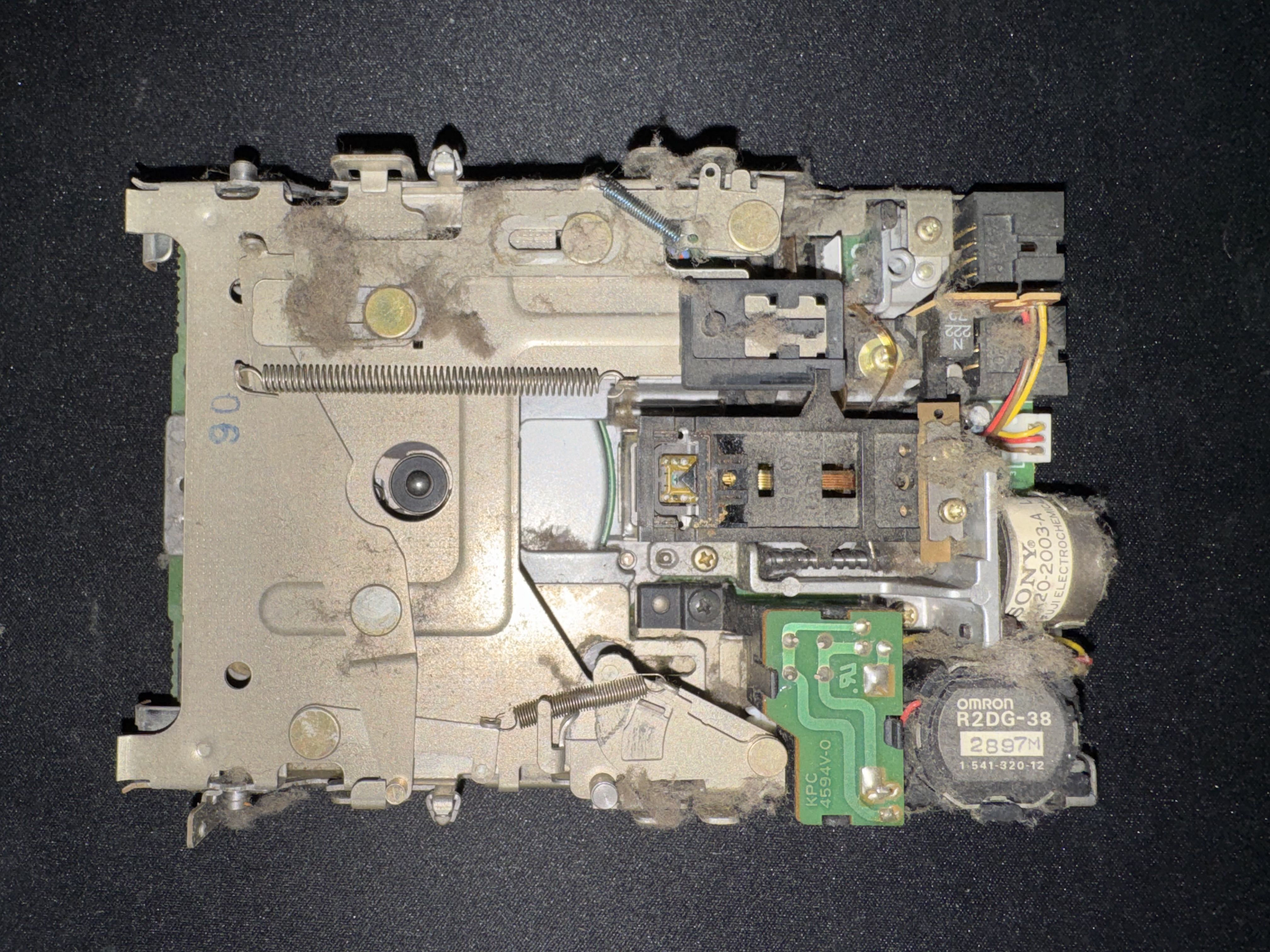

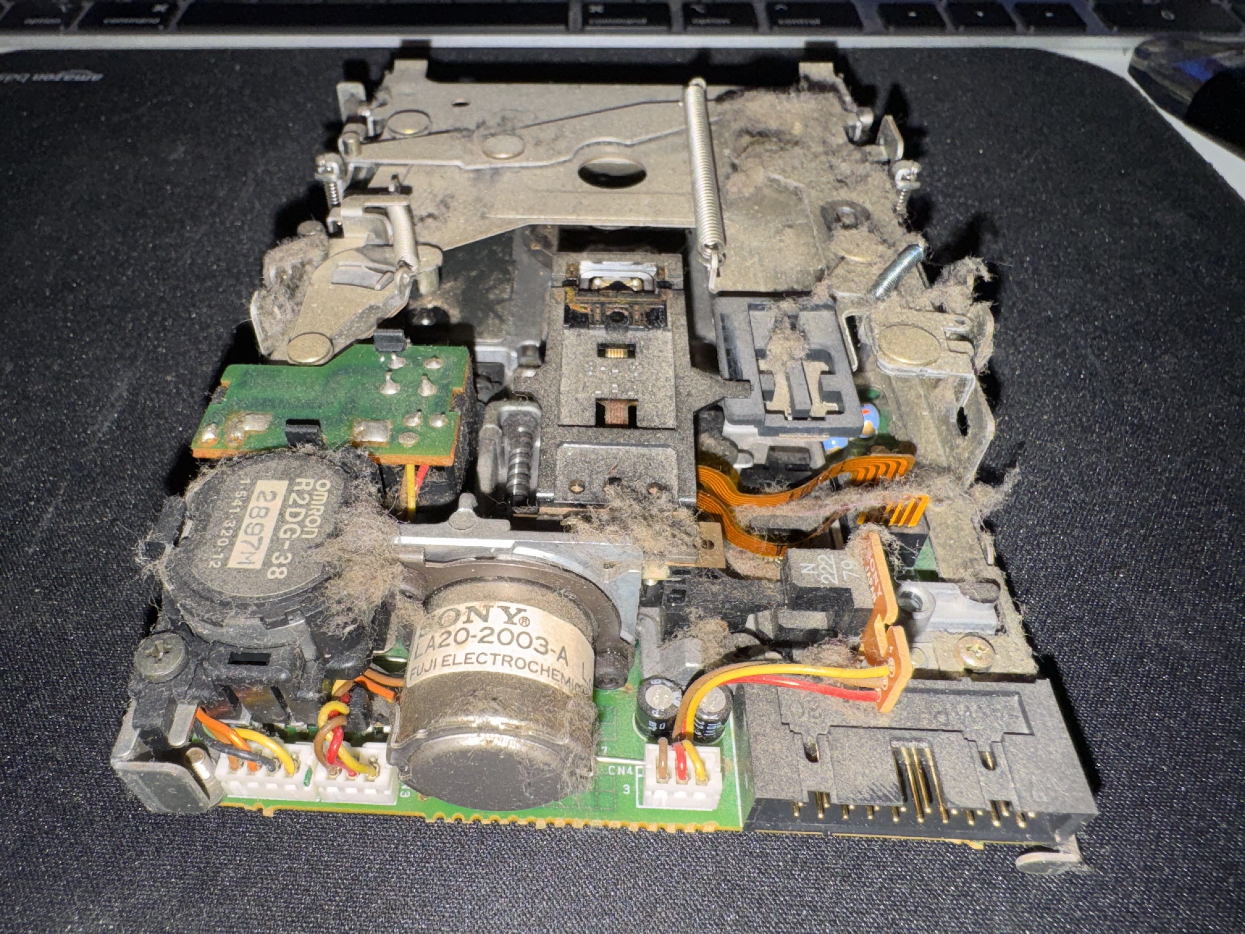

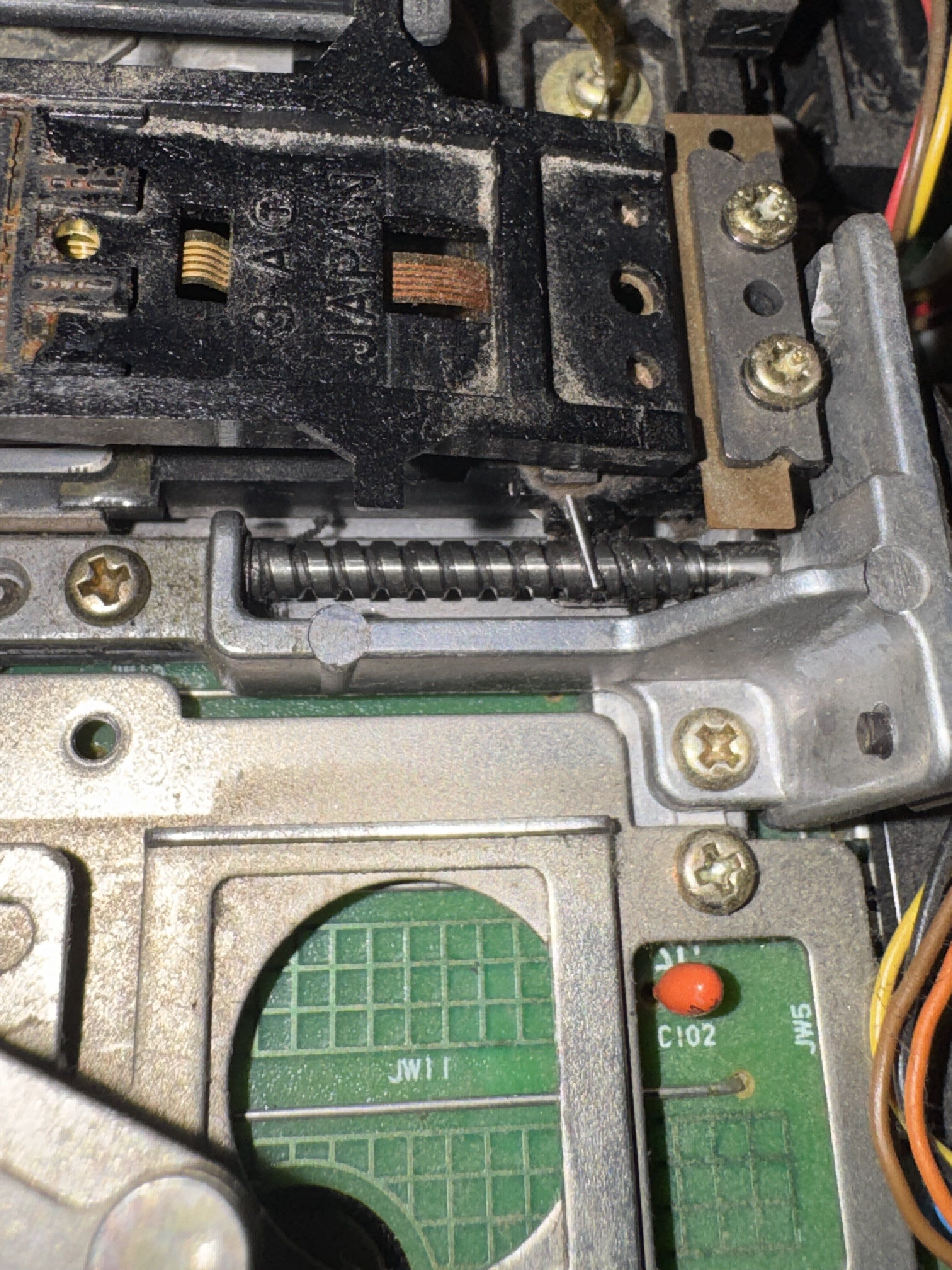

I’ll add some pictures as well, maybe they’ll help someone else someday as reference.
I forgot to take photos after the final cleaning and lubrication since it got pretty late, but at least I have some in progress shots to show the disassembly and general layout.
