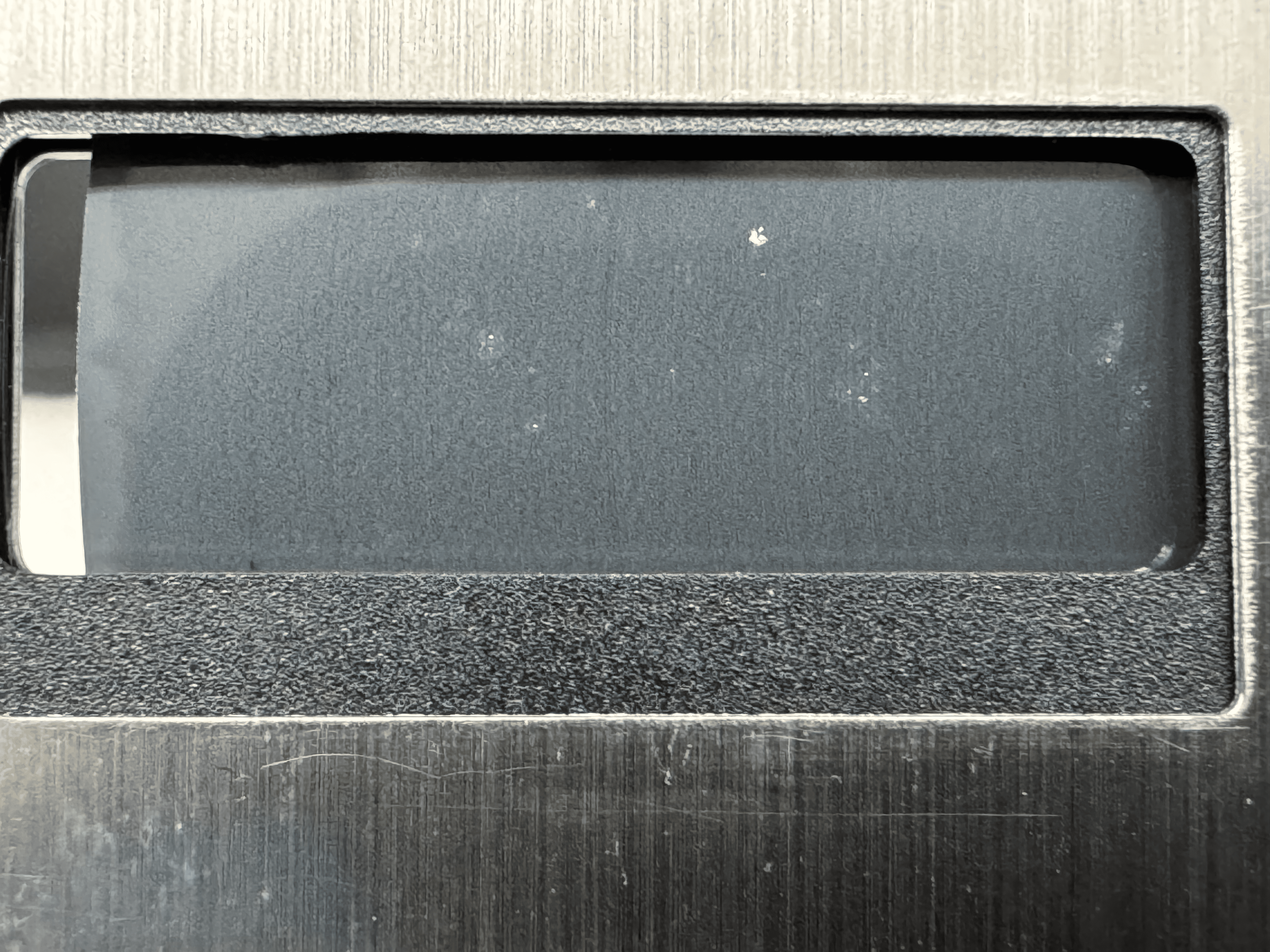

Do any of those disks make a louder than normal sound when you insert them and they start spinning? If so, look at them under a lens or microscope to see if there’s any mold or debris on the disk itself. To do that, you need to slide the metal slider open so you can see the disk itself.
The reason I mention this is because I recently had a situation where I put in a very old 400K disk and it made an abnormally loud sound when spinning, and then when I ejected it and put in another known good disk, that good disk was unreadable, yet but I put it in a different disk drive, the good disk worked fine. I then was forced to clean the head multiple times in order to get my drive working again, probably because so much mold and crud from the bad disk got stuck on the head.

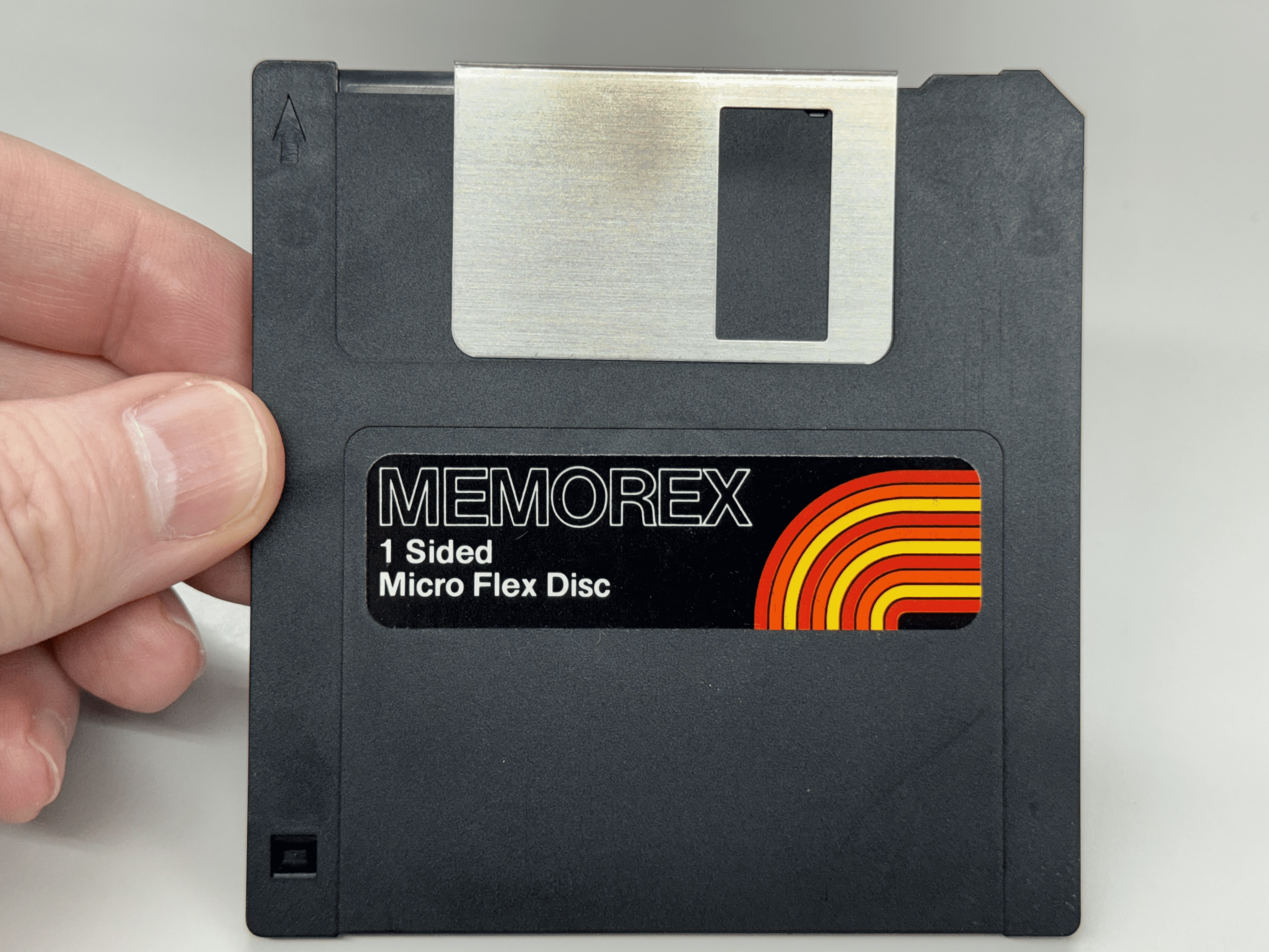

Here's the moldy floppy I mentioned in my previous post, which negatively affected my heads, even though I had just cleaned the heads and the entire drive only hours prior to testing that disk.
